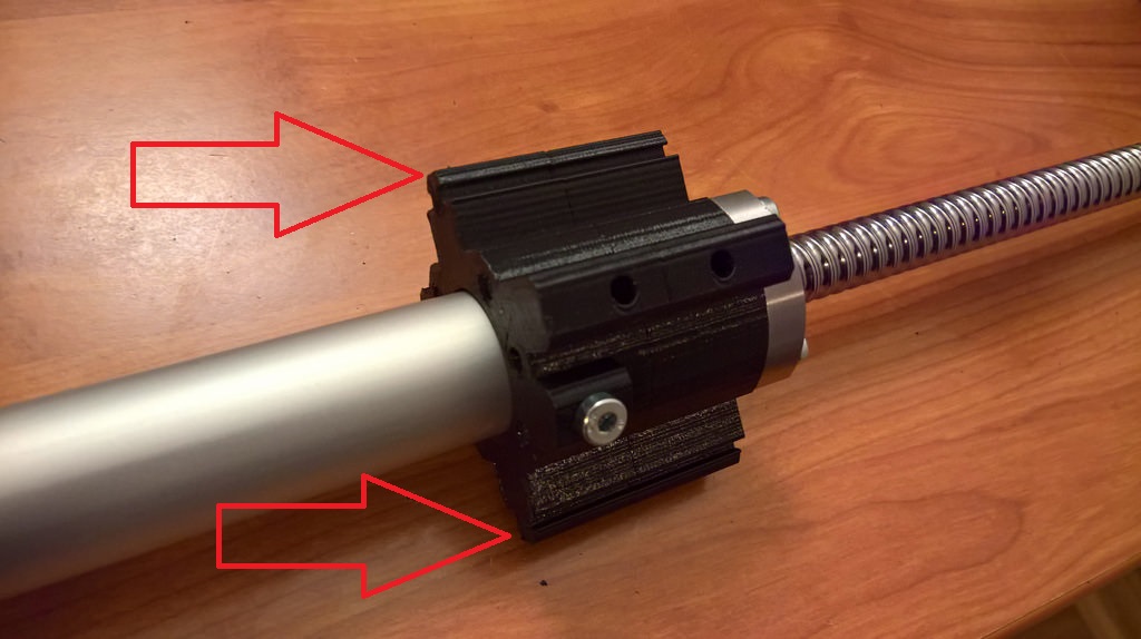

    Currently I have made a 2 dof platform, but my desire to make a 6dof calls me :)
    Seeing this project draws my attention.
    I have some doubts about the actuators.
    The profiles used are not designed to withstand the slippage of PET-G plastic. Is it cirerto?
    Does PET-G plastic support the friction of friction by the profiles?
    I attach a photo
    The printed parts. Are they 100% solid?
    Thanks in advance and congratulations on the project.

    Hi, sorry for the delay answering.
    Yes, they are solid PETG, and they slide well in the AL profiles.
    But make some printing tests if you want to follow my design.
    I had no problems with friction util now.

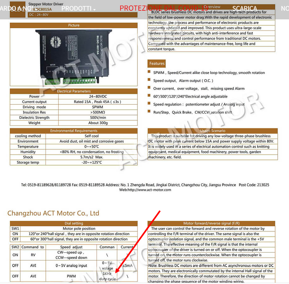

    I have a very important question:
    I would like to buy BLDC-8015A drivers, but I read from the official characteristics that the PWM duty cycle is 1Khz.
    I have a 15Khz PWM signal, can I use it anyway?

    Depends on the motor ccontroller you have.
    What is done here, is for the BLDC8015A

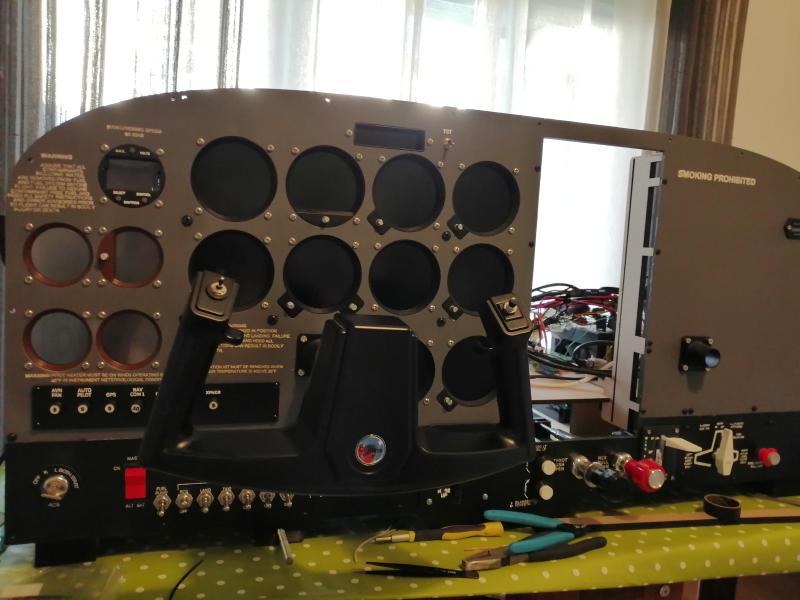

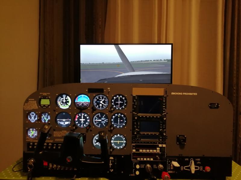

    Hi
    What is the max weight this project can accept ?
    Thank you, I'm just thinking in a 6DOF platform for my Cessna 172 Cockpit
    Congratulations about this very good project

    Hi all
    Does anybody tried to use the motors 57BLF03 to make this project ? Does it work well ?
    Thank you

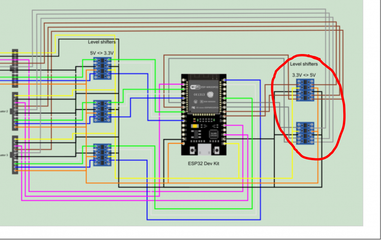

    One thing that might be useful if you are using ESP32 and BLDC8015A - in the circuit shown for the ESP32 there are 5 level shifters. I found that it works better if you only use 3 level shifters (for the hall signals only). The two other level shifters on the right (circled in red) are for the PWM and the Direction, and it seems like the BLDC8015A will accept these signals as the 3.3v output from the ESP and doesn't need to be shifted up to 5v. This made a big difference, especially to the speed of the 57BLF03 motors. With the level shifter on PWM, I could not get 3000rpm from the motors because the level shifter seems to effect the width of the pulse. Without the level shifter, the motors work much better.

    Thank you so much.
    I'm starting to develop it, I'll be using the BLDC8015A also.

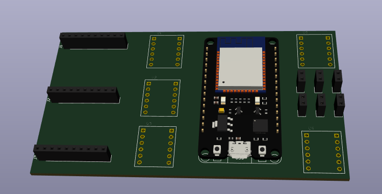

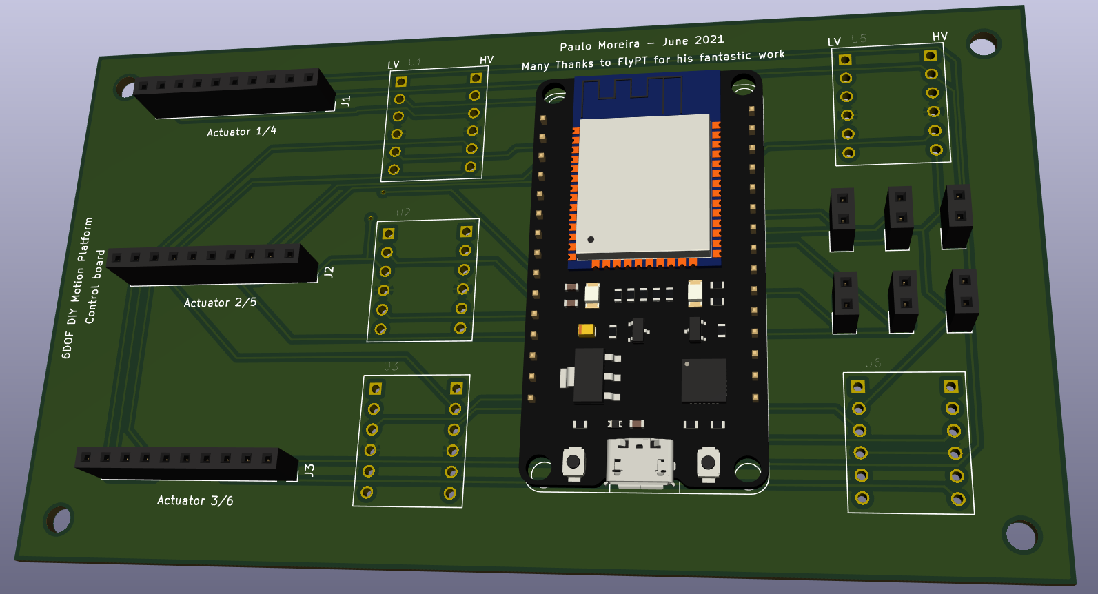

    Hi All
    I'm just creating the PCB controller boards for this project on PCB, after finishing it I'll post here the gerber files for the guys that would be interested. I'm puting also some jumpers if anyone want to try with the right Level shifter and without them.
    Cheers
    Paulo Moreira
  20. fcppenta
    fcppenta New Member
    Feb 2, 2021
    11
    65Coins
    +11 / 0 / -0
    Hi guys
    Attached is the zip file with the gerber files to fabricate the PCB. Note that the J4, J5, J6, J7, J8 and J9 will be used only if we don't want to use the 2 Right Level Shifters.
    I just have ordered 5 pcs at jlcpcb.com. Never tried them before, let's see how does it go.
    Another note, the 3 left level shifters, the orientation is with the LV on the left side, there is a LV and HV markers on top on the PCB side Silkscreen. The 2 on the right side are the same orientation.
    The pcb size is 70x123 mm
