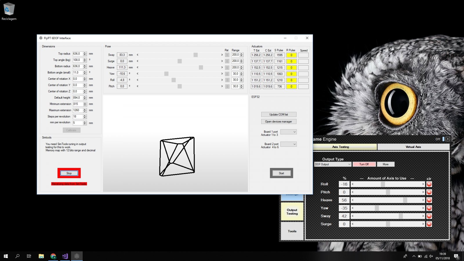

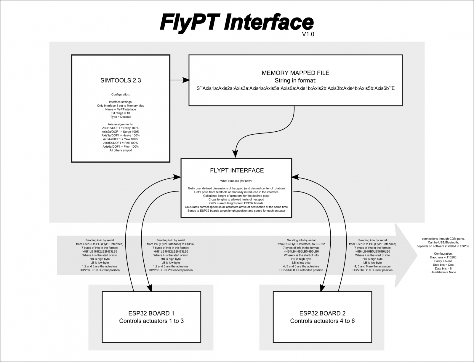

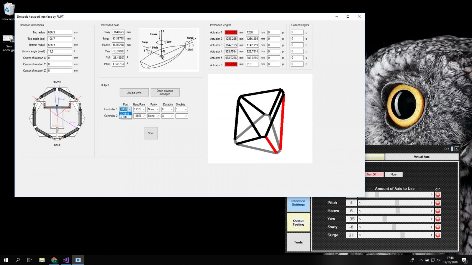

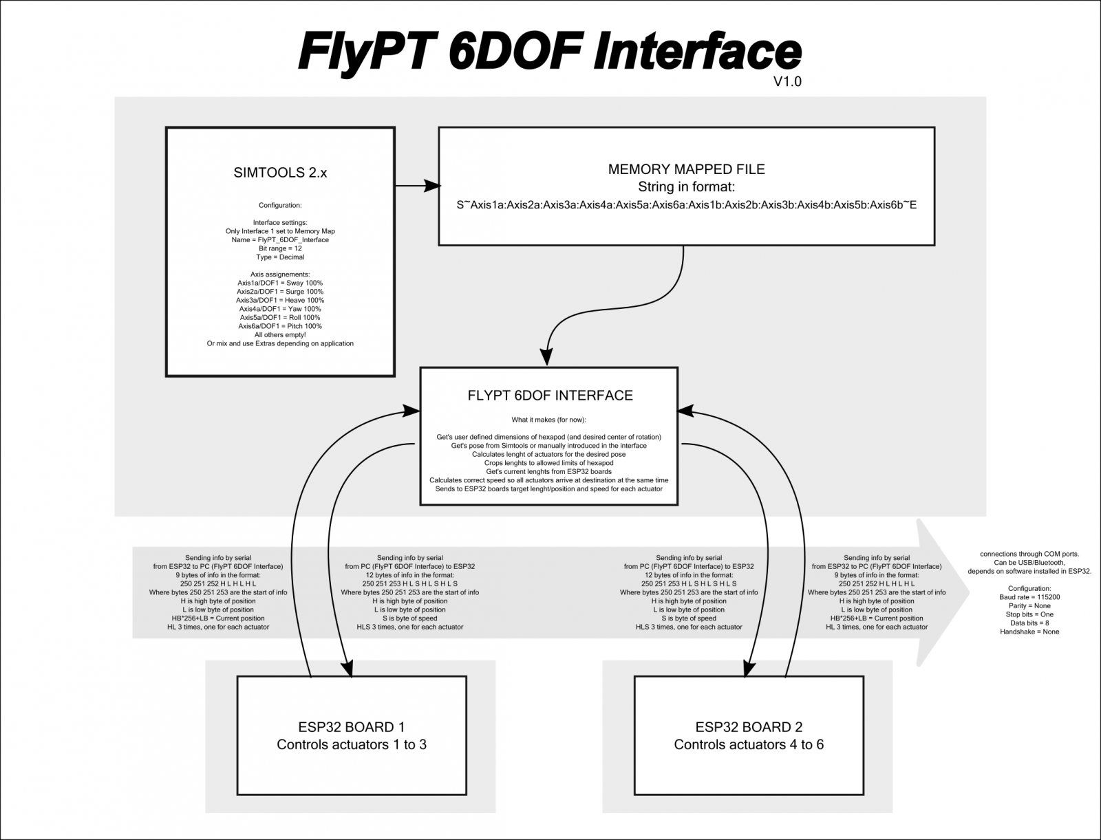

    Trying to make an interface between work times...
    Well it's something to stay between SimTools and the ESP32's.
    It gets data from SimTools by a memory map.
    It also receives some information from the ESP32's with actuators current position.
    Then makes some calculations for inverse kinematics and speed calculation, sending pretended position to ESP32's.
    Not totally working. Missing some parts between the interface and the ESP32's.
    But it's getting there.
    In the image, the red actuators are beyond limits, so it's an impossible pose for my actuators (3D drawing needs work).
    Why make this?
    -Easier to make some C# code and test than make ESP32 code and test... I have to be in the garage
    -Can collect info from all actuators from the two boards
    -Leave this load on the PC, specially to add some filters and speed calculation
    But the bad part is:
    -Add some extra delay
    I'm also thinking of using serial over Bluetooth. One of the advantages of the ESP32, but in my tests, I'm having trouble to disconnect and reconnect. Needs more testing, because when it works, it works well.

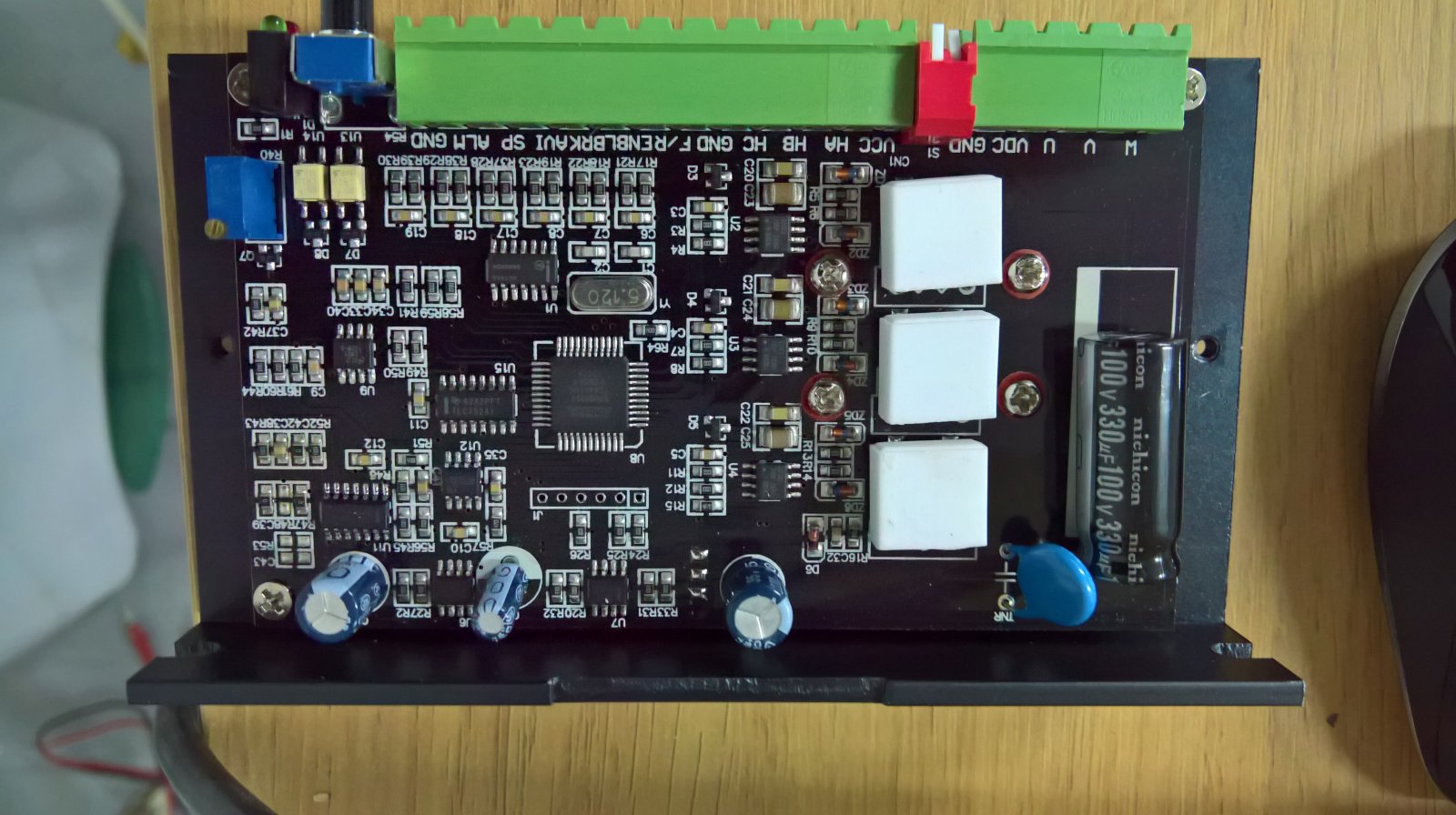

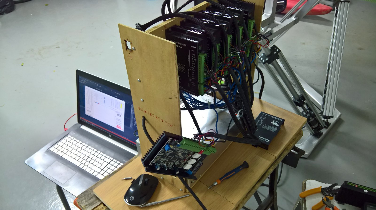

    Have you seen the Hexpod software for the AMC1280USB? (http://hexpod.xyz)
    I've been playing with a Chinese bldc controller like the one you have. It's no good.
    The controller has a fixed soft start function and it takes about a second to switch directions and after that it takes some time to get up to speed.
    I've now ordered an other controller, the ZS-X11D. Will let you know the results.

    I'm aware of Hexpod, but I like to do my things and experiment... :p I'm a bit on the crazy side.
    What model did you try? I have no problems changing direction or getting speed.

    I love that you're making your own software. Just wanted to know if you knew the project. ;)
    The controller I used is the JYQD_V6.3E1.
    I will try the ZS-X11D next. If that doesn't work I'll order the wantai controllers.

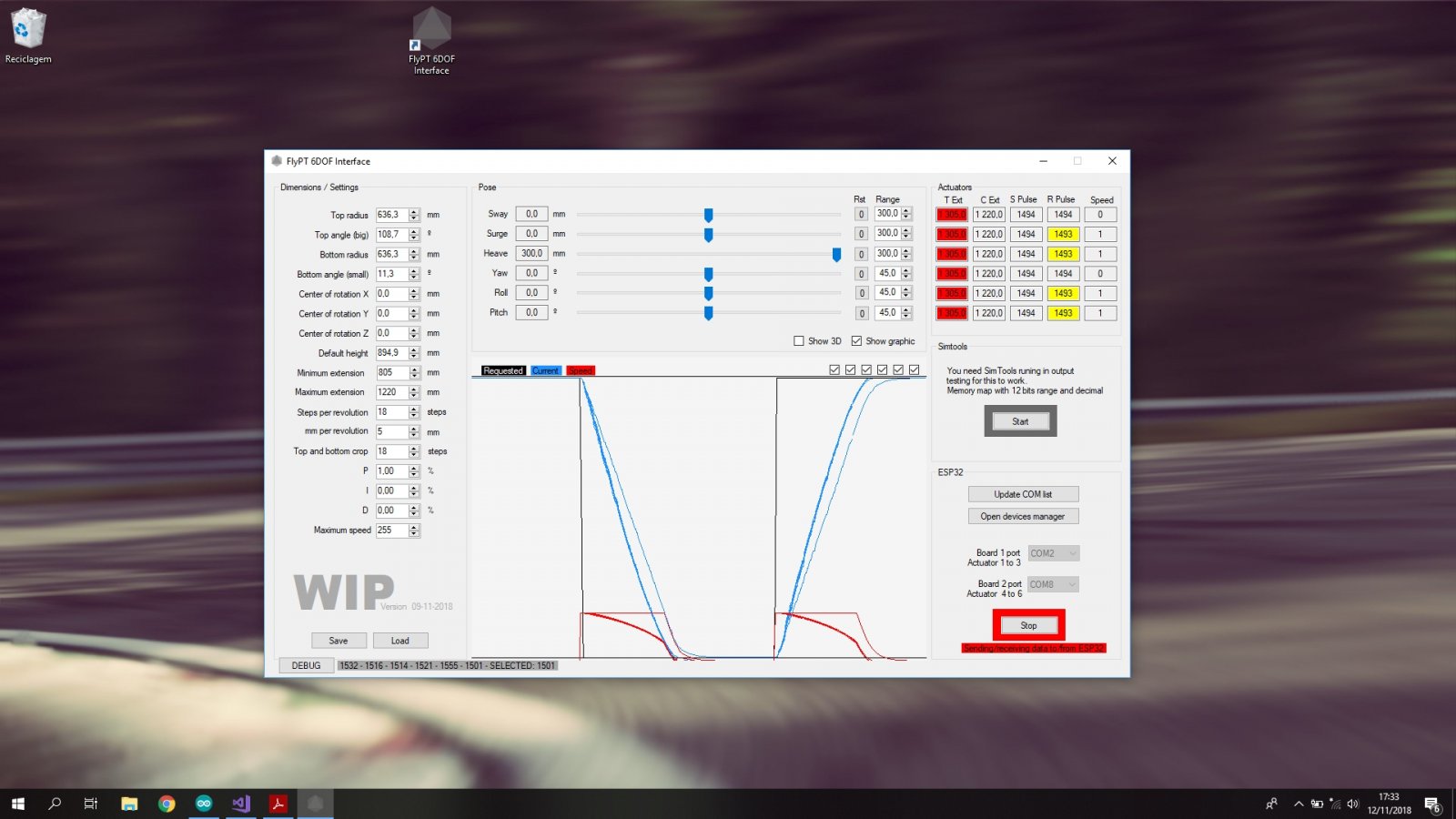

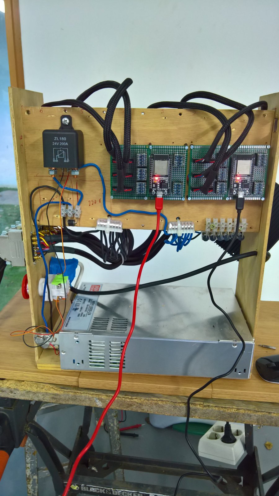

    Had some work to be done, and less time to dedicate to the motion rig.
    But here's some news:
    After some more profound tests, I found some problems:
    -Slower actuators have nothing to do with controllers.
    It's just lack of power from the PSU.
    So I need another one or some batteries. In reality, what I need is some €€€. :eek:
    -Making my interface, I found some electronic problems.
    My code was made to handle direct input from SimTools, so I mapped a range of 0 to 4095 into 0 to maximum_travel.
    This was hiding a wrong calculation of maximum_travel. The result was two actuators with less resolution, since they had 1/3 of the correct value.
    Now that I send absolute step position, I found two actuators travelling much less than the others???
    It was some bad contact in my boards.
    This was solved, so I also decided to change the voltage used for the hall sensors. My motors work with just 5V, so instead of 15V from the controllers, I use the ESP32 5V voltage.
    This put's less stress in the level shifters, that although they worked, they could misbehave with a voltage beyond the specs.
    I will update the schematics as soon as I can.
    -Until now and since I was mapping the values I never took a good look at the steps per turn.
    I was wrong :oops:. I have more resolution than I thought.
    Steps per revolution are given by:
    Electrical_angle = Number_of_poles/2 * Mechanical_angle
    In a 6 pole motor we have 6/2*360º = 3*360º = 3 electrical angles per mechanical revolution
    Since we have 6 step in each electrical revolution, we have 3*6=18 steps in each electrical revolution
    Nanotec DB59 - 6 poles - 18 steps per revolution (the motor I use)
    ACT/Longs/Wantai 57BLF03 - 8 poles - 24 steps per revolution (alternative cheaper motor, more resolution, but slower)
    So in reality, I have 18 steps for 5mm travel witch is a resolution of 0.28mm.
    -Changed the way calibration works.
    I was looking for minimum and maximum when switches where activated.
    Now I'm looking when they are released.
    I also add a tolerance, to avoid activation of switches in normal use.
    I keep checking if they are activated. In that case, position is corrected to minimum/maximum and travel is stopped.
    I'm also working on the interface that as a new look:
    More news soon, maybe with a new video...
    Edit: Replaced image with latest version. It was an image of a previous one, very similar but only int's, less dimensions and 10 bits from simtools...

  14. pmvcda
    pmvcda aka FlyPT
    Nov 3, 2010
    2,272
    Portugal
    15,902Coins
    +2,716 / 18 / -0
    Yes, it's English.
    Changed to Extra1, because Extra1 is rear traction loss.
    I don't want the rig to point the North/South direction (value given by LFS to Yaw).
    That way, Yaw on the rig is the rear traction loss.
    With my interface, you use SimTools like you use in your case, but the axis output, instead of thinking of them as actuators, they are the pose: yaw, roll, sway...
    My interface then picks those values and converts them to actuator positions.
    So in my case, Actuator 1 in SimTools is sway on the rig, Actuator 2 in SimTools is Surge and so on.
    Certainly you can still mix what you want for each of the 6DOF.
    Besides calculating the positions of actuators for that pose, my interface also receives current positions and calculates the speed for each actuator.
    Advantage is that in a pose change you make each actuator arrive to destination at the same time even if one travels 50mm or 200mm.
    Also, I need the interface to get info from all 6 actuators, since I have to use 2 ESP32 that don't communicate with each other (although it's possible).
    So my current ESP32 code (like Arduino) is really simple.
    I just get a desired position and speed from my interface.
    I apply that to the controller.
    I also read the position to send to the interface.
    I will post the Arduino code after some cleanup, but it's really basic.
    Only special thing in the code, is the use of the second processor/thread to determine current position and the associated algorithm that uses tables to not loose position.
    I already have more speed. But in that video I had a lower maximum speed and I used a low P value so it was way softer and with a delay.
    Increasing P will be way faster and violent. I show it in the video, but not for big values.

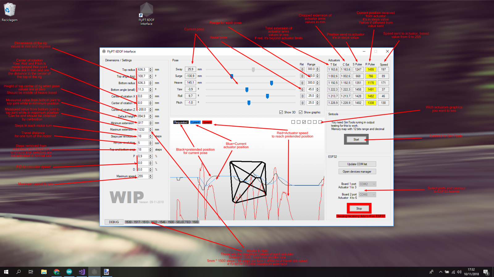

  15. pmvcda
    pmvcda aka FlyPT
    Nov 3, 2010
    2,272
    Portugal
    15,902Coins
    +2,716 / 18 / -0
    You can change everything while in motion. Even sizes, and that has no logic to be done (maybe minimum and maximum extension).
    When I start the ESP32, first thing they do is calibrate the actuators.
    I search minimum. It's when the switch is pressed and make that position zero.
    Then I go up and count steps until switch is pressed and make that the maximum.
    But it doesn't end here.
    I send the values of each actuator to my interface. You can see them when I press the DEBUG button in the lower left of the screen.
    In the interface I select the lowest one and recalculate the maximum length of the actuator, based on 5mm per turn and 18 steps per turn (for my motors).
    So min length is a measured value in the rig, when the rig is at zero position and maximum is the minimum plus the calibration value.
    I don't know if this was implemented in the video already. I think so.
    You can change maximum if you want, but after calibration, if you have the interface connected, maximum is updated.
    I also have another value that I call Top and bottom crop. That's the number of steps I want to remove from minimum and maximum to ensure switches are not activated.
    So for the interface, minimum becomes that value and maximum is subtracted of that value.
    Why?
    Because the ESP32 has a safety code that makes position zero/maximum when switches are activated.
    Resuming:
    If minimum is 0 and maximum is 1500 sent by the ESP32 calibration and if top and bottom crop is 20.
    Then the interface sends to the ESP32 values between 20 and 1480.
    Now, if in the ESP32, one of the switches is activated because of some drift in positioning, position is immediately corrected.

    Solved the different speed problem! :D
    First I said it could be the controllers...
    Then the PSU...
    So, again, I changed everything, connected, disconnected and the problem was:
    The controller!
    So I remembered that some time ago I burned one and took a look inside.
    In one corner there was a small pot...
    Yes a pot!
    With the help of my Interface, I adjusted the pot's of the controllers that where slow and VICTORY :cheers
    So here's the inside of a BLDC8015A (pot at top left in blue with a screw R40):
    Turn right, faster.
    Turn left slower.
    I used my interface and moved the rig up and down (heave).
    That makes actuators move the same length.
    The blue lines are the current position and the black ones the requested position.
    We can see the actuators that lag.
    Graphic before adjustment (only one actuator left to adjust):
    And after adjustment (all actuators):
    I also received a ZL180 24V 200A relay.
    Mounted it on the emergency switch, so now it's safer and more durable.

    Updated electronics schematics in first page.
    Also added the latest video (removed the older ones)
    Added info about the interface program with updated diagram:
    One of the changes was the bytes sent as start of info.
    This sequence of values only happens if I send them. Never as a composition of position and speed.
