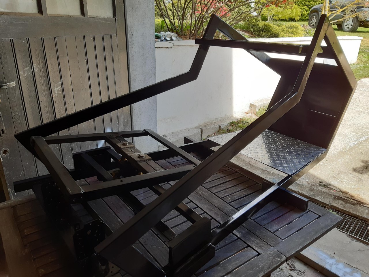

    Today I have to dismantle my installation
    since it works in Manual to paint the chassis. Then I would install the material in the final clean and try this time to make it work in games.

    2DOF, 3DOF, Arduino
    Today I took advantage of the dismantling for also paint the keys in red. I think that I might have to make a protective casing for the moving parts in case ...
