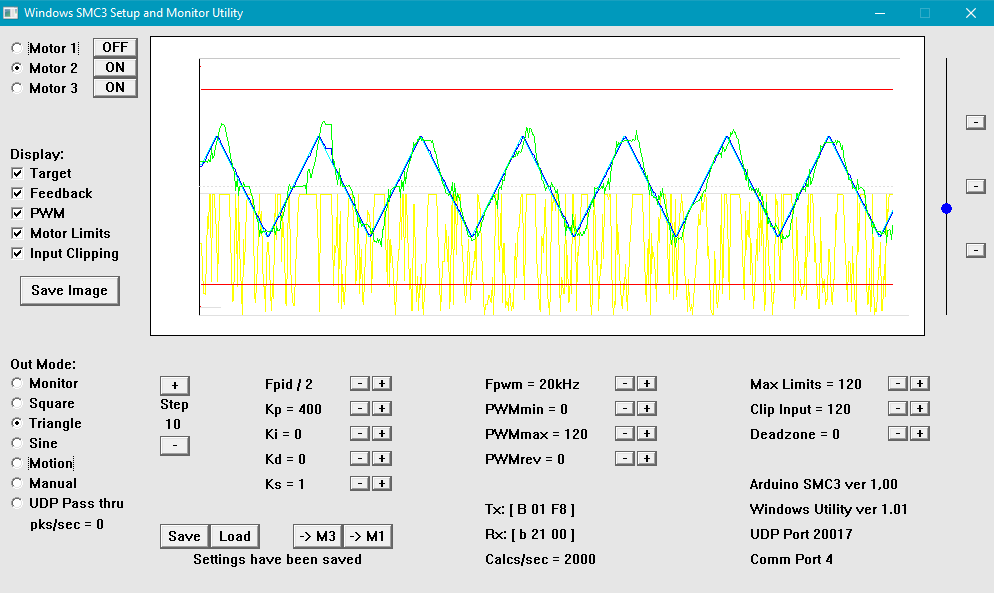

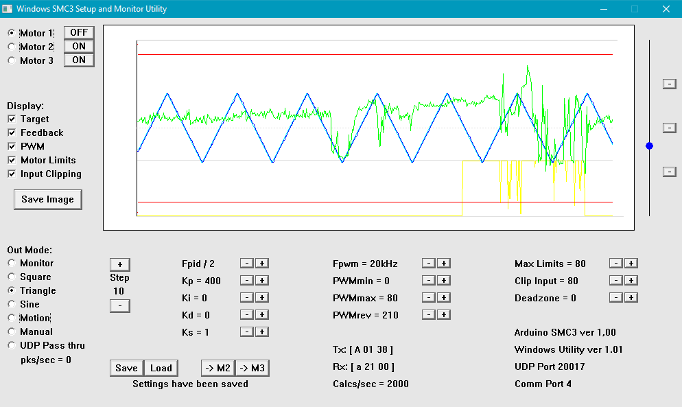

    Here is my update:
    Motors are running with SMC3. But some way strange.
    Motor 1 starts with enormous spinn and sotops ´cause of overturning.
    Motor 2 works but the feedbackline ist strange (see pic) and the Motor shakes during the movement.
    Hope i can get a Video tomorrow.
    Any ideas?
    Thanks,
    Martin

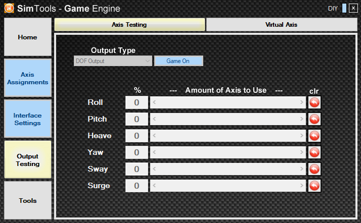

    Hi @all
    Some update on my Seat:
    In winutil everything works fine.
    In Simtools manual slidermovement moves the Motors.
    BUT: If I start LFS to Test nothing happens. I Set Up everything along quickstart Guide. I turn on virtual Axis, start the Game and..... Nothing!
    What do I forget?
    Is there Something to be set in the Game?
    Thanks Martin
    22,045
    153,866Coins
    +11,154 / 57 / -2
    Please post your SimTools Interface and Axis Assignment settings.
    LFS also needs to be run for a couple of laps before it is patched for motion. So if you had not run it then unpatch LFS, run some laps and then repatch.

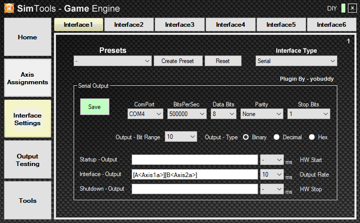

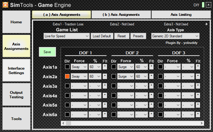

    216Coins
    Hi here are my Screenshots:
    I tried racing 3 laps but nothing happens.
    As I saide bevor if I turn off game and do some Output testing my axis move fine!
    At the Moment I start the game, everytrhing stopps.
    Hope you can help me.
    Thanks Martin
    22,045
    153,866Coins
    +11,154 / 57 / -2

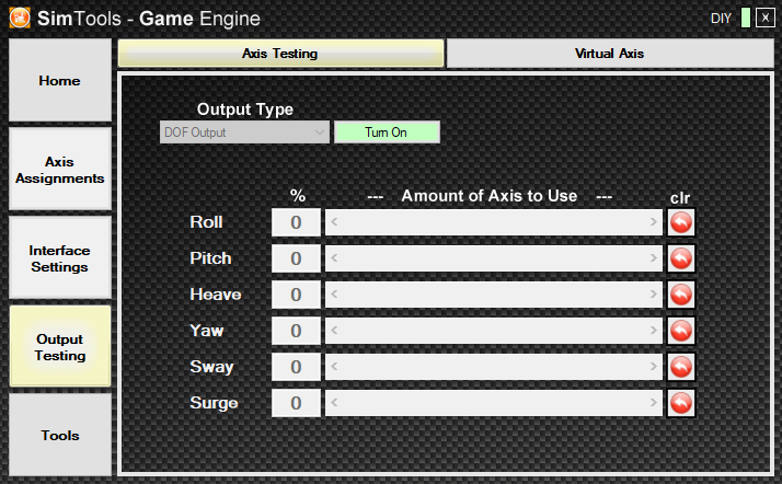

    If output testing works does Game Manager turn blue while LFS is running?
    If so then unpatch LFS, run some laps and then repatch.

    So. I did some laps. But nothing happens. Output testing is bleo.
    Any ideas.
    22,045
    153,866Coins
    +11,154 / 57 / -2
    Have you got SMC3 working correctly?
