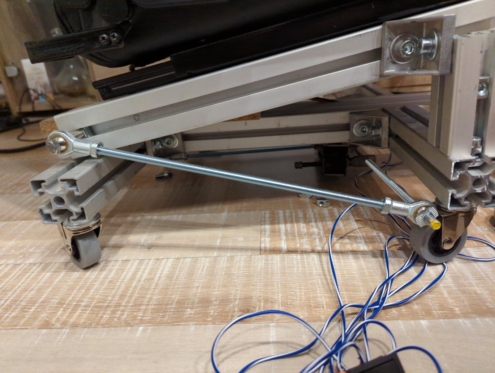

    Hello guys,
    I would like to ask you to help me to find the right way for making my motion Sim.
    I want a 3 DOF (pitch, roll and heave) + surge and Traction loss.

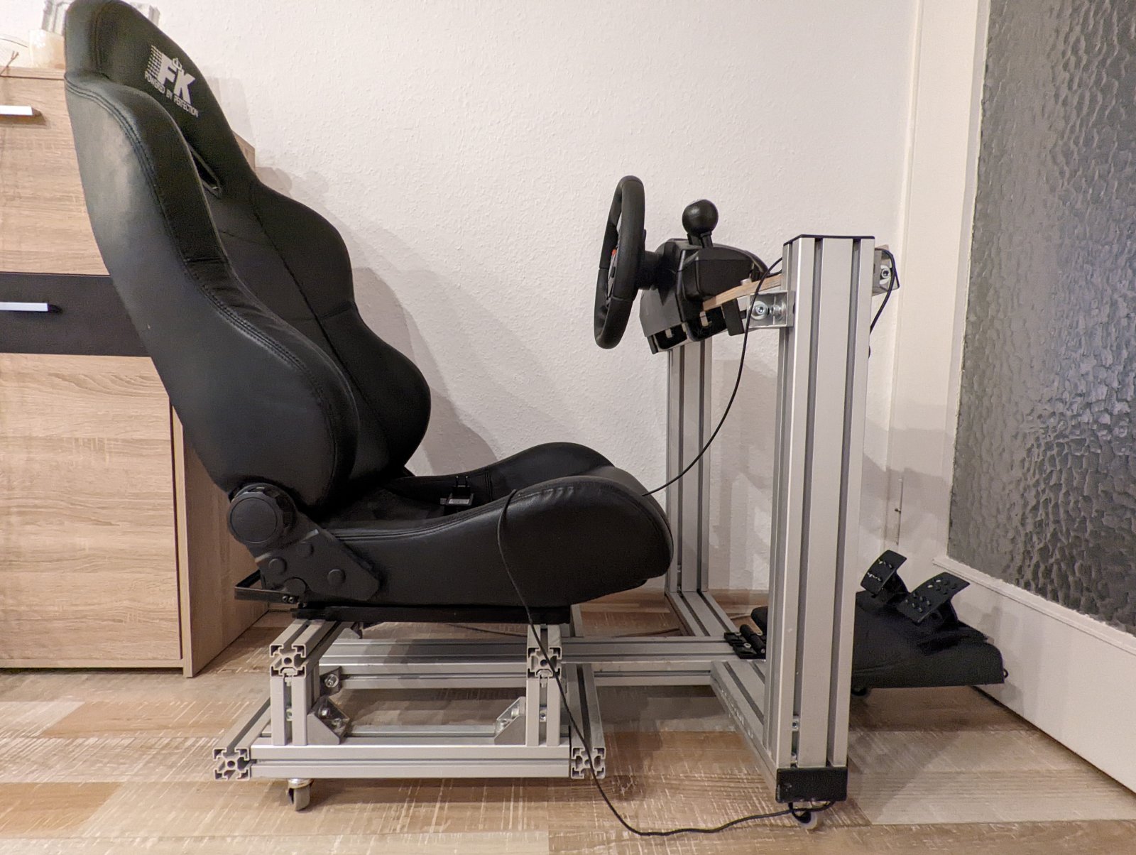

    Here are two Pictures of my current simrig build from 2010.
    compact base 80cm
    exdented base 120cm
    First of all, I would like to know how I can calculate how powerfull the motors have to be: nm, W and what the hell is the difference from a 1:50 to 1:60? At the days of 2010 I have read about truck wiper motors. Know I am read ing about motors with 400W plus each.
    Iwould like a compact base like noorbeast`s https://www.xsimulator.net/community/threads/dx-compact-simulator.5866/ and with 32:9 screen like Cameron Olsen´s rig and lovely traction loss. https://www.xsimulator.net/community/threads/my-3dof-motion-simulator.15994/
    Is it posible to configured the sim, that if the car is accelearating the surge effect have to go to the front and pich to back and if the car is breaking the surge to back and pitch to front.
    The base of the sim have to be max 100cm length and 60cm with.
    I am not sure how to realise the surge and the traction loss. At the moment I think the easist solution for the traction loss i another motor like Cameron Olsen have done. But for the surge I am not sure, I suggest me to use drawer rails with 2 or more 60kg servos.
    So far I know, that I can use up to 5 Motor with one Audrino Uno and 2 for each Sabertooh. Than i need to fix the poti for the hall, have to power supply and need basic electric skills. Luckly I am work for commissioning from plants with big 400V motors and inverters plus programming of PLC. So I think I will be know ready to realise my dream after 12 years...
    I would like to ask to, if the PS4&5/Xbox Series X transfer the telemtry data in the network the simtools will work too?
    I would like to ask if the codemasters F1 2021 (PC) is compatible with the simtools, because I can not find in the list.
    And I would like to ask you how to start. Sorry for my englisch, if somebody is from Germany can help me over PM.
    Otherwise I am thrilled to read your suggestions and answers.

    You can use SimCalc and/or Motion Visualizer to get your head around the trade offs in Design Vs physics:
    https://www.xsimulator.net/communit...e-linear-speed-and-forces-of-your-design.270/
    https://www.xsimulator.net/community/faq/motion-visualizer.389/
    A compact design requires lots of torque and the minimum mass you can get away with. Personally if I did a similar design now I would likely go with servo motors.
    Traction loss needs a pivot near the feet, so a base frame is required and given that there is the possibility to consider other design options, like foot mount motors, which provide more inherent design leverage.
    See the Console section of the FAQs for an overview: https://www.xsimulator.net/community/faq/consoles.27/category
    F1 2021 plugin: https://www.xsimulator.net/community/marketplace/f1-2021.254/

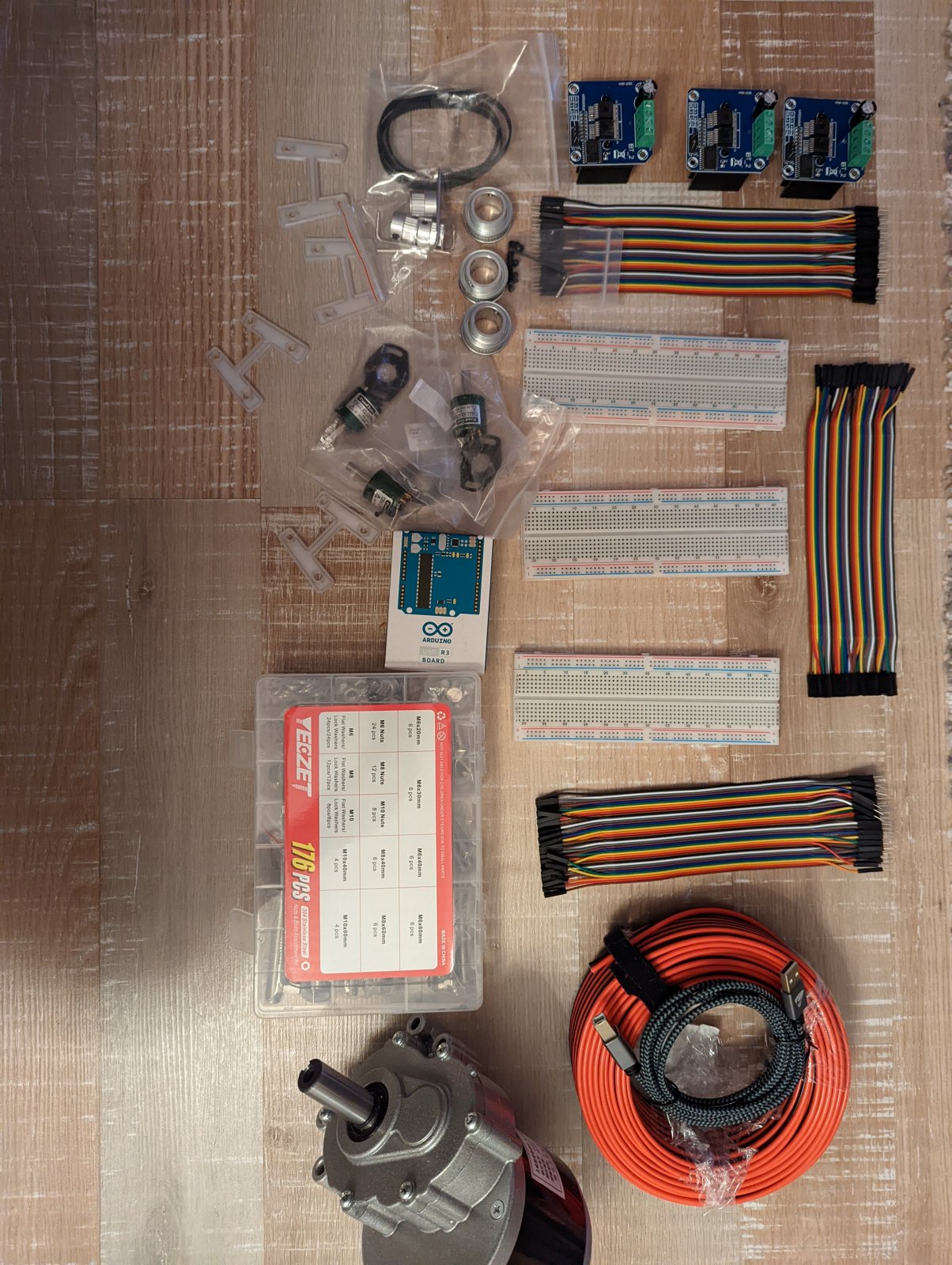

    Hello again,
    first of all I would like to inform you that I found the motors that I want to use and they will arrive today :)
    I would like to build a motion rig with most parts of SCK Gaming aka scruck tutorial and add traction loss system. But I want to build a full motion instead of a seat mover.
    I Also be highly inspired from Tino's Hypersimulator, that I would like to be my rig adjustable too. So I ordered last week a power seat base from an old VW Passat B6 from the junkyard.
    As I decide to play only VR racing games, I would like to ask you if the steam versions of Automobilista 2 and Assetto Corsa are patchable and usable with simtools. The Bass shaker telemetry is working fine from simhub.
    My major questions are:
    1. how to know how the height of the universal joint has be.
    2. how all of you guys decide to put he motors behind or in front of the joint.
    3. how long have to be the rods?
    4. what is the difference of the DIY licence?
    Thank you for your support.

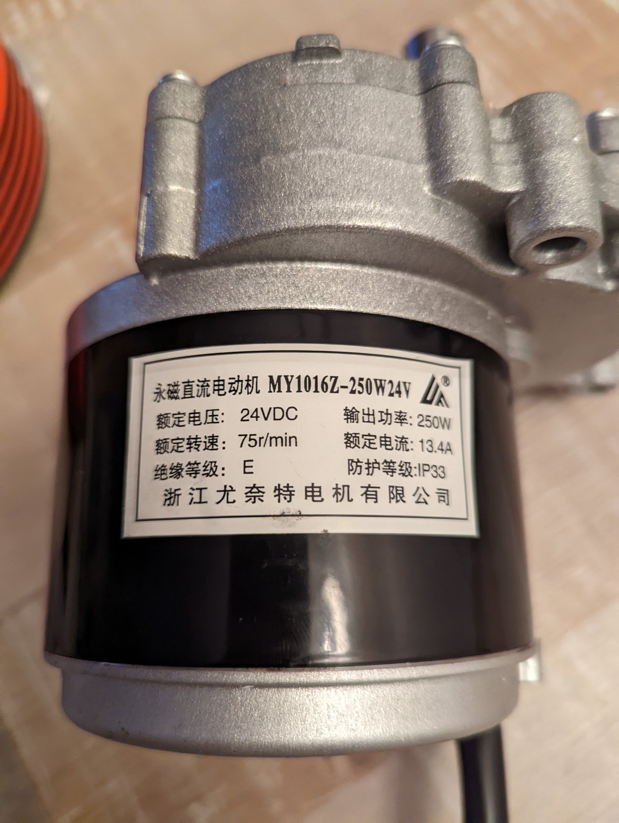

    What are the specs of the seat motors you ordered, are you sure they are it for purpose spec wise?
    Most plugins are developed for Steam versions, including Automobilista 2 and Assetto Corsa.
    1. That depends a lot on the actual rig design and if it is a seat shaker (needs less clearance so shorter Ujoint) or full frame (needs more clearance so longer Ujoint).
    2. That is a design decision, sometimes made for aesthetic reason but probably more so around space constraints
    3. Depends on your rig design.
    4. SimTools has its own team and website, see here for license/functionality differences: https://simtools.us/licenses/
    There is a Design section in the FAQs, which is a stepping off point: https://www.xsimulator.net/community/faq/design-considerations-resources.24/category
    In particular have a play with SimCalc and/or MotionVisualizer to get your head around the tradeoffs in design Vs physics, including how that links to a desired performance and the motors needed to likely drive it.

    The specs are:
    Wheelchair
    24V DC
    13.4A
    75 RPM
    250 W
    Do you think, that 3 motors can go with 3 DOF without universal Joint?
    Yesterday I was trying the the calc in metric unit m but the calc prompt the error, that I have wrong values. Probably because the xyz position of the rod and motor was below 1. But there is m and this is for me unit meter instead in setting metric of in fir inch in imperial setting.
    I think I will go to try and error.
    I would like to add in front 2 motors on the wheel profile and in the back the the other in 3dof, or for traction loss..
    Thank you for your Support

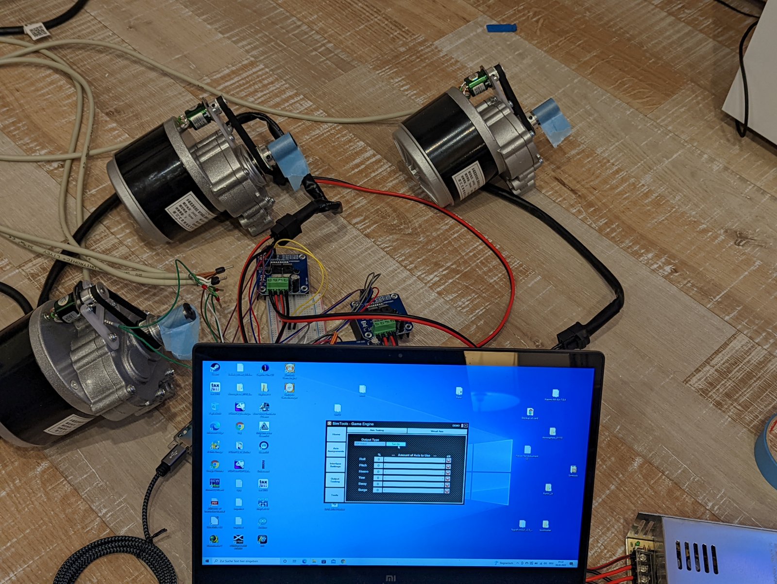

    As the motor is working on the SMC3 which you can see in the video above. I would like to ask you all, how to calibrate the hall sensor? Or where can I see the position Feedback in smc3?
    I think the lever have to be in lane with the horizon. How can I calibrate the 360 hall sensor?
    further I would like to ask if the 250W motors Are able to handle 3dof. The ctc lever have a length from motor shaft to rod 37.4mm or 67.4mm. I would like to have pitch, roll and heave if it possible.
    aswell I would like to ask if simtools offer a free demo, which works with life for spped. And how I can download. And if I be qualified to get a DIY license.
    Before I assemble the rig hopefully in the next weekend I would like to calibrate and test in simtools.

    Hello again,
    I would like to apologize that I am asking noob questions. And I am thinking, that is the reason that no more answers are posted here.
    So I read many threads and try to find the solutions there.
    So I have downloaded the simtools demo and setup the interface and 3 axis for all my three motors.
    So I patch the game LFS and and try the driving school. It's working I am so happy
    I struggle to calculate if the motors are capable to handle 3dof. The simcalc can only calculate 2dof.
    I know that the rest position have to be lever to rod 90 degree.

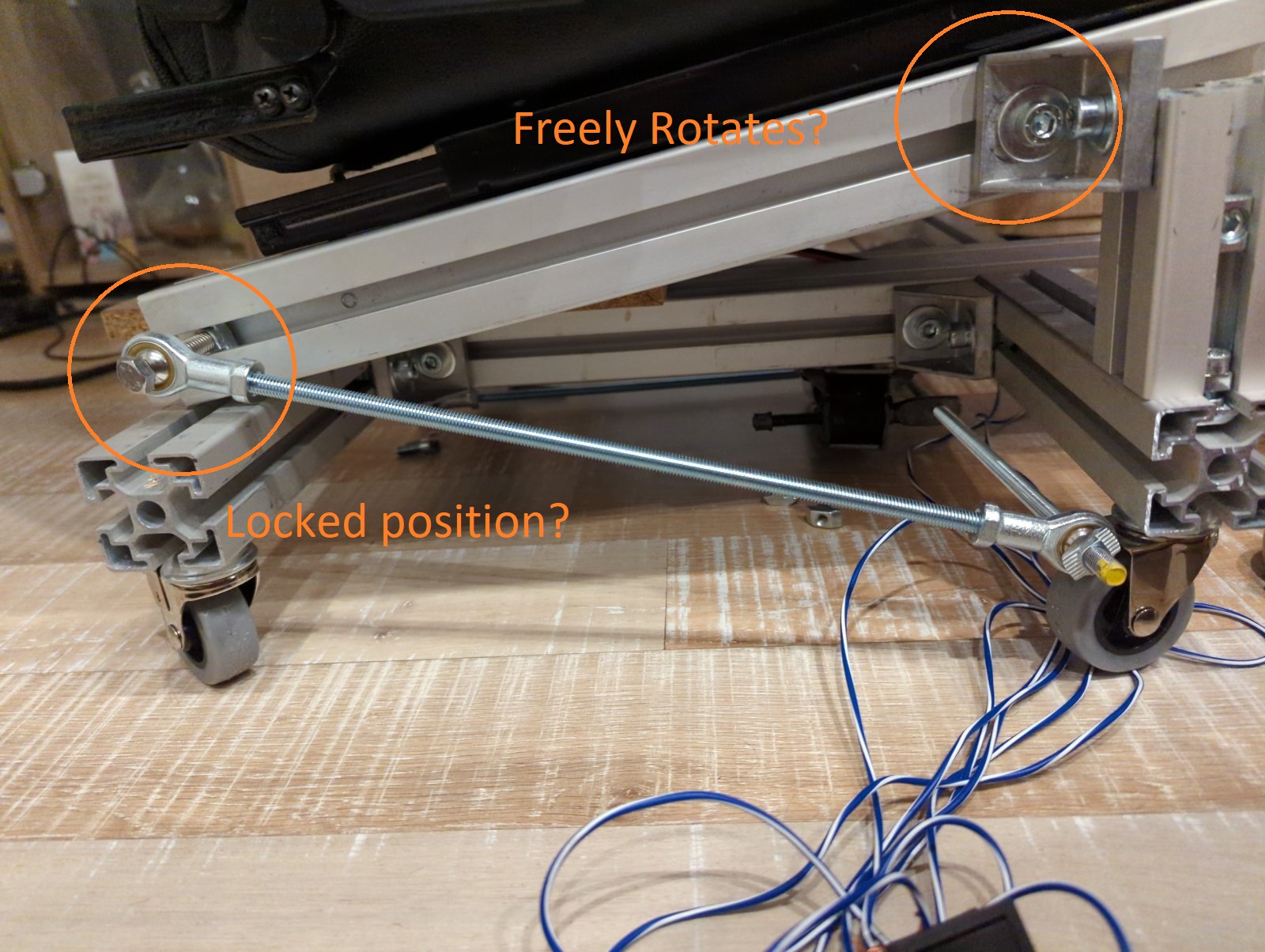

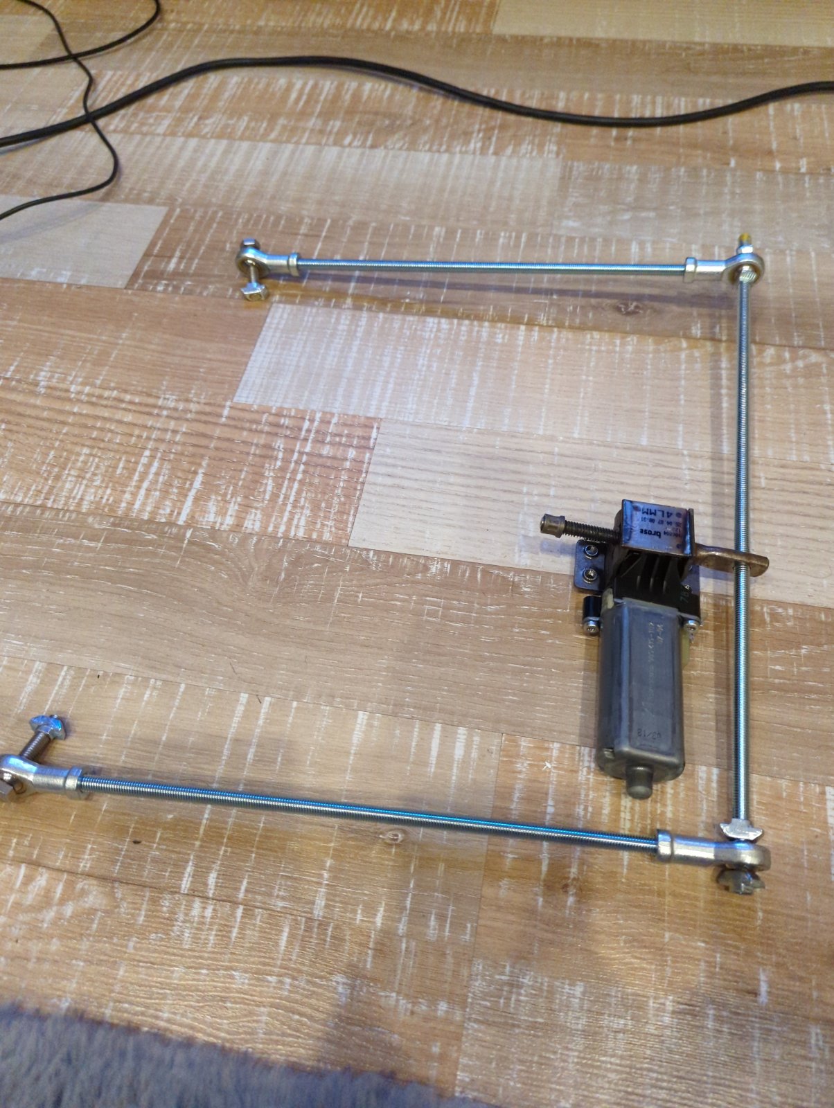

    So I need your help guys..
    I want to make the seat electric adjustable.
    The issue with I have is the design for heave the back of the seat I I want to play Eurotruck or GT instead of open wheeler.
    But I am struggle to make a simple design of it. Unfortunately the base which I have brought does not have the system vor heave.
    So I try this, to install the both rods in the back of the seat. I just want to try if the design works withput load. but don't work:
  18. noorbeast
    22,086
    154,124Coins
    +11,171 / 57 / -2
    Does the upper point freely rotate?
    Is the lower point fixed on the frame so it can't slide?
  19. Michail
    Jan 5, 2022
    176
    748Coins
    +33 / 1 / -0
    I can heave manual by hand. But it is not completely freely.
    And yes they are fixed in the back and can’t slide.
    I think I have to shrink the rod to be more effective. But general is this the right way? I can’t find information through google or YouTube. And the search here in this forum with keywords “powerseat” “adjustable seat” does not have any results.
    How I say before, I am inspired by Tinos hyper sim.
  20. noorbeast
    22,086
    154,124Coins
    +11,171 / 57 / -2
    I would have thought the simplest way would be a central perpendicular actuator with roller guides either end, or better yet a perpendicular actuator either end.
