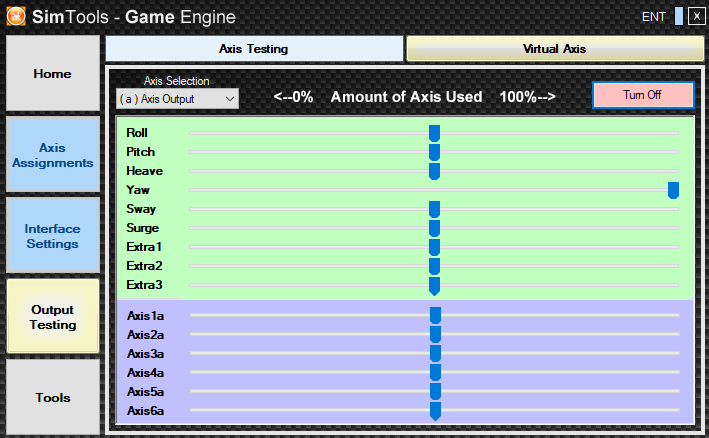

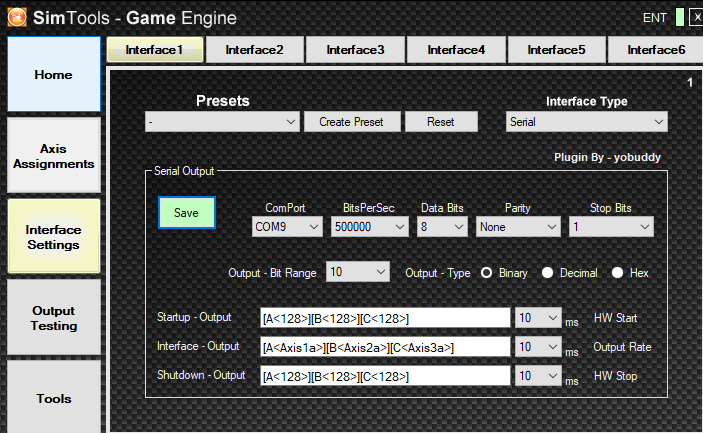

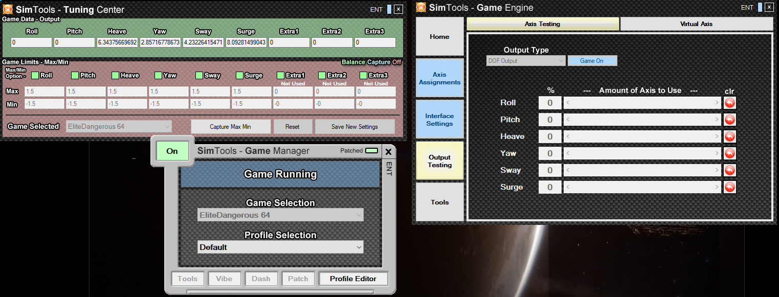

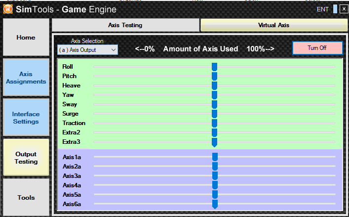

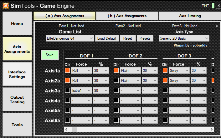

    I'm new to this, so thanks in advance for your patience. Main issue is even though game manager is connected and game engine output test worked to create motion, when I'm in game, nothing is happening. Not getting a signal during virtual output and no motion (but I DO seem to be getting data into tuning center)
    Early symptoms:
    1) game engine output did NOT work, but I ran sim tools utility to test sine wave. that worked smoothly. After that game engine output worked
    2) game manager would close out after game was started. Not sure what changed, but it now stays on (I've updated plugins, patched elite dangerous and ultra wings.
    3) unfortunately, now I'm at a point where it doesn't even recognize the com port that's connected. My situation is worse than my main issue now, I believe.
    Any help or suggestions would be appreciated!
    sim tools ed.PNG sim tools virtual output.PNG sim tools ge interface settings.PNG sim tools ge ed axis settings 1.PNG sim tools ge ed axis settings 2.PNG

    Before you dig yourself deeper into a hole can I suggest that you start with and confirm the basics before messing with ED and Ultrawings, both of which can be really tricky to setup and in the case of Ultrawings only works with a specific version of the game.
    So for starters is your rig configured to move as SimTools expects and if so does it respond correctly in OutPut testing: https://www.xsimulator.net/community/faq/which-way-to-set-simtool-axis-movements.230/
    If so download the free LFS demo and run a race in it before patching LFS for motion. Then use LFS to ensure your rig is operating as expected. Once that is done you can then move on to other plugins, and in the case of ED and Ultrawings you need to read through the respective plugin threads, as both hove potential gotchas that can trip up a new person.

    Please follow Noorbeast suggestion before you do anything, but what i can see from the tuning center is that you do have motion data from ED.
    You could use my settings, its in the post zip file.
    https://www.xsimulator.net/communit...ts-profiles-and-tips.11273/page-4#post-170908
    Remember to backup any settings you have made before you use mine. Also use the axis config and the min/max values.
    If you done it right it should be something like this
    https://www.xsimulator.net/communit...orizons-plugin-xml-edition.12955/#post-170998
    Good luck

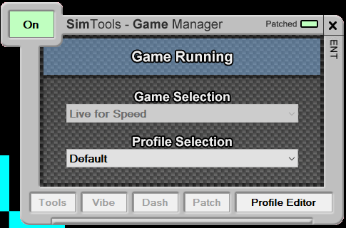

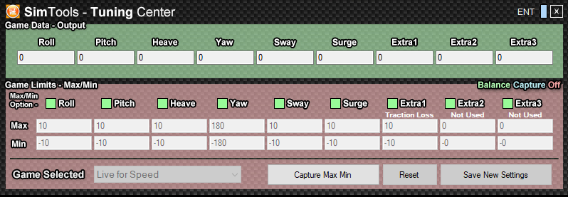

    OK. I downloaded/installed LFS. Drove through a single player race (although it didn't stop me after my 3rd lap; I had to just quit out during my 4th lap). Patched it to where it was installed Path = C:\LFS. Tried running with Sim Tools Game Engine & Game Manager running. Still no joy.
    I ran output test (before running LFS) after clearing my com ports and reassigning interface to COM3 and it didn't work again. Ran sim tools utilities, changing the com port to COM3, and sine outputs worked great on all 3 motors. Ran output test again and it worked (I believe it moved when I slid 5 of the 6 sliders). Game manager shows connected, tuning center shows mins/maxes, and game engine says game is on when the game is running. However, I don't get any movement on the virtual axis screen on the output test tab still, and obviously no movement in my chair while driving in game. I'll attach a few screen shots.
    st lfs game manager.PNG st lfs tuning center.PNG st virtual axis output testing.PNG

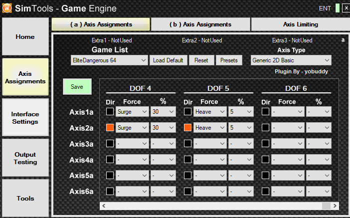

    We have JOY! As you originally suggested, I rechecked the axis assignments and (for LFS) mine had both checks on for roll and sway, and opposite checked boxes for pitch and surge. I changed it so it was opposite checks for roll and sway and both checked for pitch and surge.
    Now onto ED. Thanks so much for your help so far!

    Can you please post a picture of your axis assignments.
    What patch path did you use and did patching the game report it was successful?
