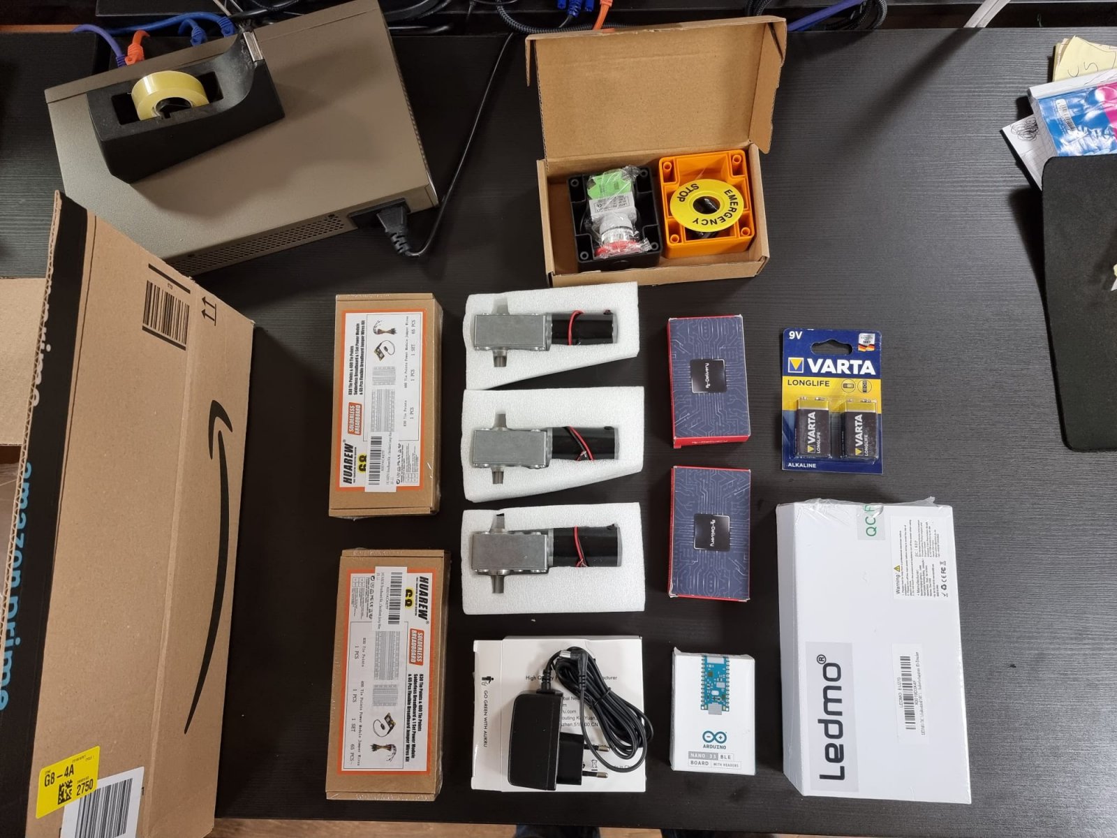

    Quick update.
    I orderder the hardware for the prototype,
    some already has arrived, some i am still waiting for. Once i have it all i will post some pics.
    One big question that keeps hunting me is regarding the orientation of the sphere. For sure the omni wheels are gonna slide a bit on top of the surface of the sphere so the rotation of the motor cannot be used to calculate the orientation of the sphere with potentiometers.
    My current plan to solve the problem is to use an orientation sensor and use that data to correct/update sim tool regarding the orientation of the sphere relative to the rest position recorded at the start of the sim.
    The idea it is to keep correcting the factor of sliding during the sim and have the motors to adjust and compensate for it. The BIG problem is how to feed that data to simtool so it can adjust the motion.
    Any idea on how to do it?

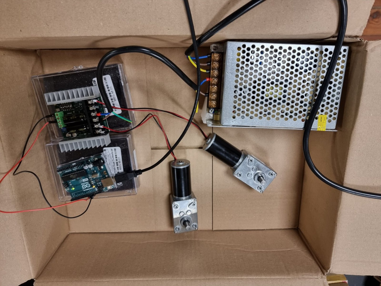

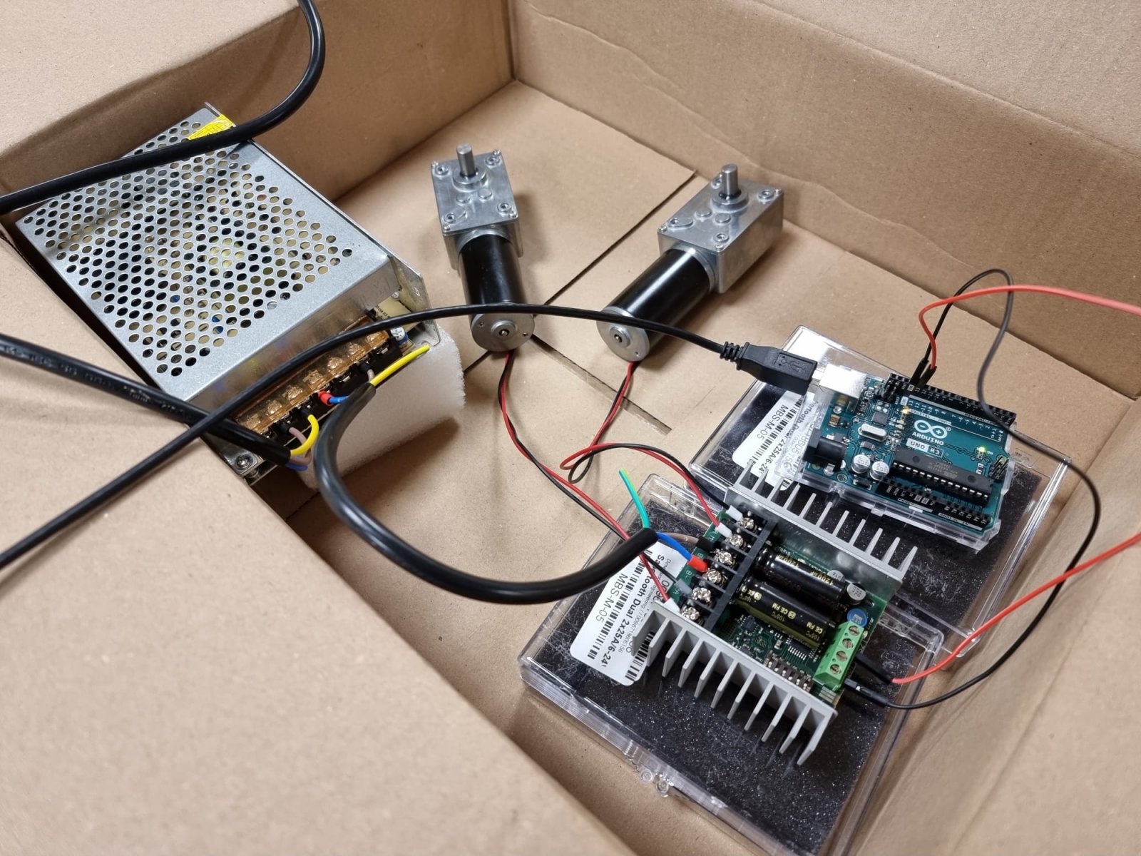

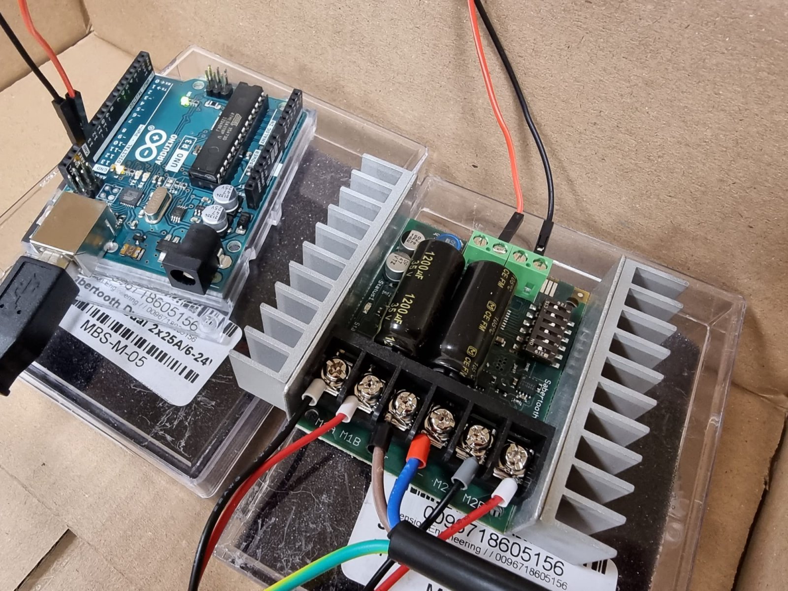

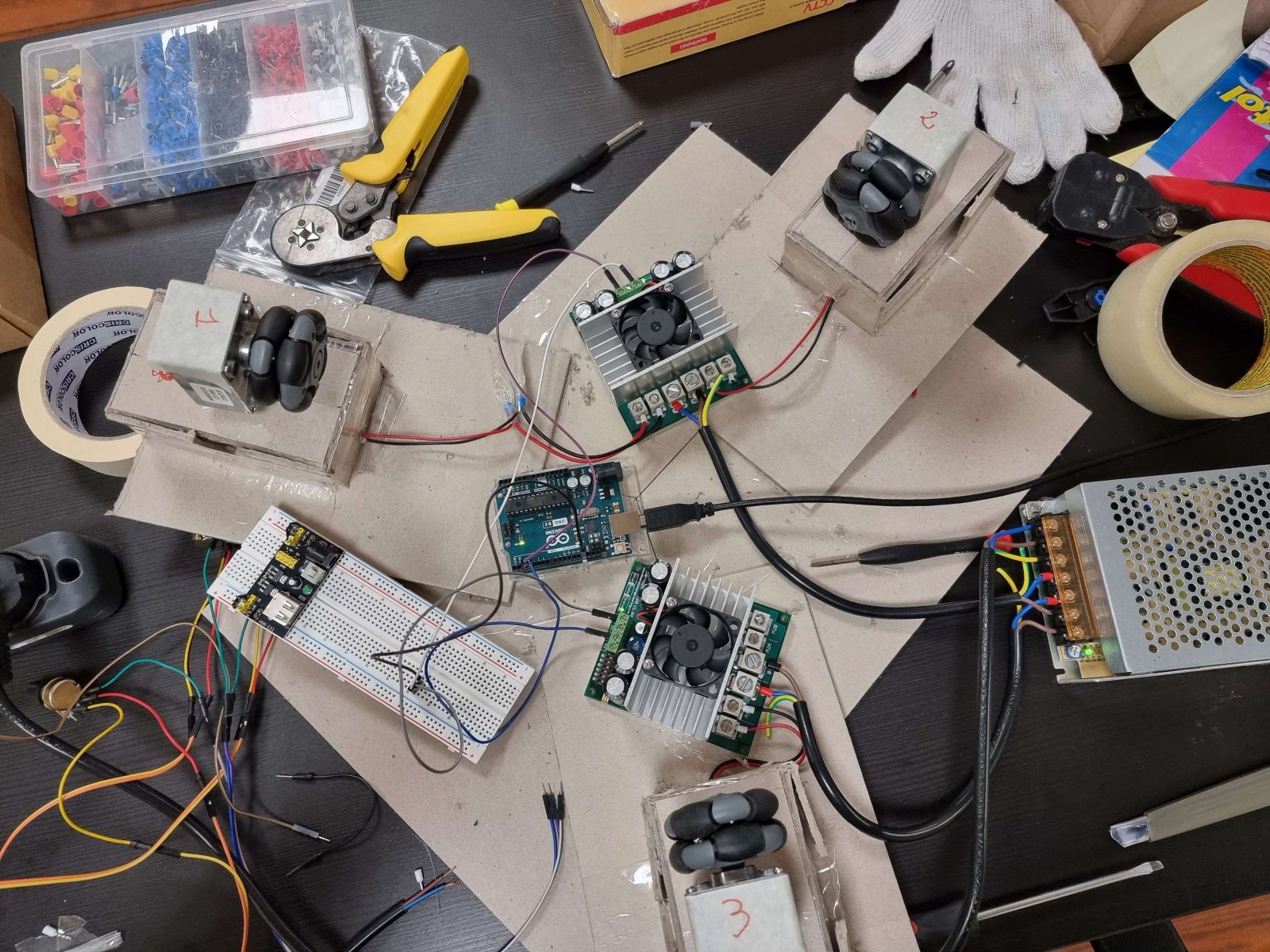

    Hi everyone,
    so as promised here some pics of the initial order and the basic setup.
    I am having some issue with SMC3 and the arduino setup. Basically when all is connected and I switch on both the AC for the motors and controllers nothing moves. As soon as I open SMC3 both motors starts to run but I cannot control any parameters from SMC3. It seems they are not responding at all. I will continue the discussion on this topic and then report here the solution aswell : https://www.xsimulator.net/communit...ial-pid-motor-driver-sketch-w-softstart.9277/
    I will keep you posted on the progress.

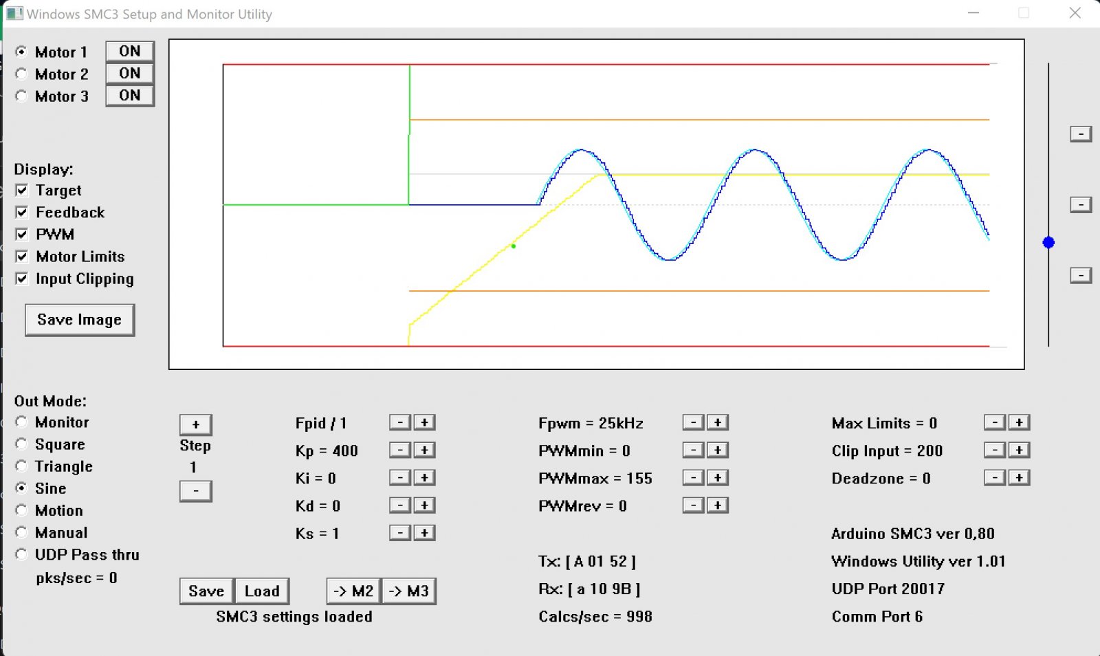

    Are the pots connected, as they provide positional feedback.
  11. Grucho
    Grucho Member
    Jan 3, 2023
    48
    232Coins
    +10 / 1 / -0
    They are not connected. Do they need to be for the controller to be able to function and control the motors?
  12. noorbeast
    21,594
    151,227Coins
    Yes the pots do need to be connected.
  13. Grucho
    Grucho Member
    Jan 3, 2023
    48
    232Coins
    +10 / 1 / -0
    Ahh ok thanks. I will put hook them up tomorrow and keep you updated.
    Thanks!

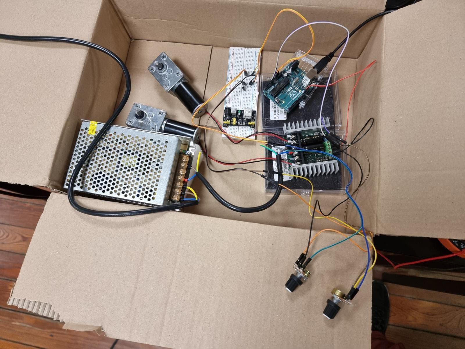

    Hi everyone.
    Here an update. So I connected the POTS as shown in the picture that follows:
    Now the SMC3 seems to be a bit more responsive. I can see that if I turn the POT the green line on the graph changes.

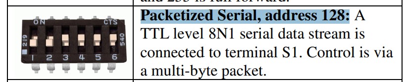

    Unfortunately I think my sabertooth has some problem with the code provided for the 2x32 and the 2x60. Mine is a 2x25
    I tried 2 different mode to run it. The first is the one recommended by the tutorial: Packetized Serial, address 128
    unfortunately with this settings I have no response from the motors.
    If I switch though to an other type of setting such as the Simplified Serial, 38400 Baud:
    This is making the motor turn, I also get a sort of control in SMC3 (i can modify the parameter and I can see that the motors are influenced) but nothing is working as expected. The motors are always on, I cannot control the power on/off button and other control don't make much sense.
    Not sure where to go from here. I try to look at the code but not sure what to change to make it work with my sabertooth if that is the problem.
