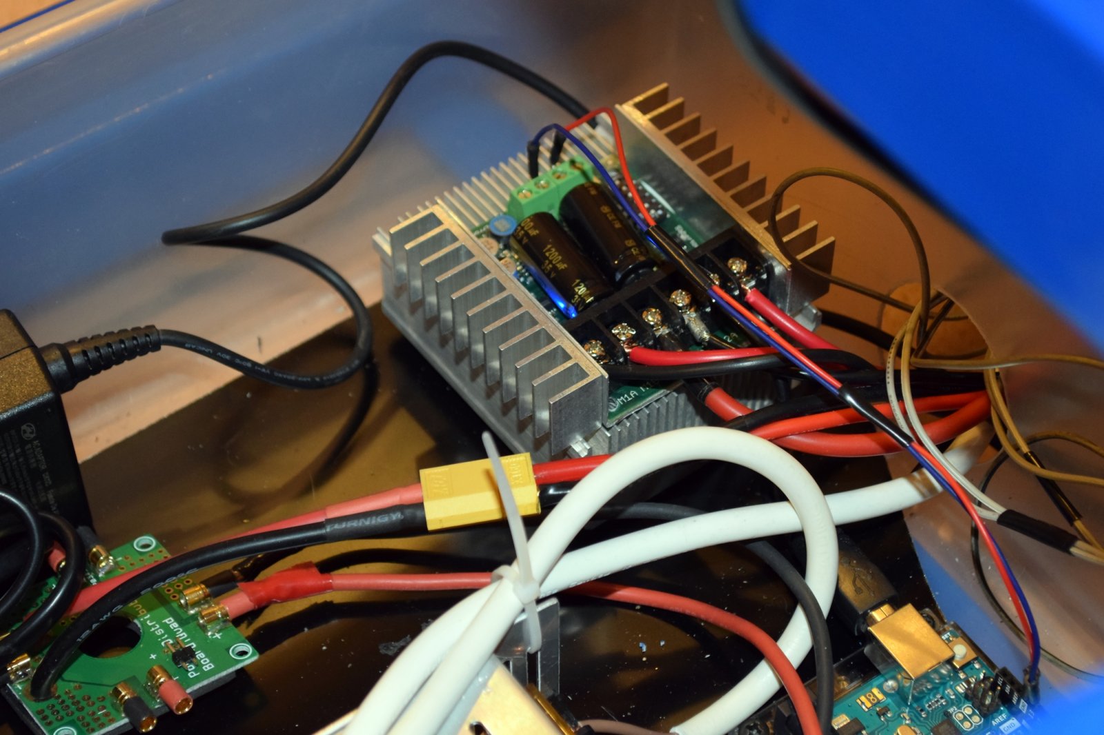

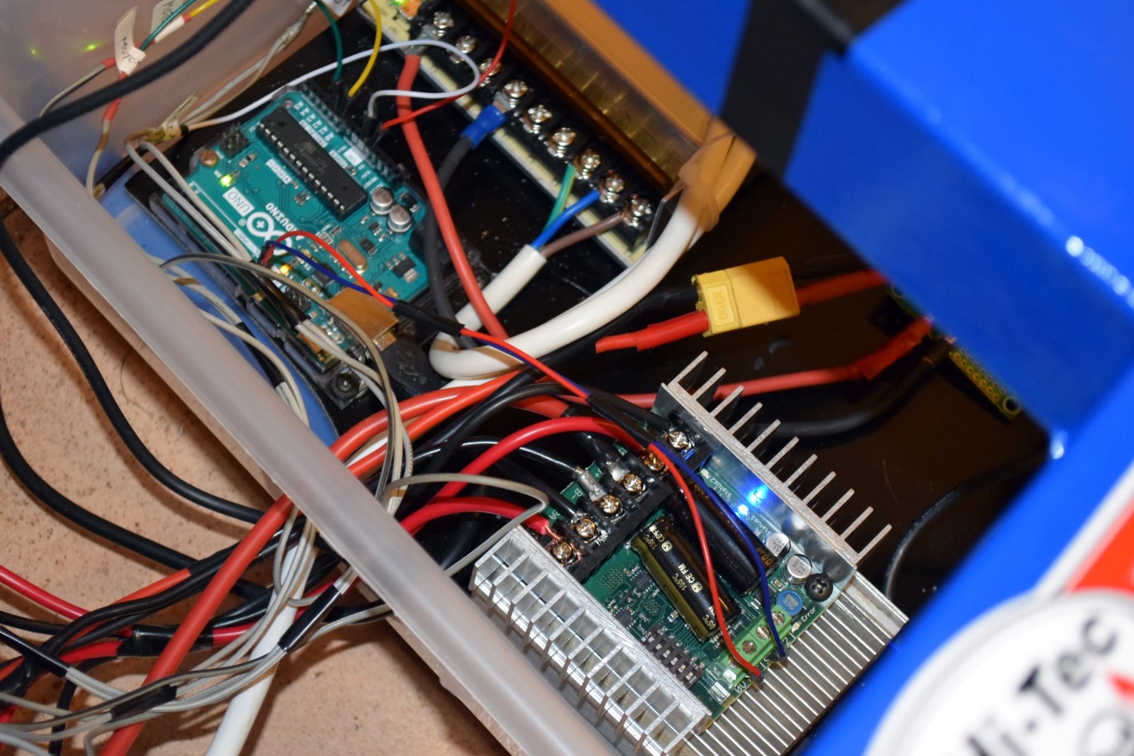

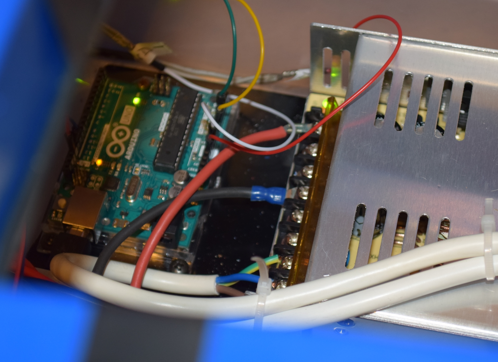

    I attempted to wire up and load the software as per your tutorial, but I have done something wrong no doubt.
    For a start I am using a 2X25 Sabertooth v2 and when I tried to change the baud rate it would not allow 115200 and the max was 38400 from memory.
    I loaded the Sabertooth Arduino Libraries but I have no idea what I do with them
    I then loaded the SMC3-SPS sketch file into the Uno and yes I did edit the com port to correct one, and that loaded I think :confused:
    I then ran the SMC3 Utility and followed the steps but when I tried to set Motor 1 I can select it but when I try to do the on/off button it doesn't move it stays OFF
    I also get no movement of any of the motors even if set the PWMmax to it's max setting still nothing
    Motor 2 & 3 in the utility are selectable,and the on/off button is always On

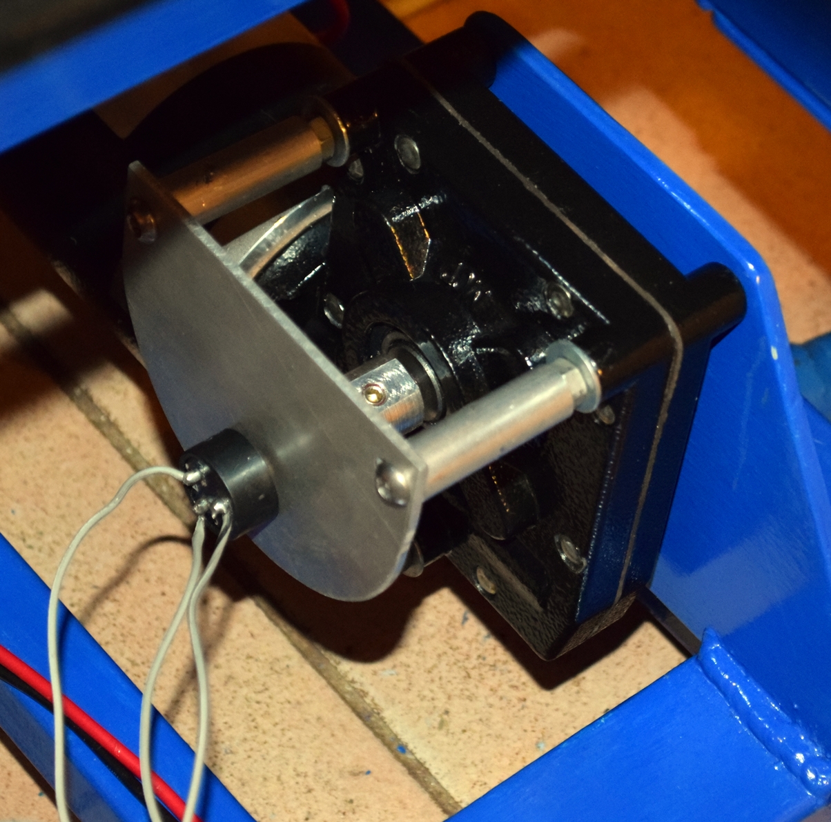

    BTW, the Pots are Hall Effect 180 degree and I am wondering if they might be a problem as the shaft rotates 360 degree with no discernible end points like other normal pots that I have used before with a VFD drive.
    Is there an particular reference point when mounting them ?
    No doubt I have stuffed up somewhere so can you see anything obvious that I might have got wrong ?
    Any help would be appreciated as I am out of my depth here.

    I am using the Describe Utility with a USB TTL tool and that connects and reads the Sabertooth
    This is my board https://www.dimensionengineering.com/products/sabertooth2x25 and it say V2 on the board
    I am using this user guide for 2X25 V2 https://www.dimensionengineering.com/datasheets/Sabertooth2x25v2.pdf
    When I try to change the Baud rate in the Packet Serial Tab
    15: Baud Rate (decimal 15, binary 0b00001111, hex 0h0f)
    This value remains until it is changed and does persist through a power cycle. The values are:
    1: 2400 baud
    2: 9600 baud (default)
    3: 19200 baud
    4: 38400 baud
    Mode 4: Packetized Serial Mode

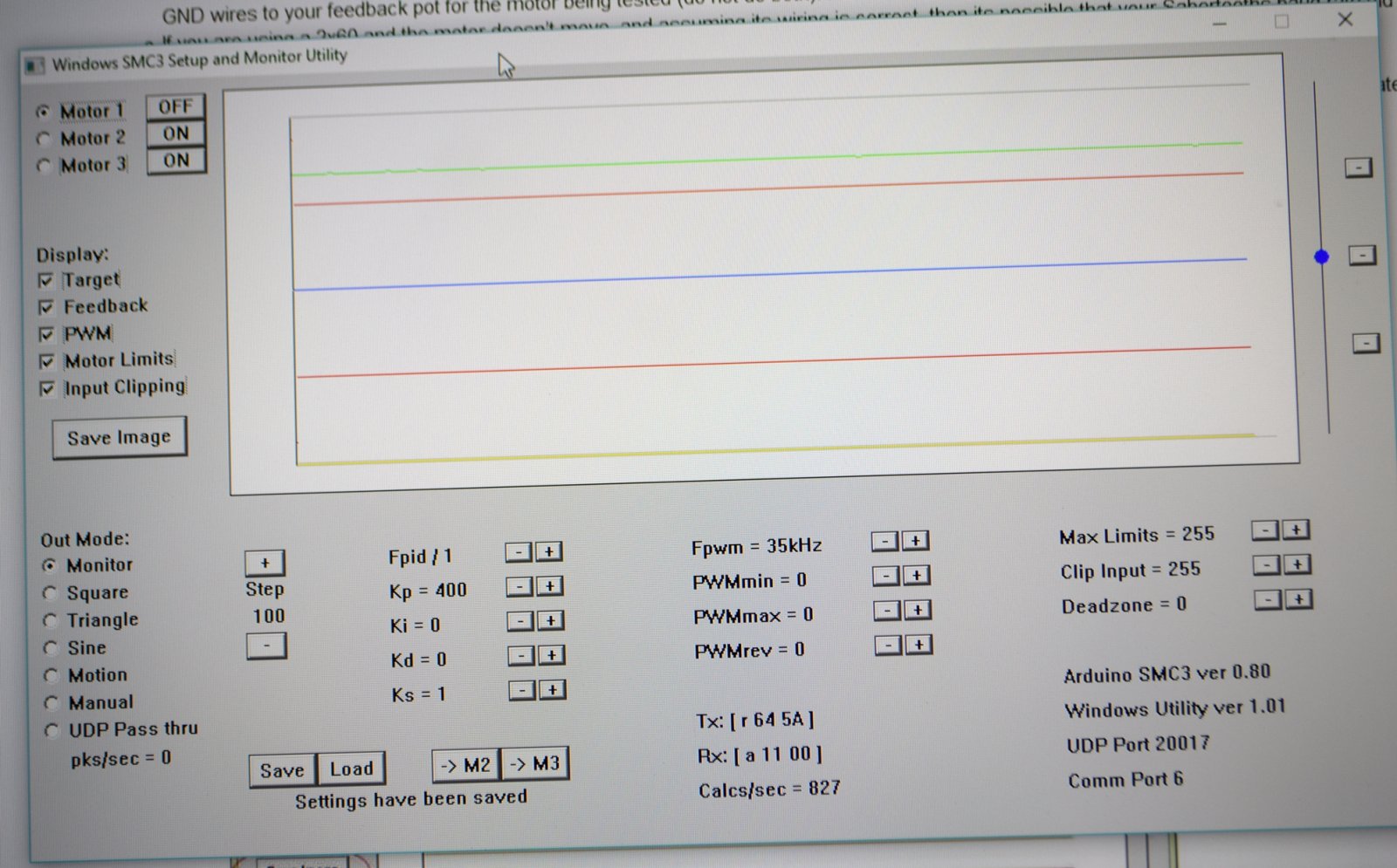

    Well I went through the steps as before but the Motor 1 button even when selected and pushed ON does nothing see pic.
    But Motor 2 I got to turn but the more I increased the speed I think it was clipping, like a miss sound if that makes sense. But it moved so whoohoo.
    Then repeated for Motor 3 and nothing, no movement of the motor or the screen trace remembering that I only have two motors !
    Does any of that make sense, as I am more confused :mad::mad:

    Use steps 11, 17 and 18 of the setup guide for motor 1 . ;) But motor 1 pot is still out of range. The green line must be between the red lines first.

    Ok. When you the pot is out of range should I manually rotate it or is it a software setting that I have to alter.
    I re -did the whole process from step one and got the same result as in the pic I can keep doing it but I just get the same flat line and Motor 1 On/Off button stays off !

    With utility running rotate pot either by housing or shaft until green line is in the middle. On 180 degree continuous rotation pot 1/2 of it doesn't do anything. If the green line doesn't move with a full rotation you probably have a wiring issue.

    After much f****ng around I think I got it right in that I got the Green line between the limits on M1&M2 and both are no moving.

    Either I was tired and frustrated or the fairies screwed with my settings but here I am again back to square one.
    Now I have rotated each pot until the green line is in the middle where the blue line and when I try that I get SFA and when you adjust the pot for each motor should the green line be set in the same position, or M1 above the Target and M2 below the target line.
    So I re-do the pot adjustment and keep the green line between the Blue Target line and the red Limit line and give it a go it heads to the blue line and hits a brick wall.
    Is it meant to be able to go past the target line or not.
    Like I said I had one side adjusted fine and both I thought but something has changed for the worse
    Another thing, when I thought I had it working and the motor was moving I then did as the tutorial said and went on to the next motor I noticed that the motor one settings had not been save to the second motor by pressing >M2 , so that is just one more thing.
    I'm sure that I have followed all the steps as listed and advised which still has me thinking it might be the Pots.
