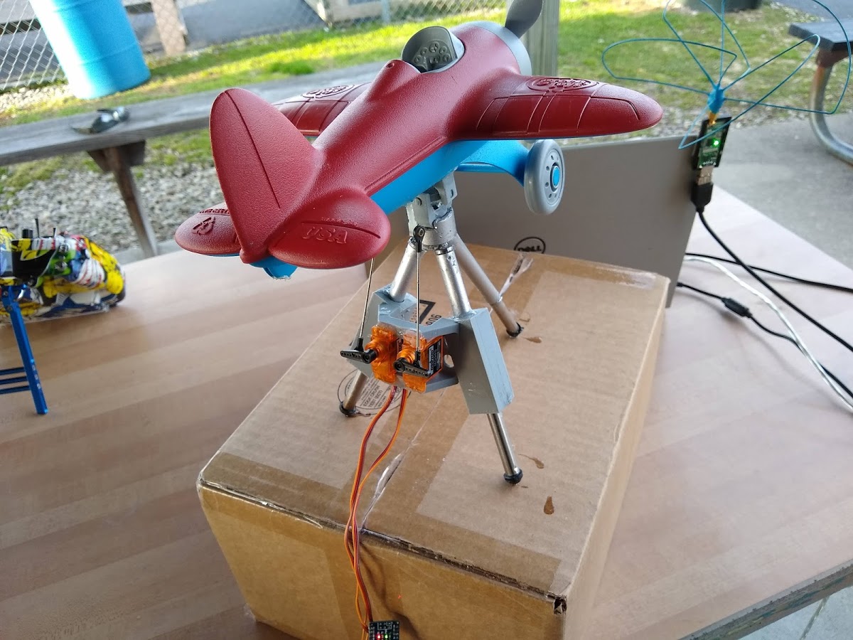

    Very fine...
    The file Rcrcode.zip is a set of arduino libraries needed for the sketch.
    The screen shots are just a sample of my set-up which drives two 10gram servos.
    Here is a picture of my test set-up lol
    Always happy to help my fellow Sim Brothers:)

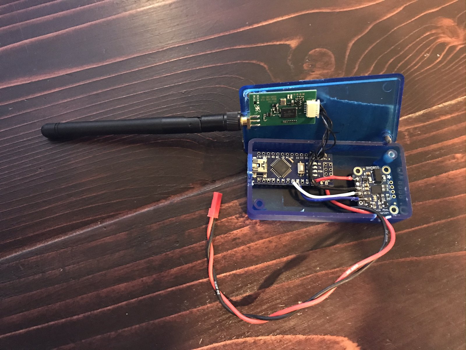

    • Arduino Nano
    • BNO055 9 DOF Absolute Orientation IMU
    • Telemetry module

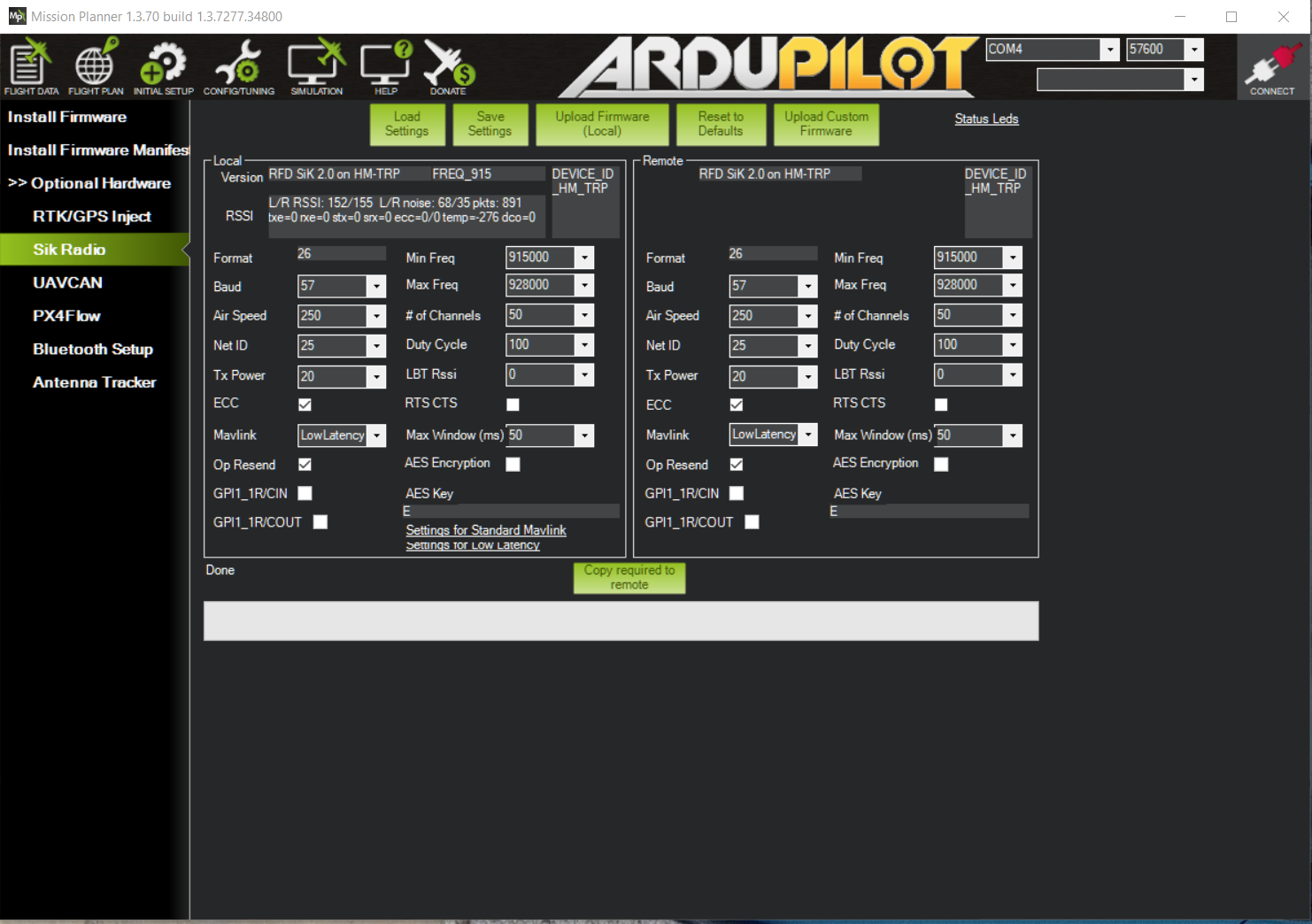

      • Think of these as a "wireless USB cable" between the arduino and your PC. There are many options here. Most are based off of the 3dr telemetry radios made to work with the pixhawk and ardupilot systems, but 3DR(American drone company) no longer makes them so there are several clones out there now. 915 Mhz should be used in USA, 433 Mhz should be used in some other countries
      • This $29 one is the one I am using with pretty good success at about 100 yards with the 100 MW version. I havent tried the 500 MW version. If you use this one, you need to make sure to update to the latest firmware for it to work using Mission Planner. At least I couldnt get it to work without updating it. Here is the firmware/settings I am running successfully but feel free to play with them to see if you get better results, make sure they are the same between the two radios
      • If you want better range you can drop $230 on this RFD900 version. I Believe this is what @T R Para is using? Havent tried it myself.

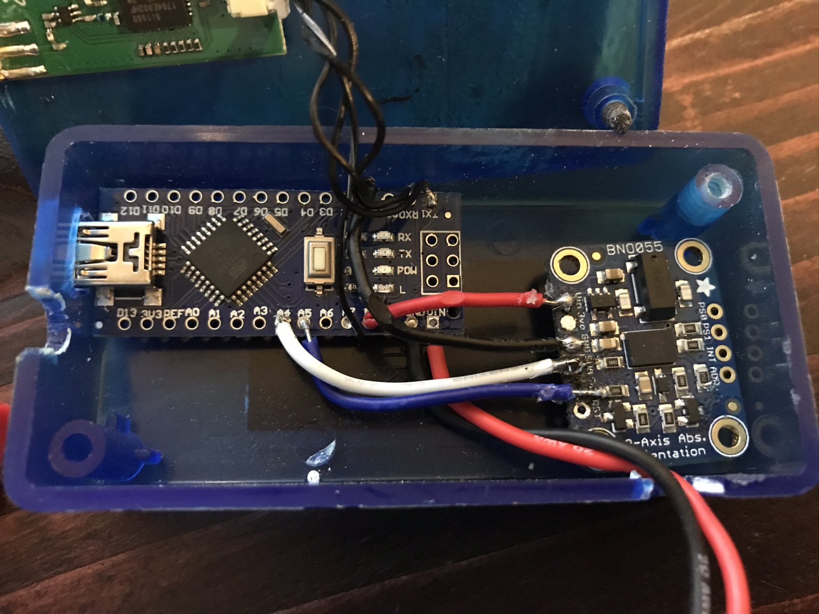

    Connections as follows:
    BNO055 IMU board -> Arduino
    • Vin -> 5V
    • GND -> GND
    • SCL -> A5
    • SDA -> A4
    Radio -> Arduino
    • 5V -> 5V
    • GND -> GND
    • TX -> TX
    • RX -> RX
    You will also need to supply 5V to the arduino. I am currently just running a cable to a servo port on my quad receiver, but there are many ways to accomplish this including a small dedicated battery to make the unit self contained.

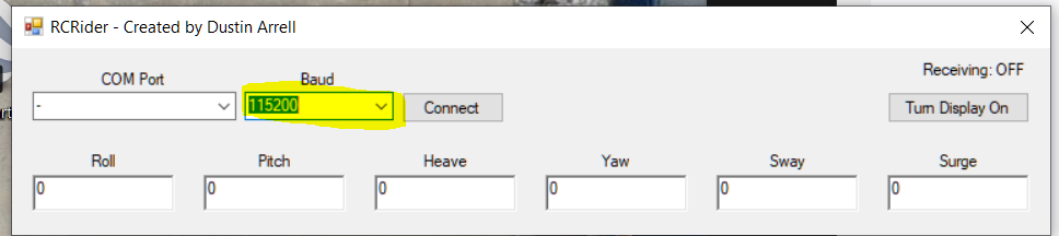

    Connecting to SimTools
    • @yobuddy created the RCRider app that receives the data and basically looks like a "video game" to simtools.
    • Just install the RCRider plugin like with any other game, then run the RC rider program and choose the correct com port and baud rate(this will be the baud rate in the arduino code. if everything is working you should see values populating all of the DOF
    • Run simtools virtual axis testing to make sure data is coming into simtools
    Couple of important things to note:

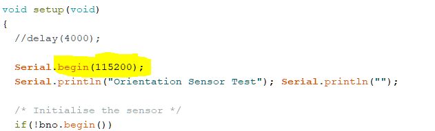

    • The Baud rate that you choose in the Arduino code will correspond to the baud rate that you select in the RC Rider app
    • The telemetry radios must use the same baud rate as eachother, but dont need to use the same baud rate as above. This baud rate is used just for communication between the radios, whereas the other baud rate is used for communication between the arduino and the PC. The radios default to 57600
    • One of the variables we havent quite nailed down yet is the delay at the end of the arduino sketch as a longer delay gives you a more stable connection, but increases latency. The code that T R Para posted above has a 65 ms delay, but I was running pretty successfully at 25ms with only a few blips here and there. @yobuddy also thinks there might be some improvement we can make in the way the data is sent that will help here, but this works in the mean time.
    • Be very careful changing settings on the radios, normally the ground USB module wirelessly updates the settings on the air module but if the settings between them get out of sync they wont talk to eachother and you need to connect the air unit to the computer via an FTDI cable (or you can use an arduino hack)
    • because the radio is using the serial connection of the arduino (which is also what the USB port on the arduino uses to talk to the computer) you have to disconnect the radio from the arduino before you can connect the arduino to the computer to update it.
    • You can also test everything without the radios by just connecting the arduino to the computer via USB as the RC rider app wont know the difference. This is helpful for testing and diagnostics and is where you should start before testing the radios.
    • I am obviously only using Pitch and Roll since I have a 2 DOF, but it is receiving all 6 DOF so you can tailor to your sim.
    I have tested it with a quad and a plane and it really is very cool! Here is a video of the tests (FYI the motion is a little choppy but that has more to do with my chair than with the data coming in, It uses pretty weak motors and doesnt have a super smooth response. The data comes in pretty smooth). Some Fine tuning to do but overall the system is working as hoped.
    Let me know if you have any questions and please post any progress you are making! The biggest reward of all the effort for me is seeing other people enjoy it.
