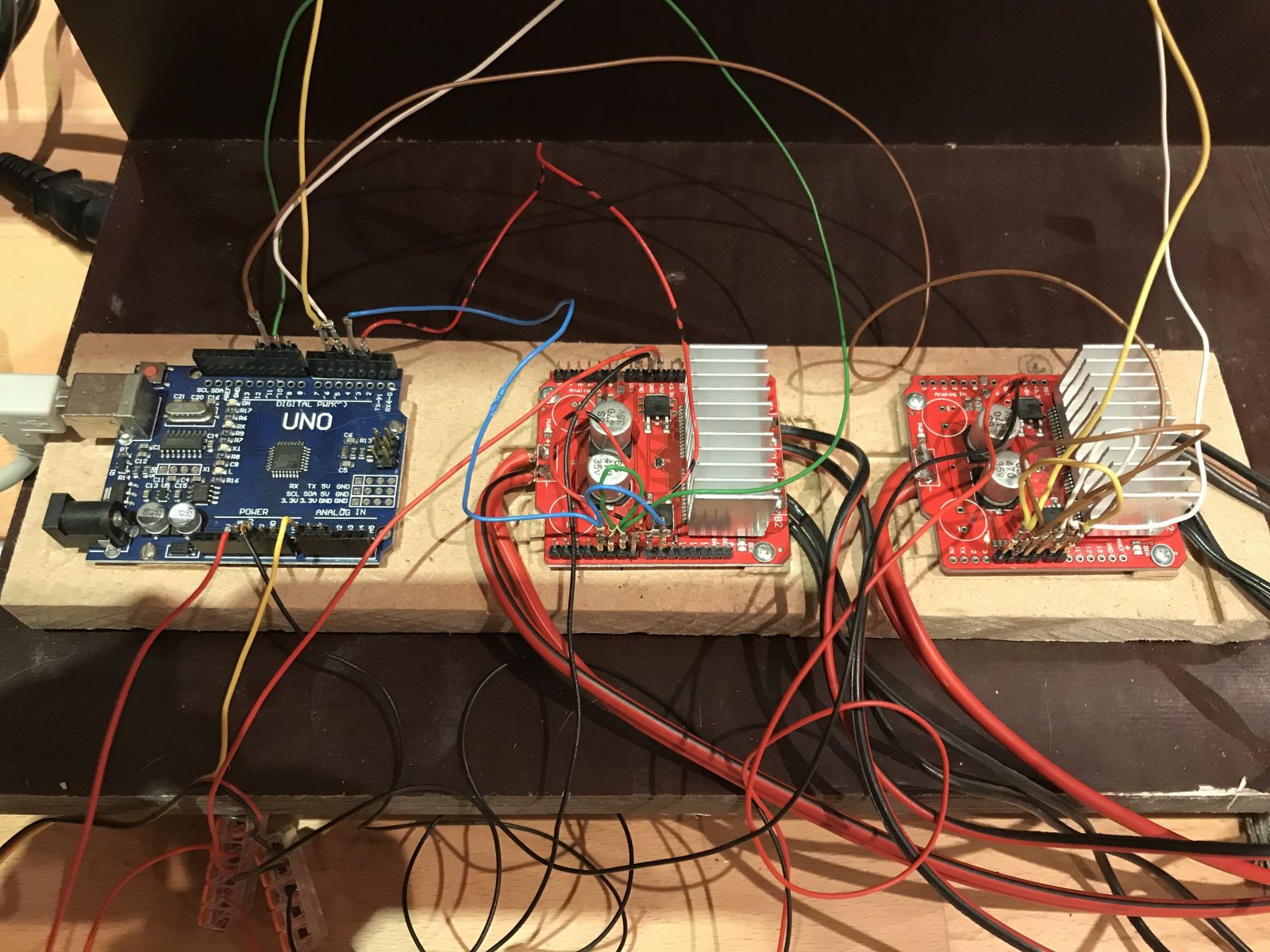

    After a few small parts were missing, I now wired the electronics and the engine. On the first try, the power was set too high and a monster motor burned out. With the right attitude, as described by smc3, everything worked and the engine runs.

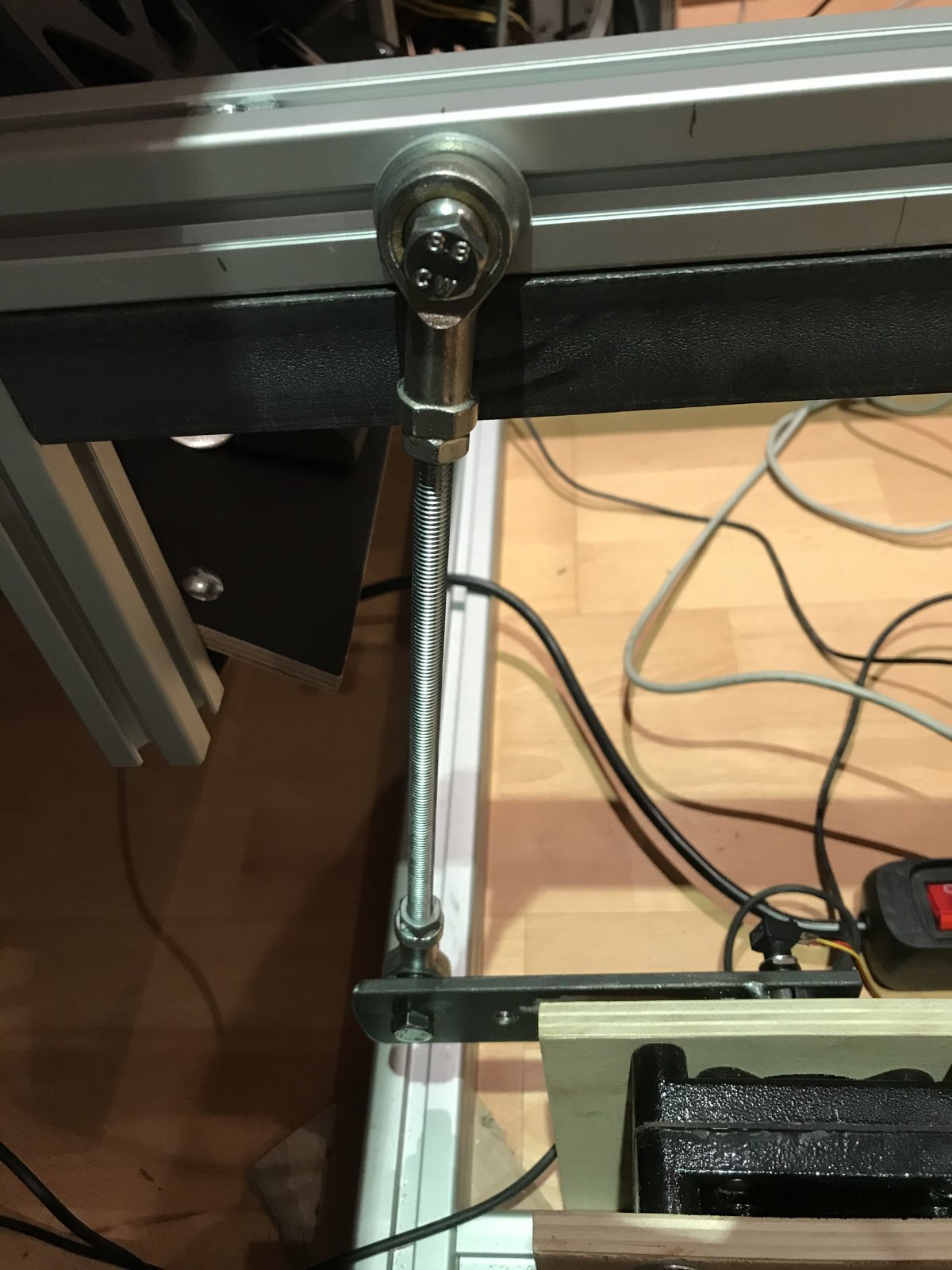

    The levers are almost done now. I welded the holders for the potentiometers. Only the push rods made of M8 threaded rods are too soft.

    Both engines are running now. After a long test, I found a defective monster motor driver.

    The push rod from engine to frame in M8 is too soft.

    first the poti has the wrong direction, now with smc3 the motors work perfect.
    with PWMmax 110 i had 14 A

    About to order my rod ends for a project similar to yours. Are you saying there is too much flex in the M8 rod? Think an M10 rod would do?
    Thanks.
  17. noorbeast
    21,677
    151,706Coins
    +11,045 / 56 / -2
    It is easy to make a suitable strong rod using steel tube with the appropriately sized nut welded either end.

    I will replace or reinforce my threaded rods against steel pipes.

    I connected the potentiometers directly to the motor shaft. It caused vibration. Had the same with hall sensors.
  19. DirtDro
    DirtDro X-plane Rheinstetten
    Jun 29, 2017
    25
    213Coins
    +7 / 1 / -0
    the hard engine did not come through the potentiometer but from a high PWM min. Value. I have 10 now. Behold, the engines are running softer.
