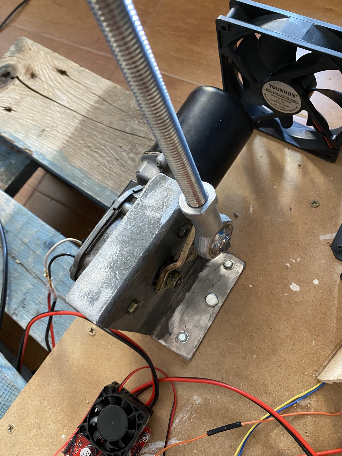

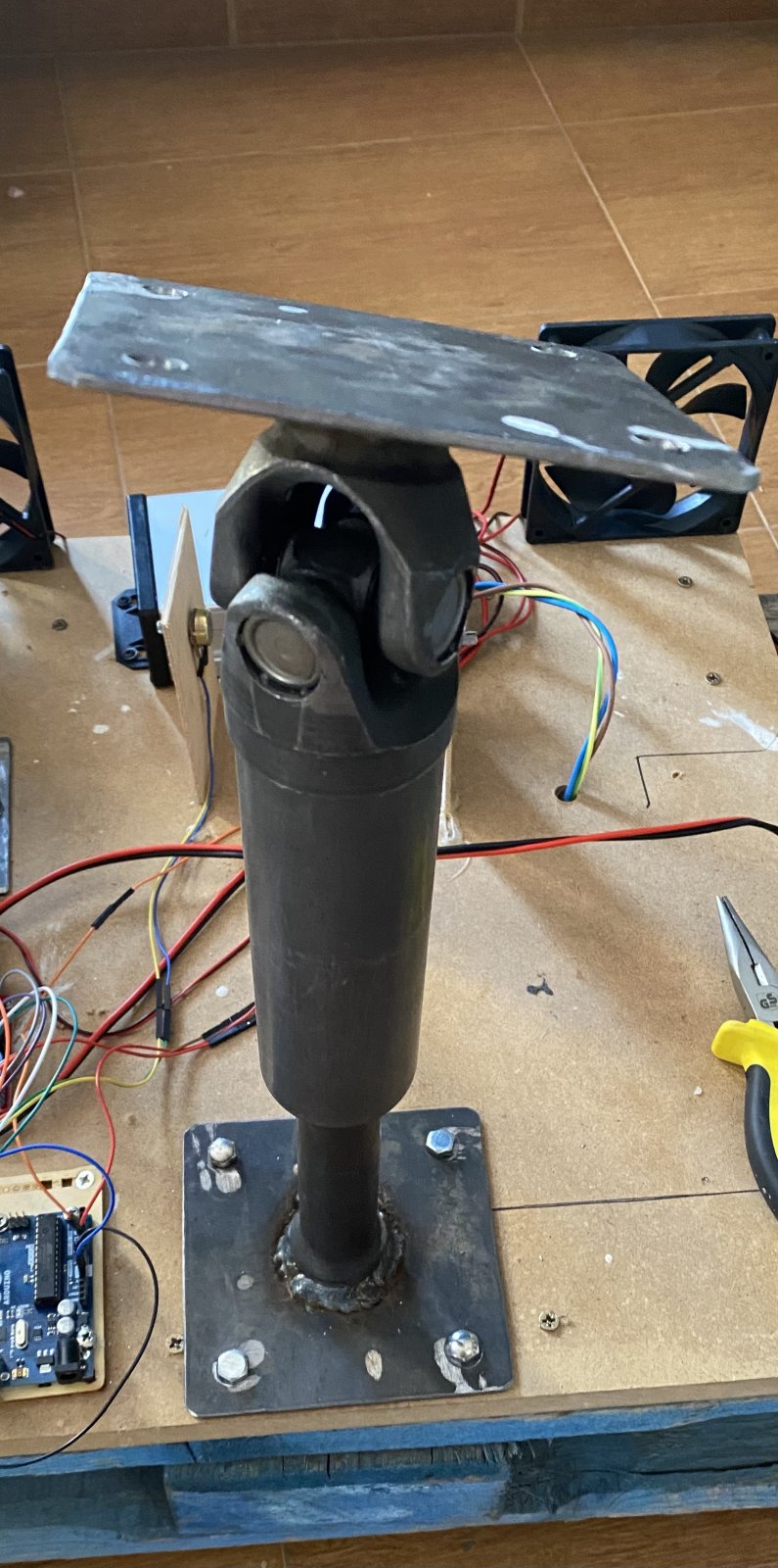

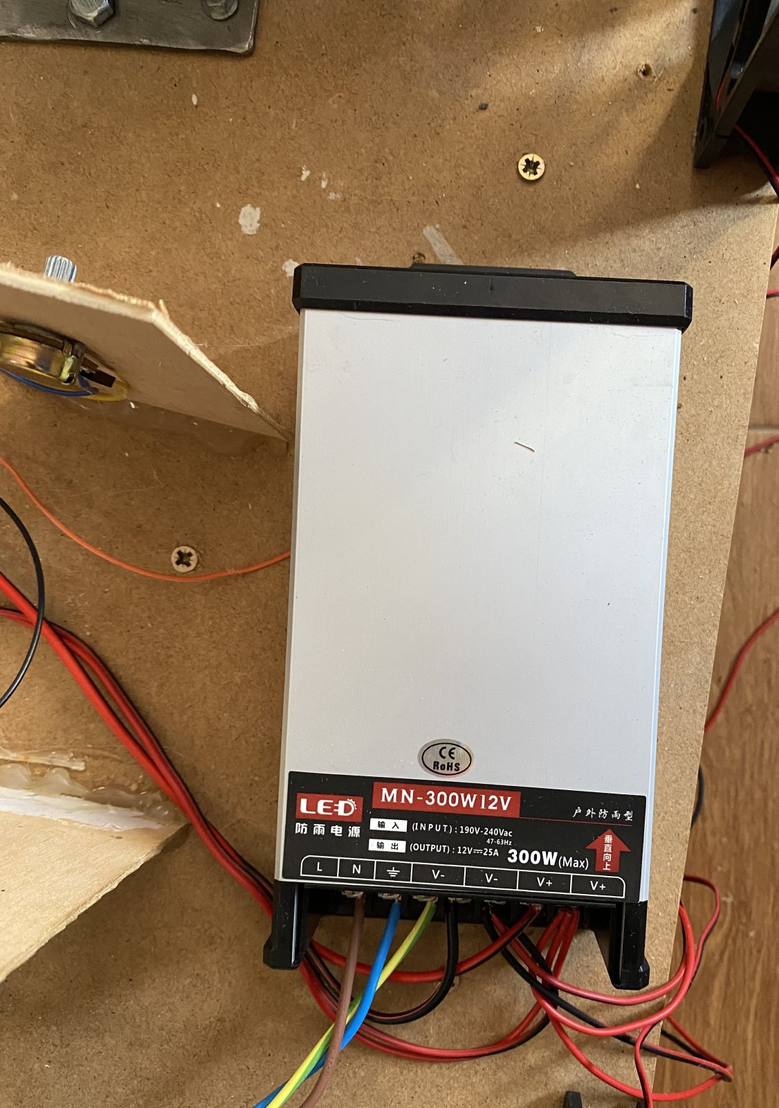

    Hi, everything worked as intended, now i added a pallet down the table to add more surface for make force, and put a motor with a steel square, I need to make the other for the second motor but I put the cardan too with 2 steel plates as seen in the image.
    I will update when i finish it ant the test. As I don´t have a license, i will use Live For Speed

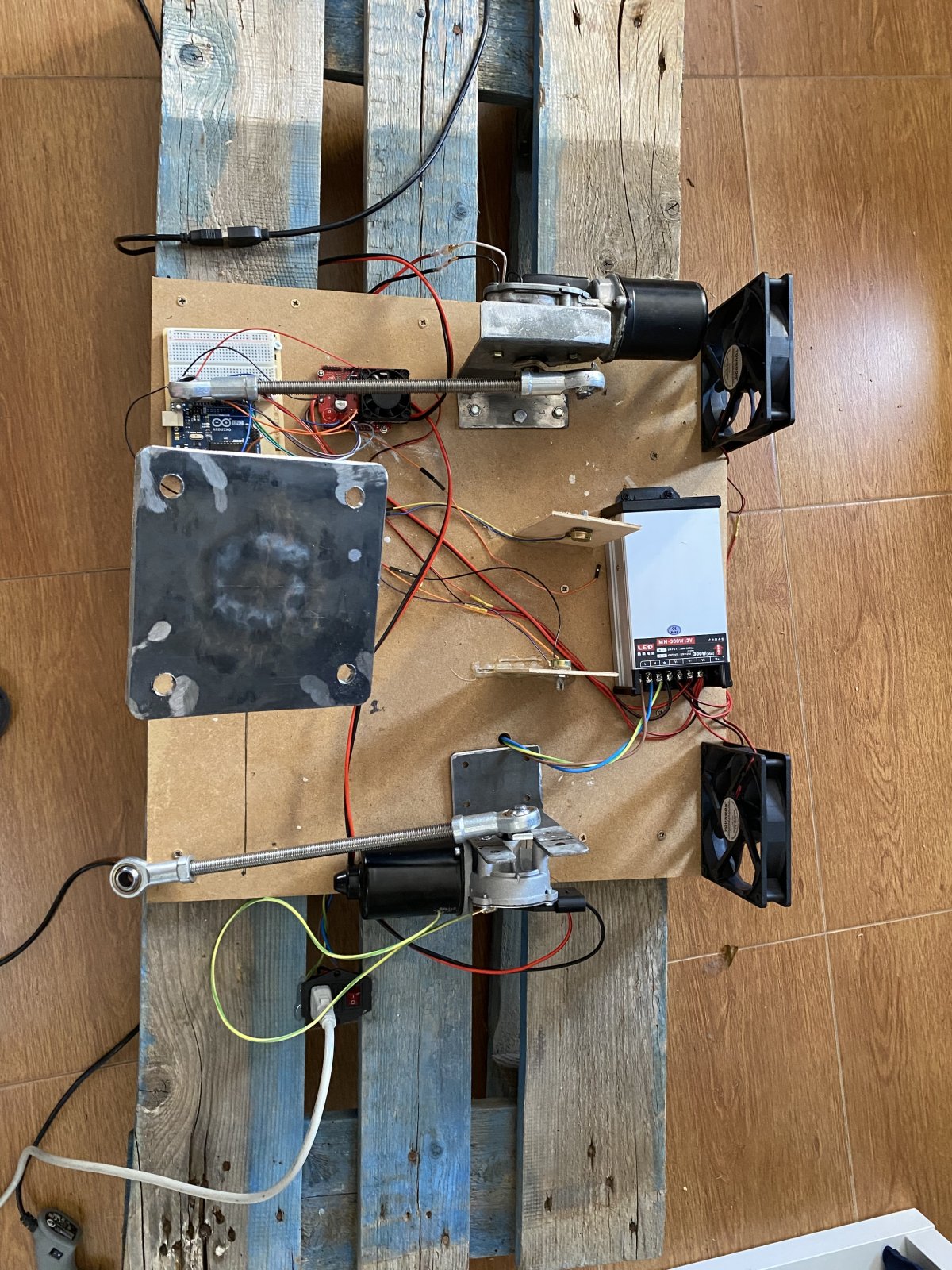

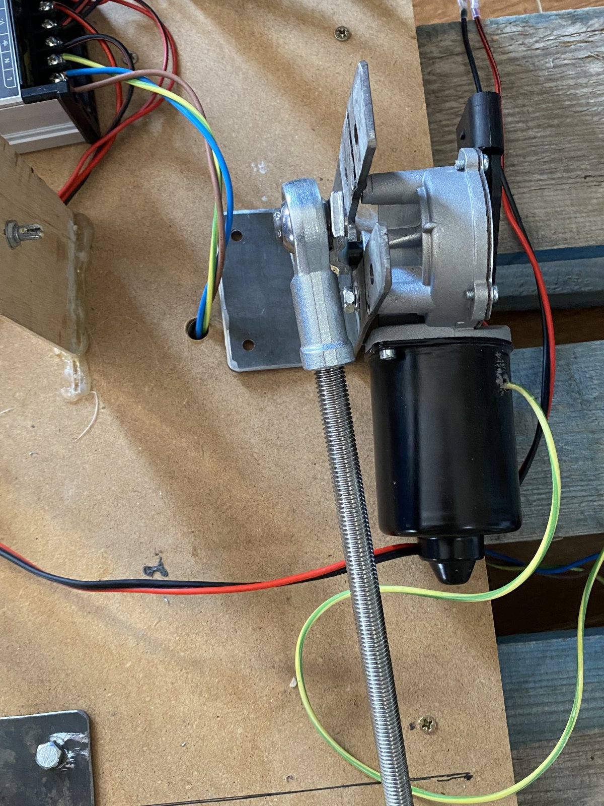

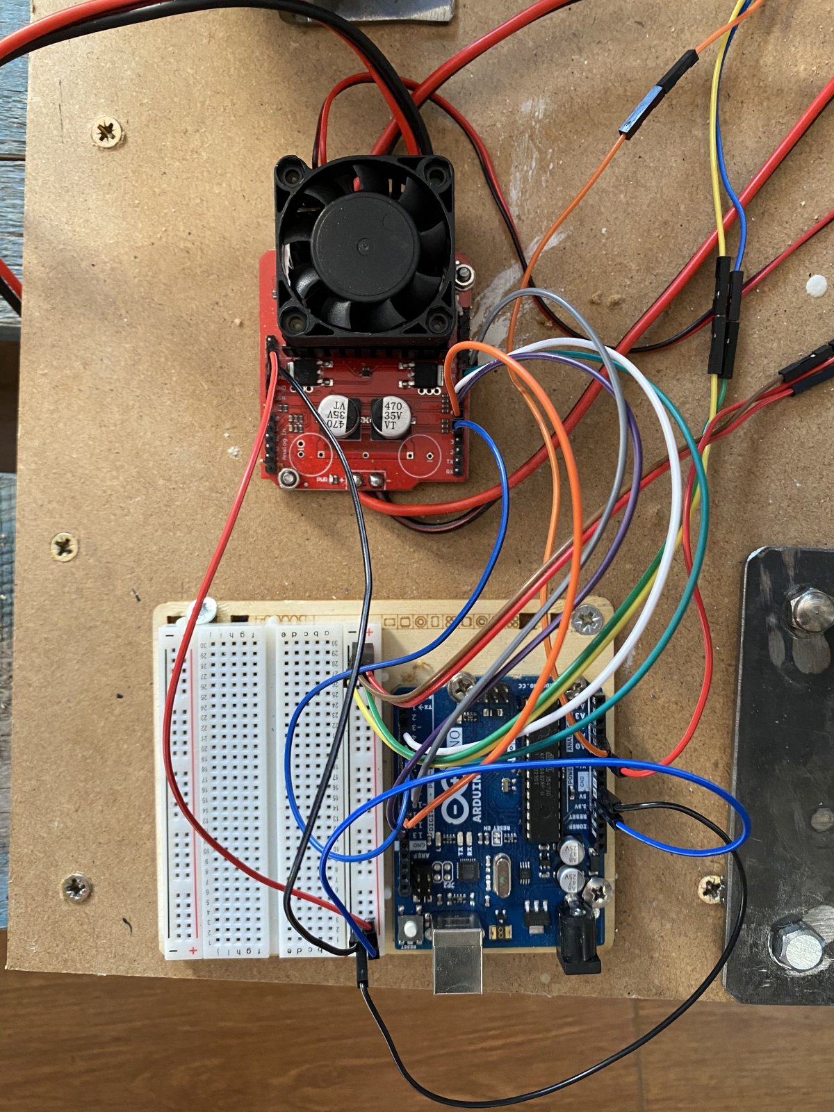

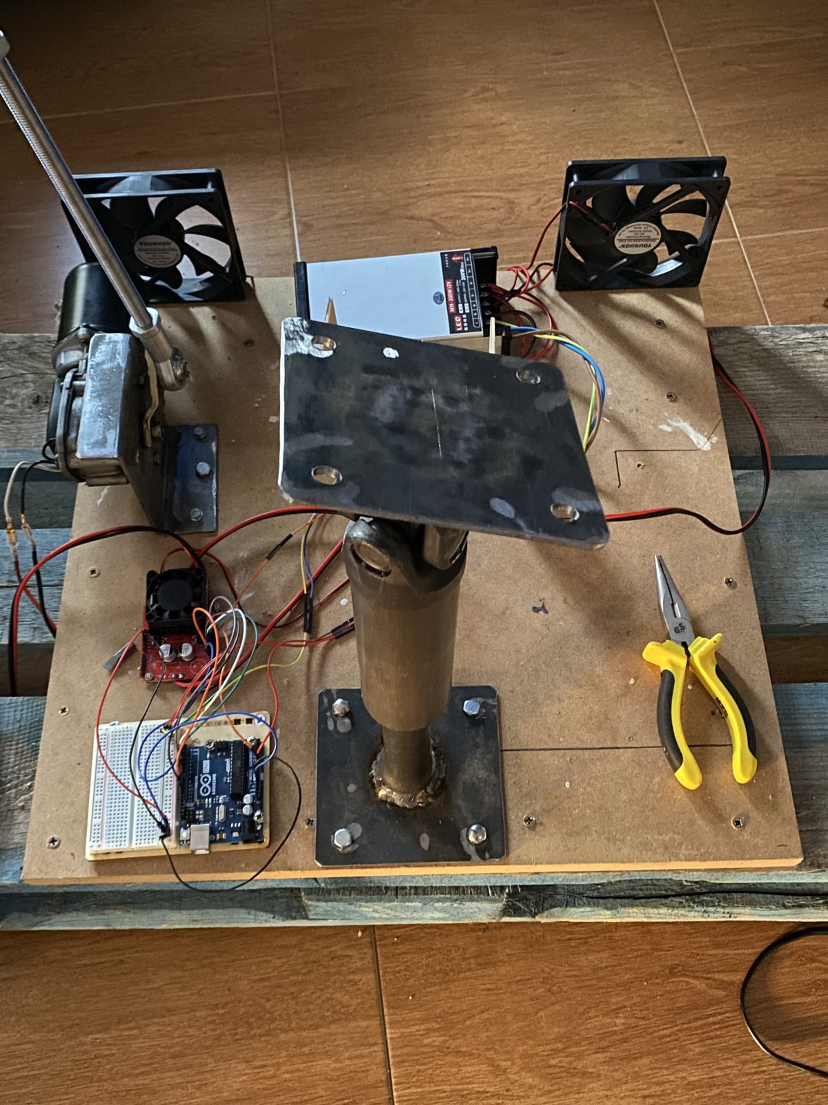

    This is the first motor, with the iron square and it is finished: 0157772B-3989-4BC4-B208-D3FE15452A78.jpeg This is the power Supply, it has 300W: 17E2FA61-1A19-4E99-9B14-6D22377AB79C.jpeg The second motor don’t have the final square as one failed and this one os new, but it should look like this: 441CF598-010F-4E3A-A02C-6FB4BE41BFAE.jpeg The cardan with the two iron plates: E6573DDC-1FDE-4320-A8D2-8F2A18AF8081.jpeg The arduino with the Monster moto shield which have it’s heatsink and fan: 4C4D6C4D-E0B5-4CAA-9959-49B124B11EEE.jpeg The final build should look like this (maybe I change it later): 8239F38E-4336-4424-83FC-A0C267B7DCC5.jpeg Yes the power cable is put outside and the pallet is big put it will not move .
    I put two fans in order to make an air flow for the motors and the fan from the Monster moto as in summer I hit inside the room where it’s placed more than 30 degrees celsius. It’s very possible that I will move the potentiometers to a more suitable place for the connection between the motors and the pots, I still don’t know how to connect them without making electric contact. I will update son and I hope they accept my DIY 2DOF SIM for the free DIY key

    Hi!
    I´m very happy to say that now it works, I dindn´t knew that SMC3 Utils configurations was important so i turned off pwm max but now i put it at 100 (to test) and it works! now i will build the other part of the rig,my DIY structure for steering wheel, pedals, handbrake and manual and sequential gearbox!
