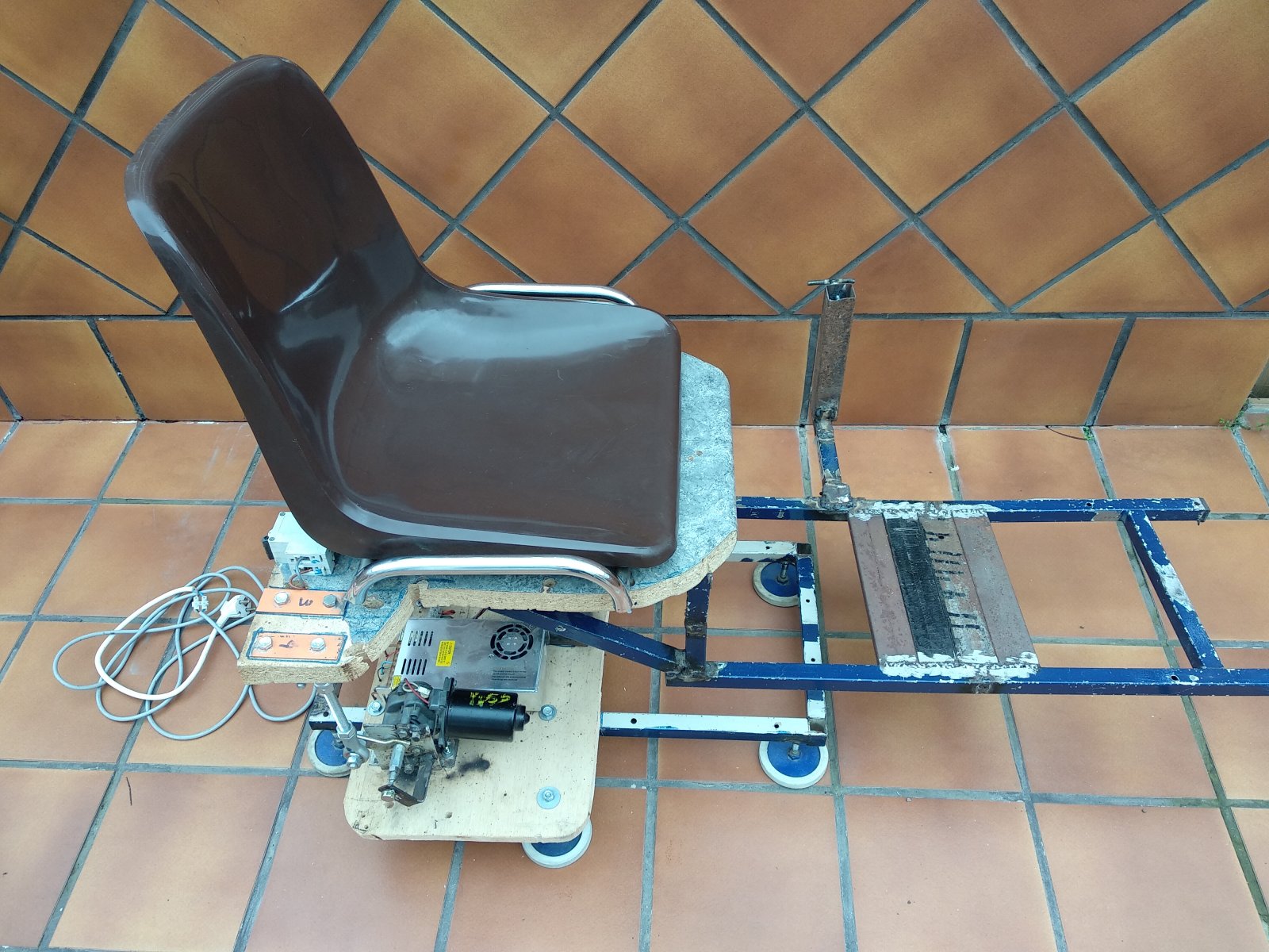

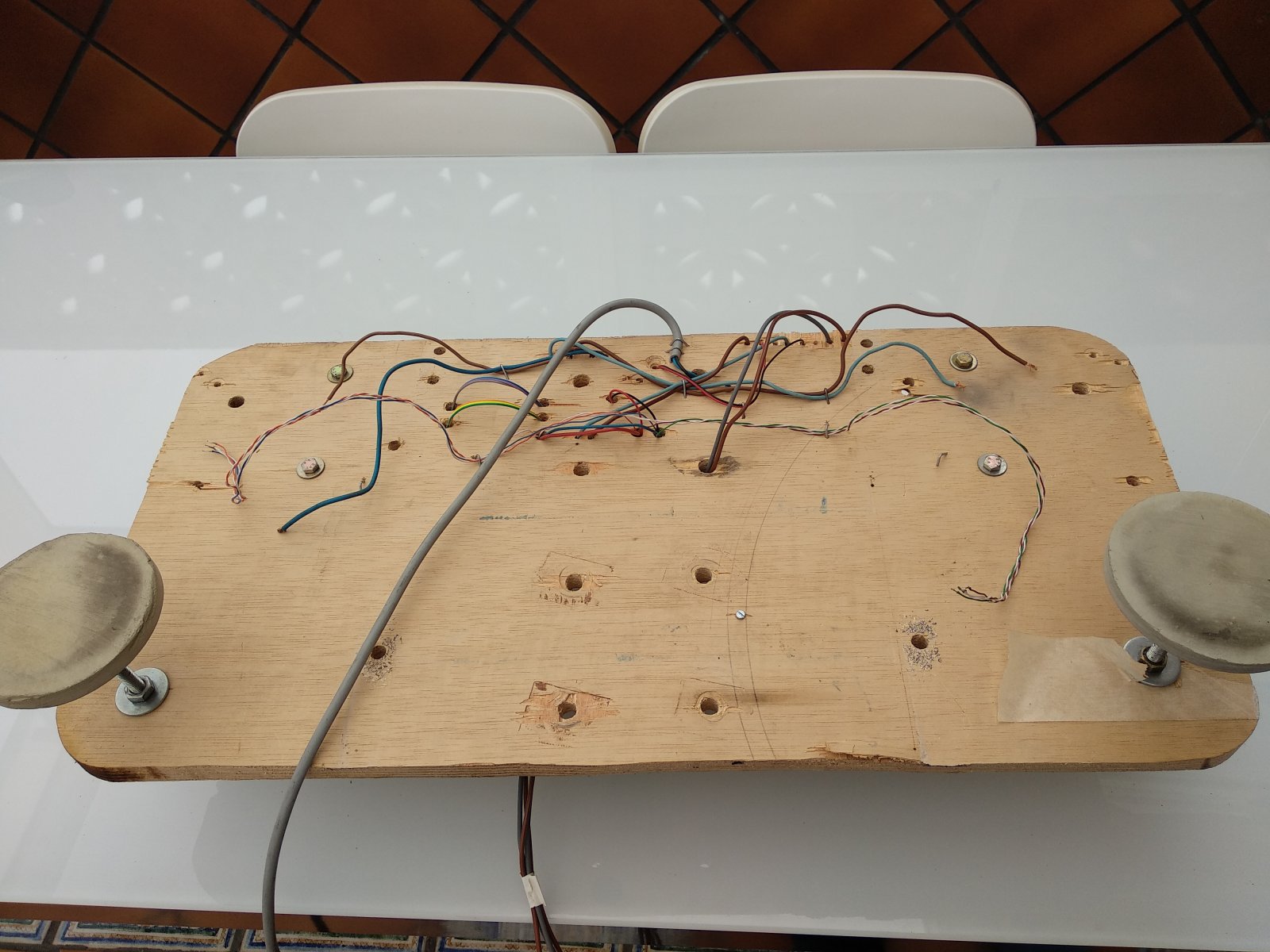

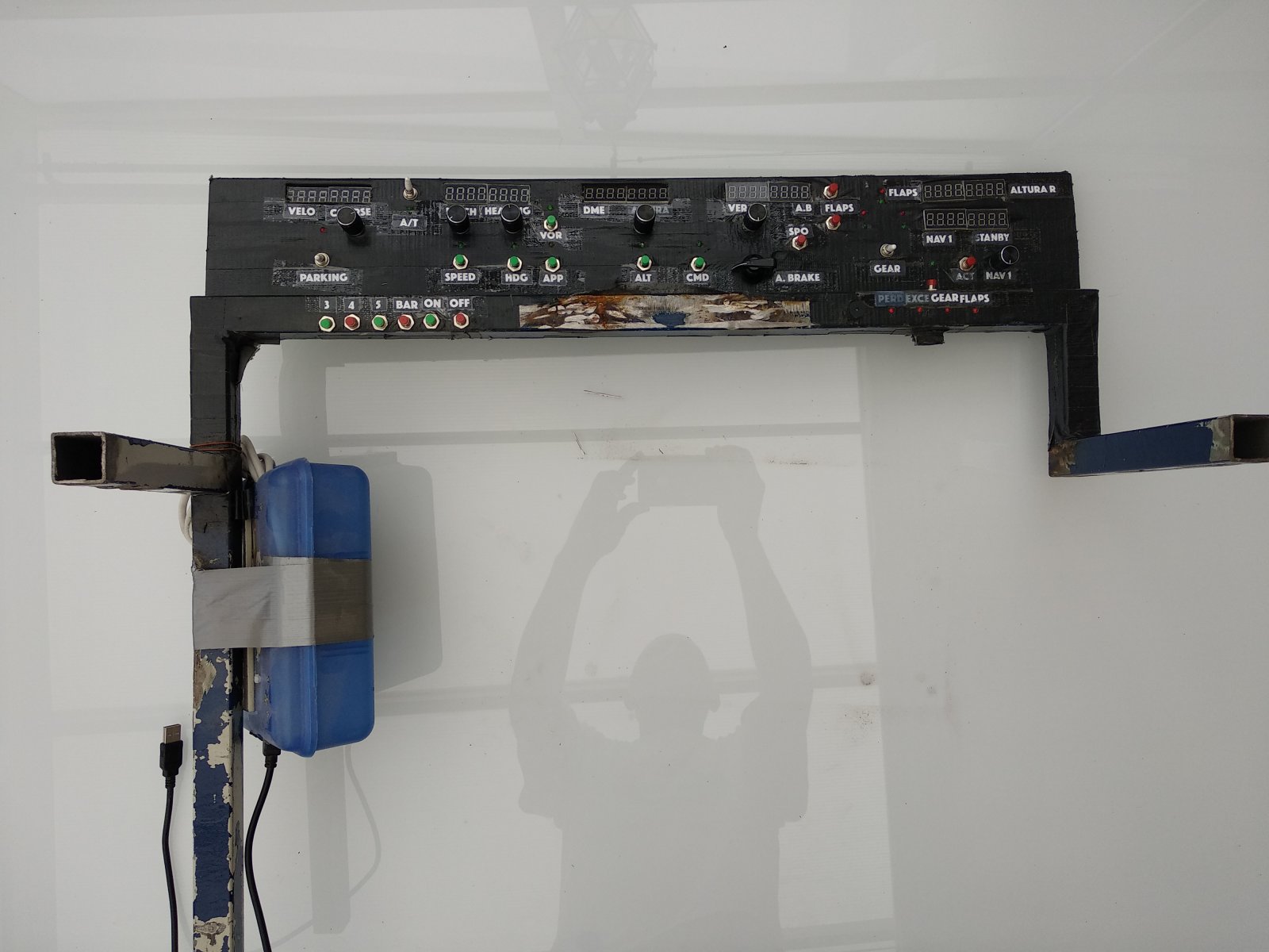

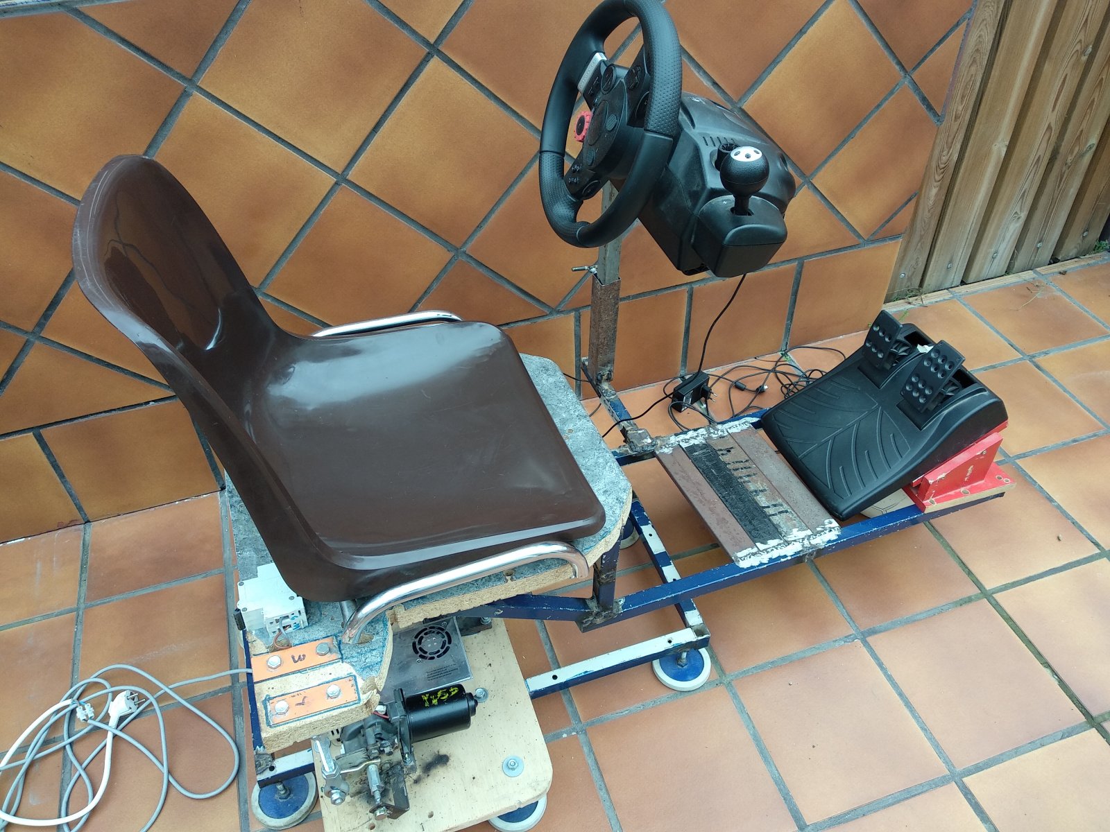

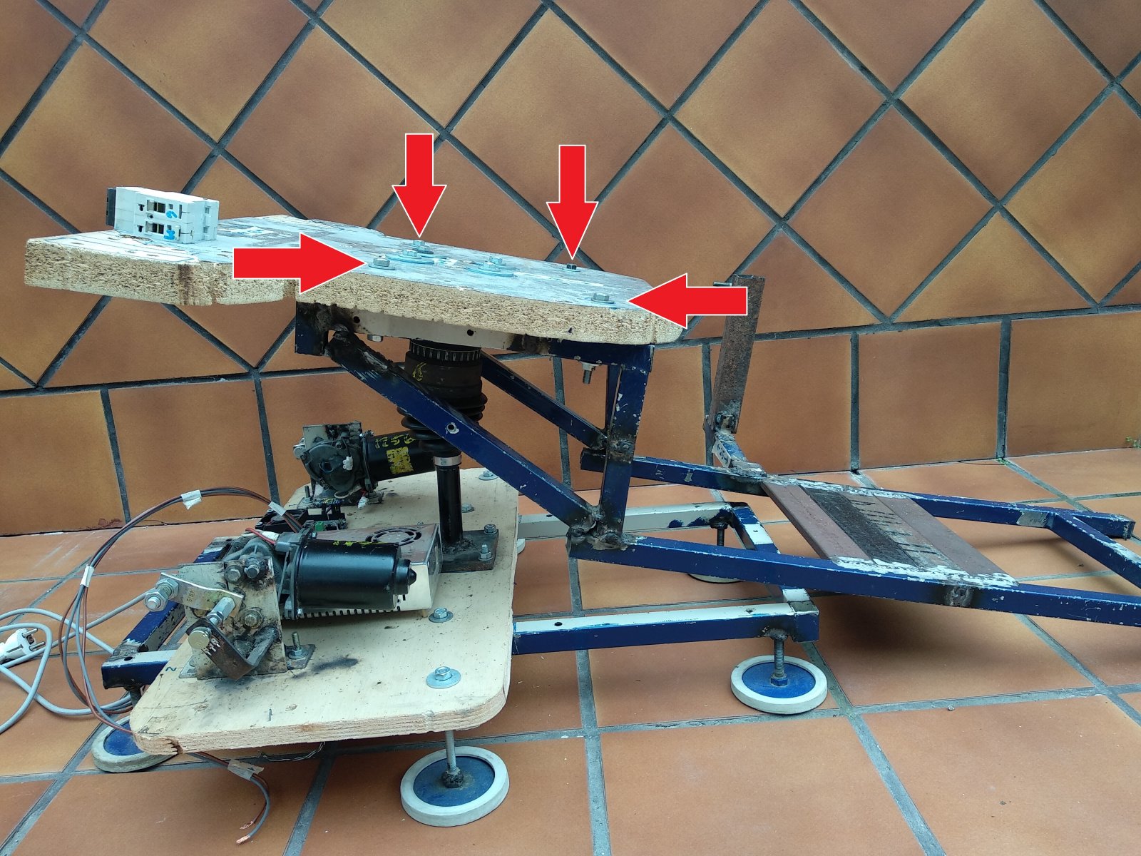

    Hello to everyone, I have finished my project and the cost has not exceeded 150 euros, I used recycled parts and products purchased on aliexpress.

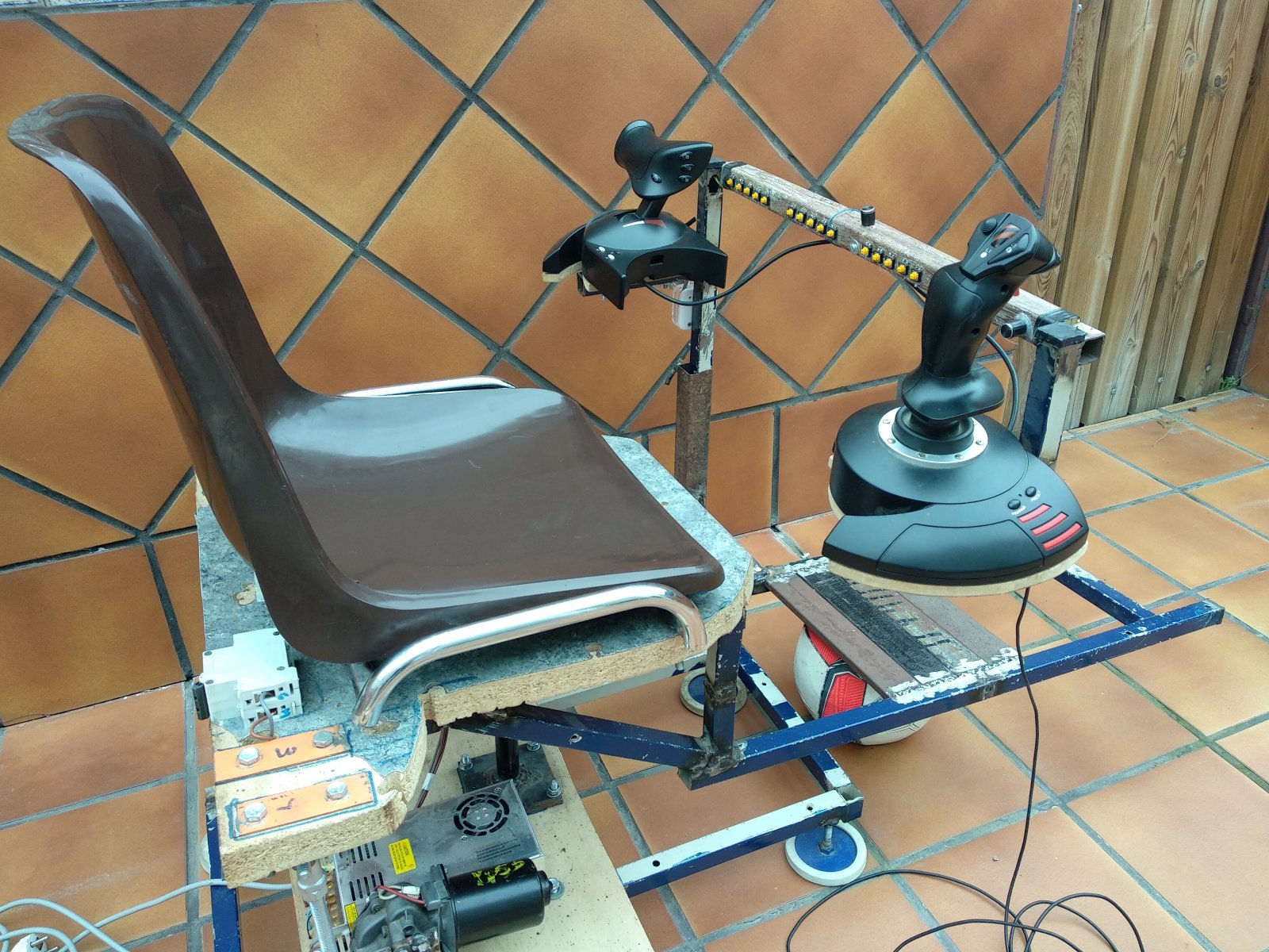

    SIMULATOR PARTS

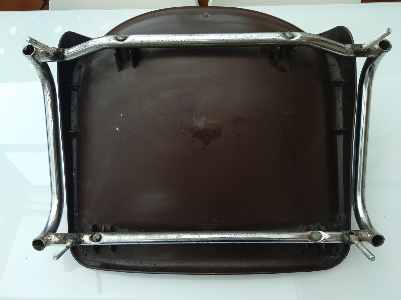

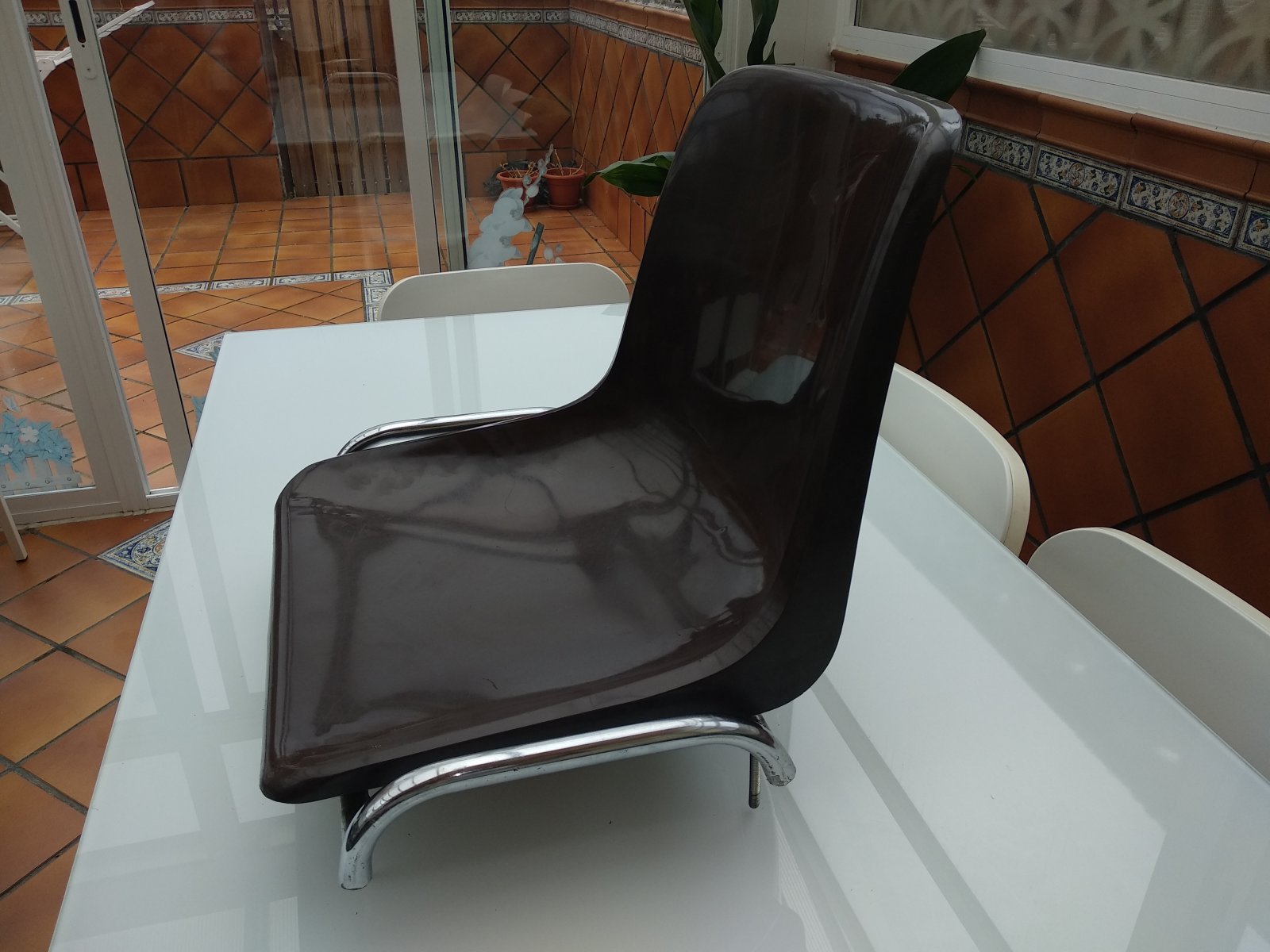

    chair with the legs cut and soldering screws IMG_20180215_110951.jpg IMG_20180215_111027.jpg IMG_20180215_111049.jpg

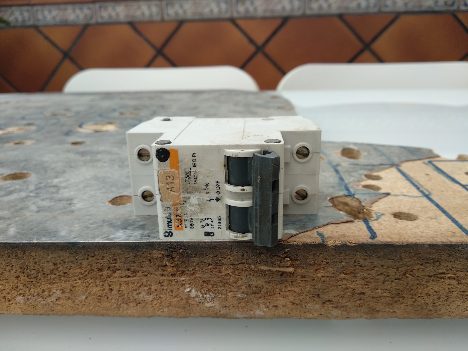

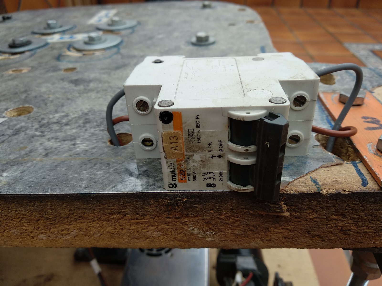

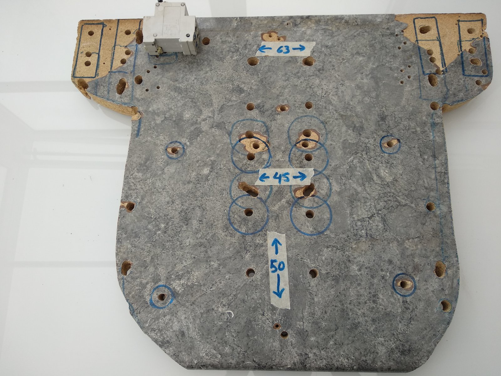

    kitchen countertop with a switch IMG_20180215_112735.jpg IMG_20180215_132316.jpg

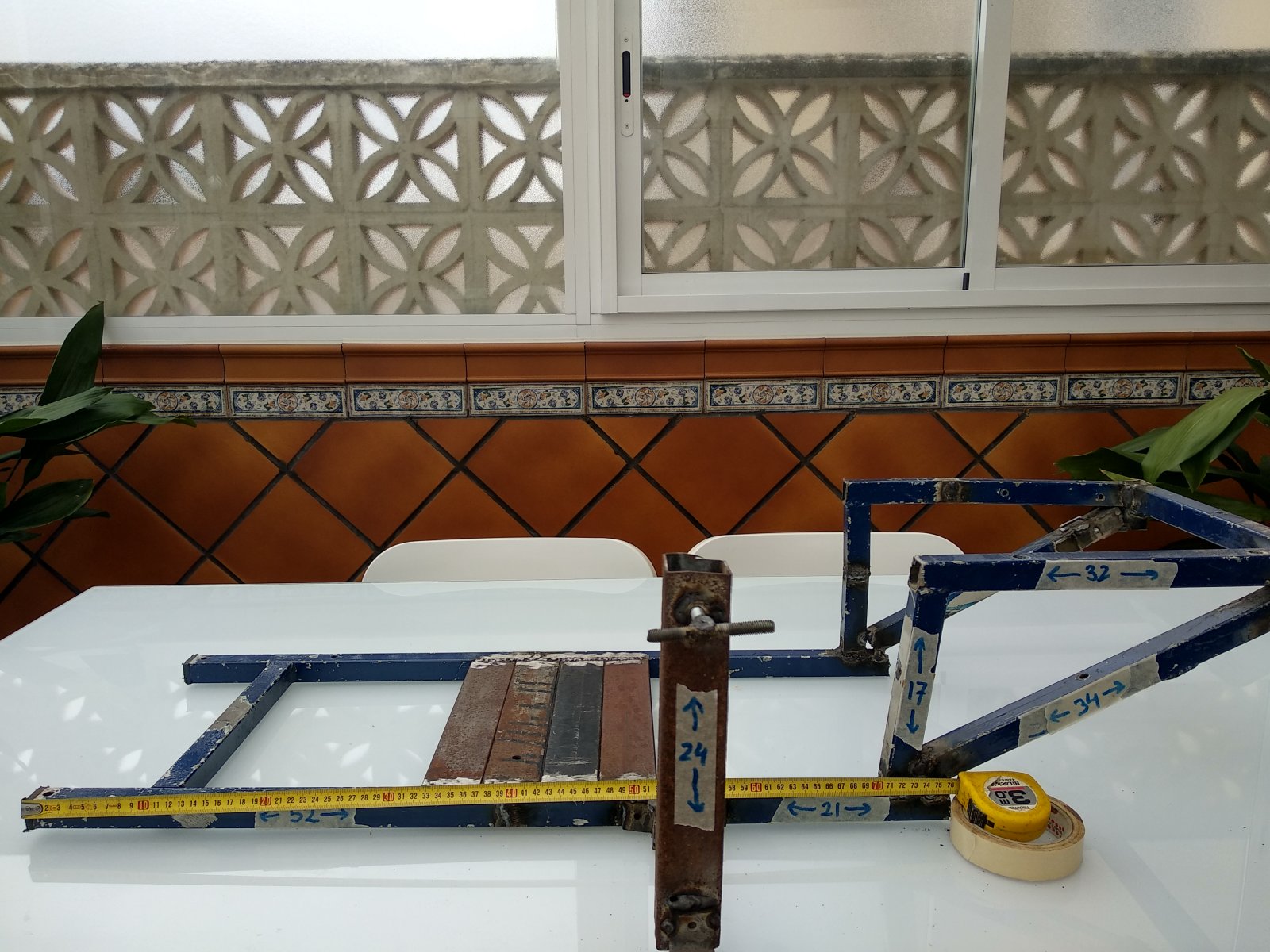

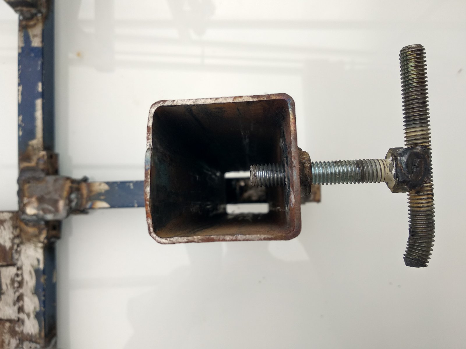

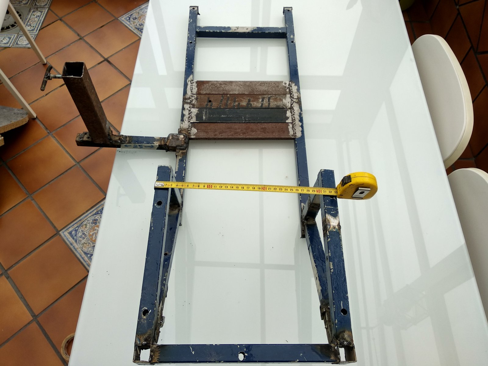

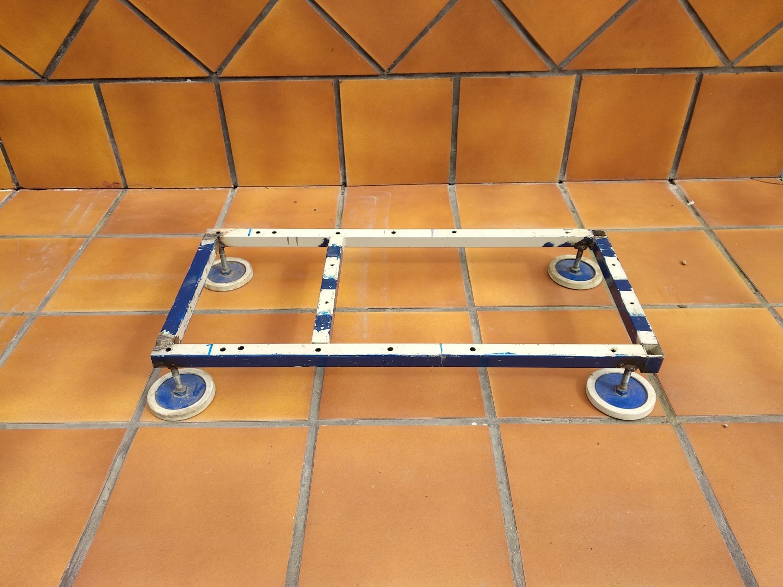

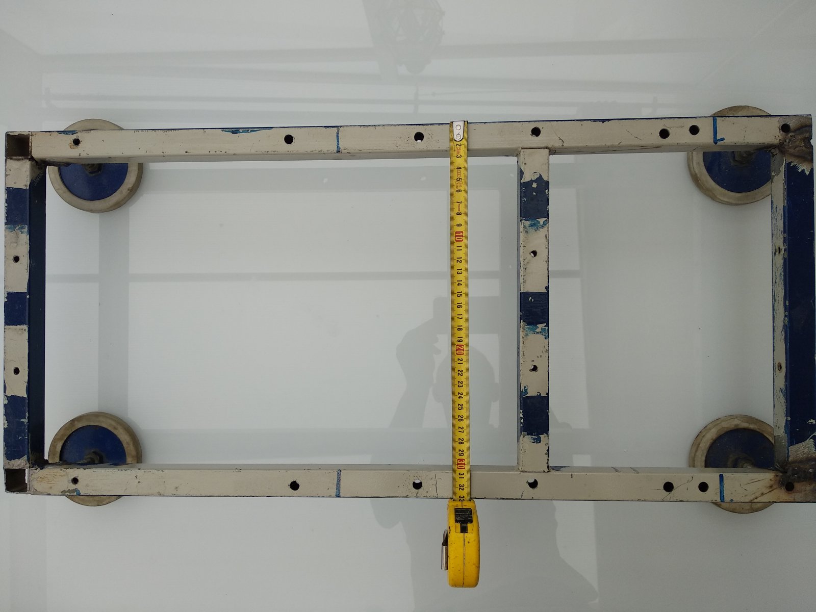

    20x20 square iron tube structure IMG_20180215_114229_HDR.jpg IMG_20180215_114429_HDR.jpg IMG_20180215_113305_HDR.jpg

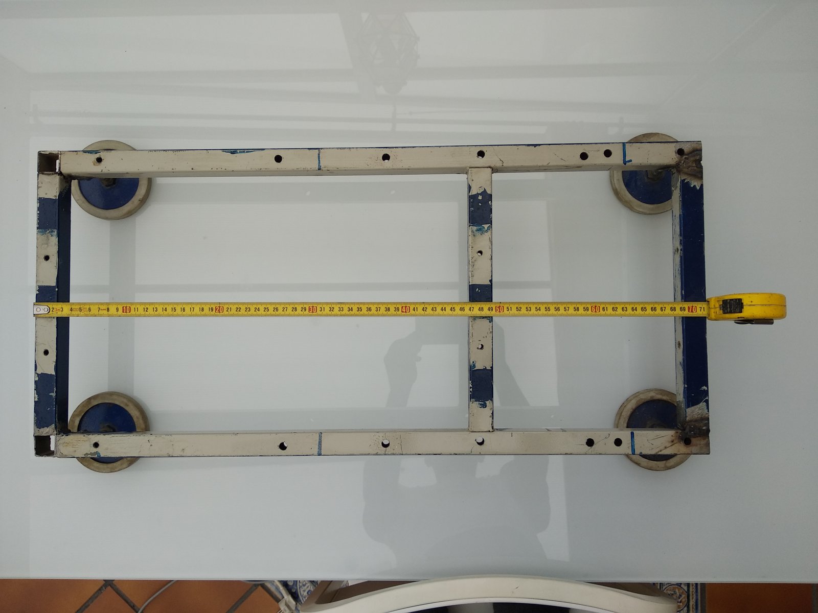

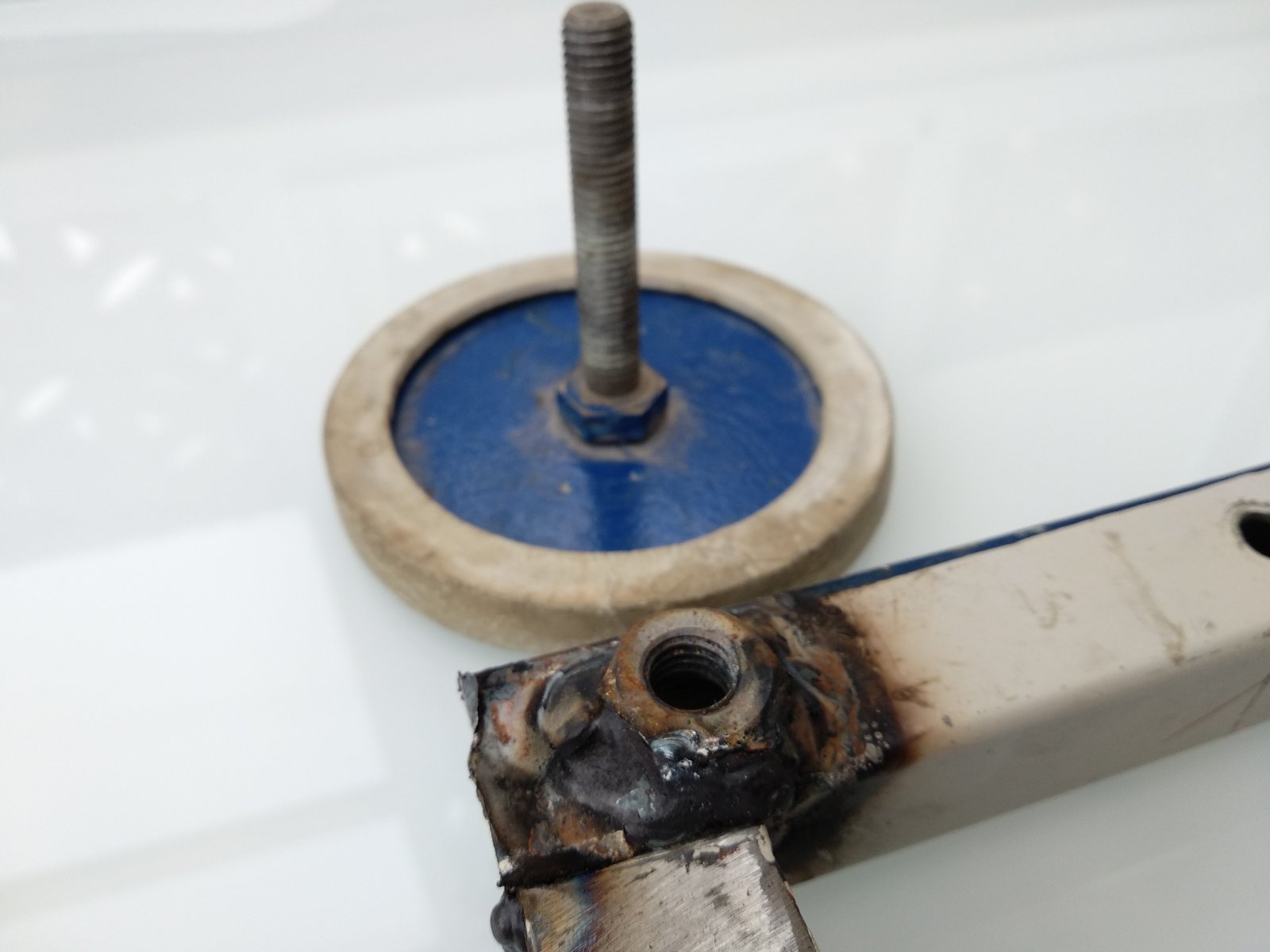

    20x20 square iron tube base, whit adjustable shelf legs IMG_20180215_125712.jpg IMG_20180215_125649.jpg IMG_20180215_171556.jpg

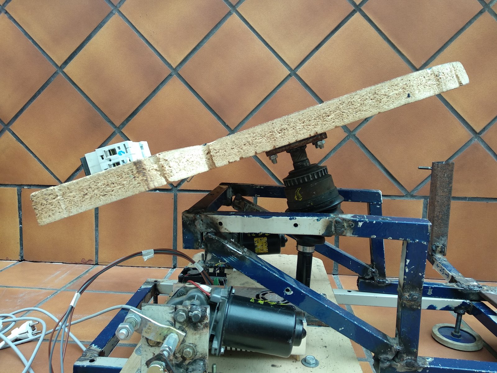

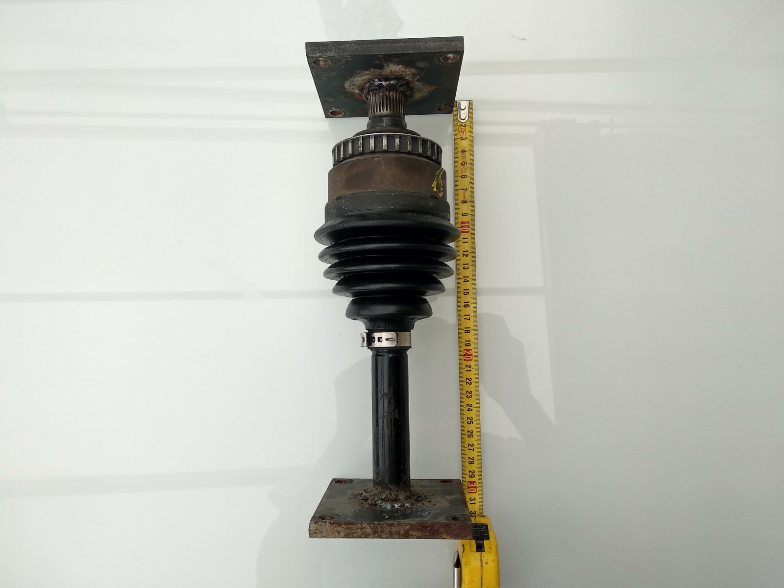

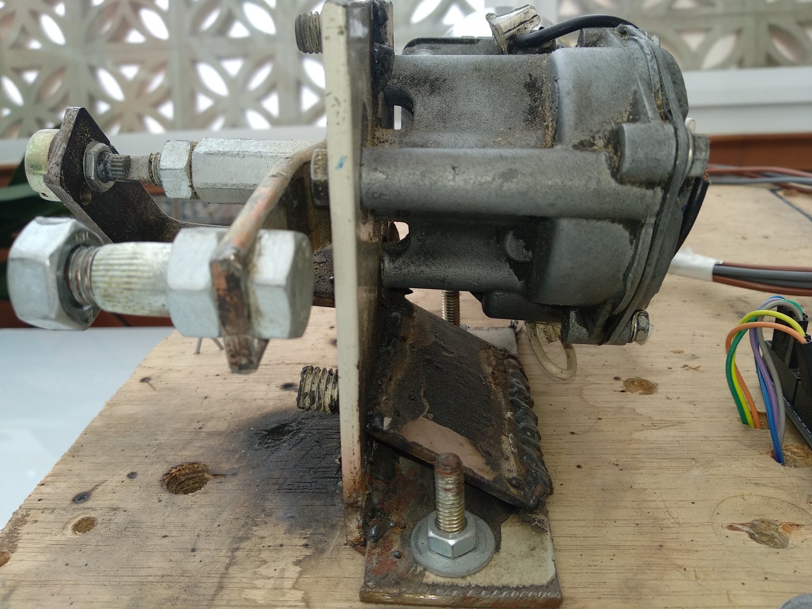

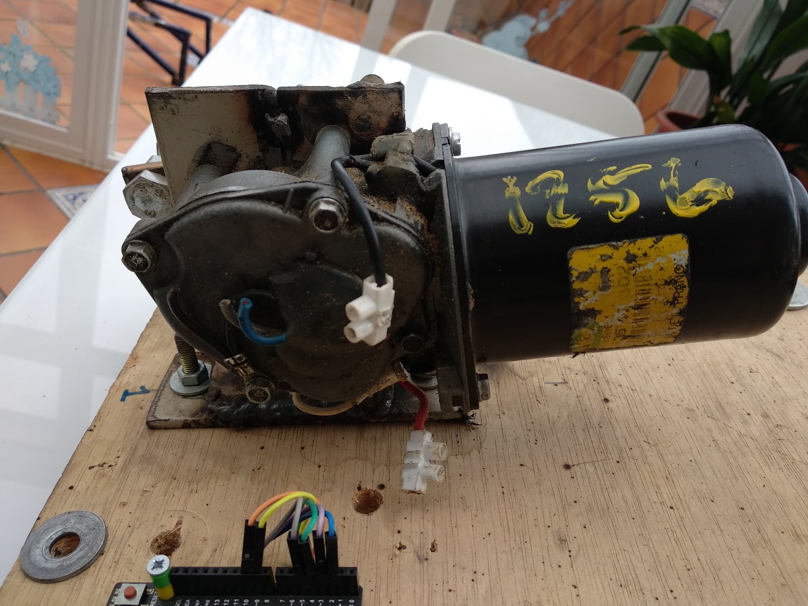

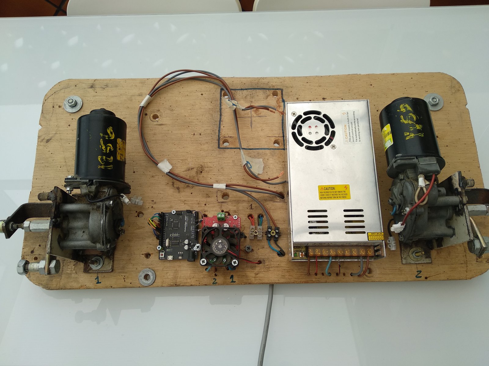

    wiper motor citroen jumpy IMG_20180215_125132.jpg IMG_20180215_124538.jpg IMG_20180215_125117.jpg

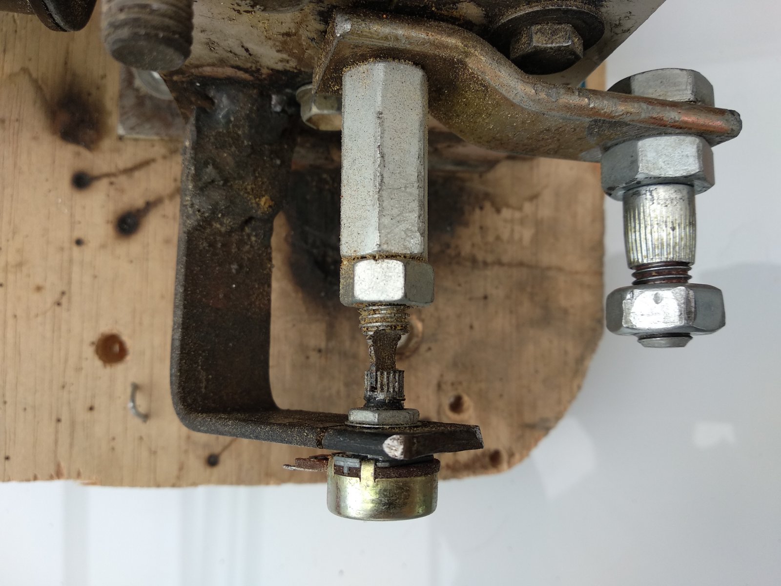

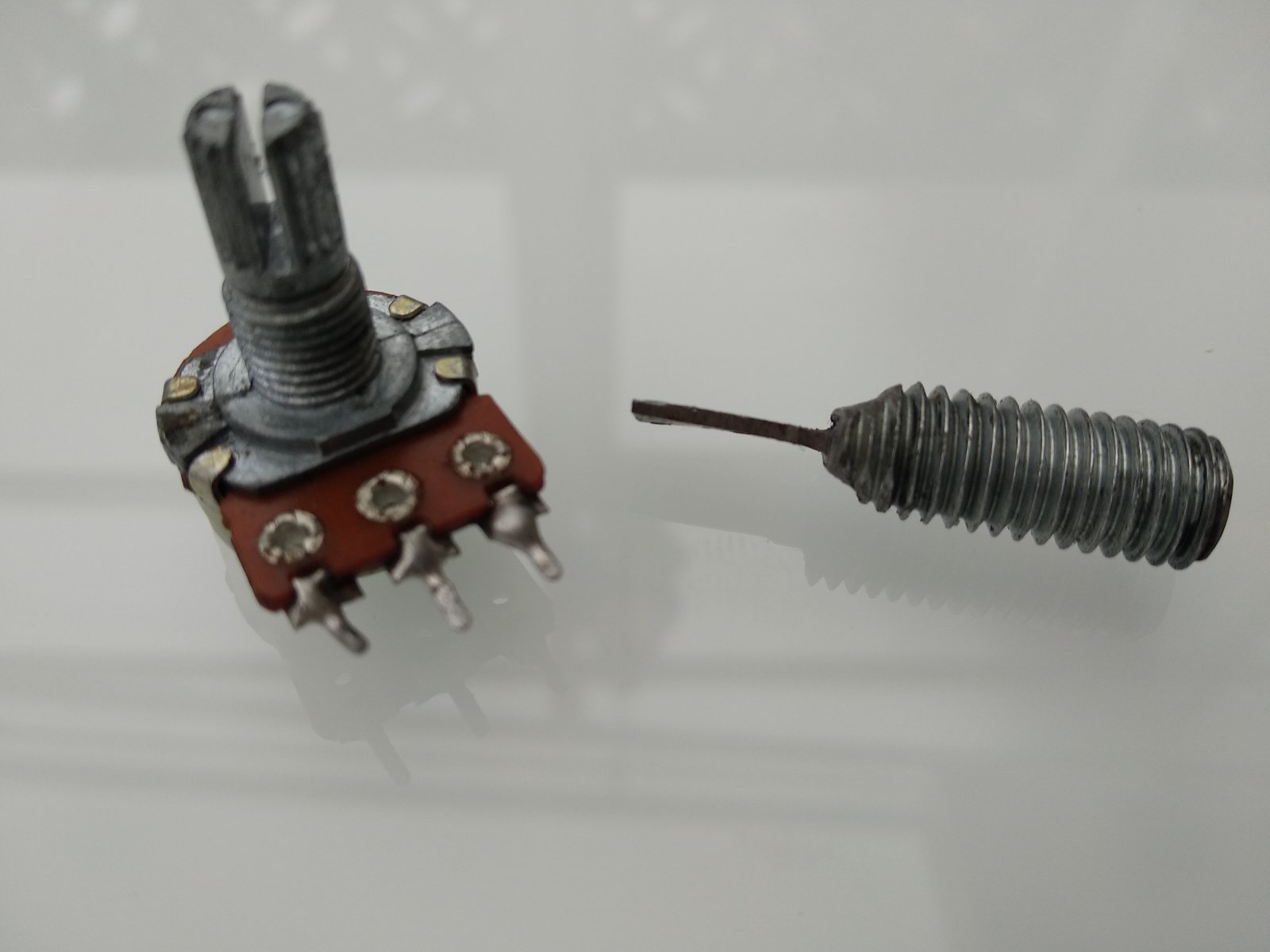

    screw cut and filed embedded in the potentiometer

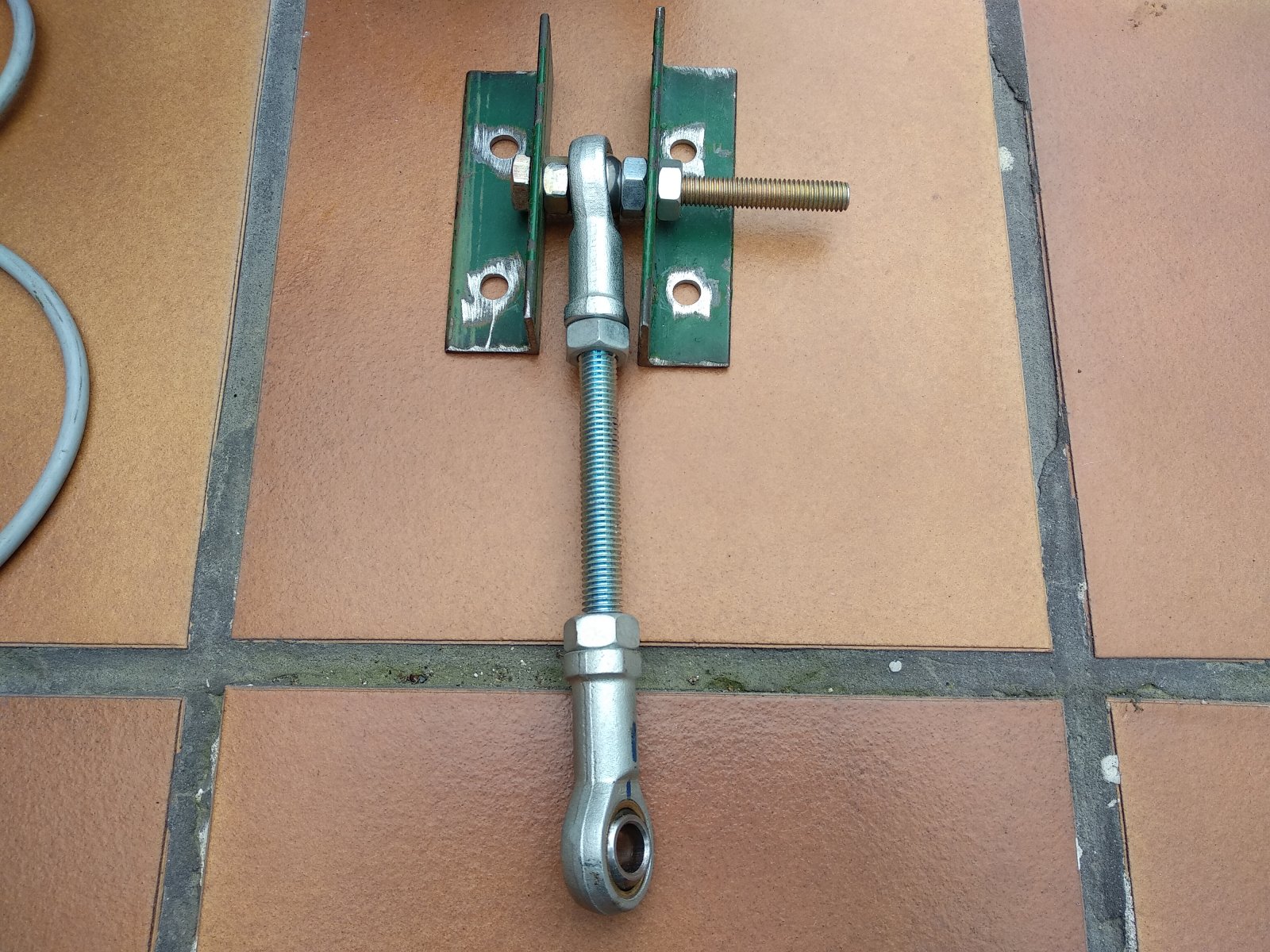

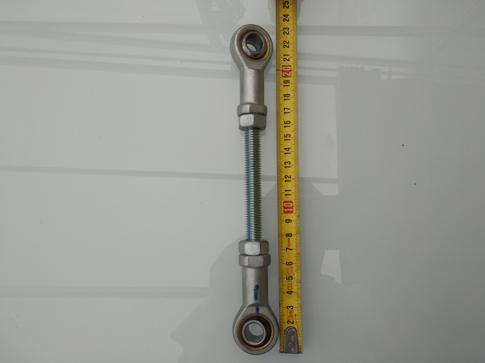

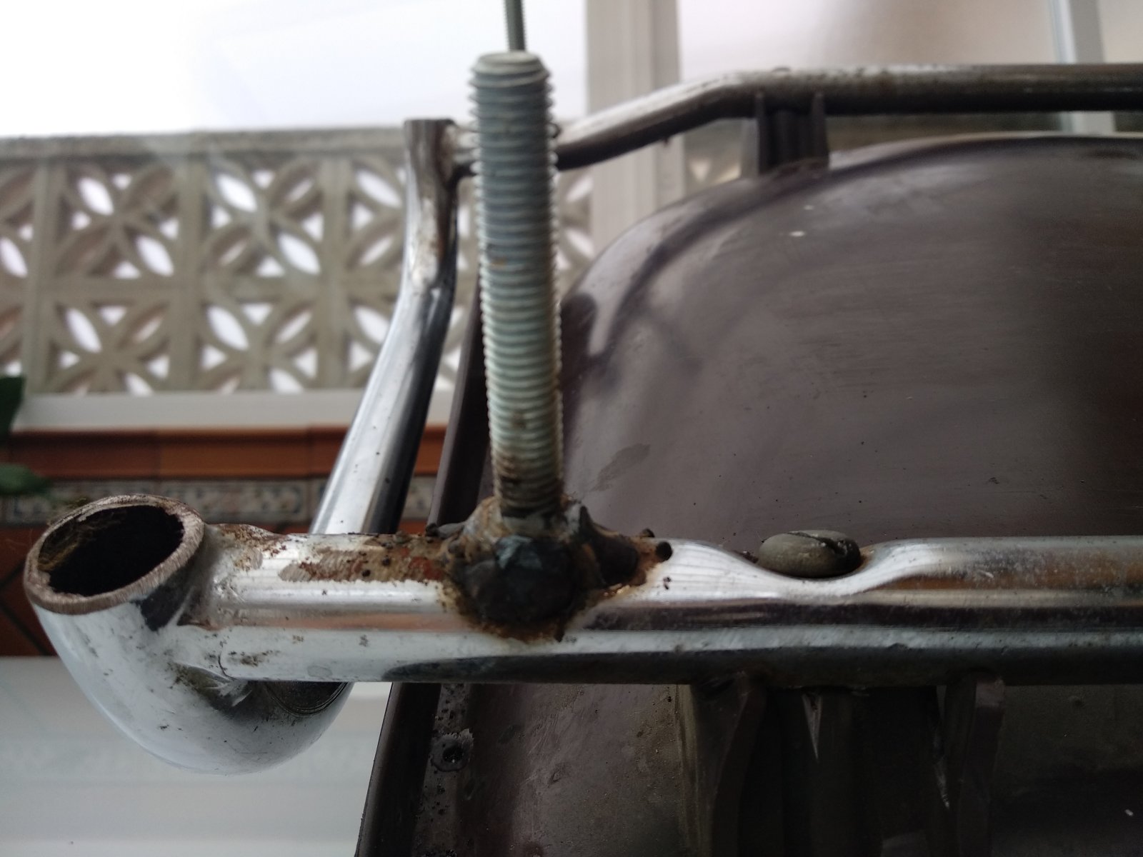

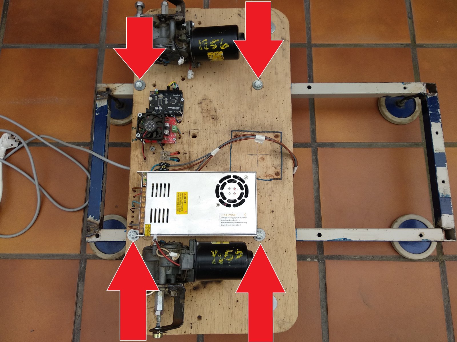

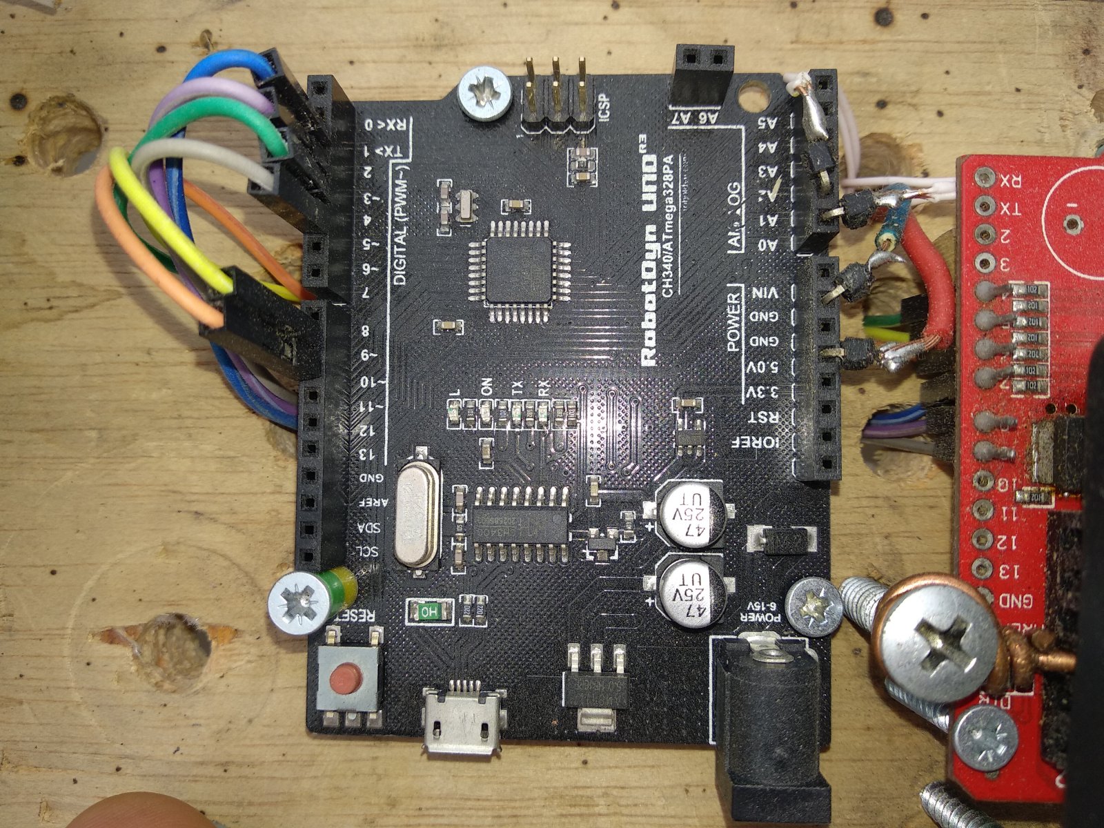

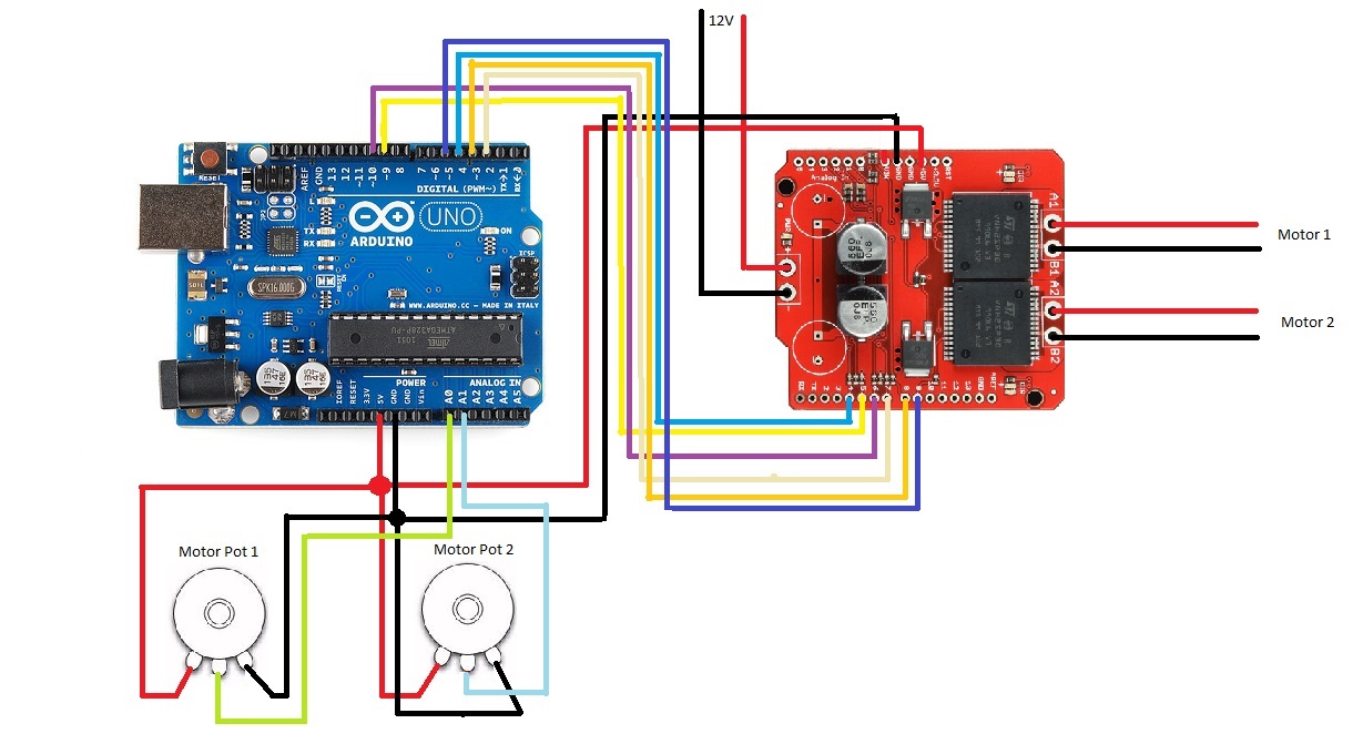

  11. satbranigan
    satbranigan Member
    Dec 23, 2015
    38
    spain
    343Coins
    +65 / 0 / -0

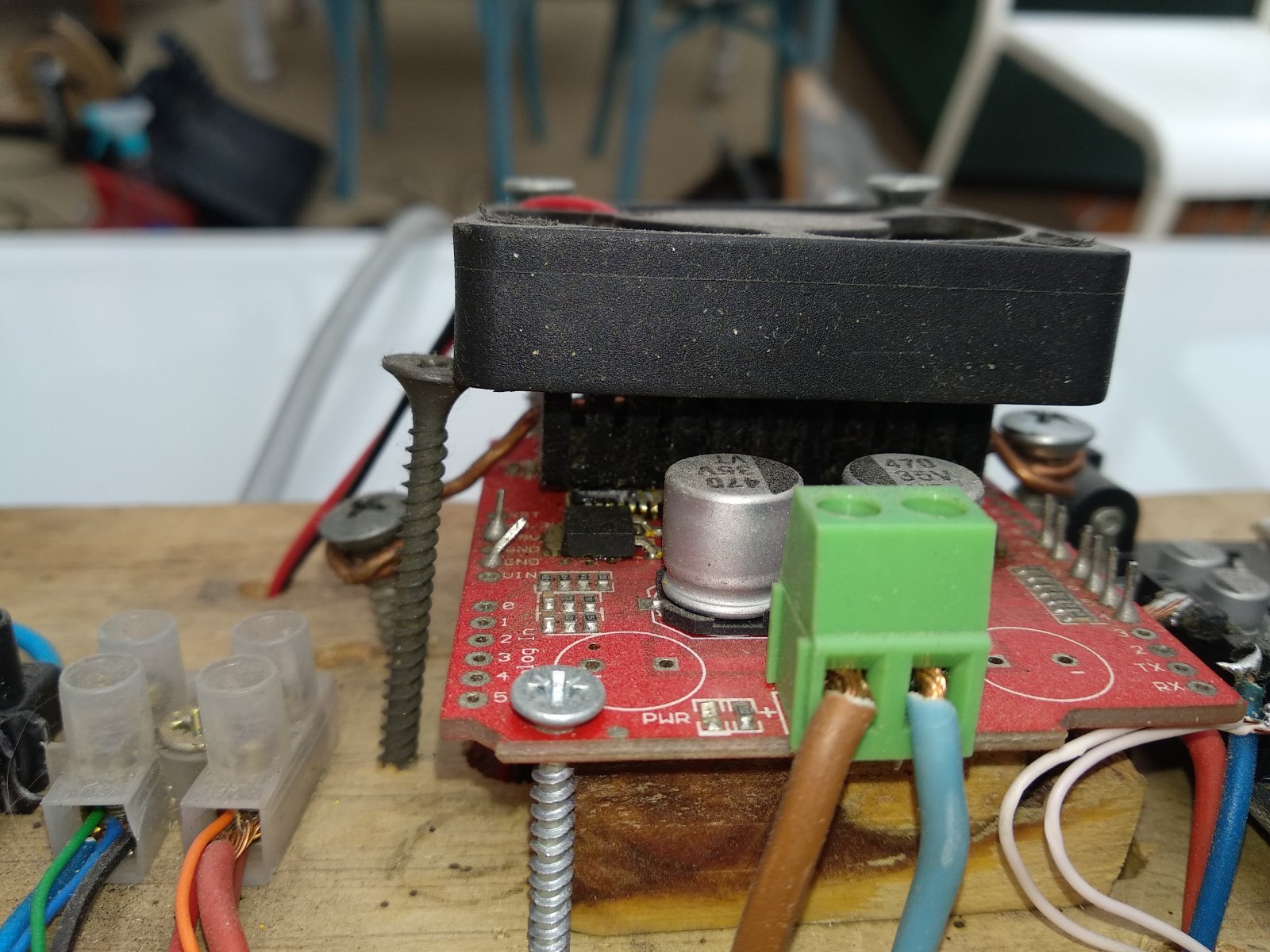

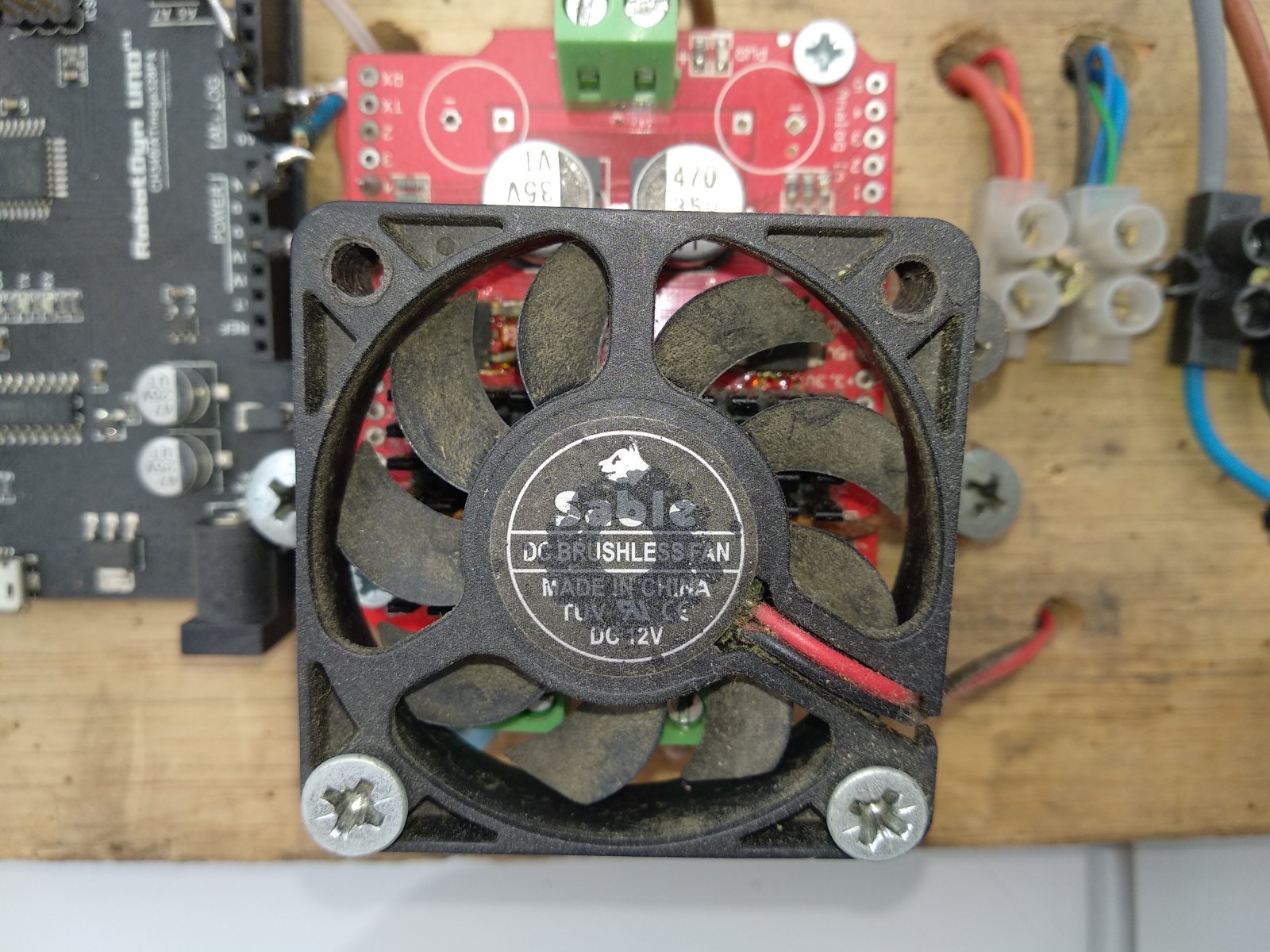

    monster moto shield, with a heatsink and a small fan IMG_20180215_124638.jpg IMG_20180215_124654.jpg
  12. satbranigan
    satbranigan Member
    Dec 23, 2015
    38
    spain
    343Coins
    +65 / 0 / -0

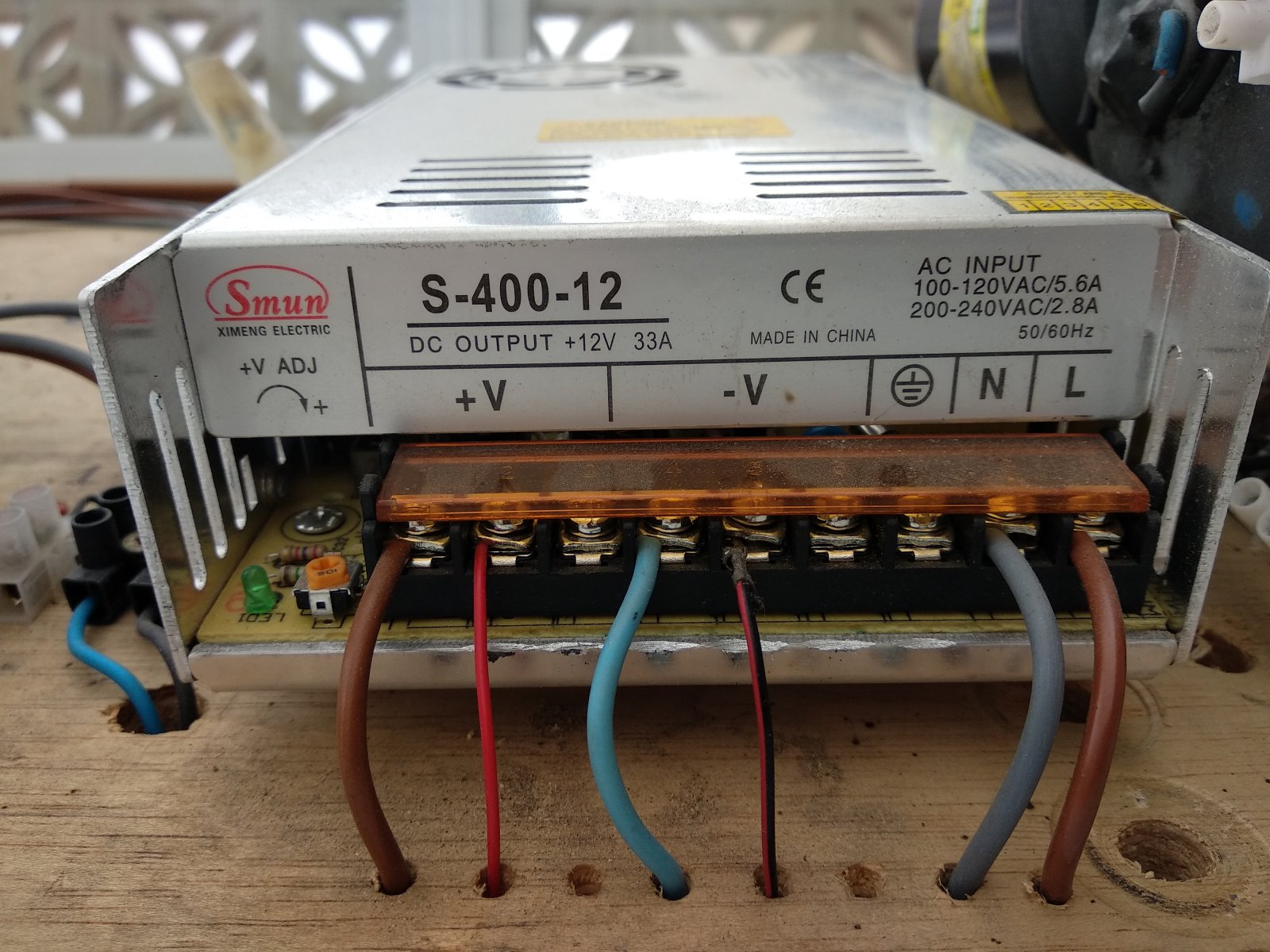

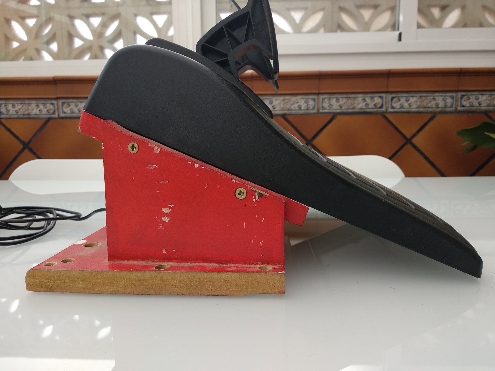

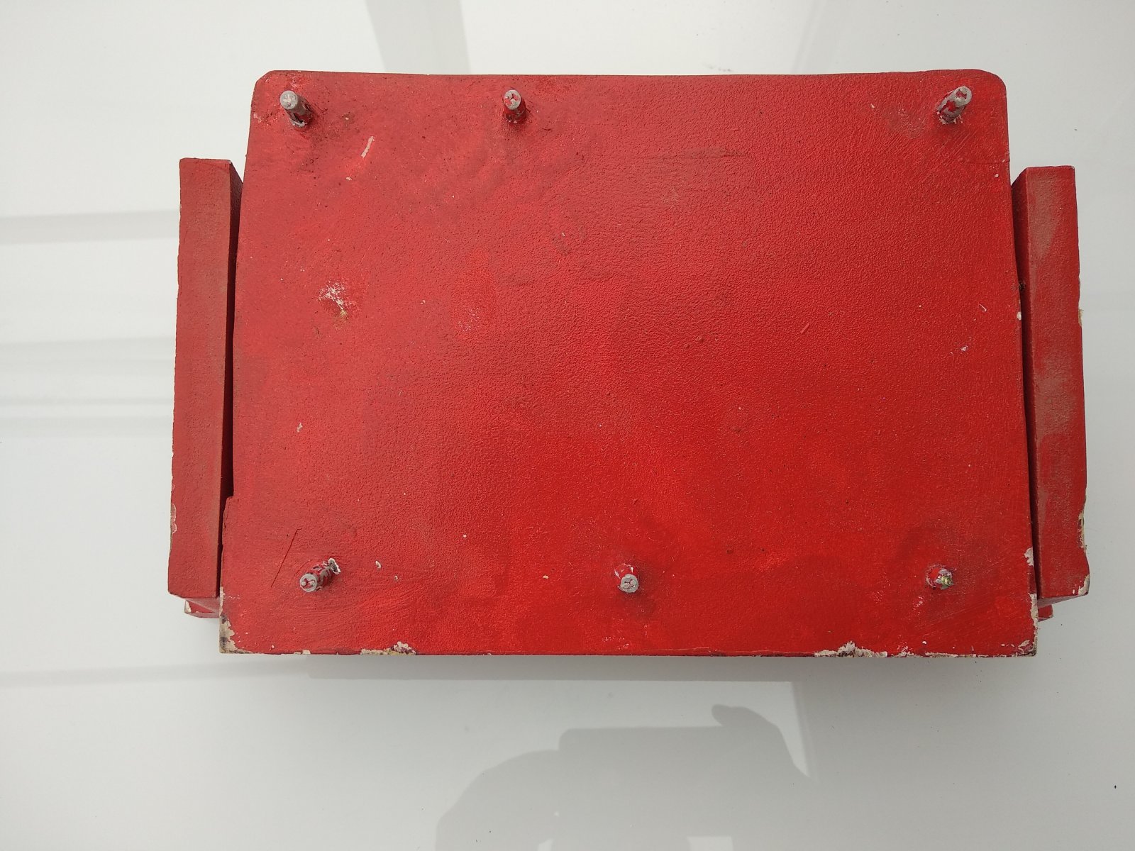

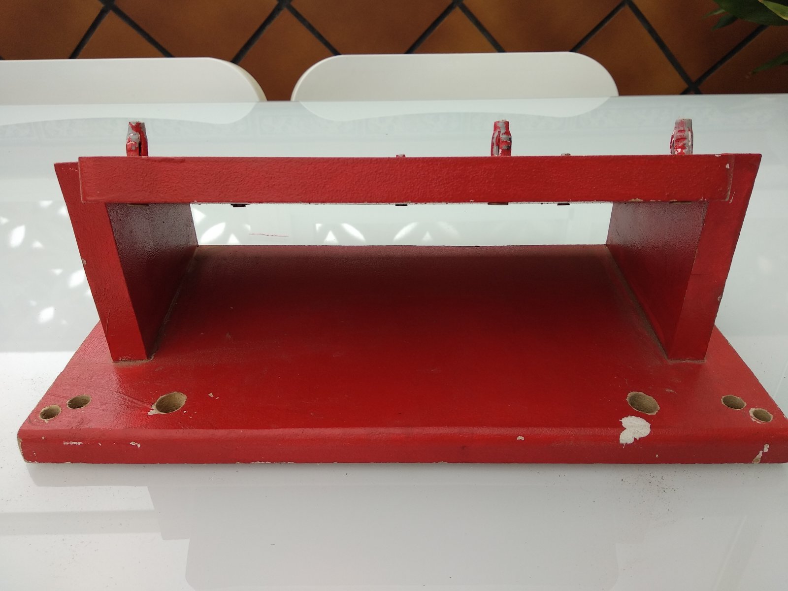

    wooden base for the pedals IMG_20180215_131118.jpg IMG_20180215_131141.jpg IMG_20180215_131210.jpg
  14. satbranigan
    satbranigan Member
    Dec 23, 2015
    38
    spain
    343Coins
    +65 / 0 / -0

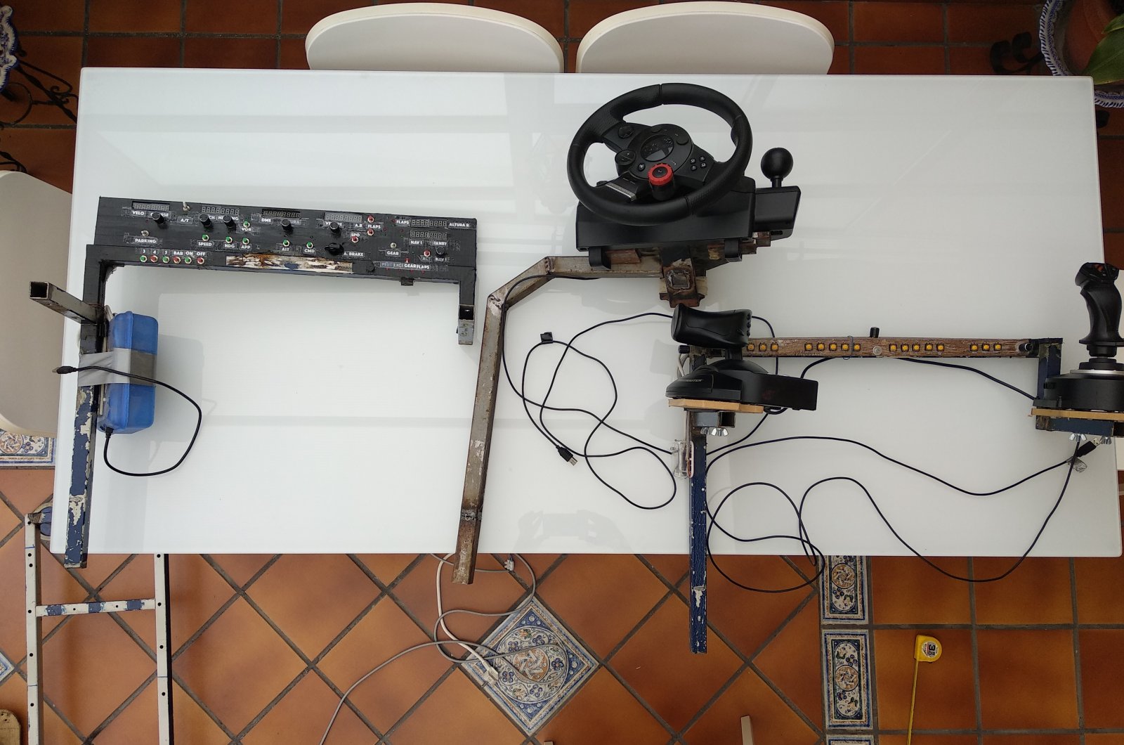

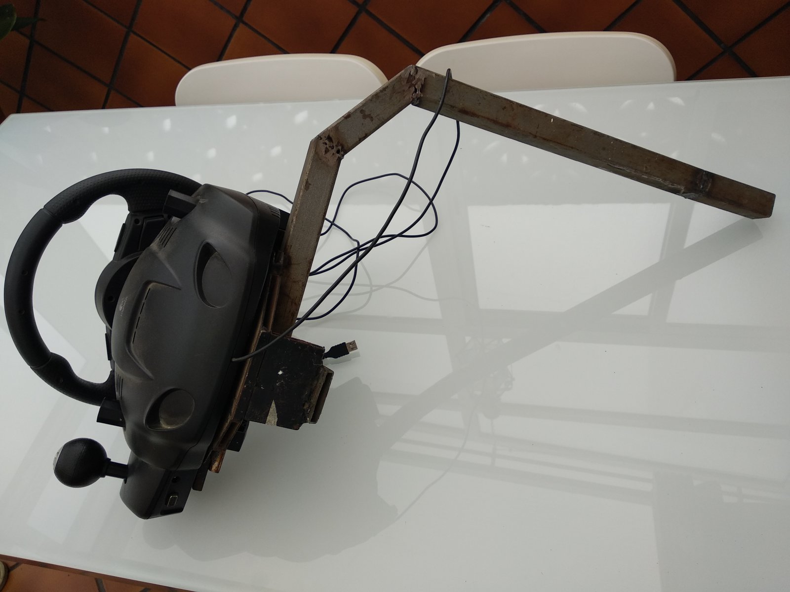

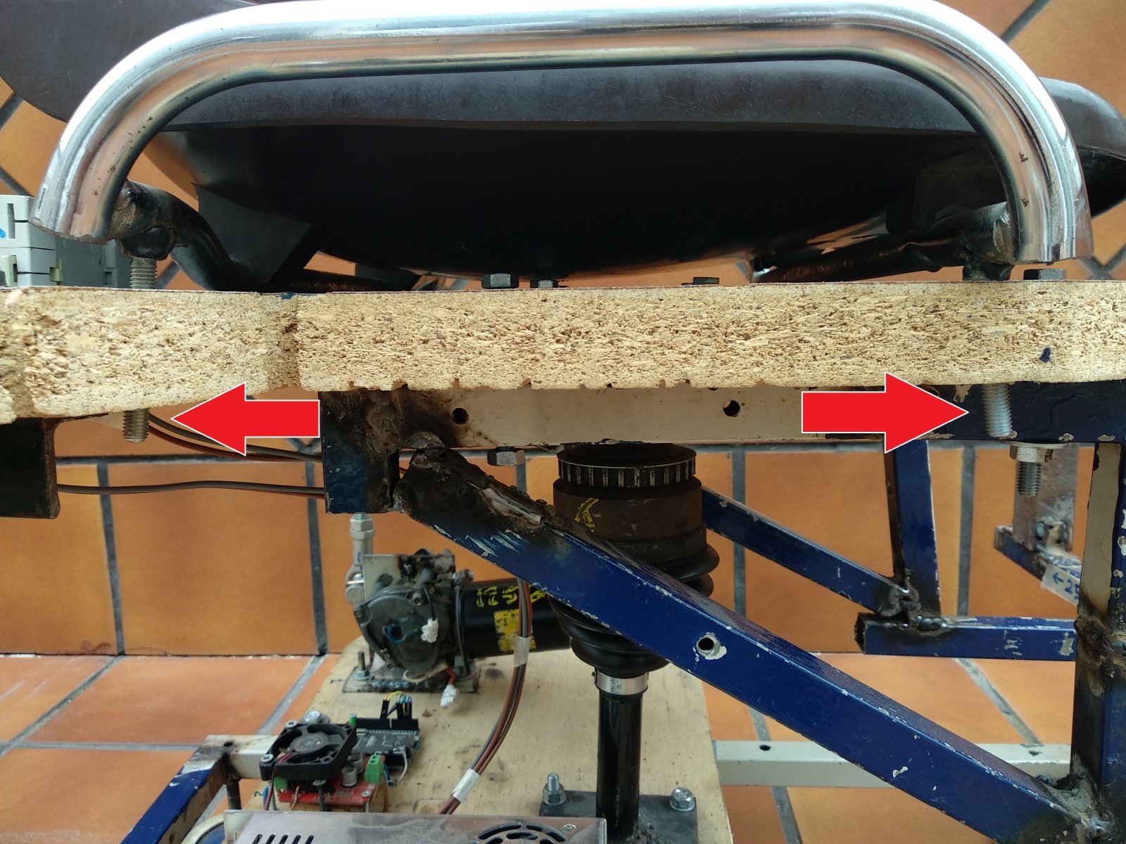

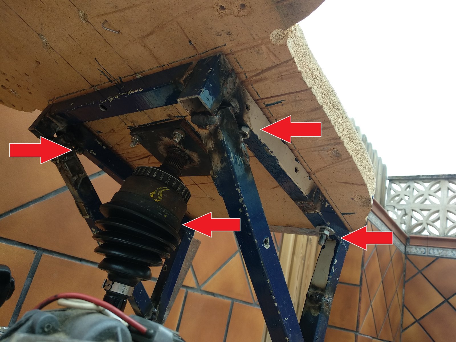

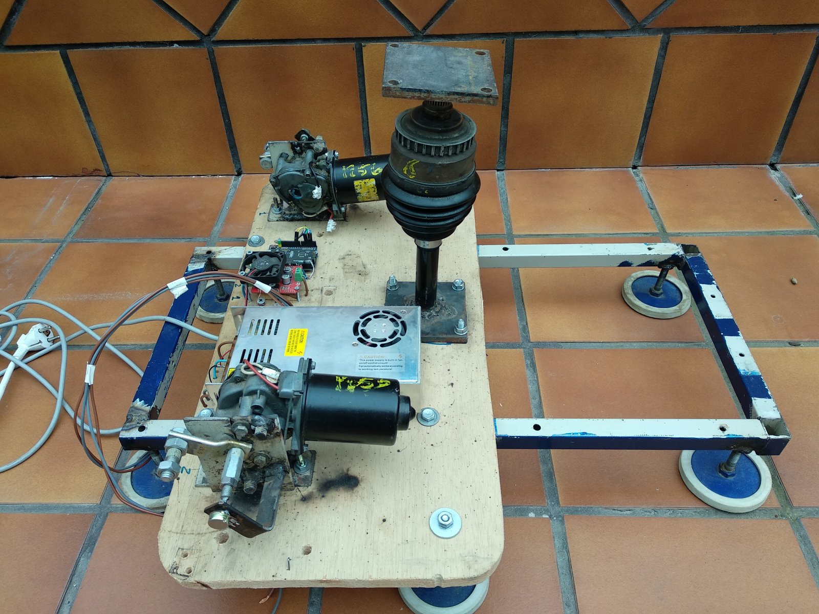

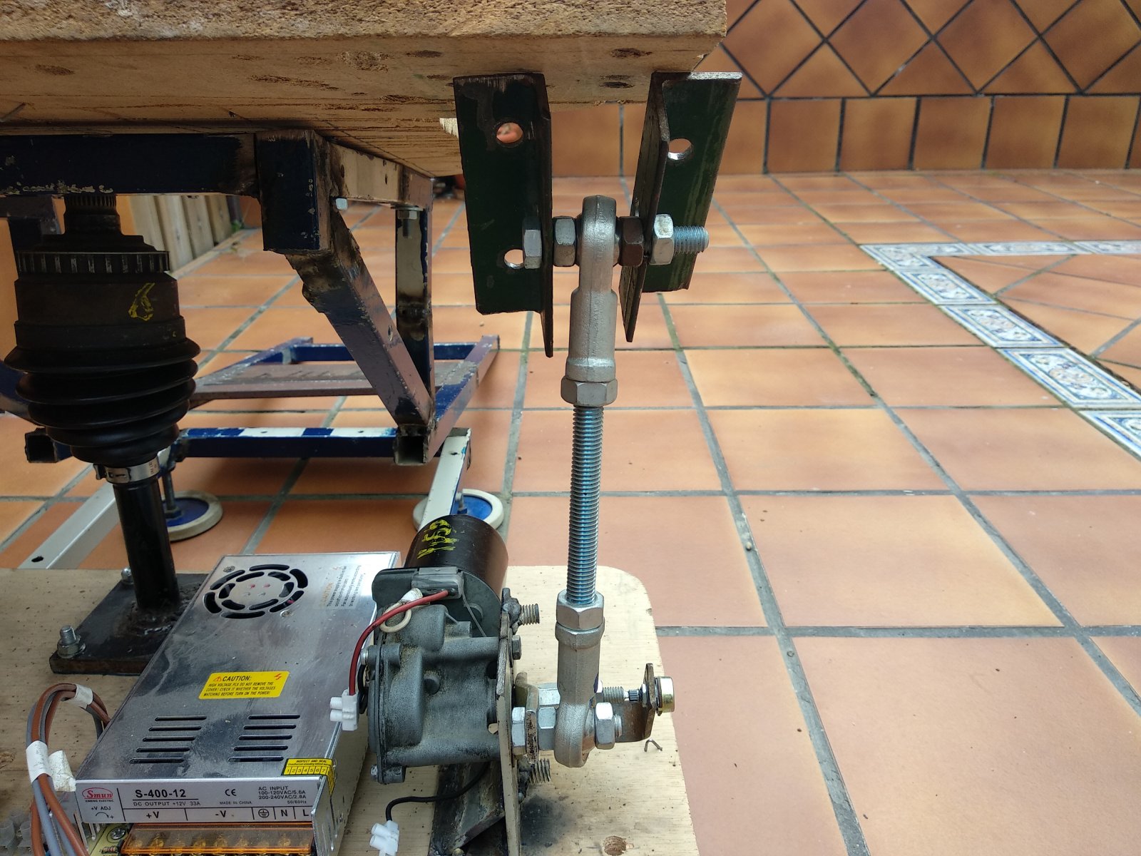

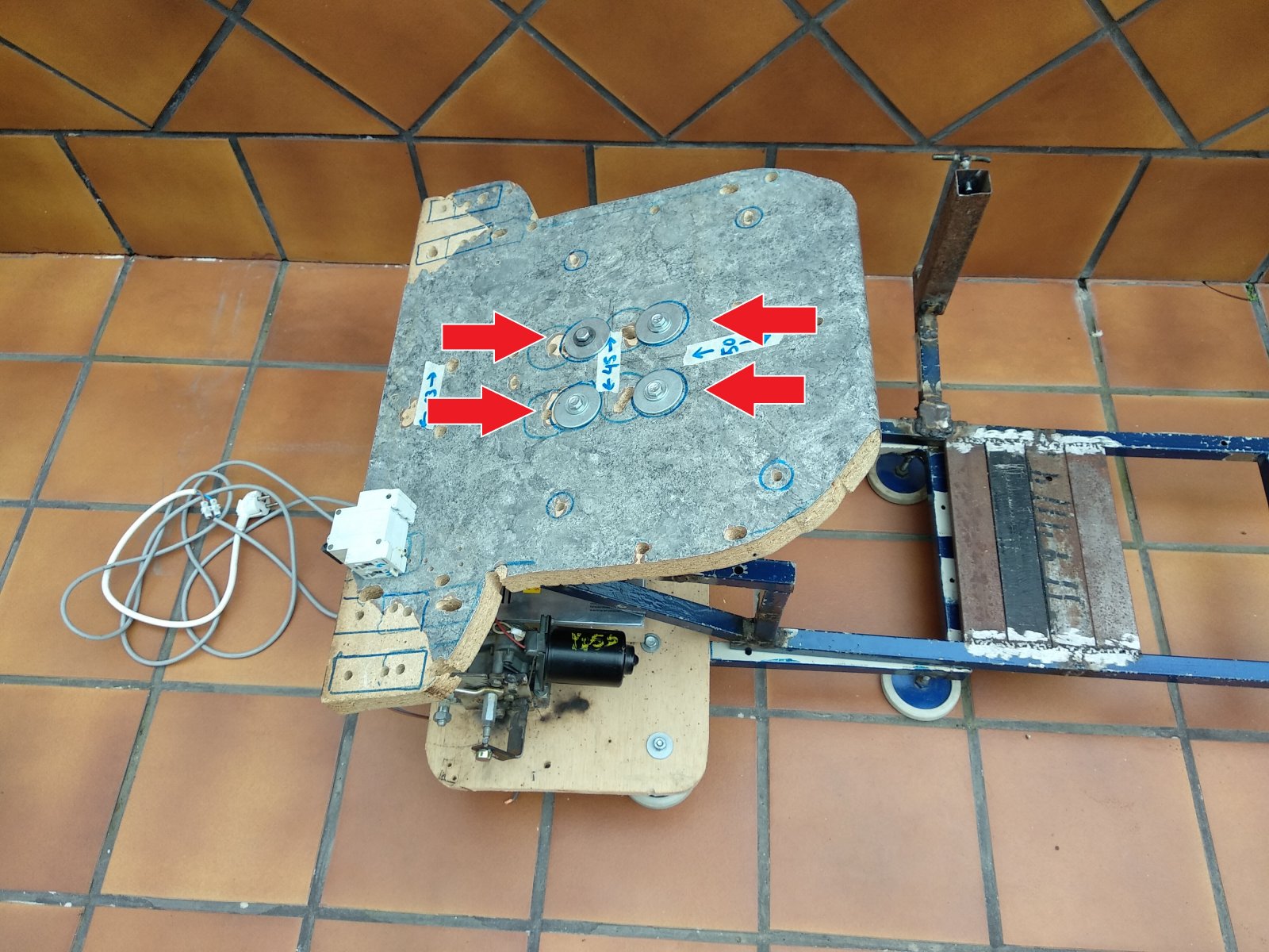

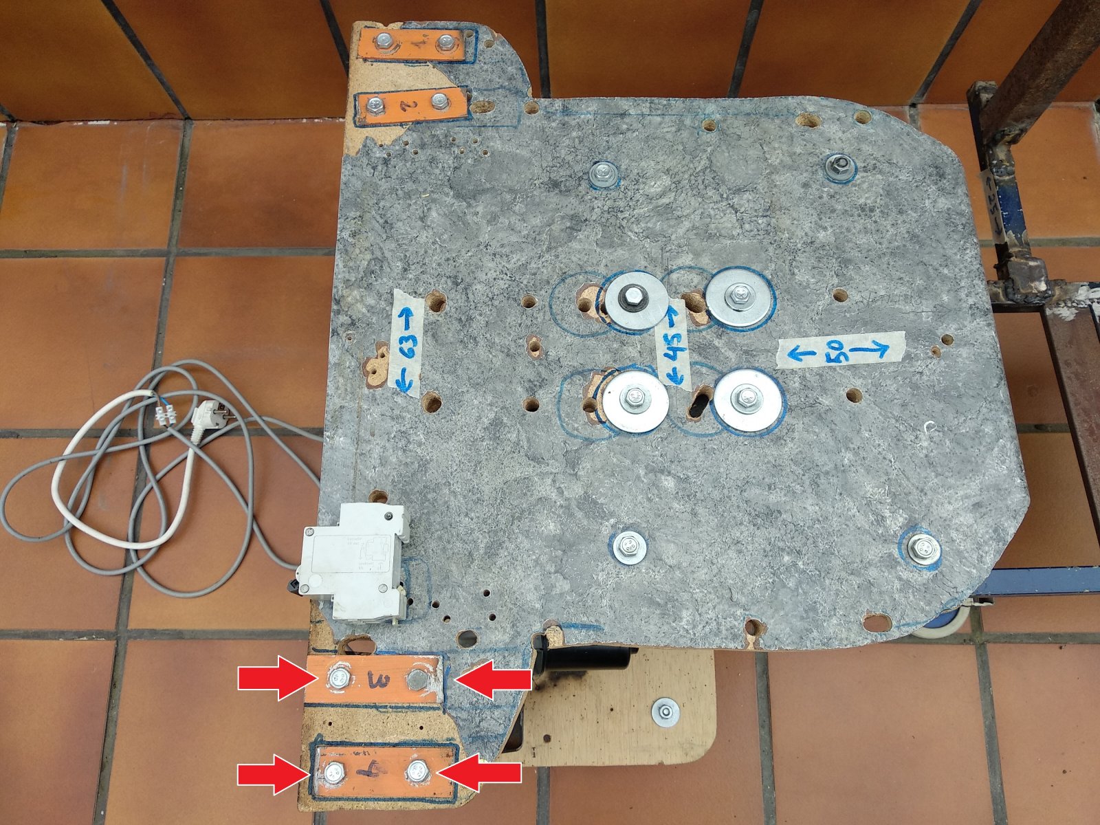

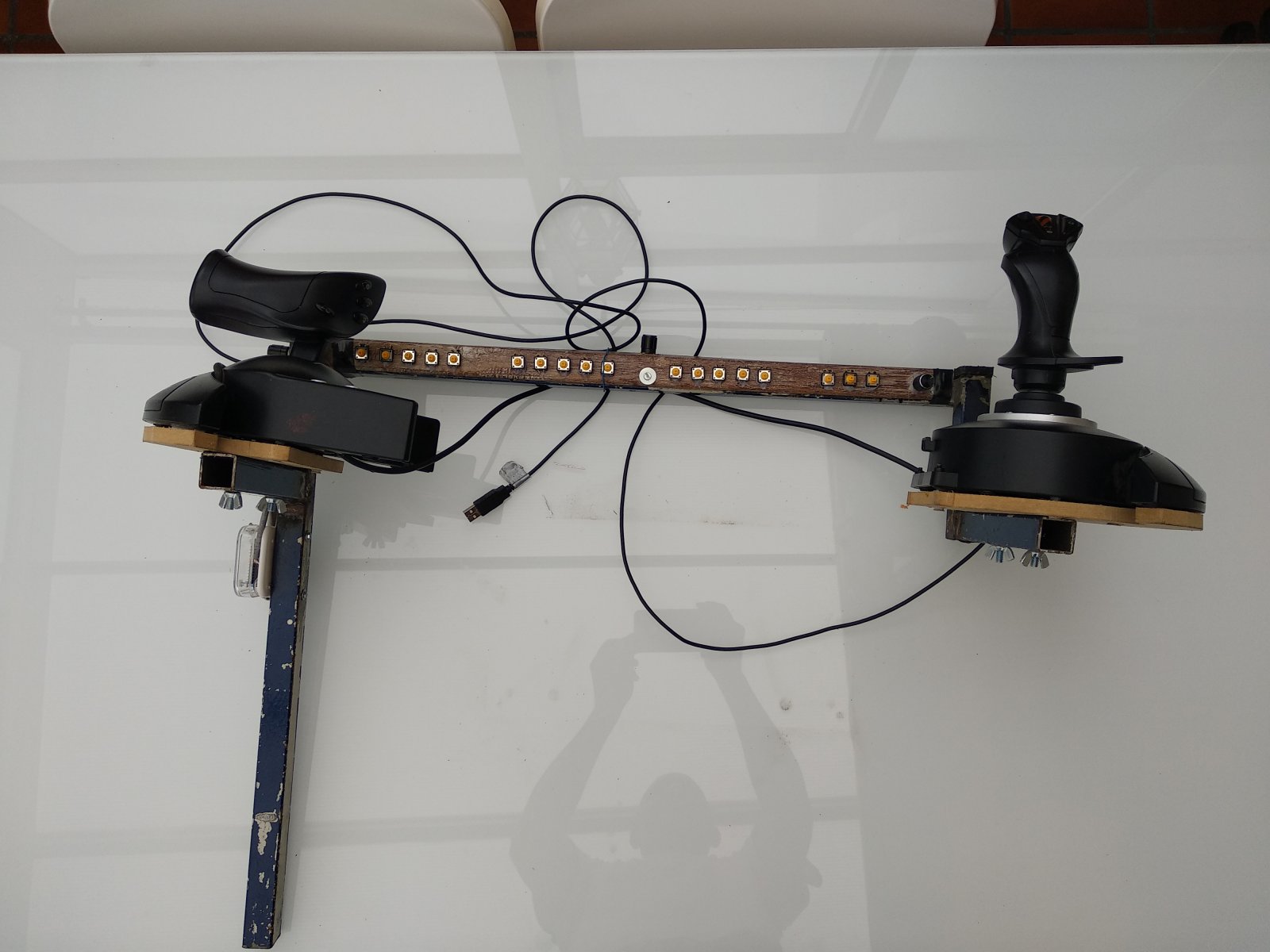

    LET'S START THE ASSEMBLY IMG_20180215_131352.jpg IMG_20180215_124444.jpg IMG_20180215_124944.jpg thanks to @eaorobbie for drawing MotoMonsterSetup.jpg madera tornillos con flechas.jpg IMG_20180215_132404.jpg encimera con flechas.jpg IMG_20180215_132719.jpg estructura con flechas.jpg estructura por debajo flechas.jpg IMG_20180215_133341.jpg IMG_20180215_133412.jpg rod end arribaflechaqs.jpg IMG_20180215_134054.jpg IMG_20180215_134202.jpg asientro por debajo.jpg accessories
    wheelss.jpg IMG_20180215_130937.jpg IMG_20180215_134747.jpg IMG_20180215_134840.jpg IMG_20180215_134429.jpg IMG_20180215_134557.jpg IMG_20180215_134654.jpg
    - 1 cardan auto. 35 euros scrap auto
    - 2 wiper motor. 30 euros scrap auto
    - 1 power supply. 30 euros aliexpress https://es.aliexpress.com/store/pro...25.html?spm=a219c.12010608.0.0.47305277SgZnap
    - 1 clone arduino one. 4 euros aliexpress
    https://es.aliexpress.com/item/UNO-...32523366108.html?spm=a2g0s.9042311.0.0.7jEjnM
    - 1 monster moto shield. 5 euros aliexpress
    https://es.aliexpress.com/item/Mons...32462879576.html?spm=a2g0s.9042311.0.0.6yEa5b
    - 2 potentiometer. 1 euro aliexpress
    https://es.aliexpress.com/item/Free...32386383331.html?spm=a2g0s.9042311.0.0.sfKLUy
    - 4 rod end joint bearing. 5 euros aliexpress
    https://es.aliexpress.com/store/pro...2482-4e0c-b9b9-5bdc5f8a73b2&priceBeautifyAB=0
    - 1 fan. 2 euros aliexpress
    https://es.aliexpress.com/store/pro...13ca-4c63-b331-dcba5704cbc1&priceBeautifyAB=0
    - 1 heatsink. 1 euro aliexpress
    https://es.aliexpress.com/item/2pcs...32239534234.html?spm=a2g0s.9042311.0.0.iEAxb1
    - 12mm threaded rod. 2 euros
    - rest of material. 35 euros scrap warehouse
    SOFTWARE
    -Simtools 1.3
    -SMC3 Arduino

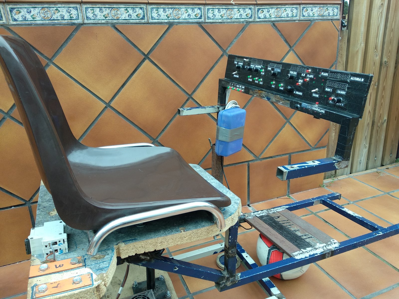

    If you want to see the modification of this simulator, to turn it into a motorbike, visit this link:
    https://www.xsimulator.net/community/threads/i-finished-my-motorbike-simulator-2dof.11790/
