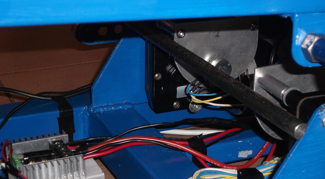

    Broken :mad::mad:
    I was trying to get the motion profile in Sim Tools setup but it would only pitch forward and stop and would not come back when doing manual tuning and I would have pick it up and move it back to the center position and that is when I noticed the whole motor mount was moving which I thought was just some flex, but oh no it has cracked above the weld and is almost cracked right through.
    So I will have to tig up the crack, and I am adding a 16mm. thick bar as a brace between the two motors and hopefully that will stop the flexing.
    No happy Jan, but at least my weld did not fail if that is a bonus or not. :(
    Pic shows the brace that I will be welding onto the motor mounts.

    At least you caught it before more damage was done.
    I use a brace between the motors on my rig and it greatly adds to structural rigidity.

    I should have used 6mm. steel plate for the mounts instead of 4mm. but the thing weighs a ton as it is.
    It's handy being a bachelor because if I was still married she might object to me welding inside the house as I don't want to completely
    dismantle the whole thing when I can hit it with the tig welder that makes no spatter and does a neat job with better weld penetration.

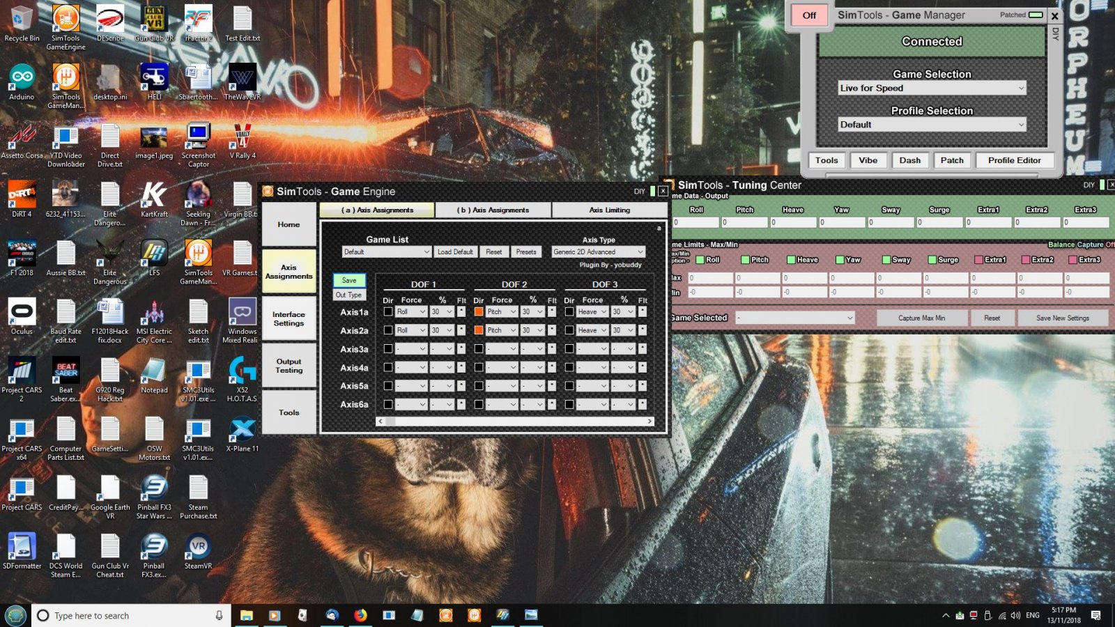

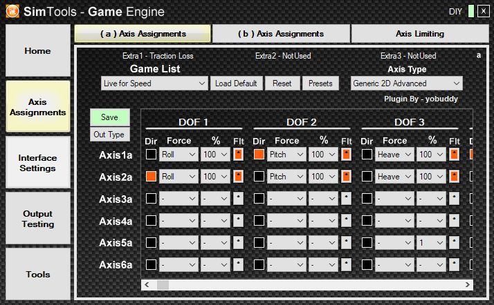

    OK.
    Well I welded up the motor mount and added the motor brace so it is know nice and solid and it is almost behaving as it should all bar for one small problem.
    My roll is Pitching and my Pitch is rolling !
    I set them in the same sequence as Sim Tools Tuning Center is laid out.
    I tried switching the axis arrangement around and it made no difference, so where am I going wrong ?
    Here are my screen grabs

    The DIR box being checked orange or not determines which way each axis moves, so for sway one is checked and the other not, while roll will have the opposite, this is how SimTools expects each axis to be configured: https://www.xsimulator.net/community/faq/which-way-to-set-simtool-axis-movements.230/

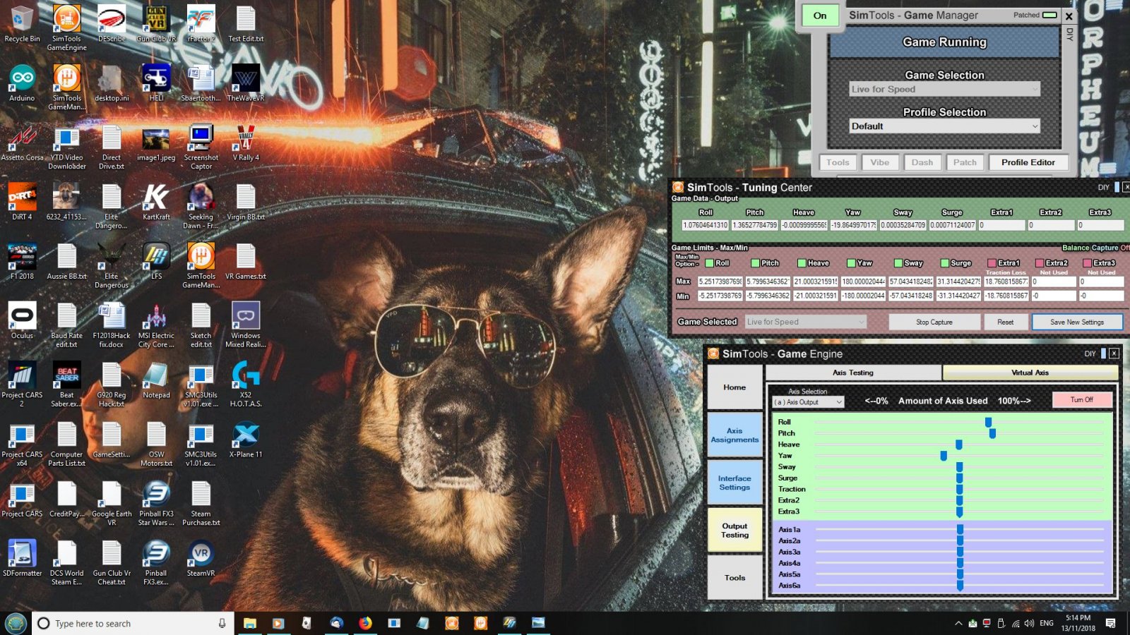

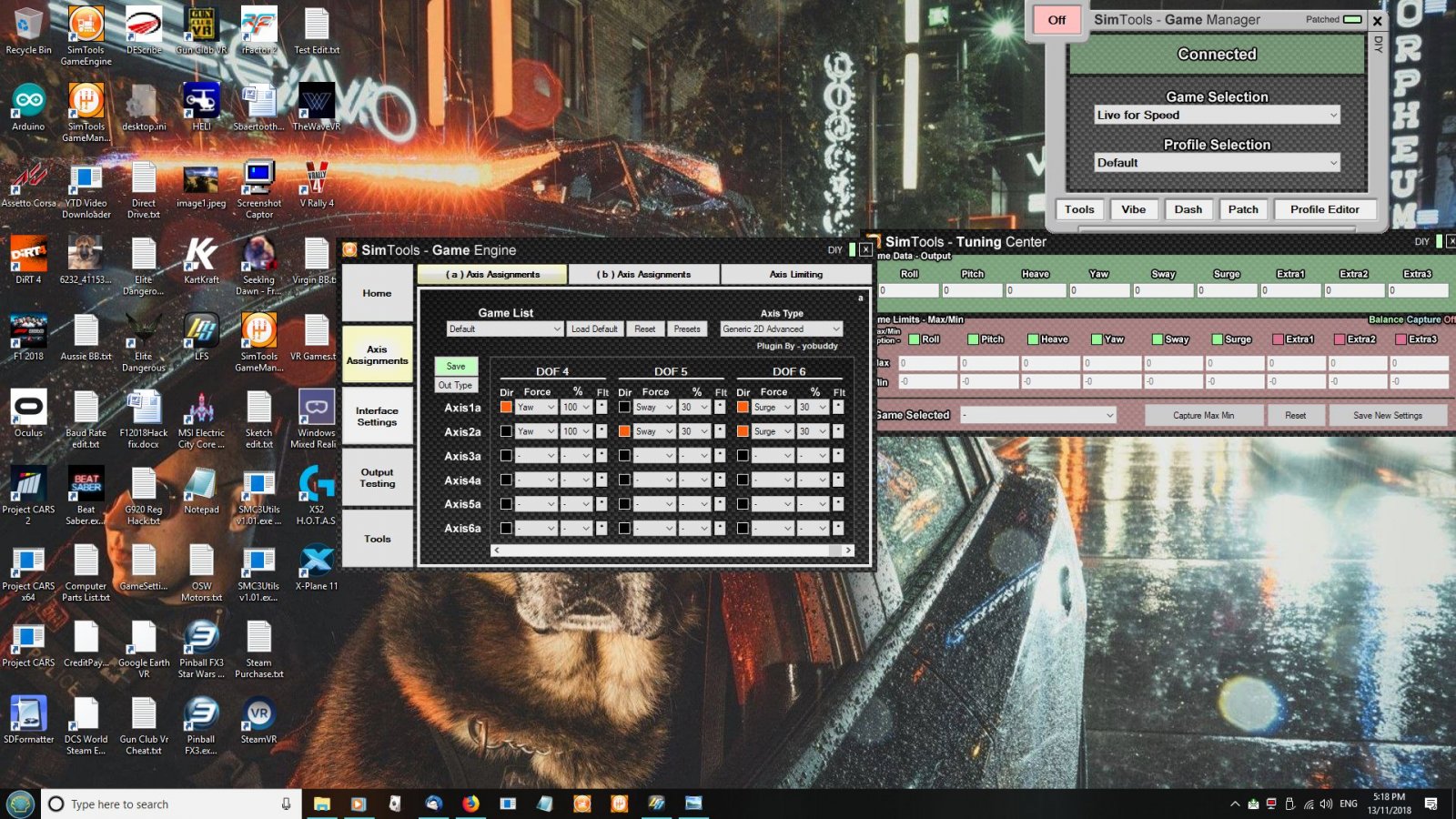

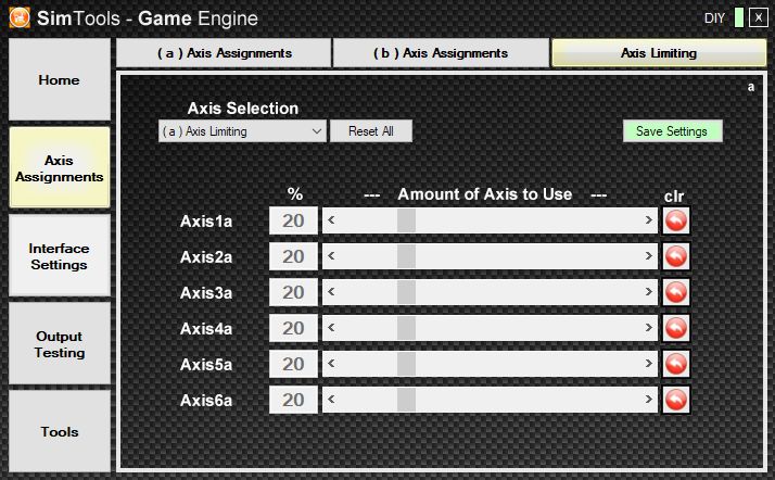

    OK, so I fixed the problems with my settings and it's now doing what it should be doing, except it want to kill me by throwing me out of the seat especially on pitch and roll.
    From memory I had Roll @ 30% and Pitch @ 20% and it's movements were violent.
    So I Upped the % values on both Pitch and Roll to 100% each and that tamed it down a little but it is still too violent to drive comfortably.
    I also have moved the motors lever points back by 2 holes and that has moved the lever length from 100mm. to 50mm. from the pivot point and I still have two more holes that I can go back on if needed.
    It also has equal mount points on the rig that gives me lots of leverage points and % points of movement
    I have not changed any of the DOF filters yet, but I have turned on Ant-Rollover on all DOF's
    Can I go over 100% in DOF force settings as I understand the larger the number the softer the output is opposed to low % values.
    Here are my screenshots with the current settings.

    Don't increase the Axis Assignment value, that will only result in clipping: https://www.xsimulator.net/community/faq/axis-assignment-percentage-totals.120/
    Instead Capture Min/Max in the Tuning Center and tweak the values there, high values soften motion, lower values sharpen motion. Follow the steps here: https://www.xsimulator.net/community/faq/steps-to-create-a-motion-profile.228/
  16. MarkusB
    Jun 30, 2015
    552
    4,215Coins
    +597 / 2 / -0
    Hi @Deane,
    in addition to @noorbeast 's very true comments I saw that there is definitely still a basic mistake in your settings, revealed in this screenshot:
    • "Roll" is a movement in which both motors turn in different directions.
    • "Pitch" is a movement in which both motors turn in the same direction.
    For this reason it cannot be correct that only one check box is checked "orange" for both DOFs.
    Instead, either roll or pitch needs to have only one check box set to "orange", while the other DOF has both check boxes set to the same value (i. e. orange or black).
    The easiest way to find out the correct direction settings is to only have one DOF (i. e. either Roll or Pitch) enabled and the other one set to 0%.

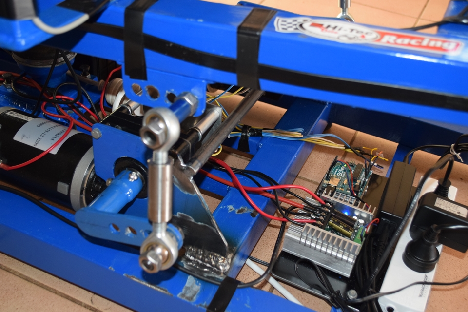

    The "fun :( " just keeps coming for me.
    I am slowly learning how to configure motion profiles etc and using my sim but in doing so I have managed to damage one gearbox by inadvertently driving it over center and jamming it which has hammered the soft bronze spur gear and now it sounds like this https://drive.google.com/open?id=1imFMmJ_iLPbkipIEcF4DdOofd5UEQj7t
    I have got on to the supplier , Motion Dynamics and they tell me this g/box is not suited to my application and have suggested that it's lifespan would not be very long if I continue to push the g/box
    in a sim, and have suggested I upgrade to heavier duty gearbox that will require some adaption fabrication to fit my motors that I still have and are working fine.
    If I had the spare money I would upgrade the whole package to a pair of motors from this range https://www.motiondynamics.com.au/heavy-industrial/ or if I wanted to rebuild the whole thing I could try some of their Linear Actuators https://www.motiondynamics.com.au/heavy-industrial-ip65/ if they would work ok ?

    Those linear actuators are way too slow, you want at least 150mm+/s.
    I disagree with MD advice, I have had issue with one gearbox, detailed on my build thread, but not the other original 60:1 gearbox on the opposite side, nor the replacement gearbox, and I have been running my rig for years now.
