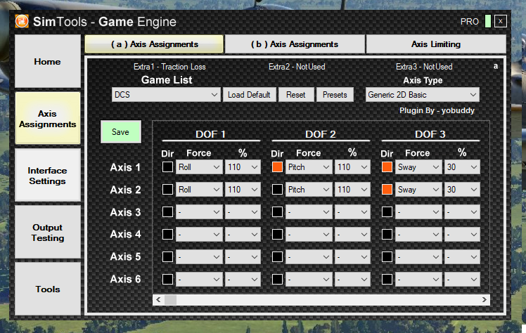

    My 2dofreality simulator jerks and jumps when using DCS.
    I have attached the Game Engine
    Please Help

    At 220% your total Axis Allocation is way too high: https://www.xsimulator.net/community/faq/axis-assignment-percentage-totals.120/
    See here regarding the steps to create and refine a motion profile: https://www.xsimulator.net/community/faq/steps-to-create-a-motion-profile.228/
    Your Dir allocations check boxes are also likely messed up, as if properly set sway will lean away from a corner and roll will be set the opposite, this is what SimTools expects: https://www.xsimulator.net/community/faq/which-way-to-set-simtool-axis-movements.230/

    @James Bomar,
    Hi Buddy,
    I will need to a pic of your sim to help you with the settings.
    So i know what kind of setup we are trying to get running.

    It is a 2dofreality rig, which in addition to the setup issues I noted also need to be carefully balanced according to other owners.
