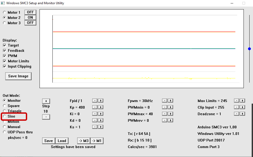

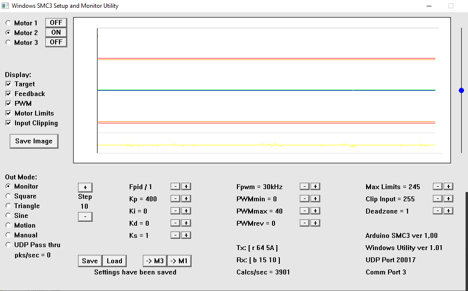

    So you had it working with RC servos not the issue is converting to motors and SMC3, is that correct: https://www.xsimulator.net/community/threads/test-with-rc-servo.17780/#post-237726
    The video is not clear enough so please post pictures of all SMC3 settings.
    My guess is the PWMmax may be too low, these are the SMC3 setup steps and we need to know what the PWMmax value is when the motors start to move:
    8. Set Kp to about 400
    10. Do the above for each motor

    yes exactly with the rc servos it worked but now I wanted to do a test with the motors in order to then move on to building a real simulator.. I followed the procedure you said setting everything to zero, the KP to 400 then I raised PWmax slowly and the motor makes a very small rotation when I reach the PWmax at 40 but it stops immediately, and if I move it it goes back to that point.
    21,597
    151,245Coins
    Can you please run the Sine in Out Mode at 40, then at 100 for PWMmax, and post a picture for both.

    sorry what does "in sine mode" mean? anyway now I have to go to work, tonight I'll try again thanks.
    21,597
    151,245Coins
    Check the box for Sine in Out Mode:

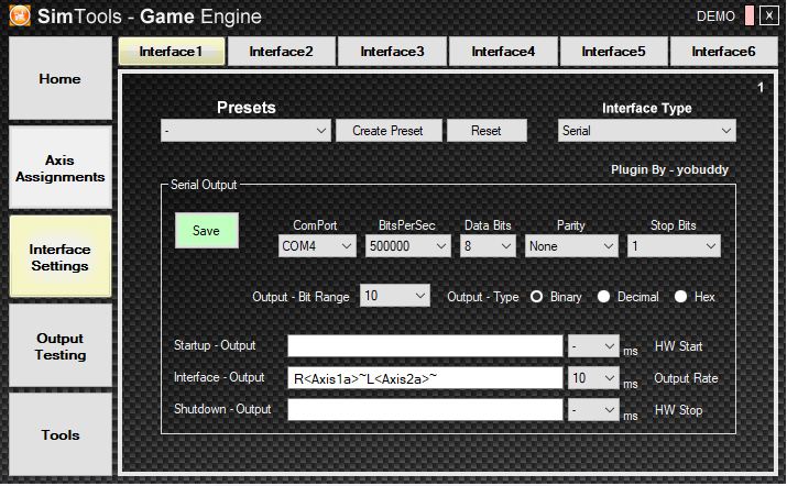

    this is what it does, i kept the potentiometer unplugged, should i have left it plugged in instead?
    I understand that I said is wrong.. now I connected the potentiometer and increased the value a bit to follow the green line, right? but i also tried to start the sim tool but i cant get it to move.
    21,597
    151,245Coins
    Yes pots need to be connected and SMC3 configured to ensure proper tracking responses tuned to your hardware.

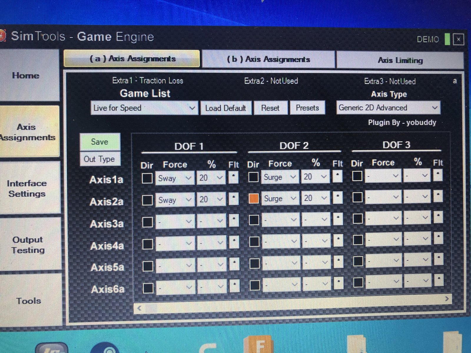

    For SMC3 the SimTools Interface Output needs to be set to: [A<Axis1a>][B<Axis2a>]
    Grab a copy of the SimTools manual and keep it handy for reference: https://www.xsimulator.net/community/faq/rtfm-start-with-the-official-simtools-documentation.117/
    The FAQs have some great settings tips: https://www.xsimulator.net/community/faq/simtools-settings-tips-and-tricks.18/category
    In particular, your Axis Assignment total allocation should be around 100% total: https://www.xsimulator.net/community/faq/axis-assignment-percentage-totals.120/
    The DIR checked orange or not determines which way each axis moves, this is what SimTools expects: https://www.xsimulator.net/community/faq/which-way-to-set-simtool-axis-movements.230/
    And see the tuning tips here: https://www.xsimulator.net/community/faq/steps-to-create-a-motion-profile.228/

    thanks, in the end last night I managed to make it move with live for speed, I'd say that I'm done with the miniature tests now I want to start making them with bigger engines and start building a simulator! always to start one step at a time and not waste too much money, I thought about going into demolition and getting 2 windshield wiper motors and buying this power supply:

    I don't understand one thing, for the classic movement of a 2dof what should I put? then the percentage next to what is it for? for the strength or for the working angle?
  19. noorbeast
    21,597
    151,245Coins
    Even with a 2DOF you can configure sway, surge, heave, roll and pitch.
    What % Axis Allocation is something you tune for each game, depending on the response of your rig and personal preferences, there is no 'magic' set of numbers.
    You should initially do each axis one at a time, do check out the motion profile tuning tips in the FAQs: https://www.xsimulator.net/community/faq/steps-to-create-a-motion-profile.228/
