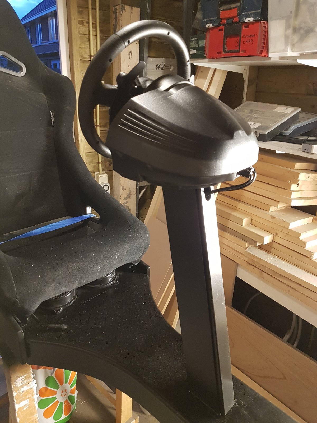

    Checking whether the steering wheel will fit.... Check :thumbs
    Checking whether the cablemanagement plate still 'clicks on' the magnets.... Check :thumbs

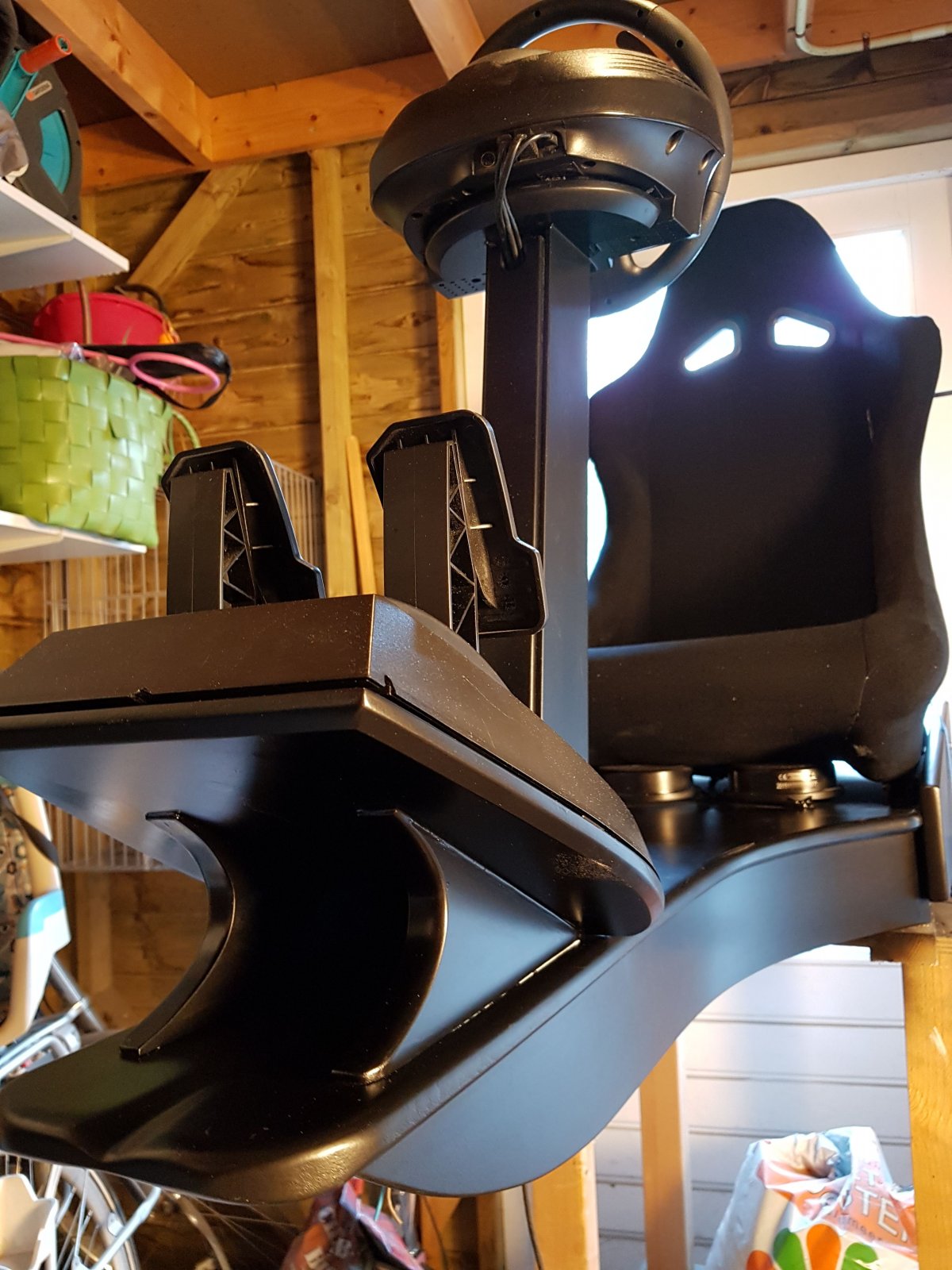

    The pedals

    Spraypainted pedalssetconstructionthingy in place

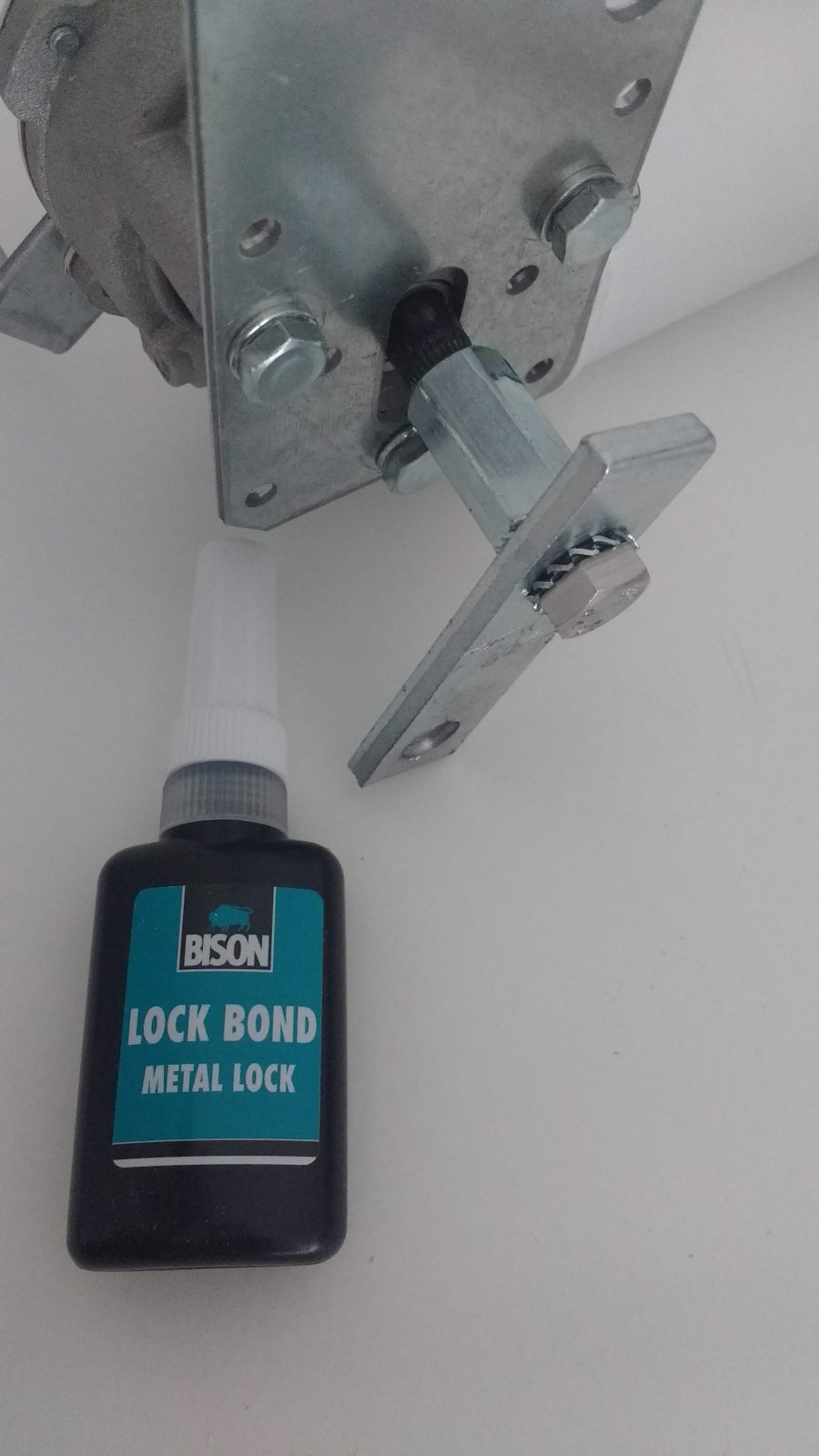

    I'm using Lock Bond for the bolts and nuts.

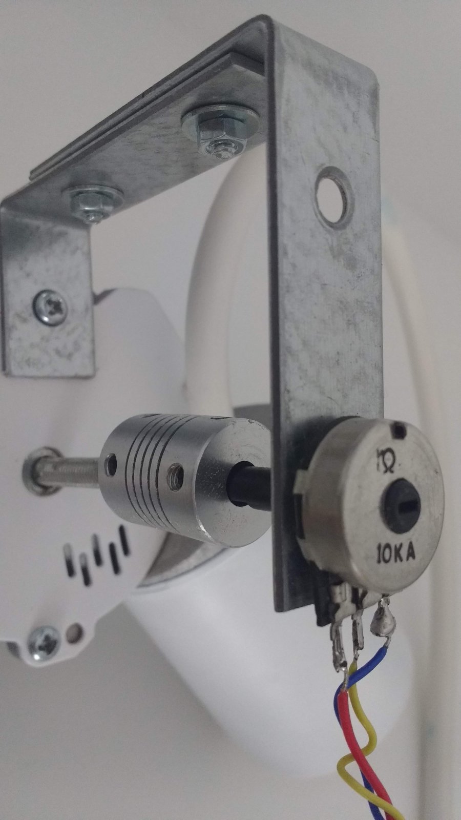

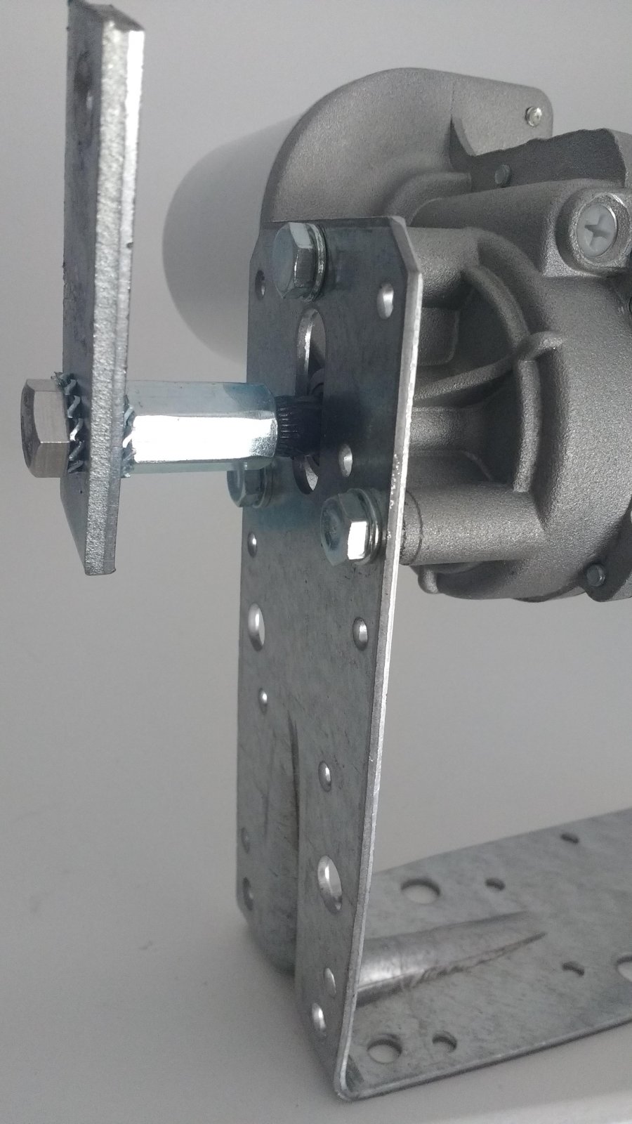

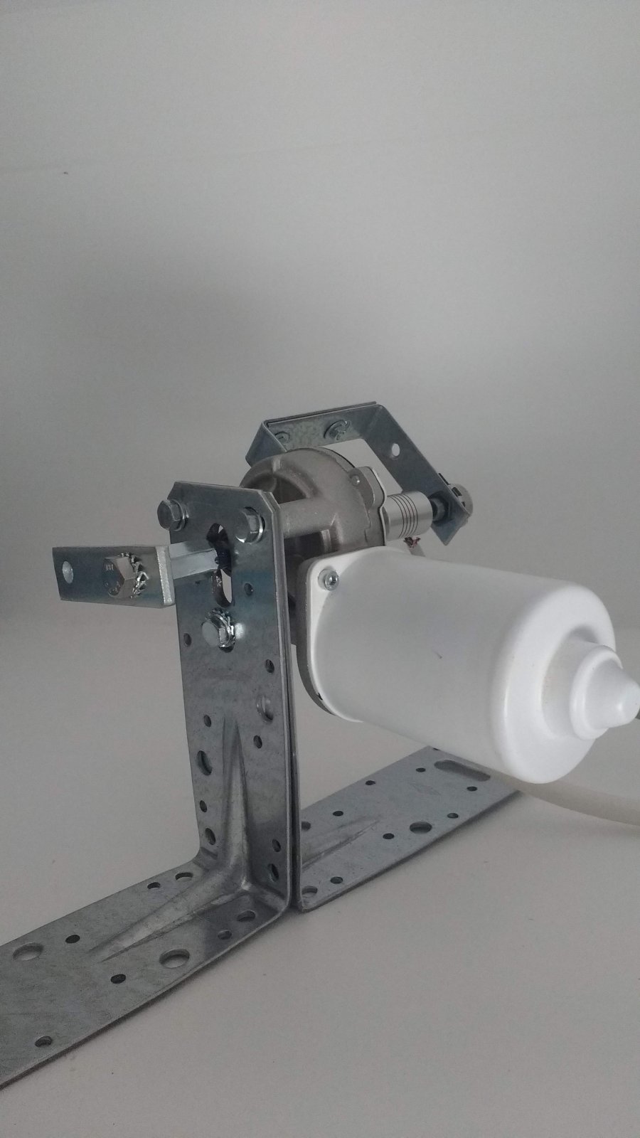

    Updated the motor mount with one extra bracket.
    I am also a bit worried about the load capacity of the engines
    21,723
    152,051Coins
    +11,063 / 56 / -2
    You also need to consider the load capacity of the motor mounts, as they are subject to substantial forces, given the movement and mass of the rig. I think they need to be far more substantial than what you are using.
    They look to be wiper motors, is that correct?
    Have you tried SimCalc to get a sense of what is needed to drive your rig: https://www.xsimulator.net/communit...e-linear-speed-and-forces-of-your-design.270/

    That's correct they are wiper motors and no I didn't try the simcalculator yet.... All the parts that I have made till now are like 'it comes as it goes'... but the motors are a braintwister for now..
    ps. The two motors get one more mount in the same line as the motor.
    We keep I'll keep you informed @noorbeast

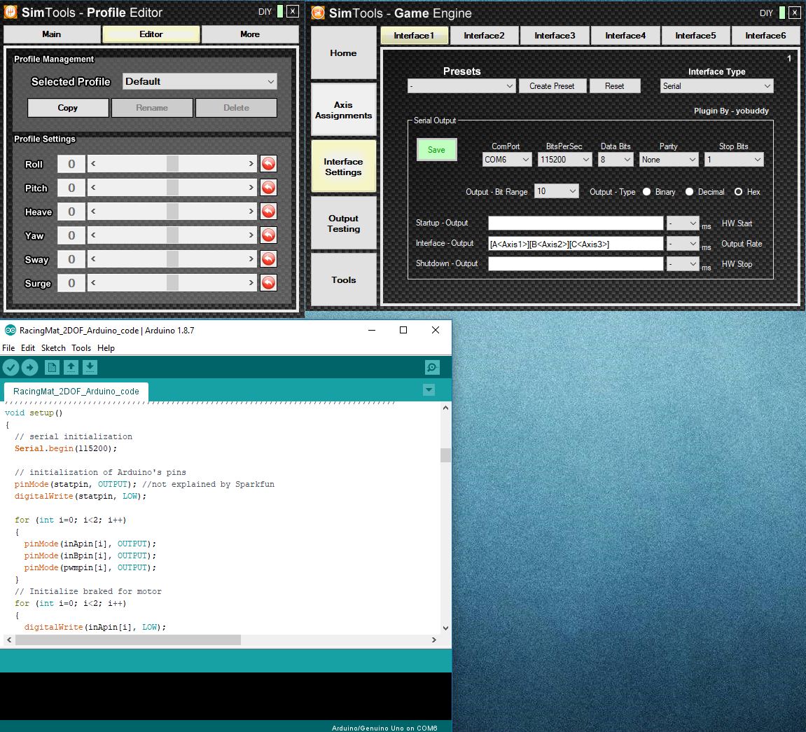

  18. Brie69
    Brie69 Active Member
    Jul 1, 2018
    100
    Beverwijk
    2Coins
    +88 / 0 / -0
    What is wrong? I've uploaded the @RacingMat _2DOF_Arduino_code with a USB cable to the Arduino...installed SimTools latested version..downloaded/installed/patched some gameplugins..
    The settings in the Game Engine are those correctly filled in?
    When I start, for example Dirt Rally, the motors give one 'kick' when starting the game but when I start driving the motors stay still.
    If there is anyone how can help me with this is much appreciated.
  19. noorbeast
    21,723
    152,051Coins
    +11,063 / 56 / -2
    For SimTools 2 the Interface Output should be: [A<Axis1a>][B<Axis2a>][C<Axis1a>]
  20. Brie69
    Jul 1, 2018
    100
    Beverwijk
    2Coins
    +88 / 0 / -0
    Sorry, @noorbeast but even when I set the Interface - Output like you said [A<Axis1a>][B<Axis2a>][C<Axis1a>] still no movement.
    Do I need to change the Arduino code or something?
    The Arduino is connected via USB A <> USB B cable to the pc
