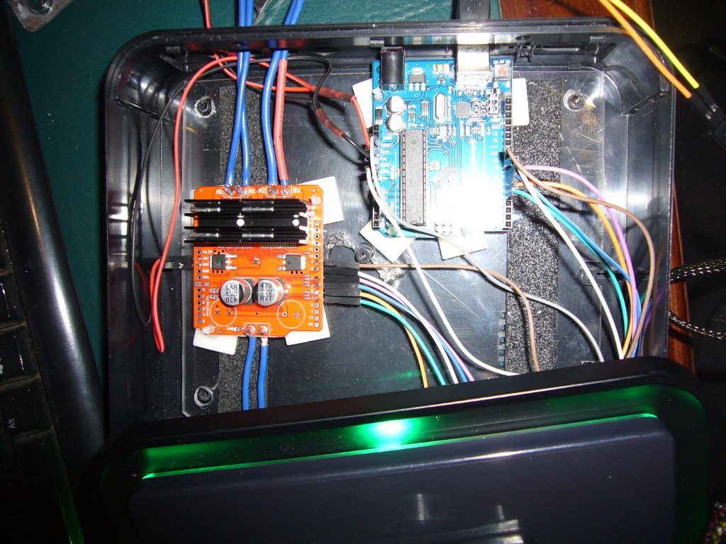

    Hello Racing Mat, thankyou for all the input to this forum that you have done. I have followed your instructions for my 2 DOF build and have a question please - I am using arduino UNO and 1 Motor Monster motor driver it will be driving 2, 12 volt DC wiper motors, will 1 Motor Monster driver be ok or should I run 2 MM one for each wiper motor? I am new to all of this and want my build to succeed. I have the frame and wiper motors attached, I have tested the motors on the frame with a direct connection from a 12 volt car battery and all working well, I have built the MM and UNO box and have wired it up as per your instructions but I am a bit worried that the 1 MM on it's own might melt down running 2 wiper motors? Any help would be greatly appreciated, Regards Ned from down under.
  3. RacingMat
    2,237
    21,050Coins
    Hi! Thanks, I'm glad it's usefull for you :)
    - Isolate the ground of the motors!
    - Yes, 1 MM drives 2 motors. But if you have 2, you can bridge 1 MM for 1 motor as Pit tested successfully as per specification.
    Please share some pictures!

    Hey Hi, thanks for your input, last night I put together the arduino and motor monster in a box I added 2 heat sinks to the mm and then put a cooling fan on top of the box I have wired it as per racing mat instructions and today will somehow try and download the code to Arduion, the box also lights up when USB cable from computer 1 is plugged in, as you may understand I am very impressed with myself being I know nothing about electronics and it's all starting to come together I need to clean up where the wires run but very happy that it powers up, LEDS light up and fan runs when USB plugged in ha ha.

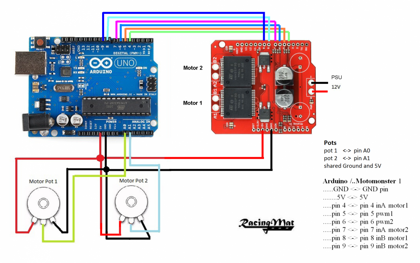

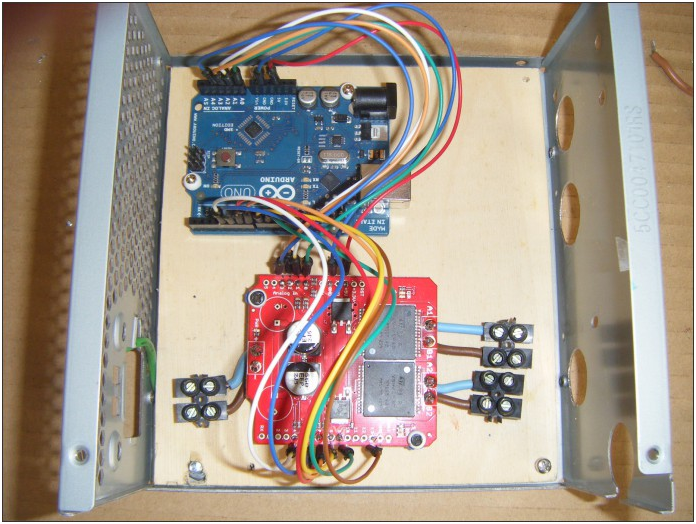

    Hello Racing mat while waiting for new MM to arrive I have been researching your 2dof site. Question for you please? I have followed your wiring instructions and notice the instructions of the wiring is different than how you have wired up the MM and Arduino boards you have used analog A0 A1 A2 and others on the MM and the wiring diagram shows the pots only hook to Arduino board. Which way should I wire both boards????
  12. RacingMat
    2,237
    21,050Coins
    As Motomonster can be stacked onto the arduino, I started by welding all the jumper wires but it was unecessary :oops: newbie mistake
    Follow the drawing!

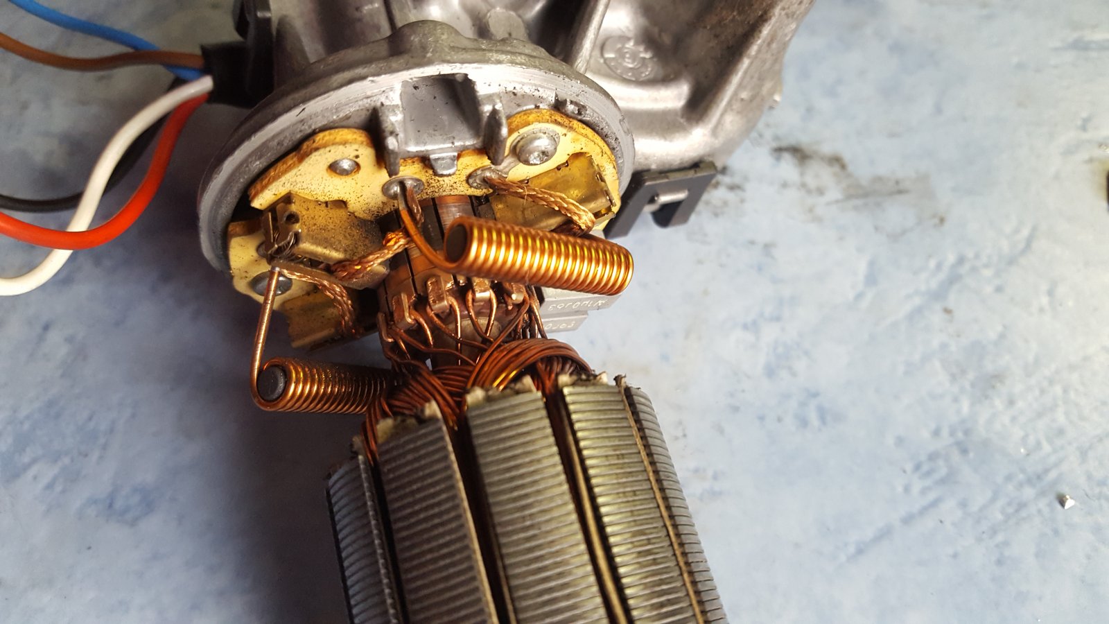

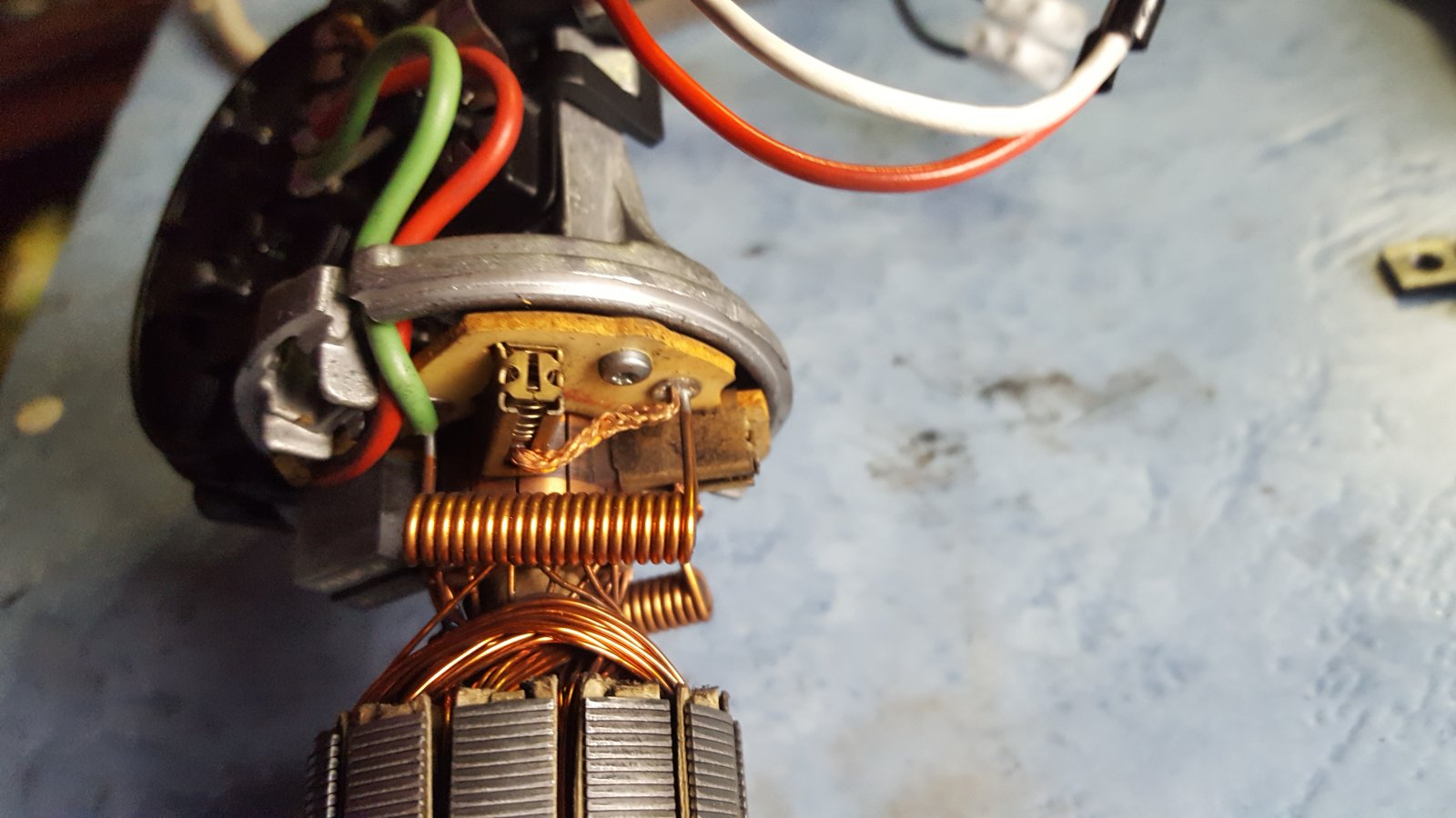

    Hello, I just attached 1 motor to my VNH2SP30 (Motor driver). But only one side of the motor turns in full speed. the other direction the motor almost doesn't turn at all! After a little while the motor stops completely with turning. Also I can not arrange the speed of the motors, only a little bit. (With the potentiometer) it's on or off.
    I'm using the Arduino program from Racingmat and haven't changed anything.
    Someone know how to fix this?
  17. noorbeast
    21,724
    152,057Coins
    +11,063 / 56 / -2
    If they are wiper motors make sure they are ground isolated: https://www.xsimulator.net/community/faq/wiper-motor-mandatory-ground-isolation.25/
    And you may want to try this speed fix: https://www.xsimulator.net/community/threads/wiper-motor-slow-in-reverse.5675/#post-59115

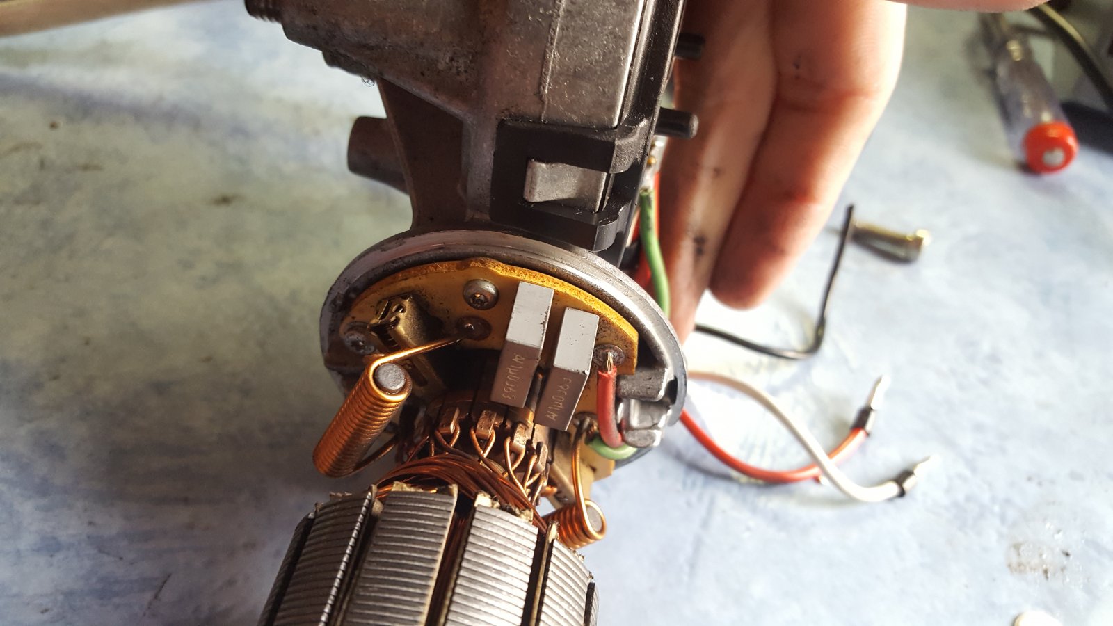

  18. Krisie300
    Krisie300 Student Engineering
    Jan 18, 2016
    11
    Netherlands
    146Coins
    Hey! I checked my motor if there was a wire connected to the body of the motor like they say in this link.
    But there were no wires connected to the body of the motors.
    Here a couple pictures and a video of the problem, hope someone can help me out!
  19. RacingMat
    2,237
    21,050Coins
    you have to wire the two pots I think to prevent floating entries on arduino
    pots are not used to change speed but to determine position
    Please follow the steps advised here
    https://www.xsimulator.net/communit...-and-2-pins-direction-hbridge-motomonster.67/
    and tell us at which step you are stuck
  20. Krisie300
    Jan 18, 2016
    11
    Netherlands
    146Coins
    @RacingMat Thank you for the fast reply!
    I'm stuck at the first step.. I've attached both motors now, but when I put the motors in reverse, they don't turn in full speed. After a short time the motors just stop turning when they should turn in reverse. See the video below. Maybe the resistance is to high?
