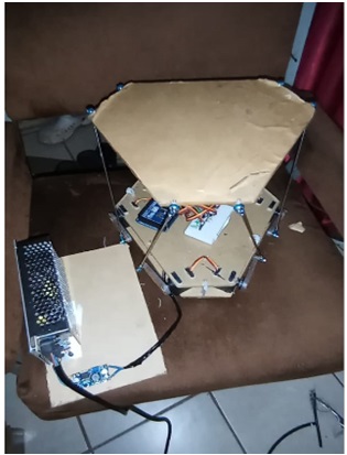

    I am a newbe here doing my final project. I want to use arduino mega for the positioning and the inverse kinematics and hoping to use SImtools for extraction and conversion. X-Sim is so hard to understand. ANybody with the way to go for setups?

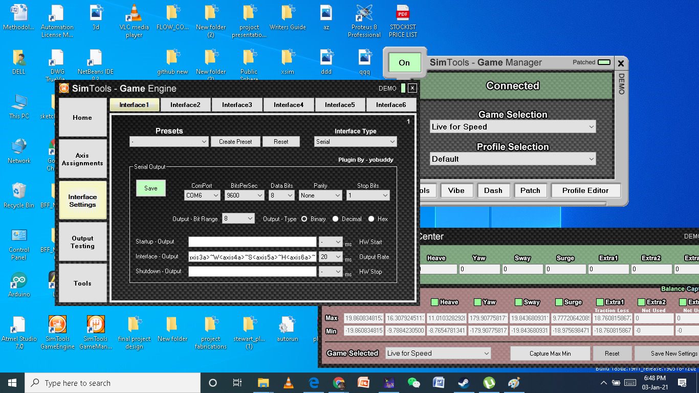

    I am now using Arduino UNO and here are my setups
    any insights please?
    21,592
    151,215Coins
    You need to post all relevant information, such as Interface Settings, plus what you have and have not done, for Example Output Testing needs to work as expected before doing anything else.
    Most use @eaorobbie 's RC code, see the post here, which also includes tips for configuring it with SimTools 2: https://www.xsimulator.net/community/threads/2dof-simulator-servo-model.6851/#post-77270
    LFS needs to be run before it is patched for motion: https://www.xsimulator.net/communit...run-in-first-person-mode-before-patching.365/
    Grab a copy of the SimTools manual here: https://www.xsimulator.net/community/faq/rtfm-start-with-the-official-simtools-documentation.117/
    And see the tuning tips: https://www.xsimulator.net/community/faq/steps-to-create-a-motion-profile.228/

    9
    189Coins
    okay let me send my interface setup and the axis setup as well. Please assist me get on the right track. Note, the output testing also not working. What might be the problem?
    getting data to the engine too

    Interface Settings should be formatted like this, with an upper case<Axis1a>
    Don't bother with LFS until Output Testing works as expected.
