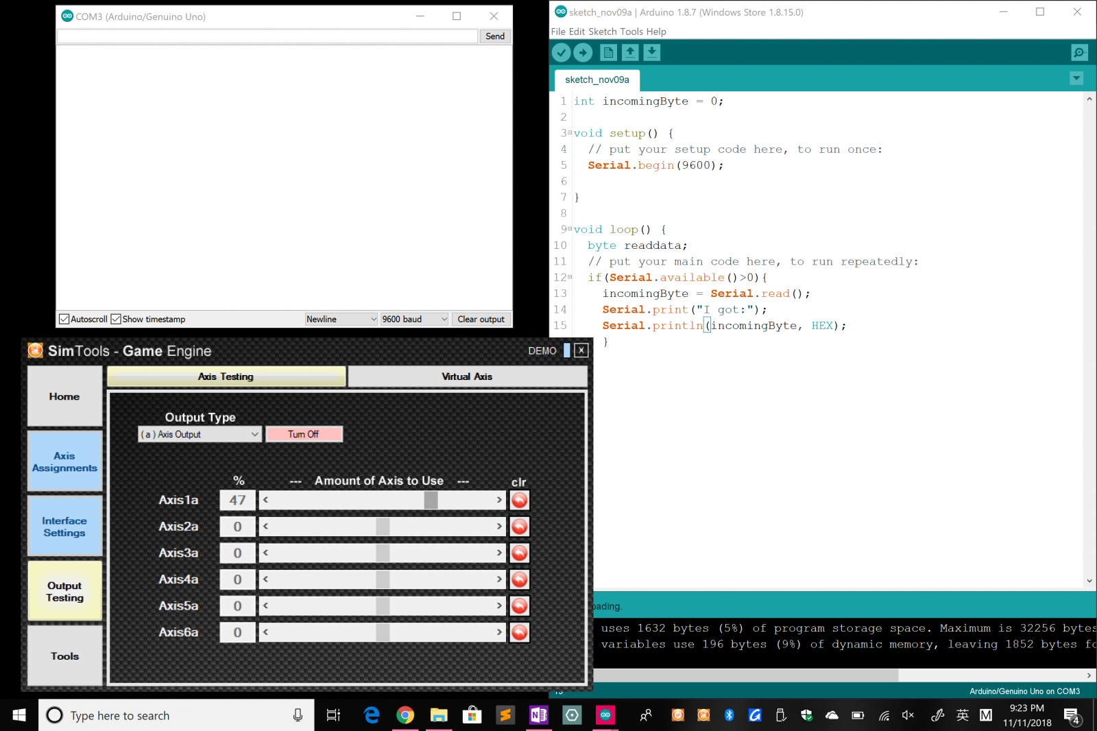

    I am new here. I am a racing game fan. And I am planning to DIY a 2DoF platform for myself. And before I start the DIY, I want to build a scaled prototype and verify some functions.
    From the documentation, I notice there is a feature in sim tools that we can manually send axis data into the particular com port which is also the com port for arduino. So, before I purchase some real motor, I want to use the Serial Monitor in the arduino IDE to print the data on com port to check the data should be correct.
    And my issue is:
    When I was trying to move the axis in the sim tool, there is no output from the Serial Monitor in arduino IDE. I have checked the baud rate and com port, it should be right. I also attached my screen shot of my sim tool setting. May be I miss some configuration here, but I really have no idea about what happened here.
    My Configuration in Sim Tool:
    The Test Screen from sim tool and Arduino IDE:

  4. fourteenary
    fourteenary New Member
    Oct 21, 2018
    8
    299Coins
    2DOF, 3DOF, Arduino
    Hi Guys
    Thank you everyone. I thought I have found the root cause of this issue.
    What I had found is, when Sim tool start the output test on com 3, the com port 3 is using by sim tool. And during this time, the serial monitor in arduino IDE tool will not prompt any error. But when I am trying to upload firmware into the arduino via com 3, the arduino IDE will report upload error because I guessed the com port is occupied by Sim Tool. It is sending data to arduino board.
    It seemed that the Arduino IDE tool and Sim Tool cannot use com port 3 simultaneously, but the data sending should be OK because it is a ordinary way to implement most of the simulation in this website.
    So now I am using the tools offered from noorbeast's replay, and it is using a network to test the data transferring. and it works fine for me.
