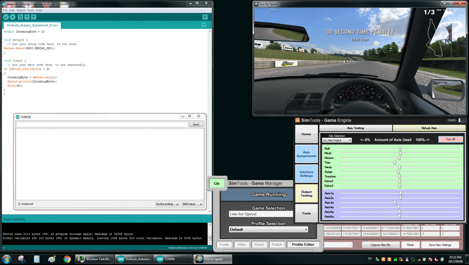

    I would like to set up a small test to send Simtools motion data (just one axis for now) to Arduino Serial Monitor. At the moment I don't have any actuators coupled, I just wanted to get a few LEDs or small servo motor turning witht motion data from Simtools.
    I have set up the Simtools Game Engine to write to COM16, 9600-8-N-1
    I have also set up Arduino to listen to COM16, 9600-8- N-1
    I then run LFS, and I get data out on the virtual axis, as well as on the Tuning Centre
    I don't however see anything on the Arduino Serial Monitor. I must admit, I only ever programmed my first Arduino this past Saturday, so I might be having a problem there.
    What am I missing?
    How should I configure Simtools, and Arduino to get just a simple 1 axis motion data to control a servo via Arduino? Any assistance would be highly appreciated.

    Select an output rate and click save buddy.
    Then try again and you should be golden!

    @fourteenary,
    The problem is in the first pic he posted.
    You can see in the pic that the interface output has no 'Output Rate' selected.
    And the save button is not enabled, meaning the settings are incomplete and have not been saved.
    Basically, the problem here is there is no saved settings for the interface.

    @Lebois,
    The problem was the settings were never saved.
    I can tell because if you look in the pics above, you can see there is not enough info in the interface section to enable the save button to use.
