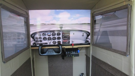

    I had the seat working pretty well before attempting to add pitch and roll for use with VR. I have decided to go in a different direction, building a Cessna style cockpit. The pitch and roll would not work well with it anyway, so I am going back to just the G-seat. I am going to weld up some plates to the seat flaps, that come up along the side of the legs to give a better squeeze instead of lift.
    I want to get back into working on it, but things have been crazy since my fathers passing 3 weeks ago.
    Here are some pictures of the cockpit. I have a larger main monitor to put in, so it will widen the whole thing by another 7 inches, bringing it closer to life size.

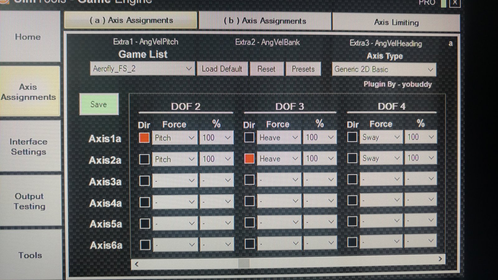

    Hi.
    Does anyone know what this could be?
    Comed last week in several PC's.
    I have reinstalled plugin and repatch.
    It did not work.
  10. yobuddy
    51,743Coins
    +5,205 / 19 / -0
    What do you settings look like for Sway?
    Looks like Sway is causing it..

    No.
    In this simulator the sway is the roll.
    If you observe you will see that heave, surge and sway are lag.
  12. Leandro Kemp
    Leandro Kemp Active Member Gold Contributor
    Oct 14, 2015
    161
    Brasil
    - 10Coins
    +34 / 0 / -0
    Why does the roll move to the left?
    It is not centered like the other bars. So I set the sway to make the roll move.
  13. noorbeast
    22,205
    154,693Coins
    +11,210 / 57 / -2
    Please post pictures of your settings, so members can give informed advice.

    The DIR being checked orange or not determines which way an axis moves, and the normal convention is that sway would be opposit of roll, so yours look wrong, this is how SimTools expects the movement to be configured: https://www.xsimulator.net/community/faq/which-way-to-set-simtool-axis-movements.230/
    Another issue is the Axis Assignment percentage total, you have 300% for just 3 axis, which is way too high and would result in clipping: https://www.xsimulator.net/community/faq/axis-assignment-percentage-totals.120/
    Follow these steps to configure and refine your motion profile, once you sort out he Axis Assignments, doing one axis at a time: https://www.xsimulator.net/community/faq/steps-to-create-a-motion-profile.228/

    I understand, but it was all working after the last update of the aerofly.
    The issue is not the movement but the delay it is giving.
    It moves with leaps. Lag
    Could someone open the game and test, please?

    Even doing these procedures did not solve.
    For the roll graphic to be in the center the plane must be 90º inclined to the right.
    Does any member of the group use this simulator? Could help?
