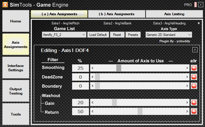

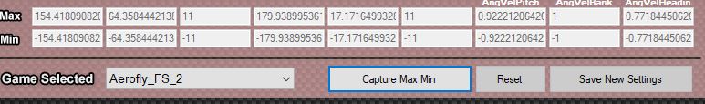

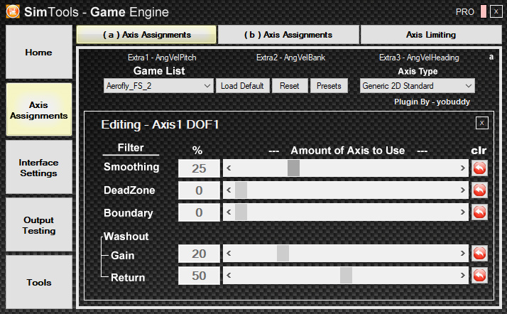

    I haven't set up motion cancellation yet. My platform movements aren't big enough to really bother me for the view changes except when I'm way off to the side and even then it isn't that bad. Now that I have washout going, it fixes a lot of that anyway.
    Here are the screen grabs I promised. I only show one of the filter settings for each axis since the other one is identical and don't show it for the forces that don't have filtering configured. This is also before I change anything and is how I was describing it above - probably too much or too fast of washout. I need to figure out if return controls the speed of the return but whatever the appropriate setting is, I need to slow down the washout just a bit.
    Hopefully these help but it sounds like you've already been all through this stuff. I just know it seems to work pretty well for me. Good luck!

    Hey @Zed ! I just went flying, with *everything* on for the 1st time. My G-Seat latest tune, modified buttshaker (using Voicemeeter banana to crank up the shakers wrt the headphones) and your SimTools settings (unfiltered on the heave though - I want immediate response on that one as its great for heavy landings) on my 3DOF.
    It came together really well. With the extra shake and some turbulent wind I didn't notice the jerkiness of the washout returns that had been bothering me before. I was in the Bucker again - I just keep coming back to that. I love the responsiveness and the view out the side. Also the big dials work well with current VR resolution limitations. I like the older prop stuff in general. My ideal is probably a DC-3 or something of that area and size as I'd like a slightly more complex cockpit and to do some VOR navigation in bad weather across some interesting terrain like Scotland. A Spitfire of course vies for top place. By the way that's the reason for Spit40 - I wrote this game back in the 80s (well I did the Amstrad version under licence)
    These is my tuning by the way. What are you using?
