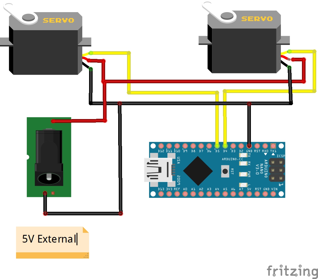

    • Found an interesting experiment with Nano and small servos. From here another question: how to embed a motor driver into this circuit, from MODE1 option, (if the stuffing of these servos is transferred to the wipers), and whether correction is needed in the IDE sketch?

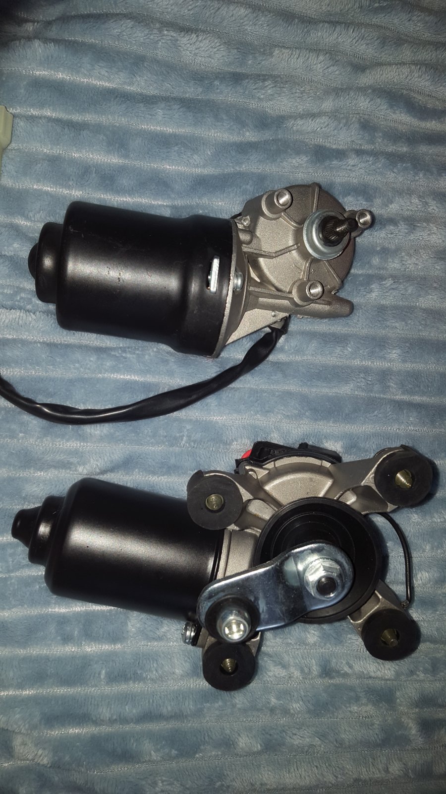

    • A question about the motor and power supply: I plan to use a Daewoo Lanos wiper motor
      (Our experts recommend this motor more often):
    rated power 30 W kW, no more;
    Voltage 12V;

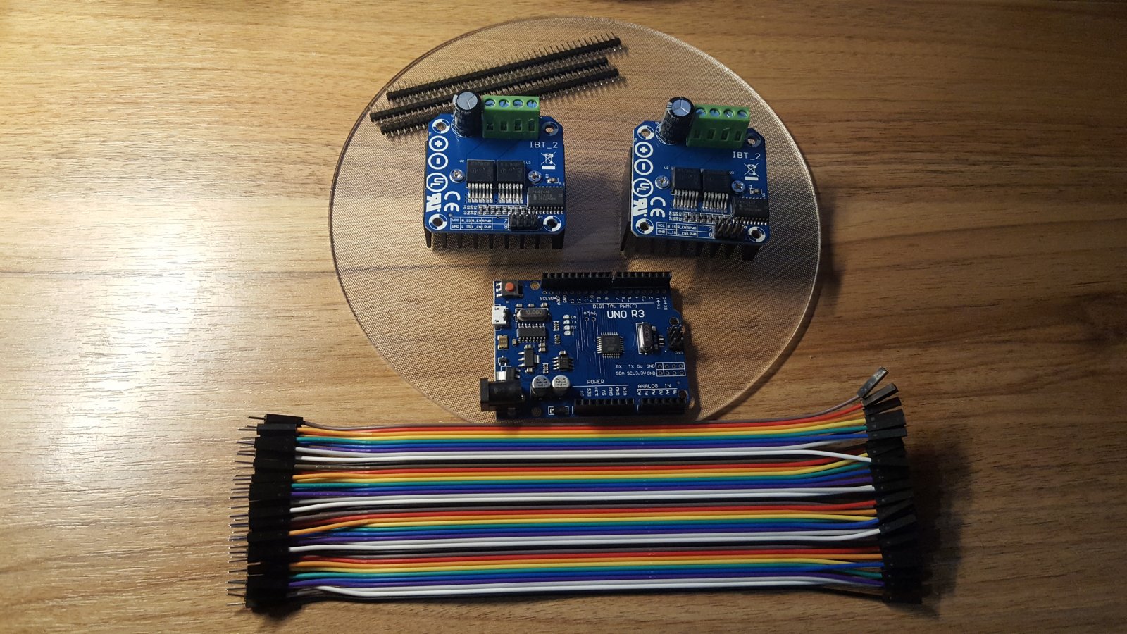

    I would also recommend to use the UNO. I have no experience with the NANO but tried to use SMC3 with the Arduino MEGA and got several problems. This will also make the question to the circuit obsolte as there is a circuite sheme or diagramm with the explanation of SMC3 (https://www.xsimulator.net/communit...3dof-motor-driver-and-windows-utilities.4957/).
    Do not use Monster MotoShield (MMs), use something else as they are making troubles very often (I use IBT2 for which SMC3 is also prepared).

    I agree with Christian, use an UNO as well as a driver other than Monster Moto. I have had bad experiences with the MMs. I personally opted for a Sabertooth 2x32. It is pricey but you get what you pay for in durability and power.

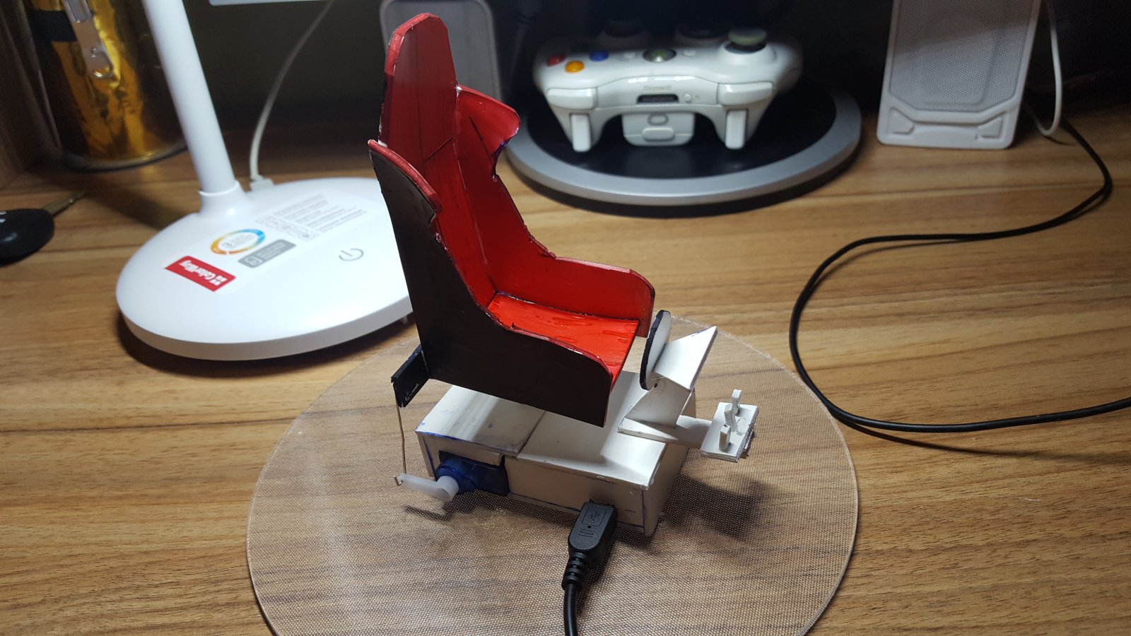

    Thanks for the support! I just finished building a miniature stand like this one. It works! Figured out how to configure SimTools. Now I am confident in myself!

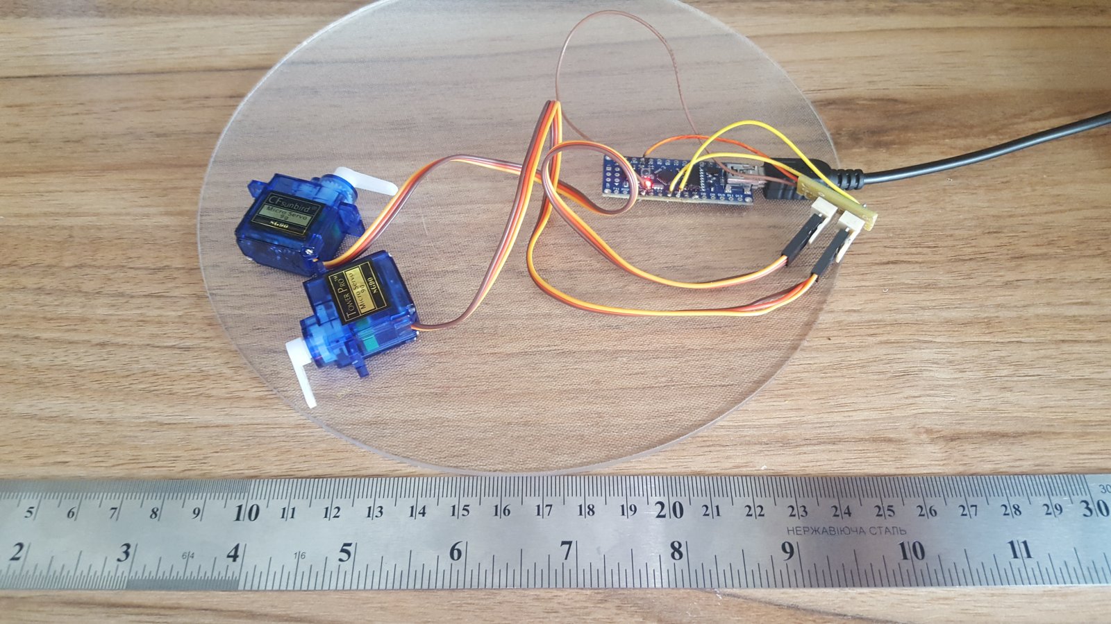

    I want to share my experiment with you.
    Works great!
    [​IMG][​IMG]
    Only for a long time I could not figure out how to invert the axes. Found in the instructions. It was necessary to press the orange buttons in the "Axis Assignments" window.

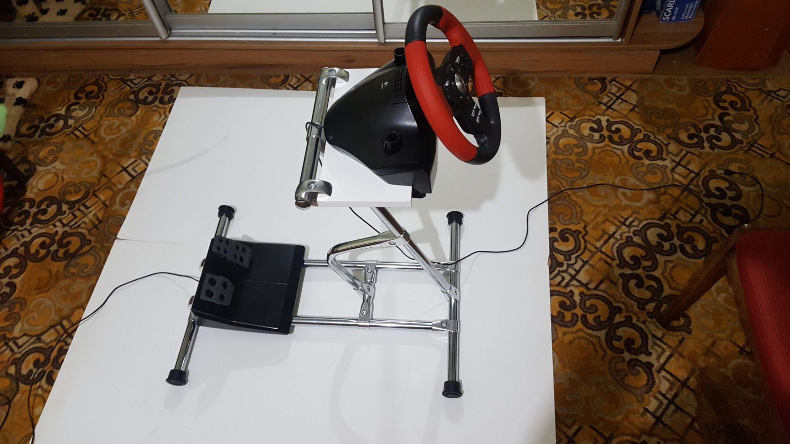

    I did this model to understand the mechanics of SimTools. But you guessed it, there will be just a movable chair. The platform with wheels and pedals will take up more area. And the motors on the back of the seat can increase size the design. Everything should be hidden under the seat. Otherwise my wife will beat me! (joke):)
    Recently, I made a folding stand for the wheel and pedals from a railing tube and Joker furniture fittings. Very good.
    There are thoughts to make the base for the motors and the seat from this material. But I haven't decided yet

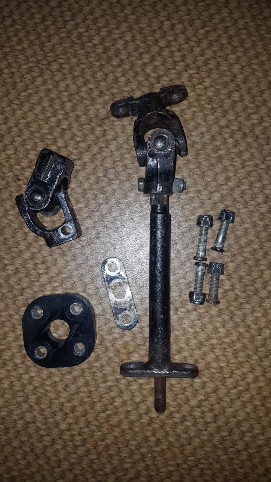

    Tomorrow I'll go to the auto disassembly, look for a cardan joint. But this can be a problem - we have a lockdown.

    There are quite a lot cardan joints from motobikes on eba*. I bought one from Yamaha 650 and it works absolutly fine. They are around 30 to 40 Euro.

    Didn't think to look from bikes. Thanks for the advice. I looked at the cardan of the steering mechanism of some car, it seemed thin and fragile.

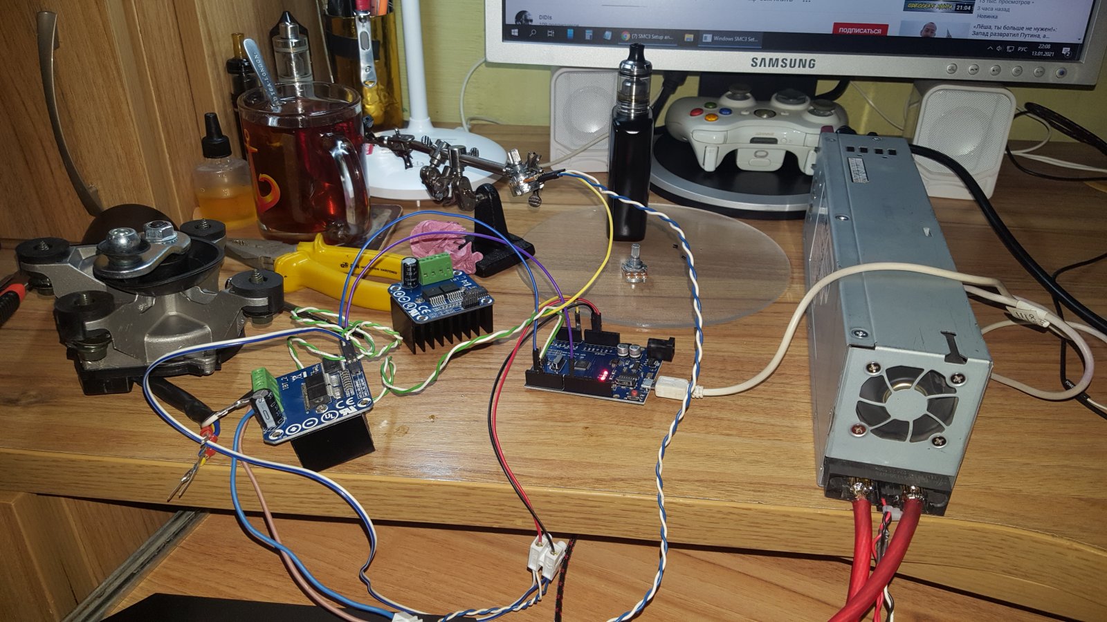

    +29 / 0 / -0
    Slowly but surely I'm moving forward.

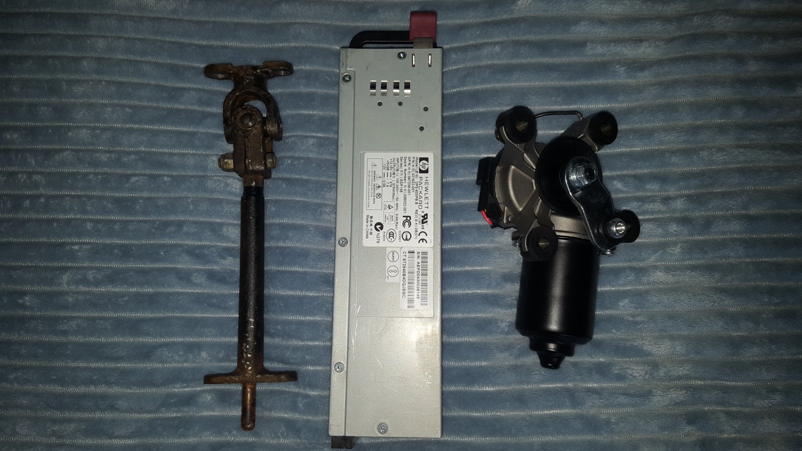

    I got a steering shaft cardan from some retro car.

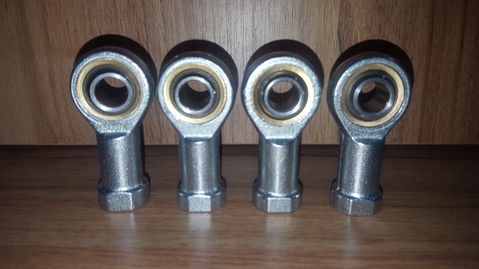

    A fish-eye bearing d = 10mm was purchased.
    Received a power supply as in this recommendation. (I chose exactly the same one so that there was less headache with pinout)

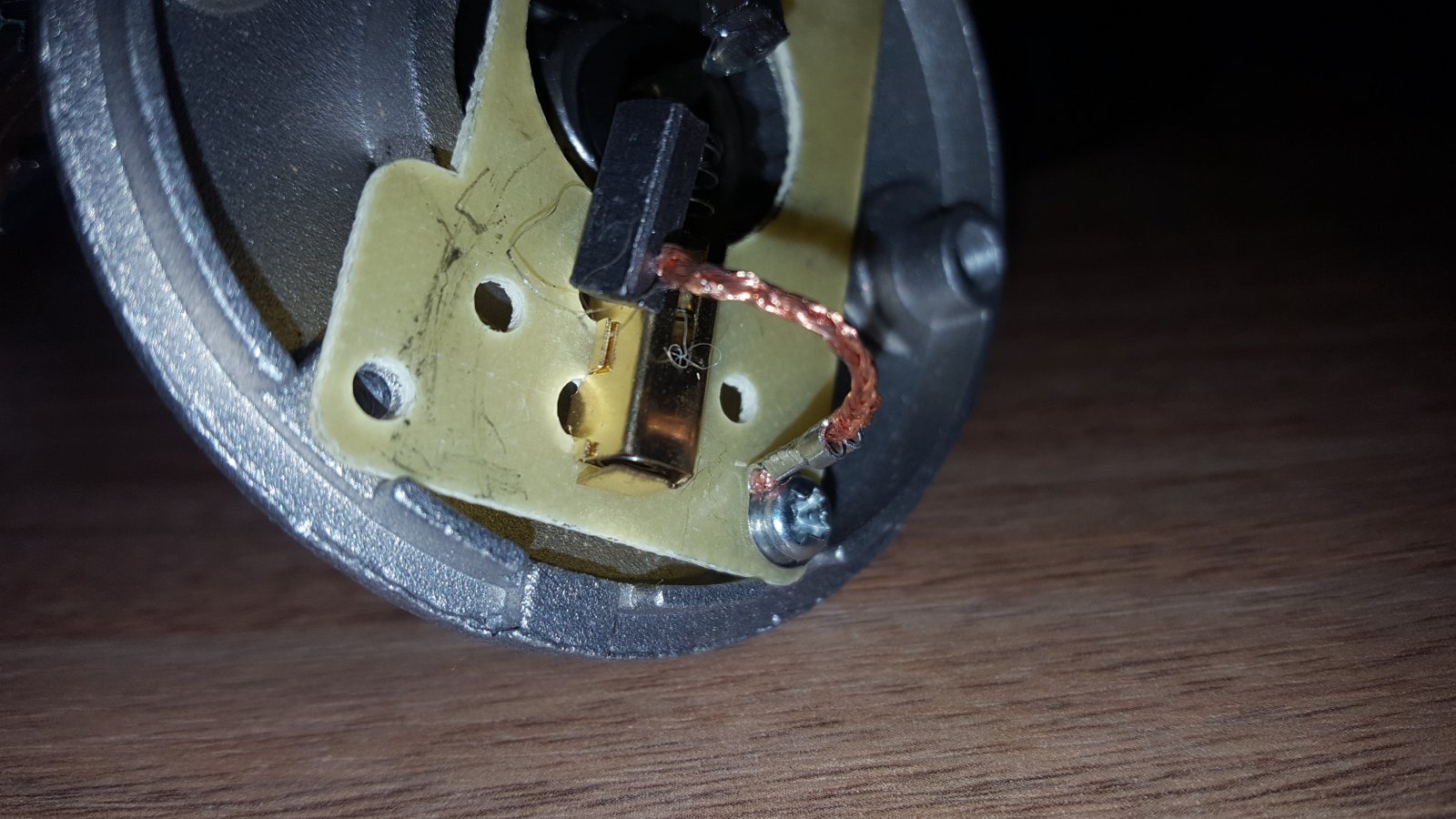

    Well and motors. Took two different ones for comparison
    One of them was with the ground on the case. Remade GND to wire. The second motor had a ground on a wire clad on a bolt. No problem.
    I connected all the components at the stand and started the test. Everything is working.
    Have a question about engine operation in SMC3Utils v1.01
    When I turn Out Mode to "triangle" or "Sine" the engine performs the task, but with a constant CW offset, whatever the setting. Is this how it should be, or am I not configuring something?
  20. Christian Doehl
    Christian Doehl Member Gold Contributor
    Oct 6, 2020
    63
    Germany - Bavaria
    718Coins
    +35 / 1 / -0
    Have you connected the motor shaft to the shaft of the pot? Cannot see it in the picture. If not, you have to do. If yes, maybe it's too soft and twists when moving. The motor shaft movement has to turn also the pot as this gives position feedback to the arduino.
