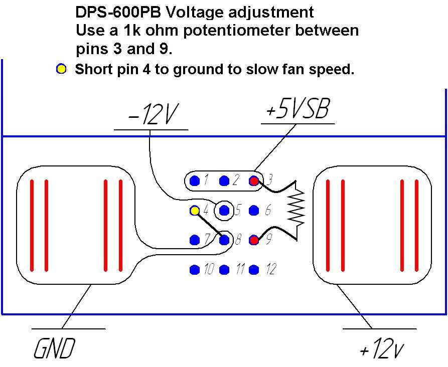

    So the first thing to point out is the connectors on the power supply board. Some people open up the unit and take this connector off to solder direct to the board.
    I'm going to show how it can be done by anyone with limited skills and is also very quick and easy.
    The connectors that we require are as follows;

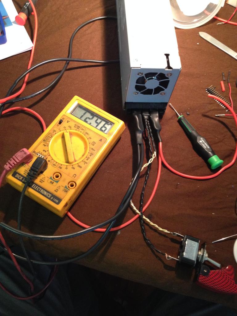

    In order to get solid stable voltage we will join both earth connectors together and on the other side we will join both +12v connectors together.
    In the middle there are a number of pins which control the unit. We are going to join pins 4 and 8 which will lower the fan speed to a much quieter level (about half) and provide ample cooling for the the unit. If the unit begins to heat up the internal controller is still able to increase the fan speed itself so this is a great modification to do.
    Then join pins 6 and 10. This, when also joined by pin 8 via a switch will turn the unit on (it will make more sense shortly) I chose to put a switch in place for a couple of reasons - one it will look good on the dash of my simulator and two it provides easy control over power to my motors etc.

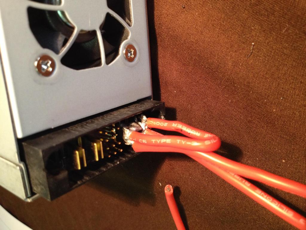

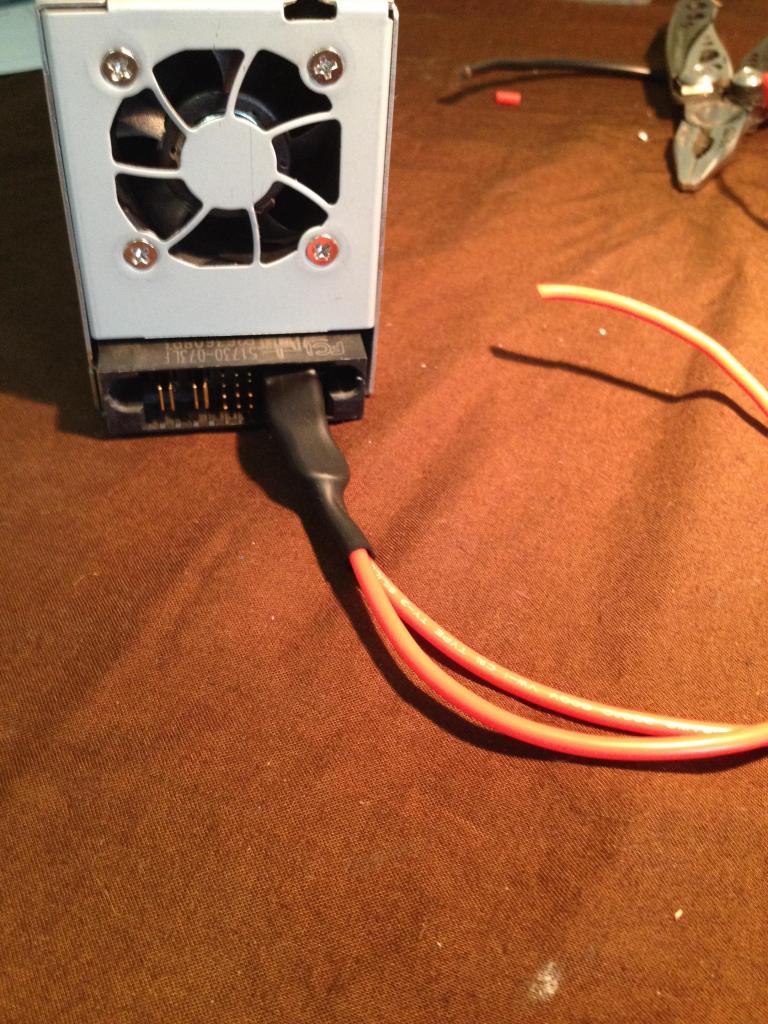

    Solder wire to the main voltage pins. I used a RC (remote control) silicon covered wire which is rated to 600 degrees and 600V, easily available on ebay.
    http://www.ebay.com.au/itm/AWG14-AW...faultDomain_15&var&hash=item258c7d2916&_uhb=1
    [​IMG] [​IMG]

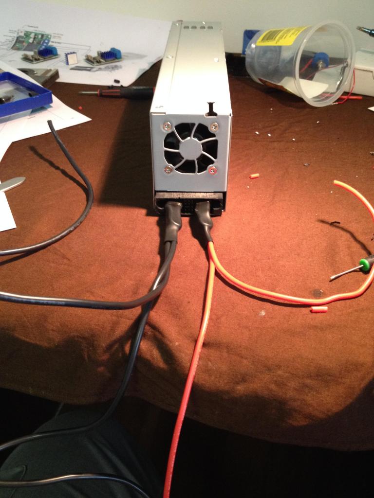

    I have wired one long wire (for the motor +ve) one shorter one for other accessories requiring +12v in the future and a short link to join both connectors.
    Then make it safe and look neat. Heat shrink is your friend :)
    Rinse, wash and repeat (joking) and do the same for the -ve (earth side)

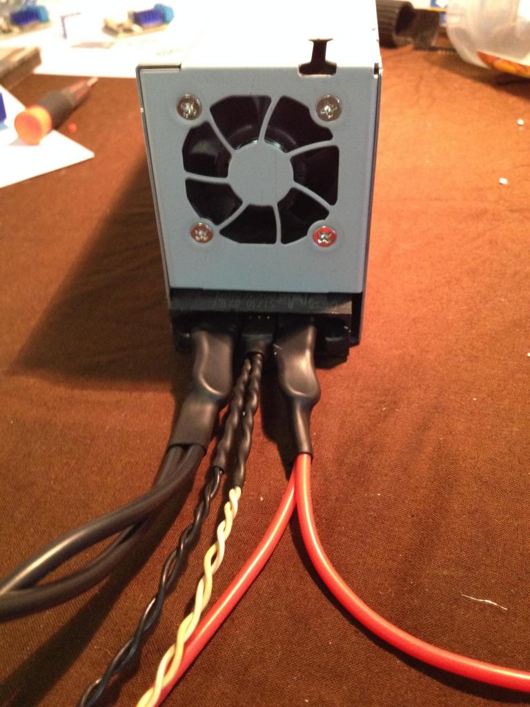

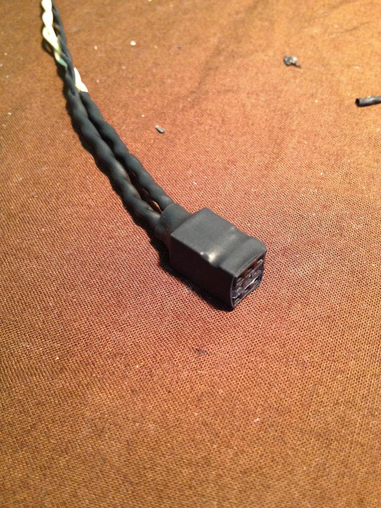

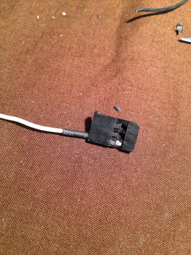

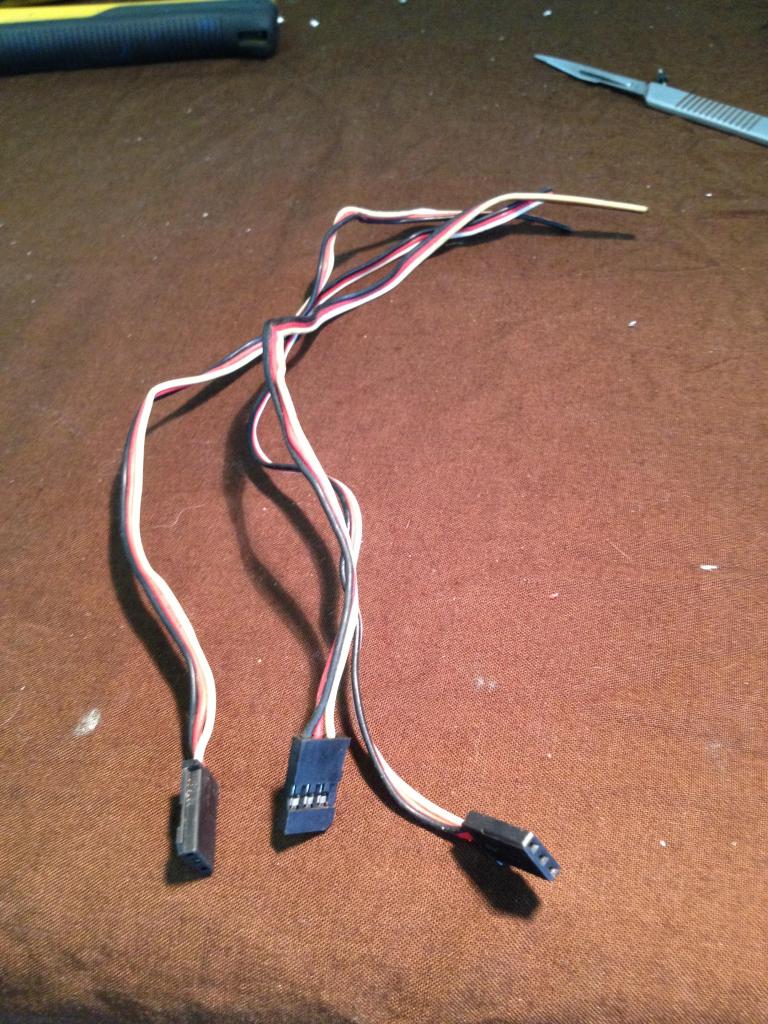

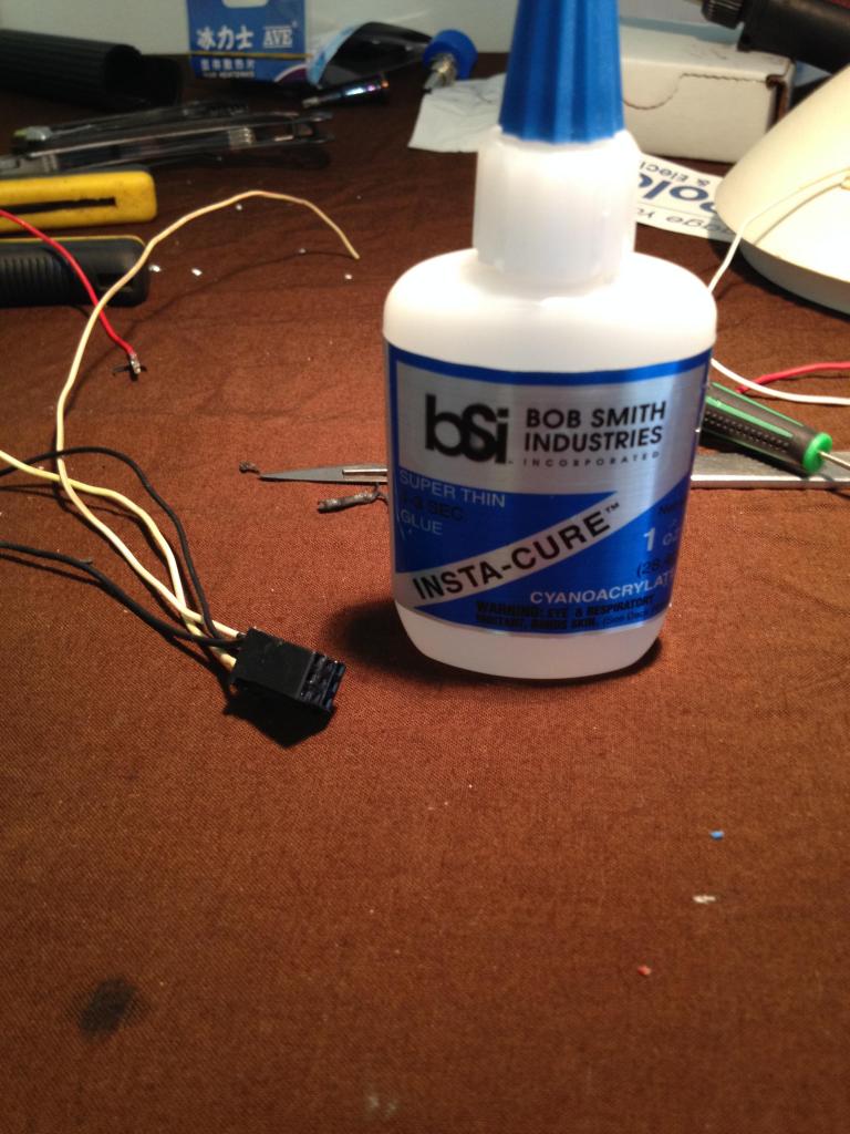

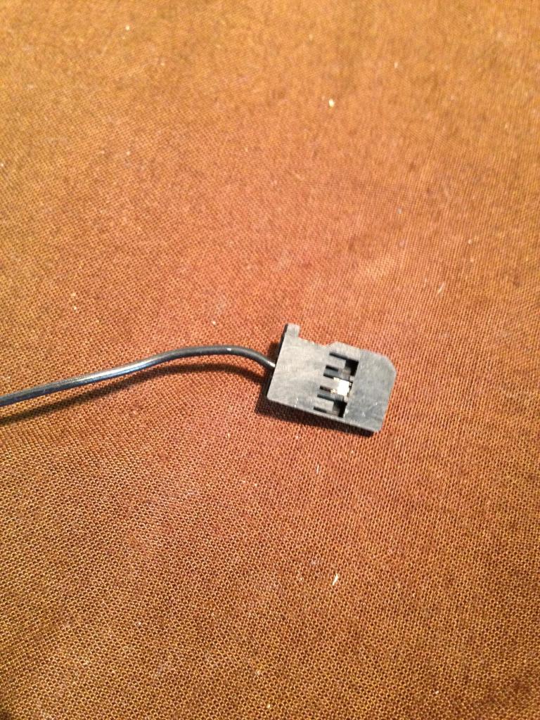

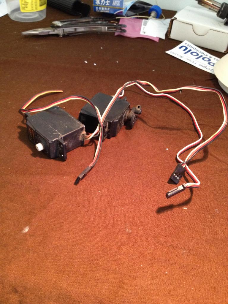

    Next - the pins in the middle are very small and to some may appear like they are going to be to hard to use/solder etc. Well there is a very easy way. RC servo connectors. These are also available on ebay, however if you have ever used remote control cars/planes/helicopters you may have some lying around like i did.
    Cut the connectors off leaving long length of wire
    Separate the wires
    You will need 3 (three) connectors in total.

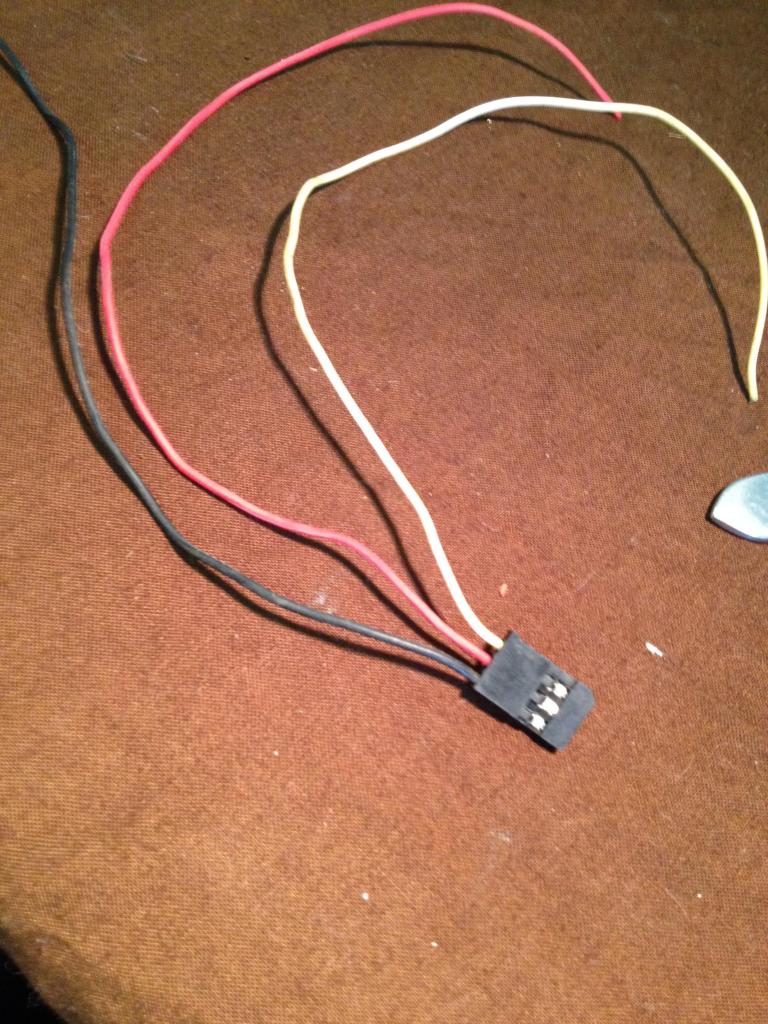

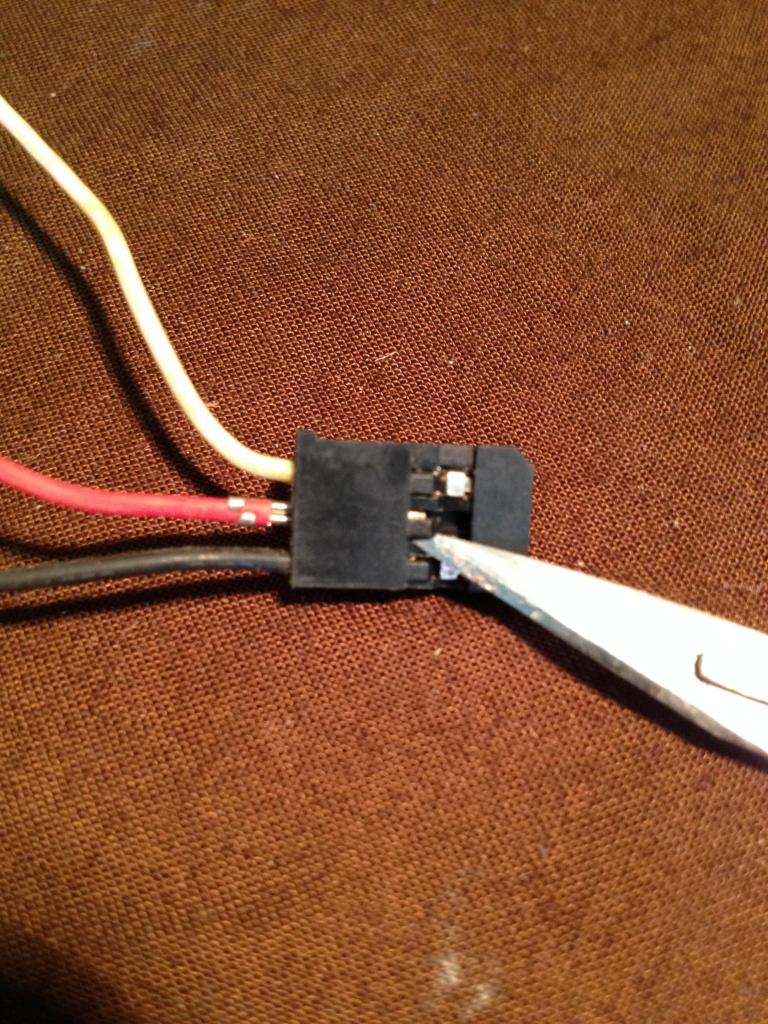

    Connector 1 (one) - remove the middle pin only using a pointed tool to lift the retaining tab.
    Connector 2 (two) - remove pins 1 (one) and 3 (three)
    I actually removed all three pins and replaced the middle pin with the black one so it matches the colour of the wire it will join with on connector 1.
    Connector 3 (three) - Remove pins 1 (one) and 2 (two). Again I removed all pins and replaced pin 3 (three) with the correct colour wire. you dont have to do this but it looks better and is easier to follow.
    Next you glue them all together. I used a very fast drying CA glue used for RC car tyres. You can use any glue just dont use very much and dont get any inside the pins!
    I then twisted the same colour wires together and used some more heat shrink to tidy it up, and there you have your middle connector!
    Now you can plug that into your power supply. Remember the wires should match the pin diagram back at the start - the top connector should have two wires in it.
    I then join the two black wires together and the two white wires together and put them on a switch. This will then turn the power supply on and off (output). The internal fan is always on when power is supplied to the unit (input).
    All that is left to do would be to extend the switch wires and mount the switch somewhere on the dash and connect the output wires to the JRK's or whatever you are powering.

    Here another tweak

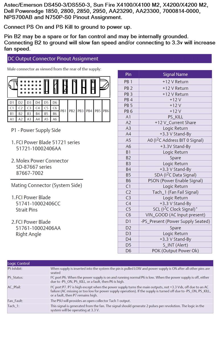

    Here is another pinout reference for server PSU
    Dell poweredge 1850, 2800, 2850, 2950, AA23300, NPS700AB, N750P-S0
    Connect PS On and PS Kill on Ground to power up!
