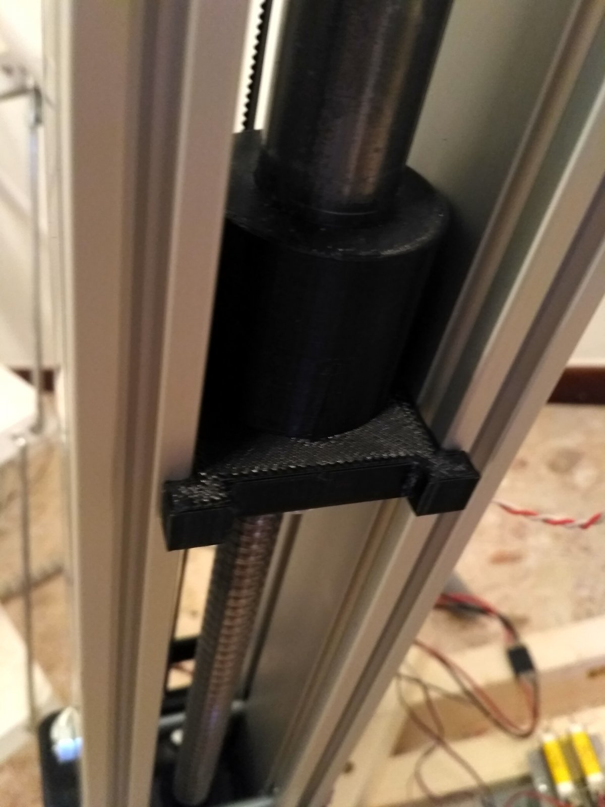

    I do have some questions.
    How is the ballscrew thread fixed at the top?
    Do you use any sliders on the alu sides?
    How to prevent the ballbearing to twist?

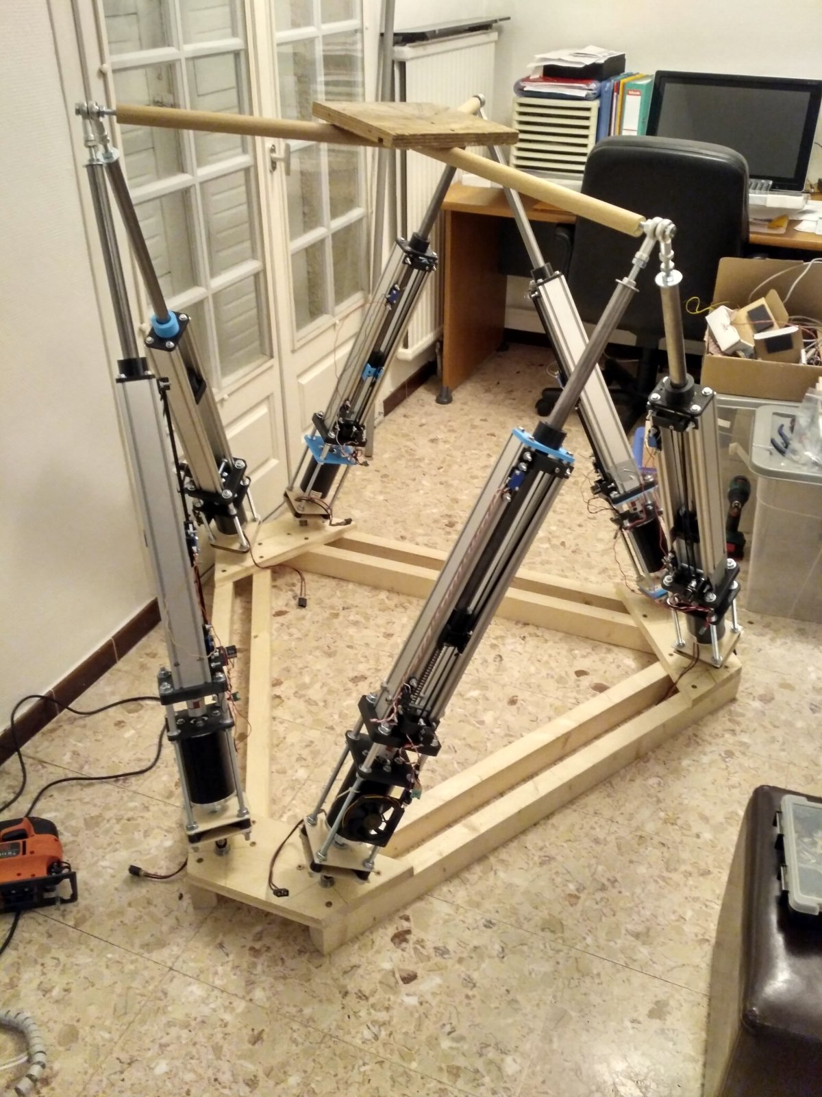

    All actuator tested, seems to be ok ...
    Tonight, wiring !

    Great stuff matey, now the joy of wiring and setting it up ;)
    And your platform looks a little flimsy and weak :D lol

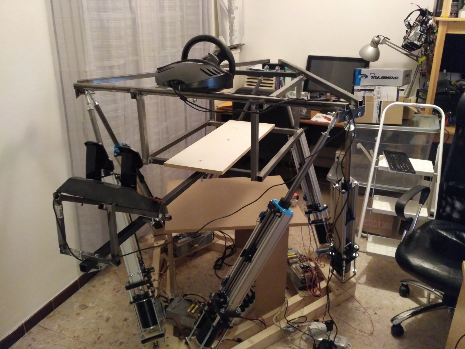

  8. baykah
    baykah Active Member
    Sep 1, 2016
    137
    Toulouse - France
    414Coins
    +133 / 0 / -0
    For the first tests I did a link between actuators very weak to be sure it will bend in case of missettings ...

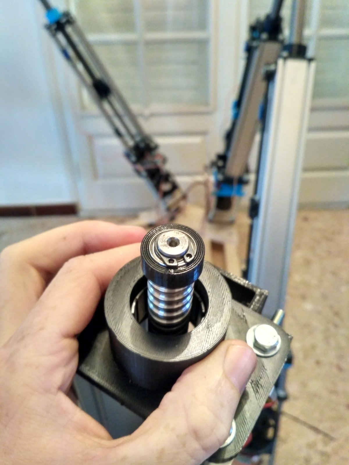

    quick update for woble fixing (at least most of it) in the actuator.
    Flange on the actuator carrier and a plastic part with a bearing to reduce play between the steel tube and the top end of the ballscrew
    2 are modified, 4 to go ....

    I have finished modifying all the actuators, it semms to be a good solution as the only wobeling left is my motor ... the motor support is 5mm thick and not as rigid as it could be.. well see if this is a problem.

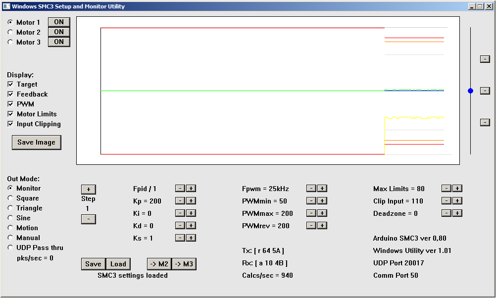

    414Coins
    +133 / 0 / -0
    Hello everyone, some update
    Need help with SMC3 tuning also !
    I set parameter rapidly, it is working quite well without me on the rig... with my 70kg it is a lot more bumpy and not so great .. any advice ?

    You can find info about SMC3 PID tuning here:
    https://www.xsimulator.net/community/faq/a-laymans-analogy-guide-to-pids-pid-tuning.219/
    https://www.xsimulator.net/community/faq/practical-examples-video-tutorial-to-jrk-pid-tuning.225/
    The SMC3 thread has an overview as well:
    Although I'm not sure you'll be able to tune the actuators with them attached to the rig with a 6DOF like that. I'd assume that most of the tuning would be done with one actuator with a simulated load attached to it, but I don't have a 6DOF so someone like @SilentChill would be much better of giving advice in that area.
  17. SilentChill
    2,645
    20,601Coins
    +3,570 / 34 / -0
    @baykah
    I would try these just to start off with in SCM3 util.
    Kp= 450-500
    PWM Min = 0 <----- Make sure this is Zero all you will do is heat your motors up
    PWM Max = 220
    PWM Rev = 220
    Everything else should be ok ;)
    Edit: Make sure you set all the motors the same
  18. OZHEAT
    OZHEAT Active Member
    Oct 26, 2015
    208
    Australia
    2,459Coins
    +106 / 6 / -0
    3DOF, DC motor
    @SilentChill i'm sorry but setting PWMmin to zero is wrong.
    This is meant to be the minimum pwm value before the motor overcomes the load & friction and starts moving from rest.
    Think it as in your 12v motor even with no load. 0.5v isn't going to move the shaft all it is doing is producing heat, it may take 3-4v before it moves.
    PWM works just like a variable voltage source low pwm % lower voltage, higher pwm =higher voltages.
  19. Tim McGuire
    Jul 26, 2015
    261
    Canada
    2,221Coins
    +317 / 2 / -0
    3DOF, DC motor
    In theory setting your PID loop correctly will alleviate that issue completely though. If the sim position is not approaching the set-point, the integral term will ramp up the power until the sim starts moving. Personally my position would be to keep PWMmin as small as possible and spend more time tuning the loop properly. I have mine set to nearly 0 (it takes at least 55 for my motors to move), and spending more time tuning the loop properly.
    If your PWMmin value is set too high, your loop will become unstable with lower values of Kp/Ki then it would otherwise.
    This is just my personal experience though, other settings might work best for different sims :)
    • Dislike Dislike x 1
  20. SilentChill
    2,645
    20,601Coins
    +3,570 / 34 / -0
    Hmmm okay ....................... I'll leave this well alone
