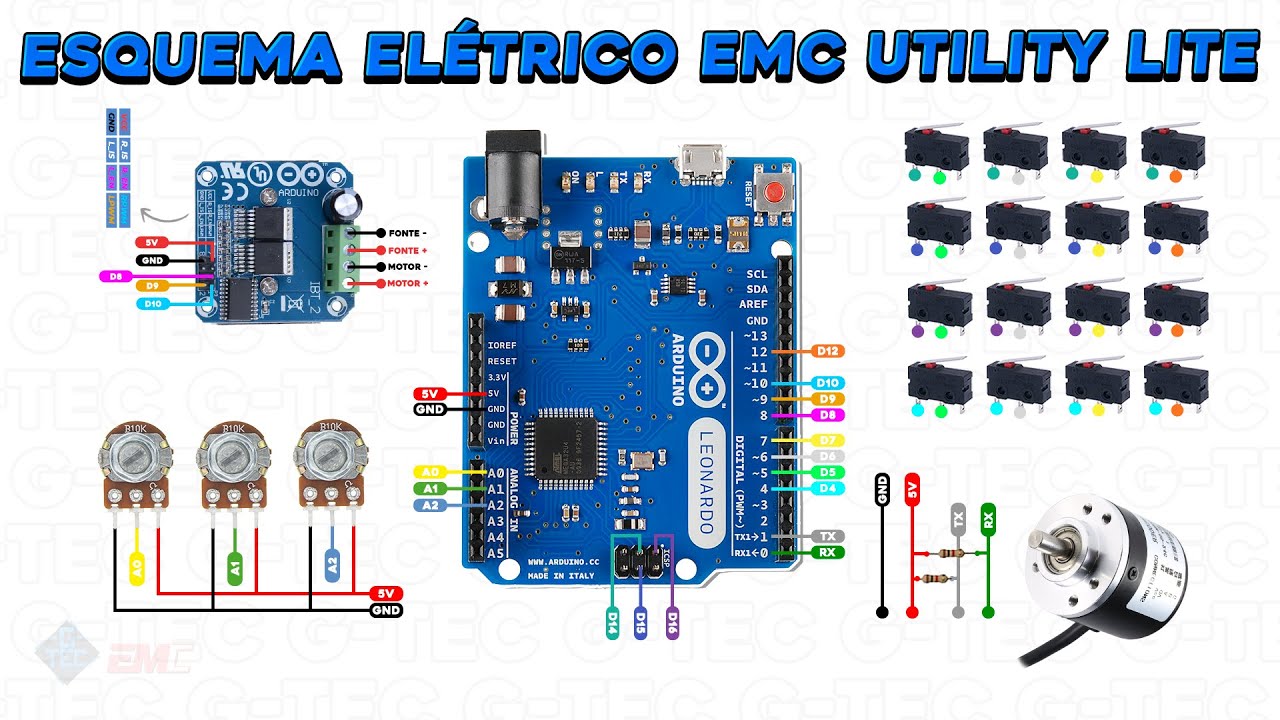

    So I’ve got my rig back up and running but motor 3 only goes in one direction! I’ve almost tried everything, I’ve swapped out the ibt2 thinking it may of been a driver problem, tested the ibt2 on different pwm input on Arduino and same result, and I’ve tested the motor in position of motor 2 and works perfectly, I’m running 3x 33a led power supplies relay per motor to estop, any ideas? All I can think of is maybe the pins on the jumpers are not contacting properly.

    I already did the isolation now I have 3 cables but I don't know how to connect them to the bt7960
    PD:
    It strikes me that it only hard loock in one direction and not in the other, could it be that my BTS7960 is damaged?

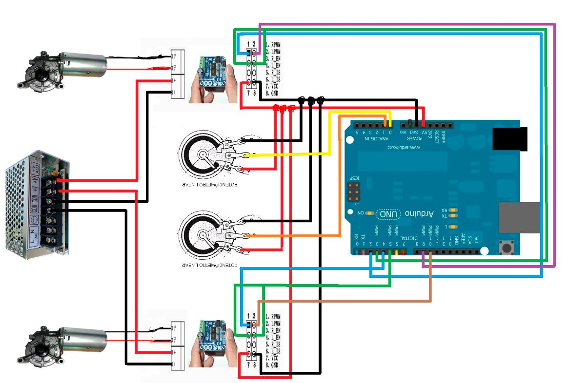

    I am testing the motor with a computer source but my problem is that I do not know how to connect the cables to the bts7960 since I have everything configured correctly I am using EMC UTILITY I use this electrical diagram

    Mine was a loose pin I hard wired everything all is good now!

    Great! I've the same problem, but I cannot find loose wires. Got some strange reading on the IBT output aswell.. This week I will get new IBT's to test from start again.
    Which wiring diagram did you use?
  15. Nikkatai
    Nikkatai New Member Gold Contributor
    Jun 17, 2022
    21
    97Coins
    +14 / 0 / -0
    This one here

    Just make sure you use smc3 to ensure the motor is following the green line( potentiometer) if not, reverse the motor wiring or pot wiring, a lot of info in the forums on how to do that.

    Netherlands
    214Coins
    Thanks. I use the same wiring diagram.
    If I reverse the pot wiring, it does nothing. Green line won't move than.
    Reverse the motor wiring, only changes the direction of the motor and has the same problem.
