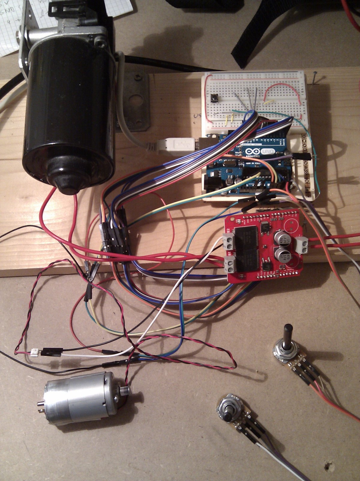

    I ask you some support in my DIY motion simulator, 12V DC wiper motors, arduino + sparkfun moto monster project.
    I based my project on RacingMat project. Big thanks to him for this detailed project. It is very helpfull.
    So I used an arduino, linked to an sparkfun moto monster as depicted in the project. It work well but the motor choosen do not go in reverse direction. I am blocked at this step since some months. I need help to analyse the problem.
    A picture of the project is in attach of this post. It seems not clean. It is due to my numberous attempt to solve the problem ;)

    My observations:
    - without any load, the behavior of the moto monster is ok : the led showing the direction of the output varies well with the value of the potentiometer. the measured voltage goes from positive values to negative.
    - with the load (the wiper motor), the motor run in forward mode. But it do not move in revese mode. The voltage measured in this operating condition is only ~-0.5 V. The led showing the direction are both ligthing, despite the full rotation of the potentiometer. (note : I tested it at full pwm : pwm = 255)
    At first, I though my connection to the moto monster was bad (bad brazing?). I order a second one to do it better (this time the connection is good!), with the same result.
    I changed the supply to avoid power limitation : server supply hp DPS-600. With the same result.
    Investigation :
    - with a lower load (a inkjet dc motor), the motor run in forward and reverse direction. I remark that to control the motor, I had to provide high level of PWM (first attempt at 100 was not enough, 200 worked well)

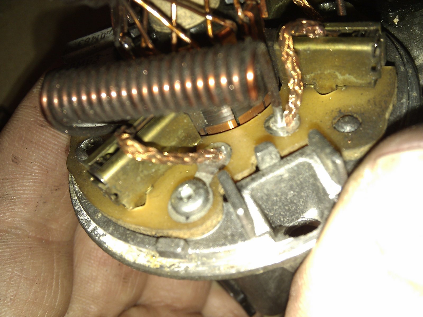

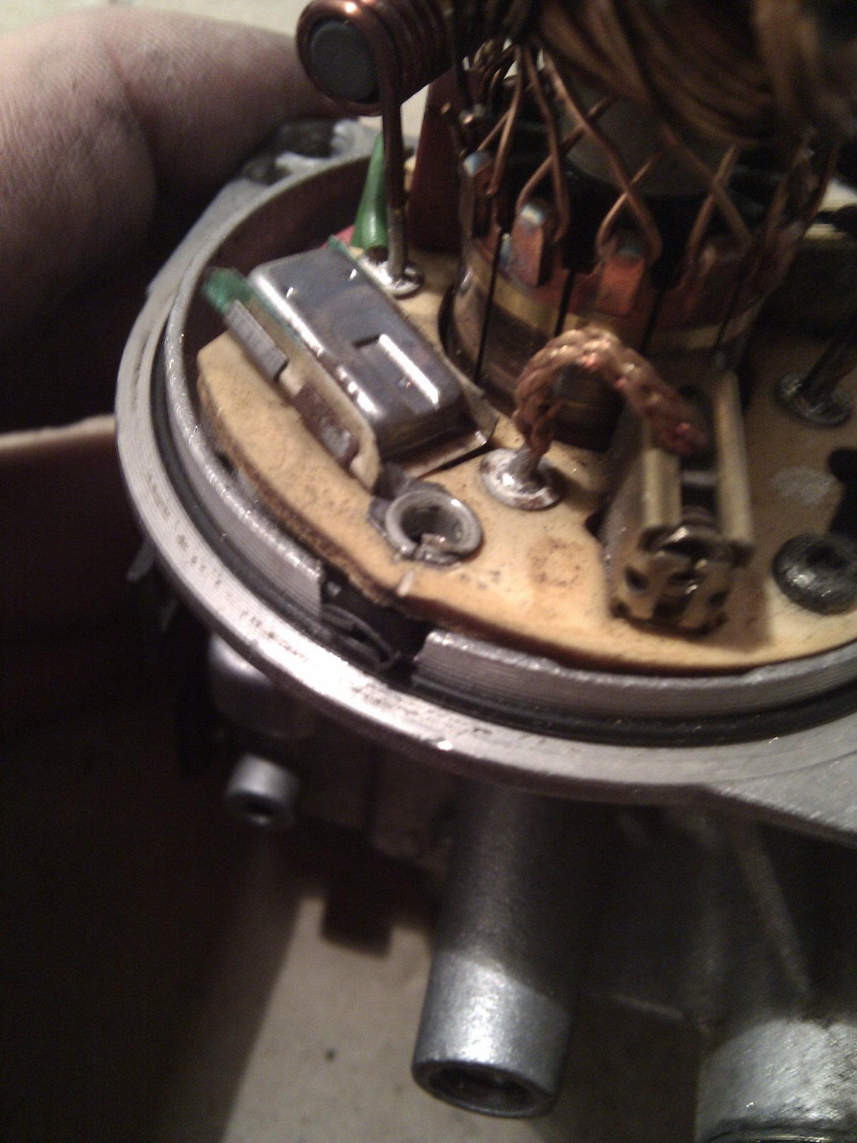

    My motors were not internaly isolated (but still ground isolated as fix it on a wood board!). By the way, I never read about ground isolation in the post a came across. Ground isolation is now done. For the record, I attach 2 pictures of the links inside my motors. I removed the screw (linking to the chassis) and put some isolating tape below.

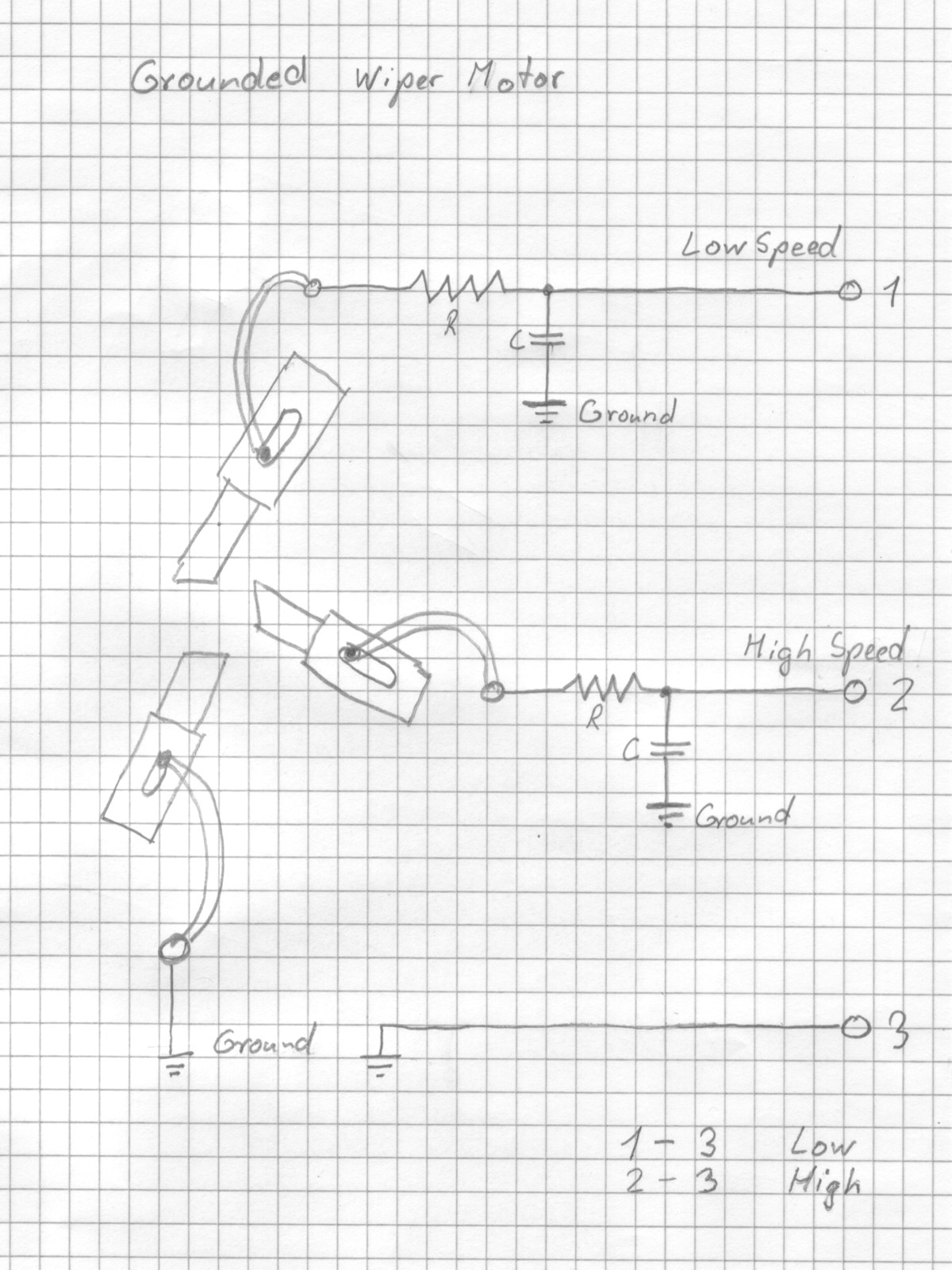

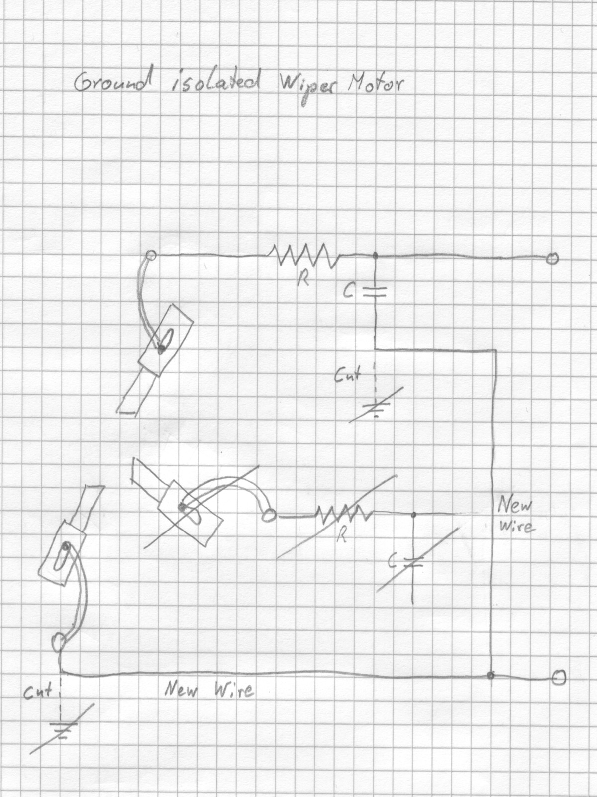

    1. I think you did not isolate your motors correctly. A wiper motor with 2 speeds has two connection wires, the third connection is ground (chassis). If you only isolate ground internally, the third connection is missing and you are using 2 carbon brushes which are in a 90 degree angle. That seems to be the reason for the different amperes in both directions.
    I've made two drawings to show the correct wiring:
    You can only use the 2 carbon brushes which are in opposite direction (180 degree), the 3rd carbon brush (90 degree) can't be used anymore.
    Here is a very helpful thread that shows pictures of ground isolation:
    http://www.xsimulator.net/community/threads/isolating-a-wiper-motor-ground.3358/
