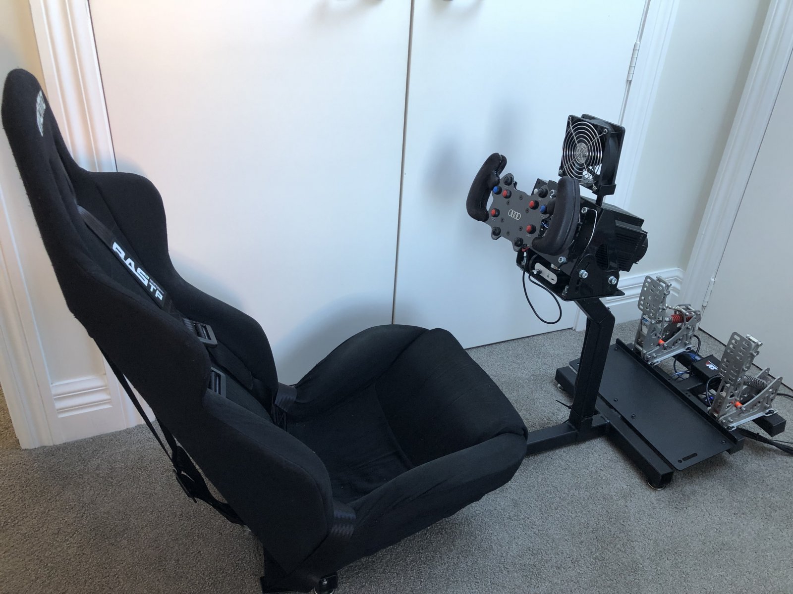

    I'm in the beginning stages of extending my sim racing rig with the addition of 2DOF + traction loss.
    I've got a simple proof of concept running with wiper motors, arduino, and SMC3, and live for speed, so that I could get my head around some of the concepts.
    And I've got a lot of parts, with still more on the way, some steel, and a home welder. It's important to me to keep things as compact as possible.
    The main issue I've faced so far is not realising that the motors I purchased were Brushless DC Motors, and instead of simple brushed motors. This has caused me some concerns but I think I'm making progress there.
    But to start with, below is my DIY rig as the starting point.

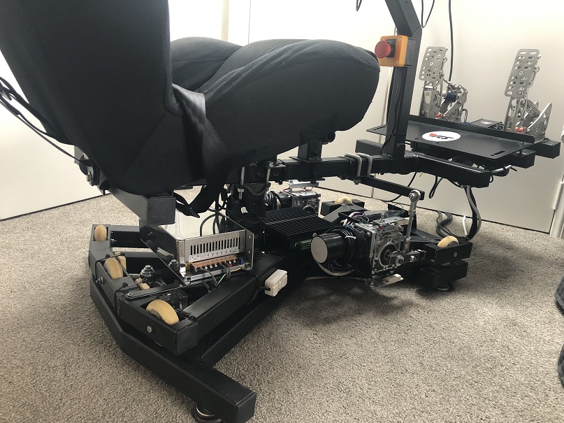

    [Edit] A long time, and a LOT OF EFFORT later, here's what is now sitting beneath that original rig:
    And here is a video of it while running Dirt Rally:

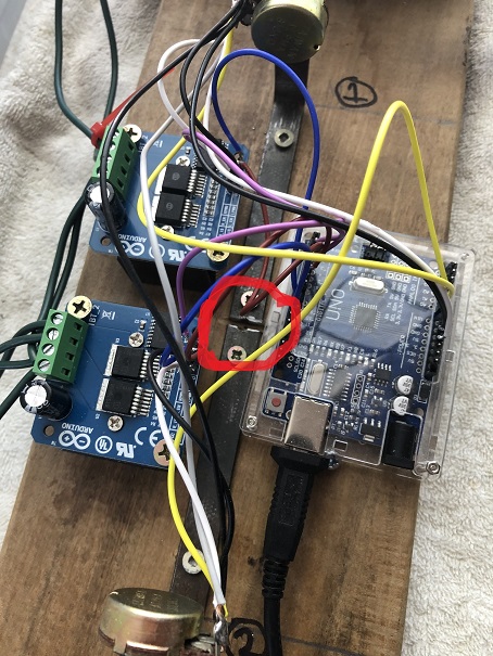

    First step is a proof of concept using the SMC3 code, Arduino UNO, BTS7960 motor drivers, and wiper motors from a Toyota van. It was tested using SMC3Utils v1.01.exe, and eventually Simtools and Live for Speed.
    I got a lot of information here:
    But it still took me a while to figure things out, and a lot longer to get going than it should have due to another reason. I could get one motor to operate using SMC3Utils v1.01.exe, but not both.
    I eventually realised that due to the way the everything is connected with metal (except for a wooden insert in the aluminium tubes), there is actually a very poor short circuit from one motor to the other when they are operating in opposite directions. Poor or not, a short circuit is a bad thing. The attached photo show's where I used a steel cutting blade and solved the whole problem.
    I'm not sure how I will deal with the final equipment mounted on a steel rig but that's for another day.
    EDIT: Just found this thread about isolating ground on Wiper motors. Would have saved myself some time if I'd found that earlier, and would definitely be useful if I planned to use the wiper motors on the final setup:

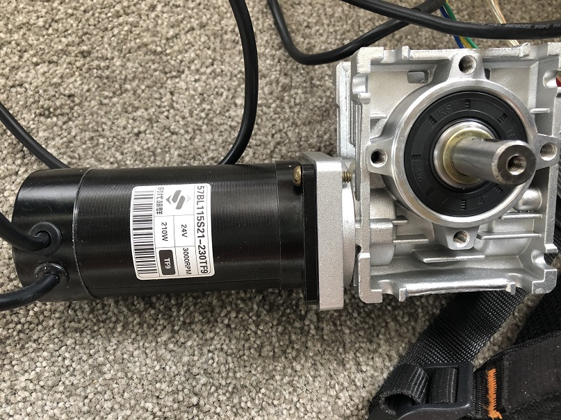

    - and three BLDC motors with 50:1 wormgears...
    Yes, maybe they are not the ideal motors, and maybe I should have researched more before I got them, but they are what they are and I hope to get them working. And to me they are things of true beauty :)
    The motors are 0.7Nm, 210w, 24v Brushless DC motors with built in hall sensors, and 50:1 wormgears.
    Upon realising that these are 3 phase DC motors (what??), and my proof of concept with H-Bridges was not going to be useful, I had to find another way to control these motors.

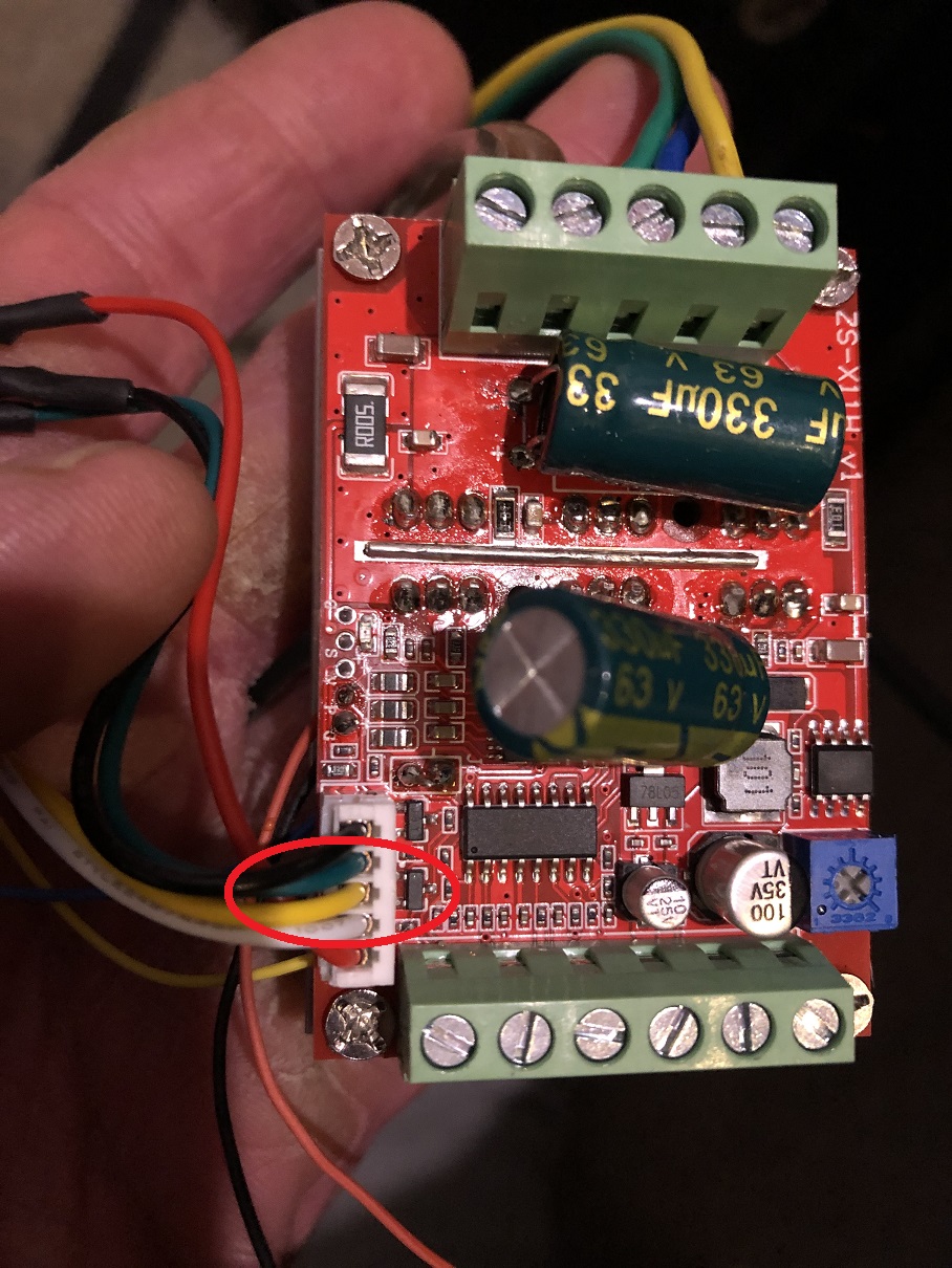

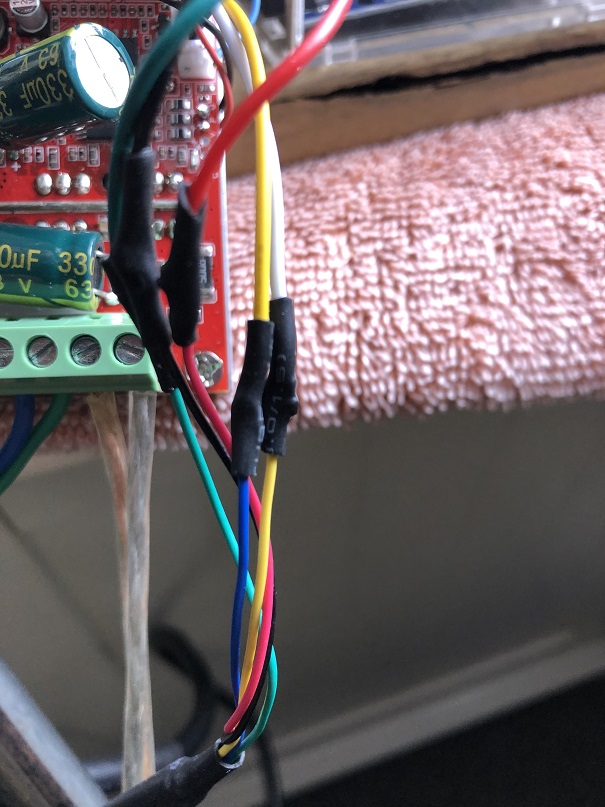

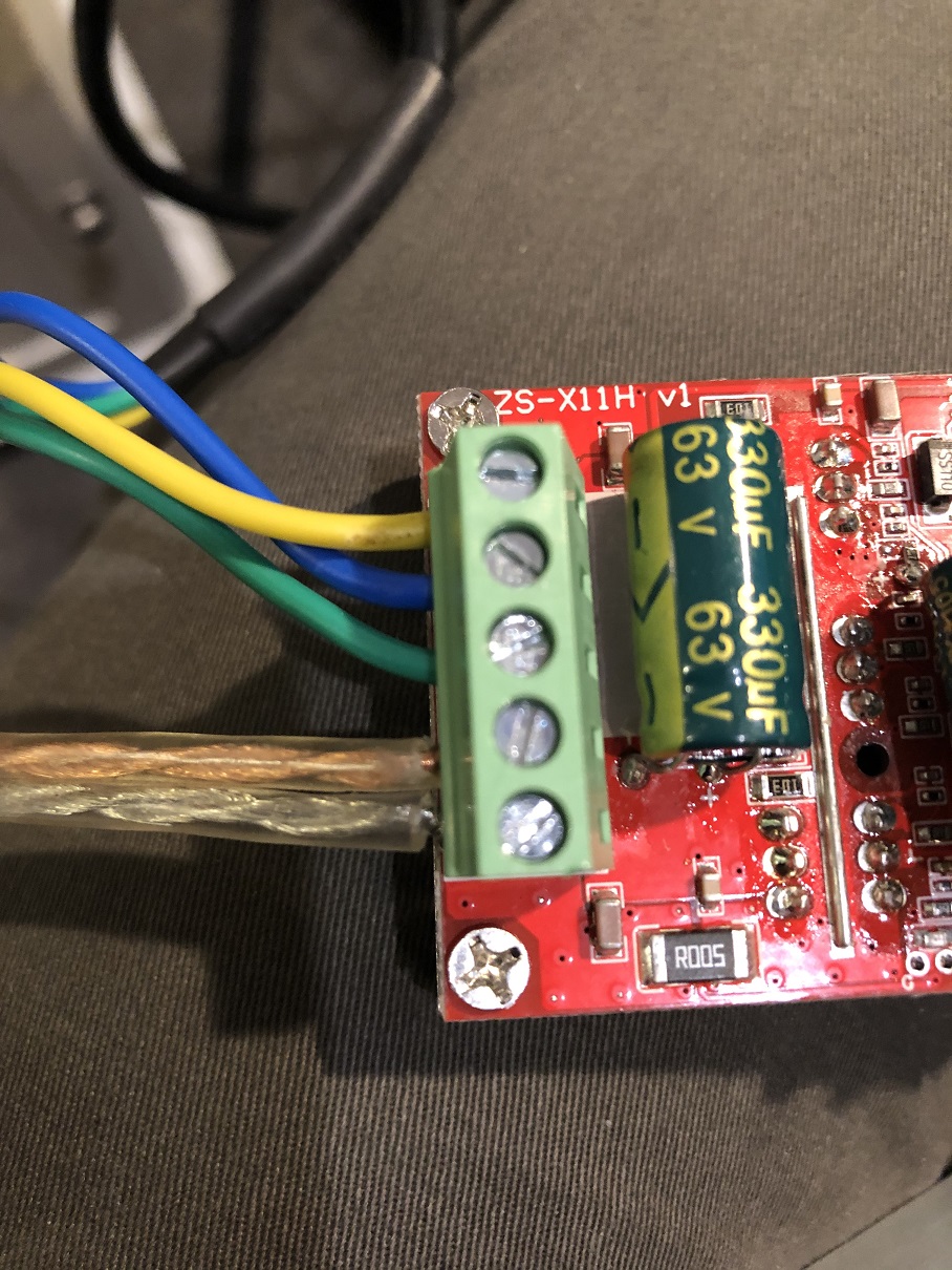

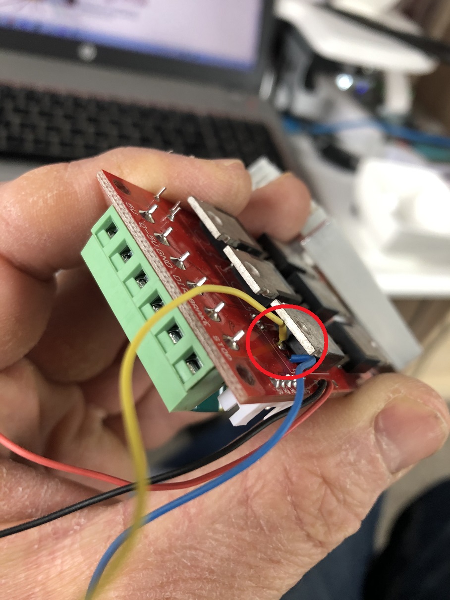

    So understanding the wiring of the motor drivers has been a learning experience. As mentioned I've burned out one motor driver already. That just means a delay until I can get another one delivered (at least a month), but luckily still have 2 more.
    First, the order of the motor 3 phase wires needs to match the order of the hall sensor wires. The photo below seems to indicate that this is not the case, but in fact the colored hall sensor wires are soldered, just on the edge of the photo (see second photo), to ones which match order of the motor wires. So Yellow-Blue-Green in the same order on both.

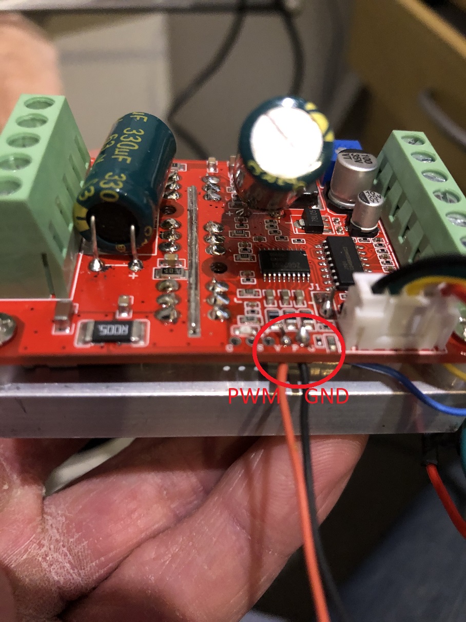

    Second, the tiniest connectors ever for PWM input! The PWM from the Arduino is the red wire going into the board, and black is ground from the Arduino.
    Third, more tiny connectors! Here is where you need to solder a jumper to tell the motor driver to use PWM mode. The jumper pin holes are beneath the capacitor on one side of the board, and you need to remove the heat sink on the other side to be able to solder it. I have the red and blue wires twisted together just out of the photo. Will replace those 2 wires with a single short jumper wire.
    Lastly, this is the motor running from SMC3Utils (in sinewave mode) via the Arduino. The motor changes speed, but doesn't yet change direction as it should. The motor driver needs a pin to be grounded (I think) for reverse direction. This is my next issue to solve, and I think will require some tweaks to the Arduino code.

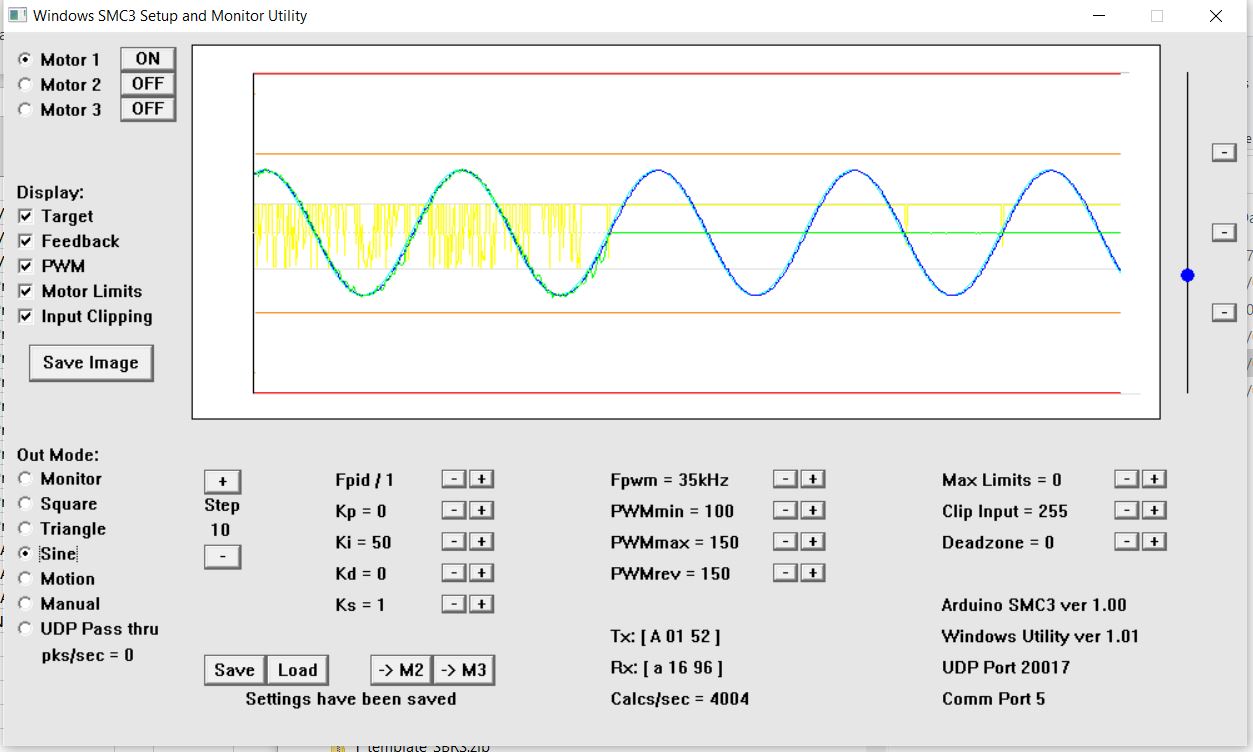

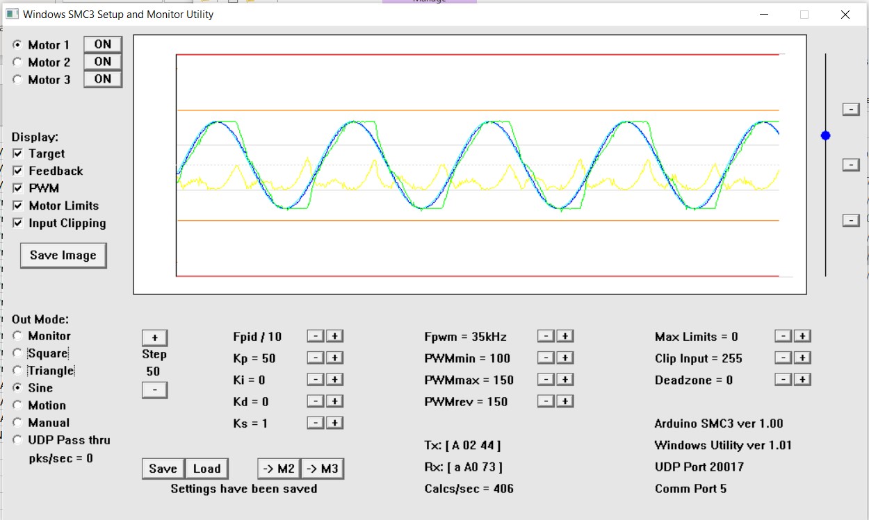

    I now have the BLDC motors running in both directions, using SMC3Util with the Arduino providing PWM & Direction to the motor drivers. I thought/hoped this would work but there are serious issues which may require a completely different approach.
    Comparing the same setup between my wiper motors proof-of-concept (with h-bridge drivers) and the BLDC motors (with ZS-X11D1/ZS-X11H driver).
    The wiper motors setup does a pretty good job where the green Feedback follows the blue Target quite well:
    The BLDC motors setup does a better job. The Feedback follows the Target with great accuracy as shown on left half of the sceen-shot below.
    Unfortunately, while the accuracy is good, it's not useable as the motor is stop/starting or forward/reversing continuously trying to get meet the target. This is clearly not good, but somewhat funny!
    So, I will revisit the way I am using the motor direction output in case I can find a better solution. Many times I have wished I had an oscilloscope, including now! Otherwise I think I need to look for significantly different way to do this, and will probably start to look in depth at the way @pmvcda (FlyPT) achieved the control he needed using similar BLDC motors in this thread here:

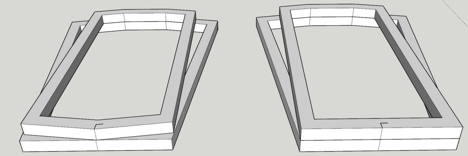

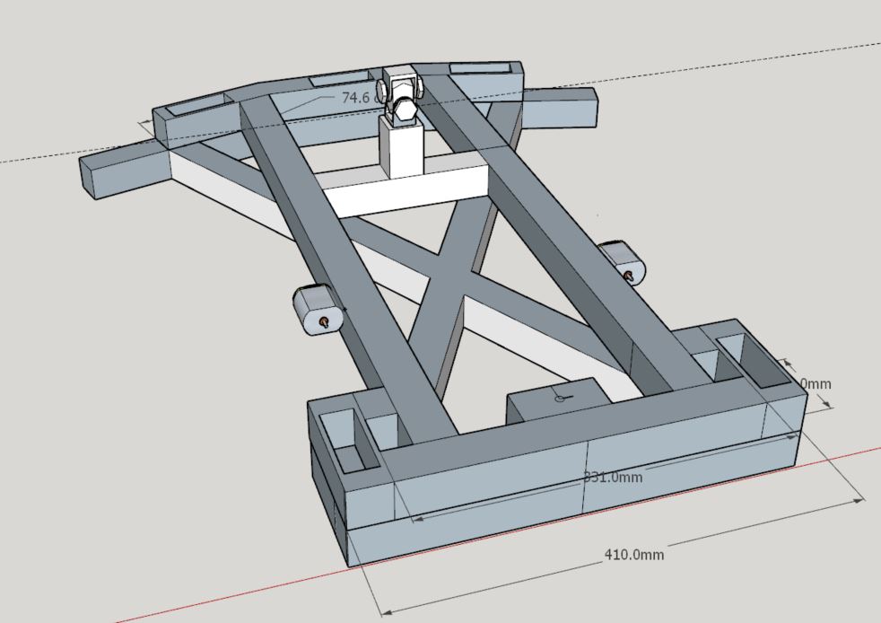

    Been doing some design before I start cutting steel. This is the traction loss frame so far, but things may change. The wheels are from roller-blades and will sit within the 38mm square section, two at the pivot end and two at the seat end.
    The pivot point in this case is to the rear of my pedals (behind where my ankles sit)
    EDIT: Update below for a number of reasons, including so that there is space for the motor cranks/arms to operate below the lowest point of the upper frame and above the floor, but not hit the lower frame when the unit swings left/right.
    Can anyone suggest the ideal left/right angle should I be aiming for? At the moment it's 8 degrees (100mm left and 100mm right) but wondering if it should be more?
    EDIT: I've found the following on this subject:
    https://www.xsimulator.net/community/threads/how-much-movement-in-drift-axis.6837/
    https://www.xsimulator.net/community/faq/traction-loss.174/
    While there's useful information in those posts, I still haven't found information about traction loss angle. Distance left/right seems irrelevant to me without knowing distance from pivot point and therefore the most important thing that you will feel - angle. I don't have enough time to spend reading every forum so may have missed something. For now I think I'll continue with 100mm shift either way.

    your tracking problem may be due to your smc3Utils setting. tried with a lower frequency (Fpwm) because your controller works from 50hz to 20khz, I had this problem with my bldc controllers. you also have to adjust the min and max pwm (for me it's 48 and 255)

    in fact the green line is the monitoring line of your engine and the blue line is the one to follow, it is normal for your relay to click on the black circles if there is no more engine monitoring.
    the motor reversal will be done on each side of the green line and no blue line (example: blue ball under the green line clockwise, blue ball above the green line anti-clockwise)

    Of course you are correct @hoyang! I had completely the wrong idea there, and it's obvious now that you point it out. Thank you for saving me a lot of wasted time.
    So now I'm back to square one unfortunately. As my motor/arduino tries to follow the target curve (say a sinewave) the feedback crosses the target line and the motor then reverses to bring it back to towards the target. Going in reverse it then crosses the target line again and once again the motor reverses. It kind-of makes sense that it continually changes direction and it certainly follows the target line very well.
    There must be a better way though :-( Time to do more research in PID control systems I think.
    I will also experiment with the PWM frequency, but I'm sure I've tried all options before on that.

    after several tests on the smc3 tuning I found how to avoid engine monitoring overruns adjust kp = 10 ki = 0 kd = 0 ks = 1 then increase kp point by point for a good follow-up without overshoot. if pwmmin and pwmmax are correct there are no more problems.
