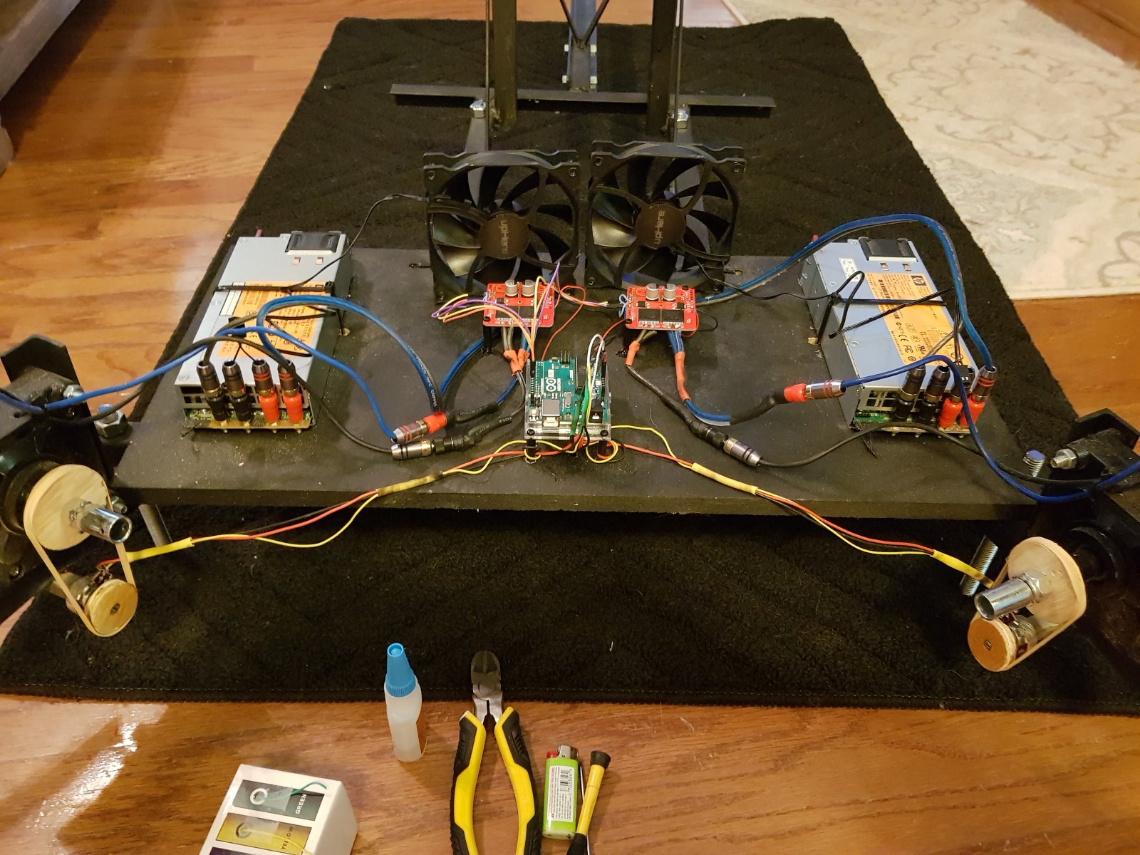

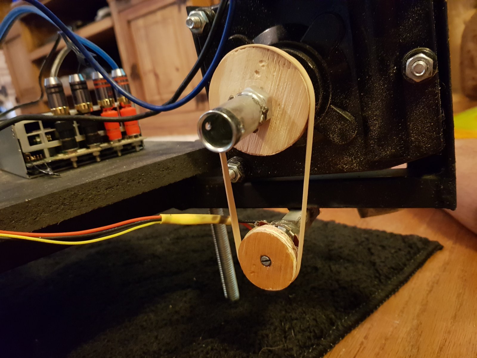

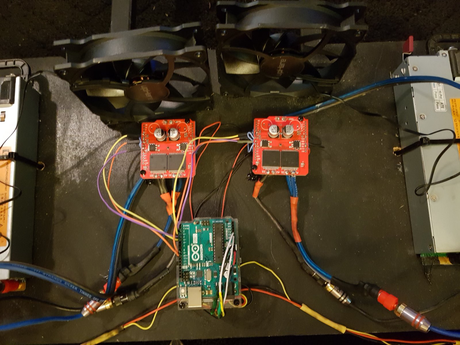

    The new motor controllers are hooked up! Everything is wired up working correctly...ish (more on that later). The new potentiometer mounts are much better though they still need some minor optimization. I cut small discs out of wood to mount on the motor and on the pot. I can adjust the size difference to dial in sensitivity. As of now I'm using a rubber band as the drive belt. They seem to work quite well, but I'll be testing out various materials with less elasticity. The rubber bands are nice because if the motor continues spinning then it doesn't force the pot to keep spinning once it hits its limits. I've included pictures of the new pot mounts and the whole wire setup for testing. Wire management will come after I'm sure everything is working.
    As for initial testing with smc3 utils, the right motor is functioning perfectly. It starts, stops, and changes directions according to the potentiometer position. The left motor, however, will work for a couple cycles then the motor controller and fan plugged in to the same power supply will shut down. I haven't gotten the multimeter out yet, but since the fan turns off I assume it's the power supply that is cutting power. I will swap power supplies and test again to narrow down the possibilities. The other problem I'm having is the second potentiometer. Sometimes it works as it should and sometimes it doesn't register a signal at all. The first pot works fine every time, but when the second stops transmitting signal, the first one will control both motor 1 and motor 2. I imagine it's just a setting somewhere, but if anyone has suggestions then I'm open to them.
    Mind you, this is testing for the first time after plugging in to smc3 utils, so I expect most things to be a bit wonky until the values are optimized. I'll read through some guides and post an update in the coming days.

    Double checked wiring and settings in the smc3 util software. After some slight adjustments everything seems to be in working order. The motor controllers are running nice and cool thanks to the fans. The rubber bands are working pretty good. I'll need to carve out better tracks in the wood pulleys so they don't slip off during operation. I'm uploading screenshots from the smc3 software demonstrating motor/pot interactions.

    The rig is bulky enough to be a pain moving from the garage to the living room, so I have to do my testing in limited time windows. The right motor has a tendency to overshoot forward and clip out the pot. Also, after 15 or 20 minutes of testing with my weight it will only move forward and not 'pull' the seat back resulting in movement only from the left motor. Not sure if it is from the overshooting or if the controller is still getting toasty. I've redesigned the fan enclosure to act more efficiently and will test more as time permits.
    Rubber bands as pulley belts have had ups and downs. They are super convenient and safe; however, sometimes the elasticity will cause the motor to 'rock' back and forth to find the stable point. No big deal, but it's a little funny being in the seat as it happens.

    You may need to refine your PID settings, here is a gentle introduction to understanding PID: https://www.xsimulator.net/community/threads/a-laymans-analogy-guide-to-pids.7649/
    And if you are using SMC3 the settings options are explained here: https://www.xsimulator.net/communit...driver-and-windows-utilities.4957/#post-48121
    You need good cooling for MMs, and if using cheap clone MMs check them carefully: https://www.xsimulator.net/community/faq/reputable-monster-moto-suppliers-testing-before-use.158/
    Good cable management also helps, as it reduces the risk of interference. You can also add cheap clip on Ferrite magnets to cables.
