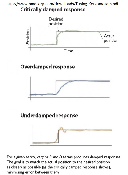

    It also helps to know what you are looking for when using the step-response method. The aim should be to set P with a slight overshoot and then increase D to critically dampen, as in the illustration:

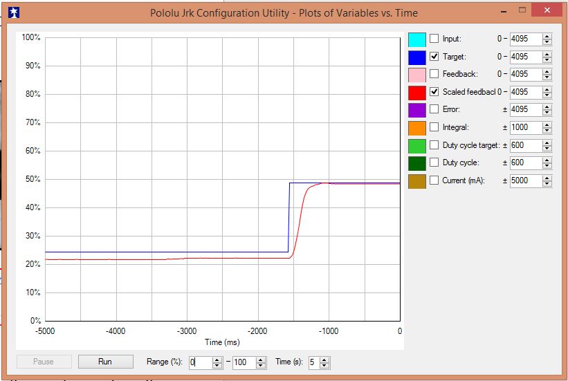

    Here are some test I did back on my old motors.
    This was at the higher PID P=0.75 I=0 D=1.2. I could stop it on the way up but on the way down it would over shoot. This is stepping the motor from a target of 1000 to 2000 and back again

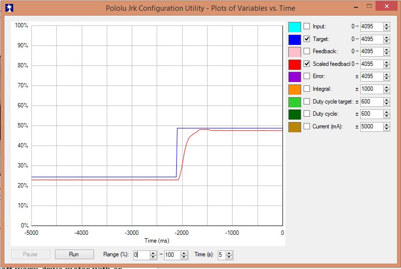

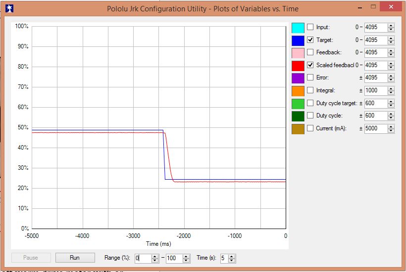

    This is what I settled on with my bigger motors at P=0.5 I=0 D=0.8

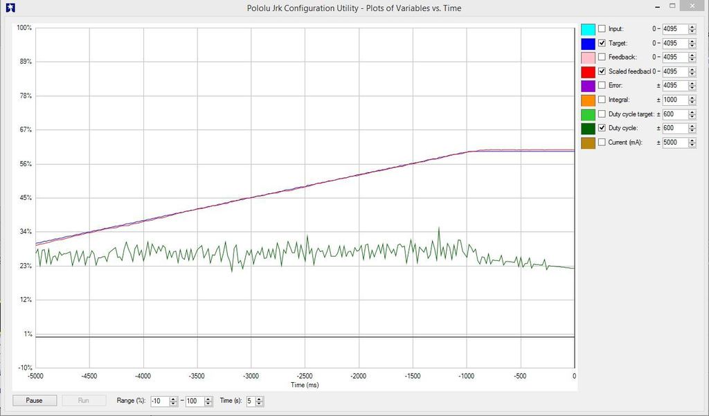

    Thanks. I tend to find that pictures and graphs help a lot. I am not too good with the maths behind it all so I just go by feel and what I see in the graphs.
    This has prompted me to have another play around with my PID and I have found a few interesting things.
    The main one I really wanted to test was with slow movements like in flight sims. I have found that the scaled feedback doesn't track the target very well with my old setup, it always lags behind on the upwards movement, it never corrects the error.
    I played around with the I and it made a massive difference.

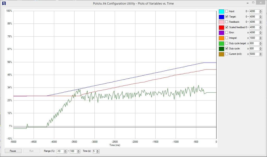

    This is a screenshot of a steady upwards movement with no Integral. It is like it never corrects for the initial lag as the duty cycles ramp up to the point that the motor starts moving.
    Here is the same test with the Integral set to 0.02, it now corrects and follows the target perfectly

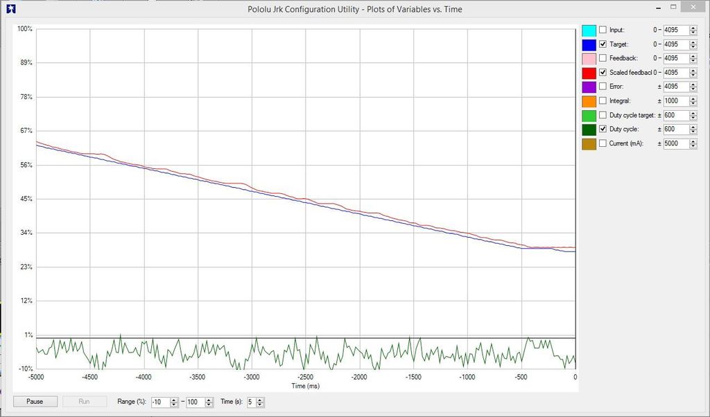

    Downhill seems to be a bit smoother also. This is with Integral turned off

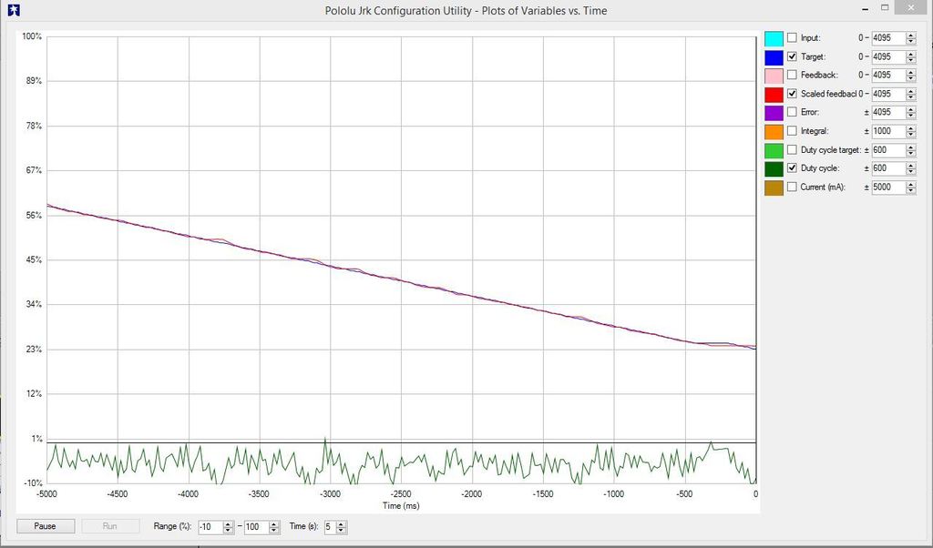

    And this is it with Integral set at 0.02
    I recorded a quick video showing the difference. The video really shows the difference well.

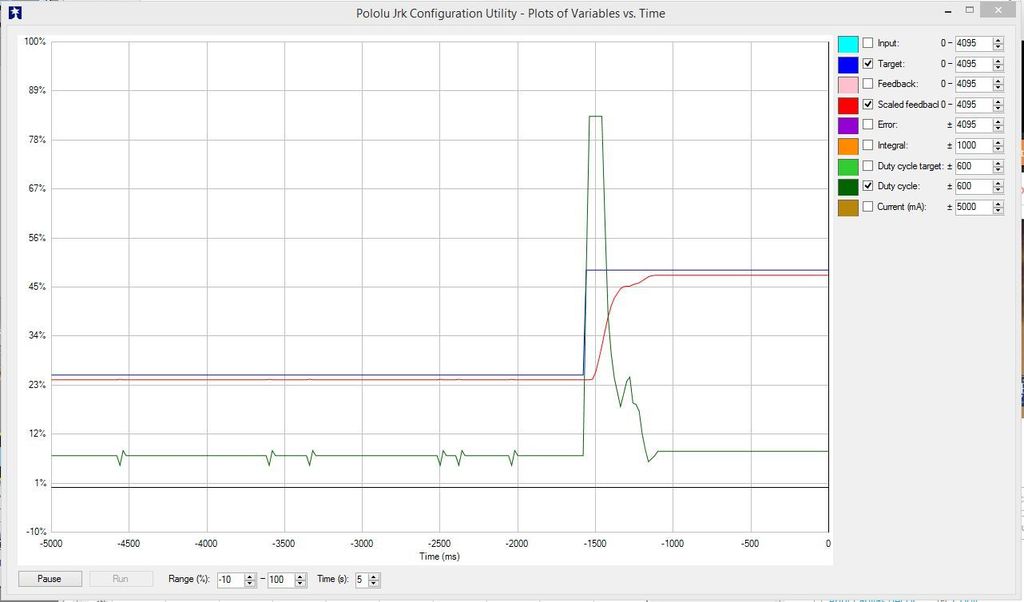

    Like this is a example of a fast movement. You can see it jumps straight up to my duty cycle limit, I have it limited to 85% duty cycles. (Ignore the actual curve, I am playing around with different settings)
