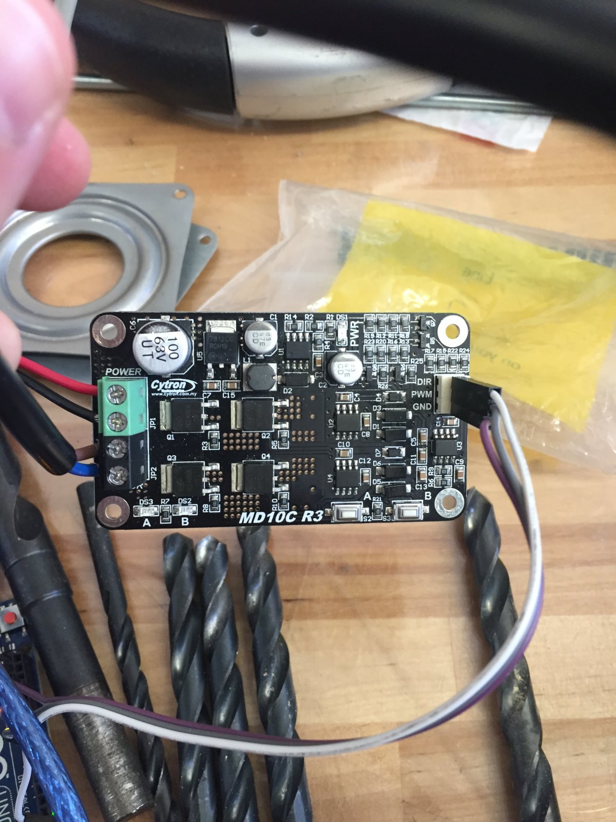

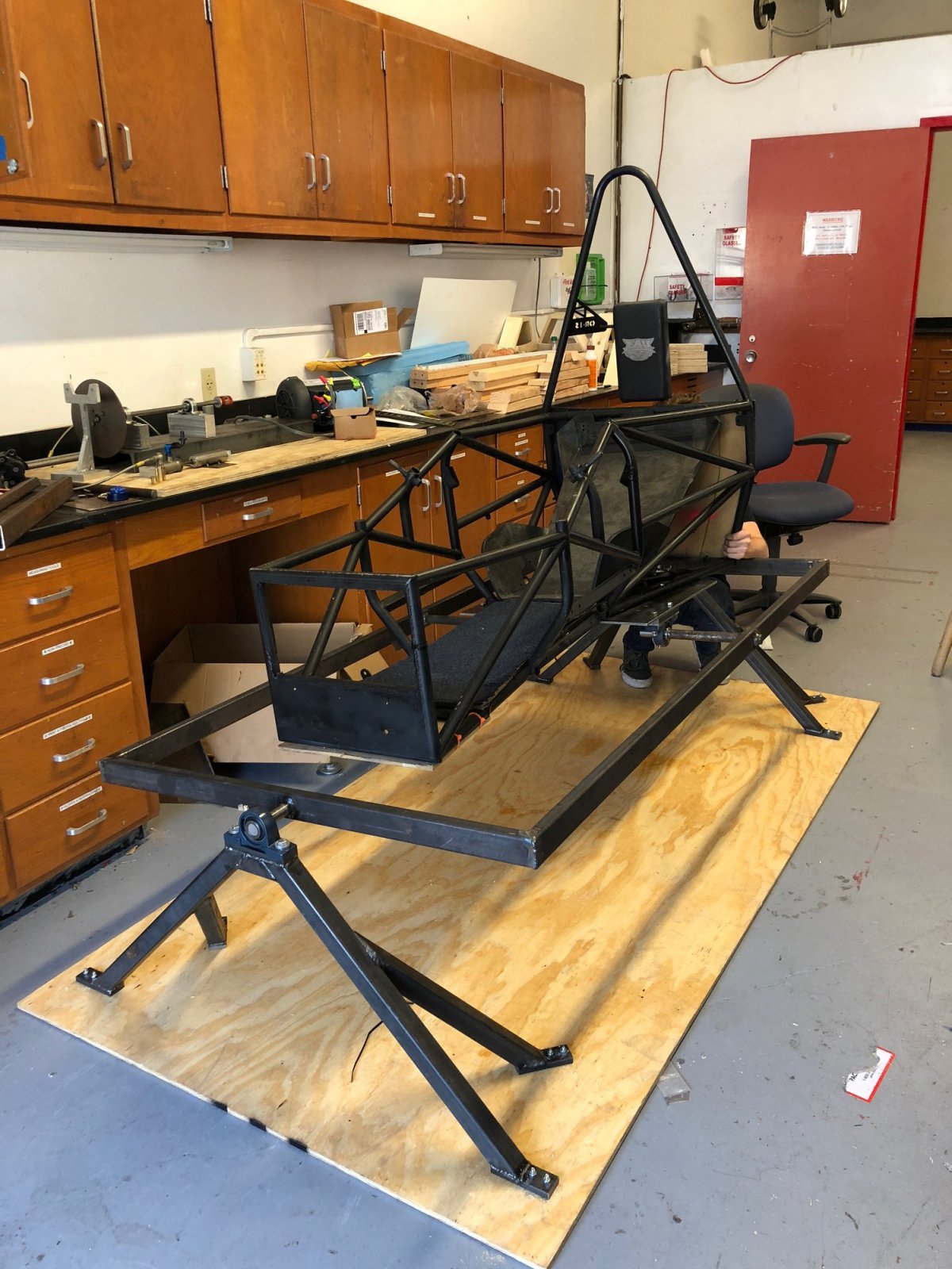

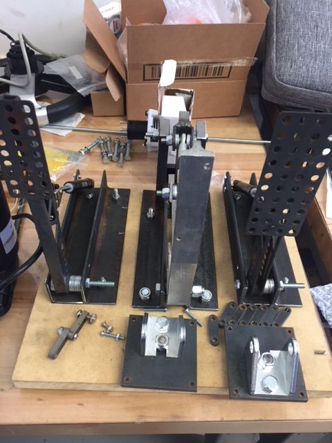

    Here are some pictures as requested.
    Car frame can rotate about pitch and roll axes. It has shaft connected to bearings. This is meant to simulate surge and sway.
    Motor driver is made by Cytron. Can control one motor. Has 1 DIR pin, PWM pin and GND pin. IMPORTANT: motor has no potentiometer/feedback. Feedback is given by gyroscope which measures angle of rotation of the car about each axis.
    Pedals: gas and clutch contain potentiometers. Brake has load cell. Steering wheel also has potentiometer.

    I would suggest you are going to need to find a way to interface a gyroscope, and even then may have to deal with things like drift, or go out and buy a couple of pots or Hall sensors, make mount brackets for them and just hook them up...I would suggest the latter is far easier and will definitely work, the former is a shot in the dark and not likely to happen by next week.

    Dude the potentiometers are to read the position of your Motors not the frame that's where you're running into a problem you're not trying to get feedback from your frame you trying to get feedback from your Motors so the code knows when to stop and start your Motors
