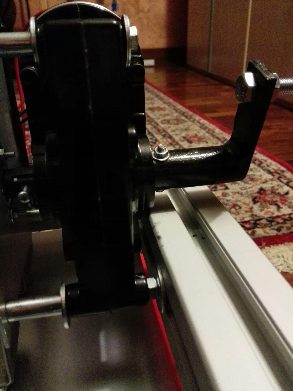

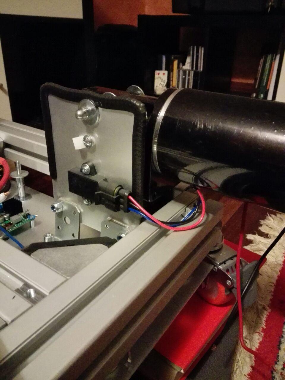

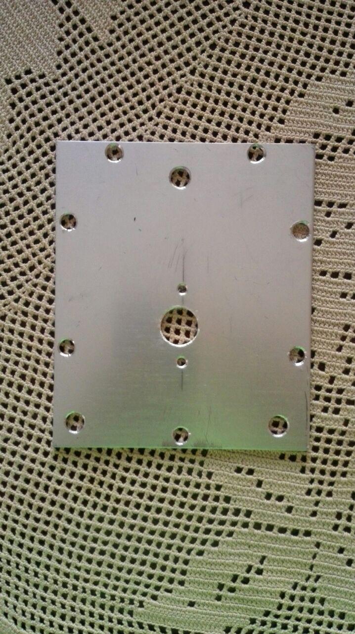

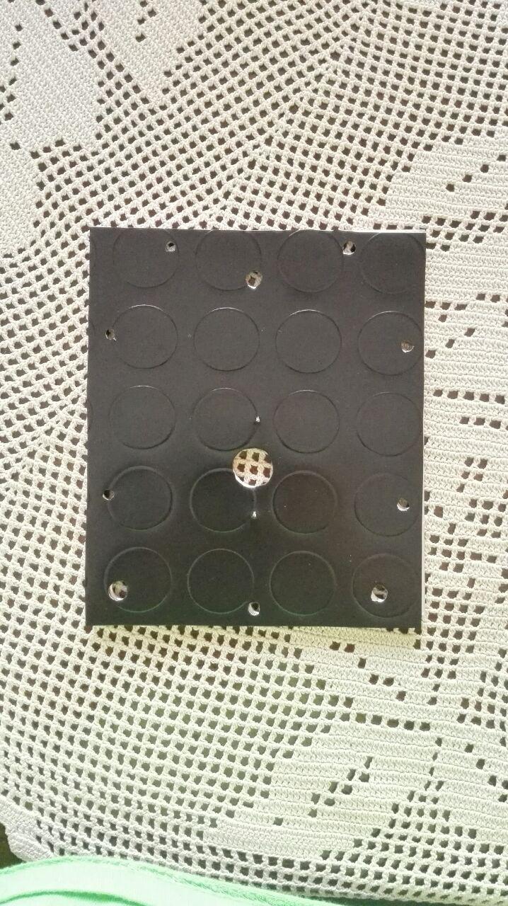

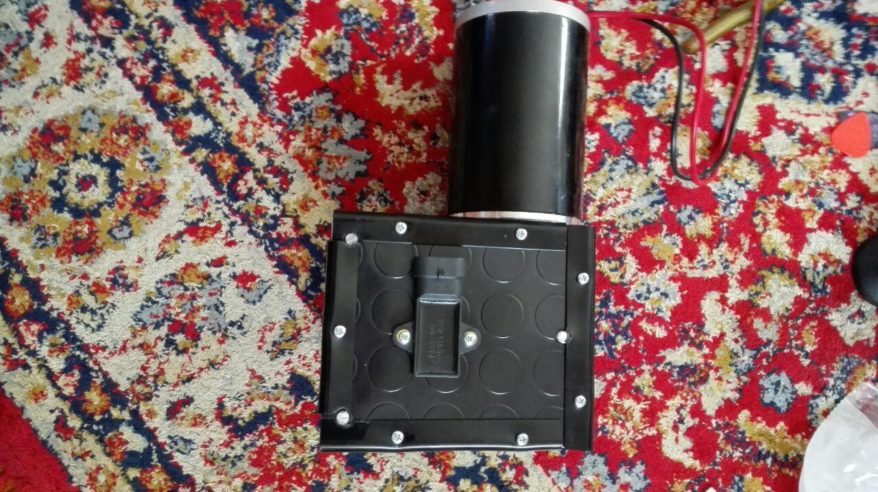

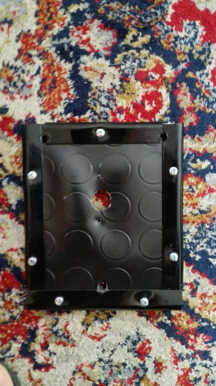

    Today I've maked plates for Hall sensor. It's rude, but seems good to me. I've wrapped it around black rubber to avoid magnetic interferences.
    photo_2017-08-13_18-23-33.jpg photo_2017-08-13_18-23-32.jpg photo_2017-08-13_18-23-14.jpg
    Here with sensor mounted:
    around 2 mm from sensor to magnet...

    Hey Mirko - the rubber is unnecessary - it won't affect magnetism. Also, those look like aluminum plates. It's non-magnetic. You should be good just as they are.

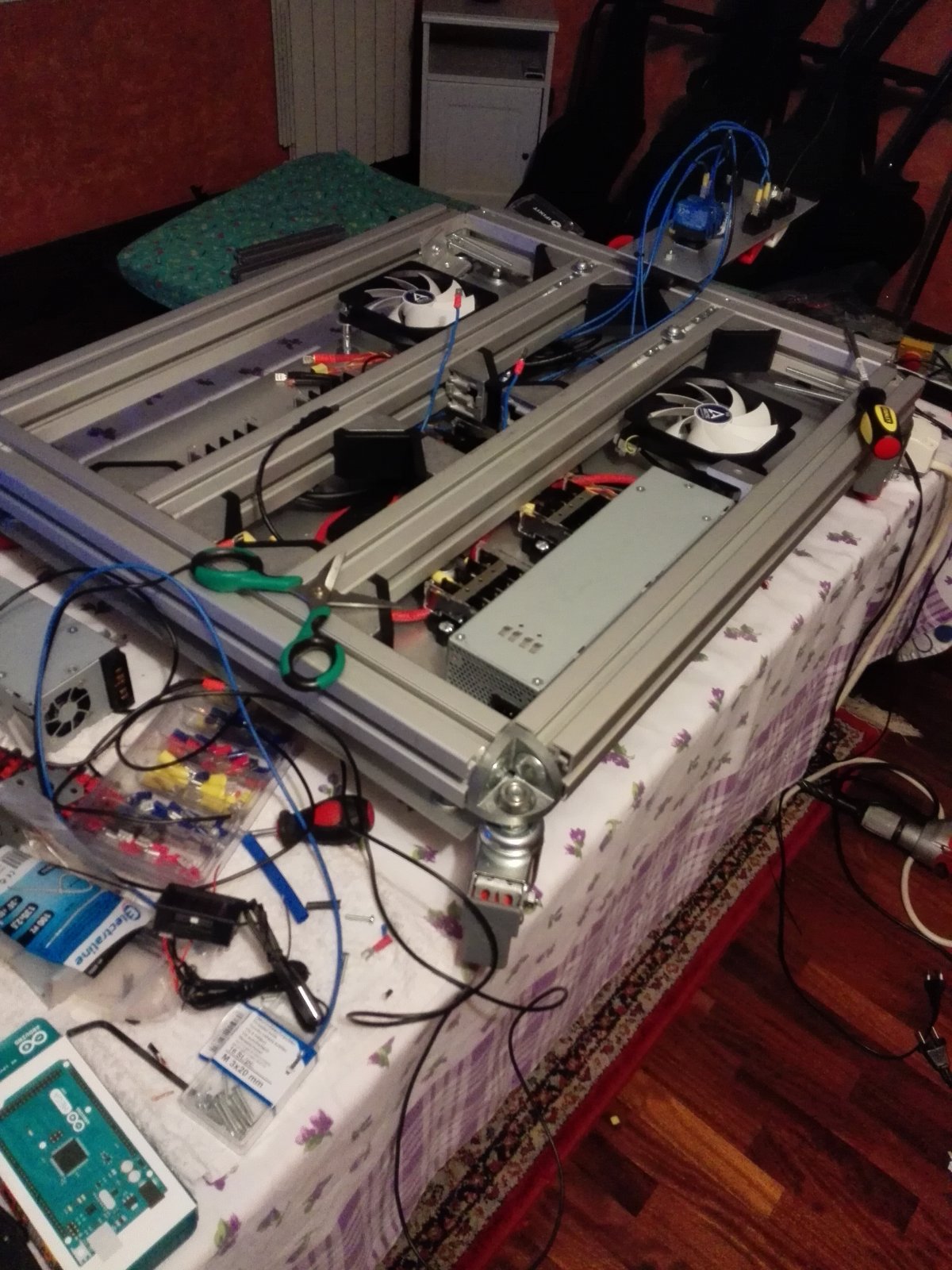

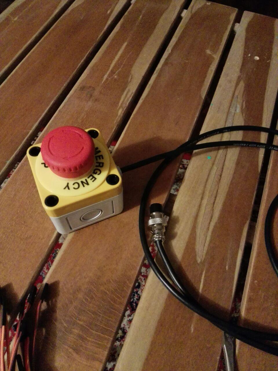

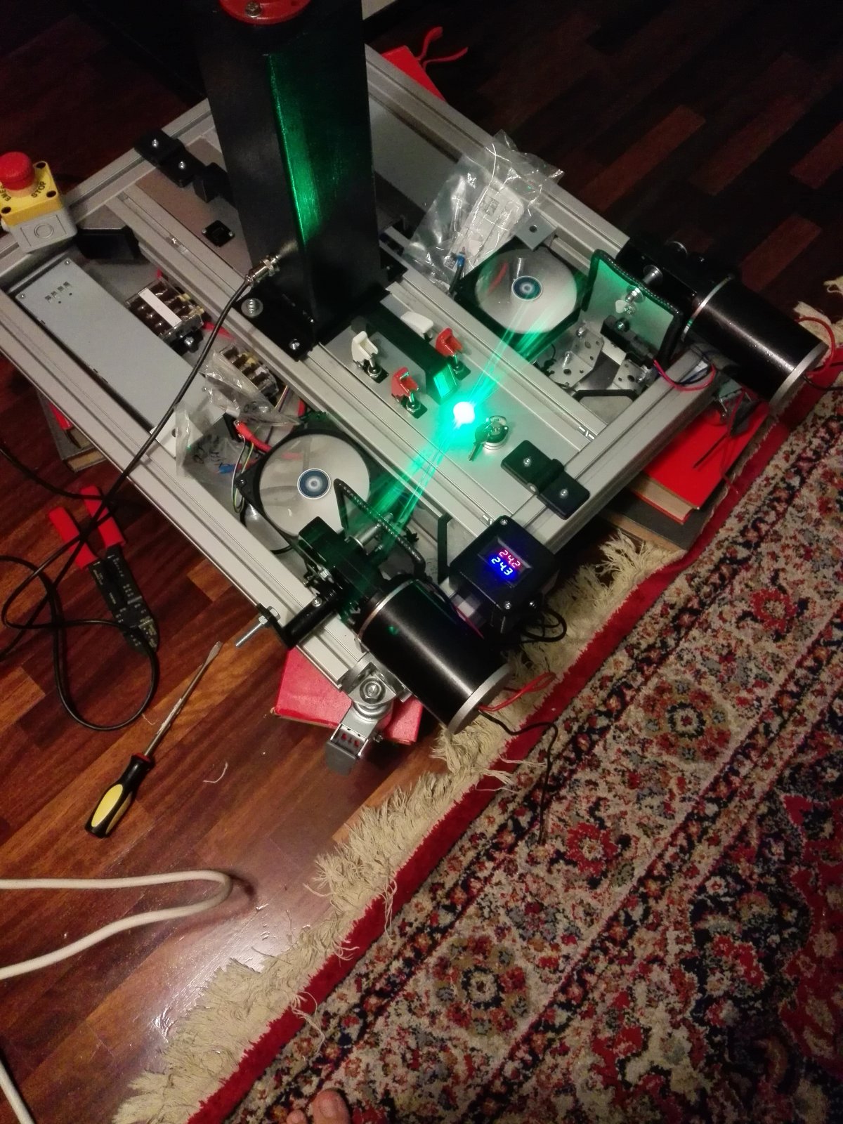

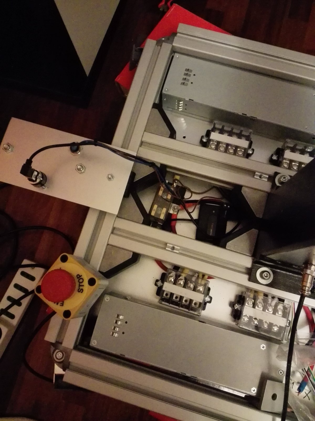

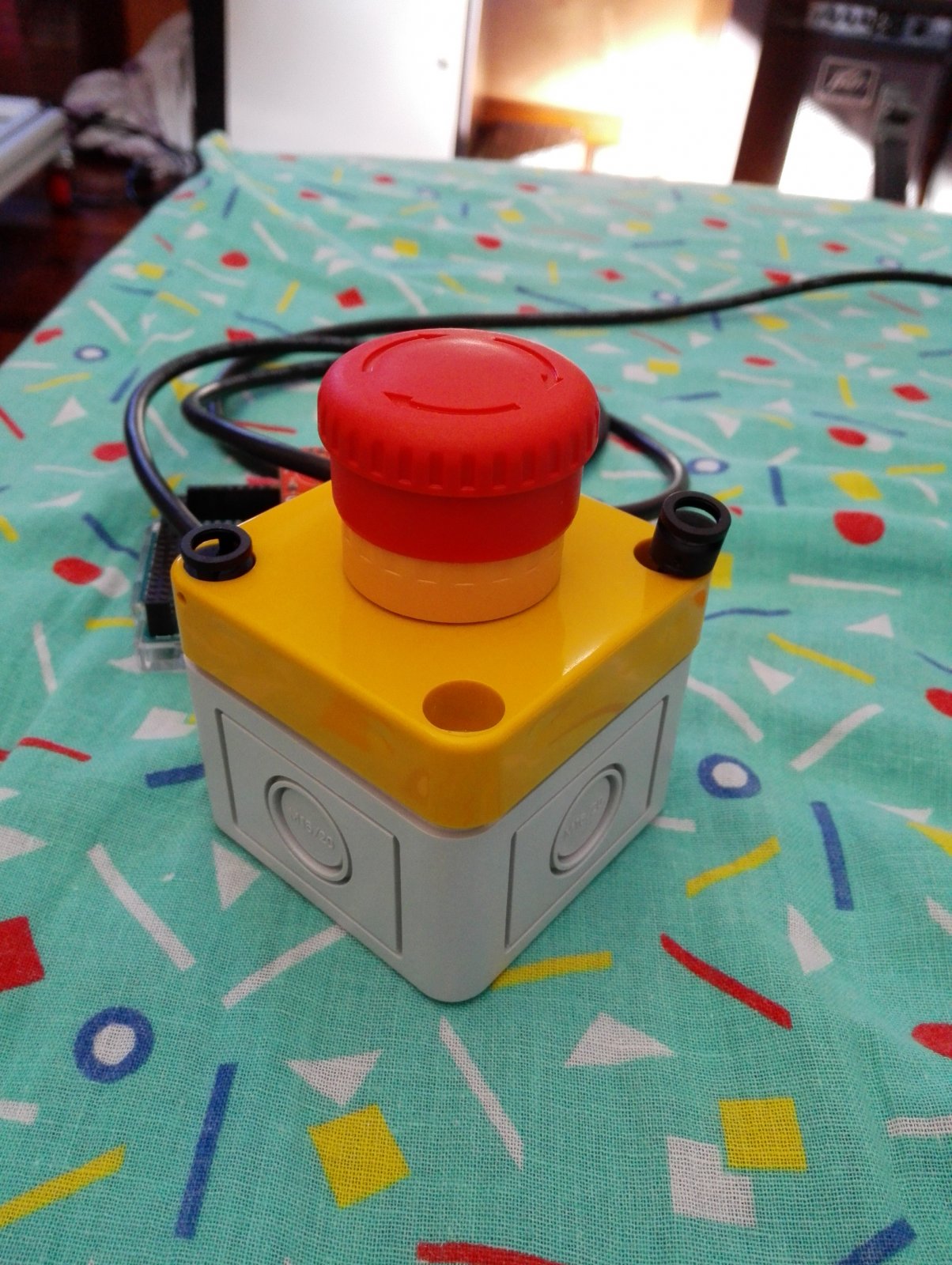

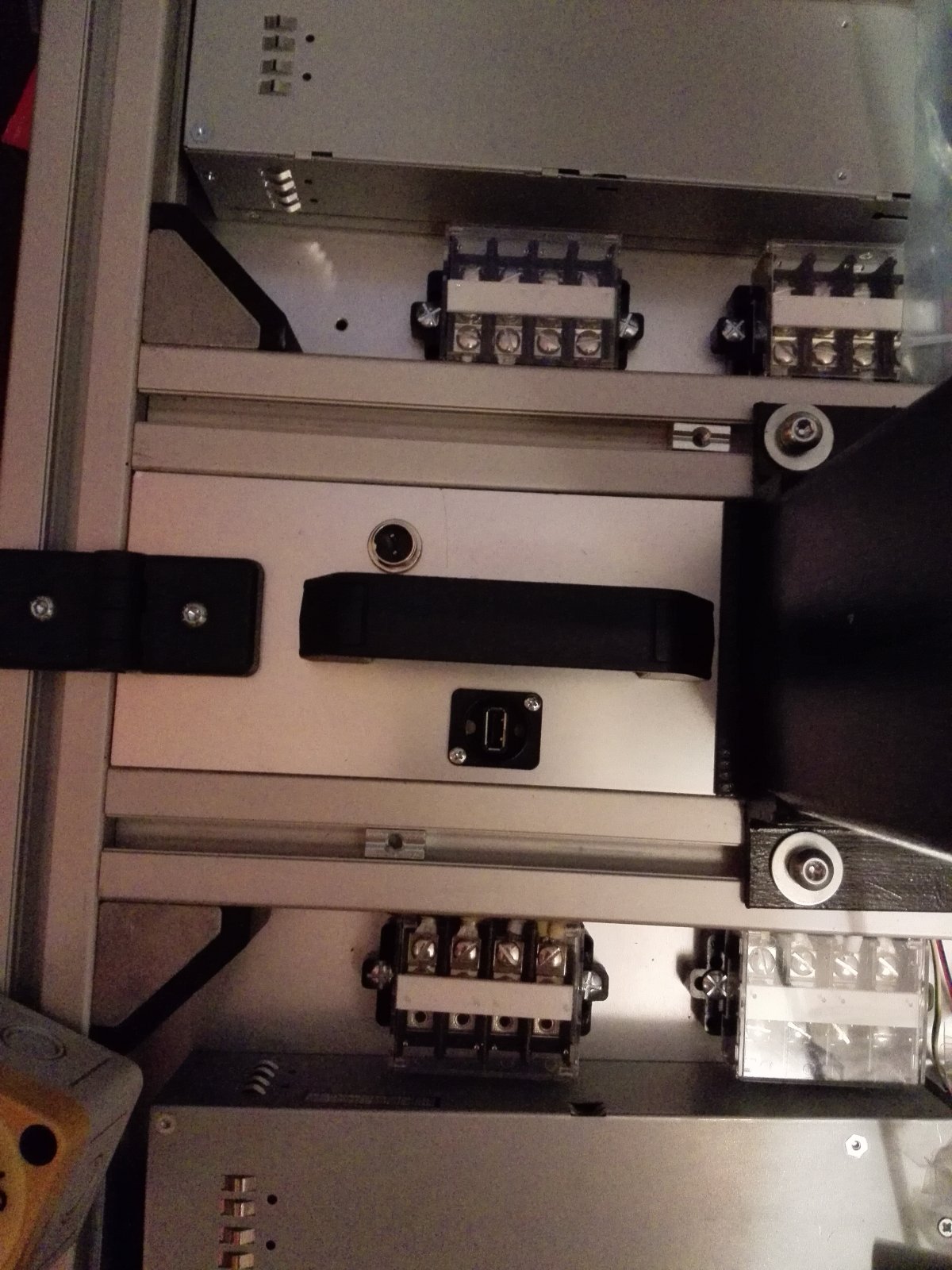

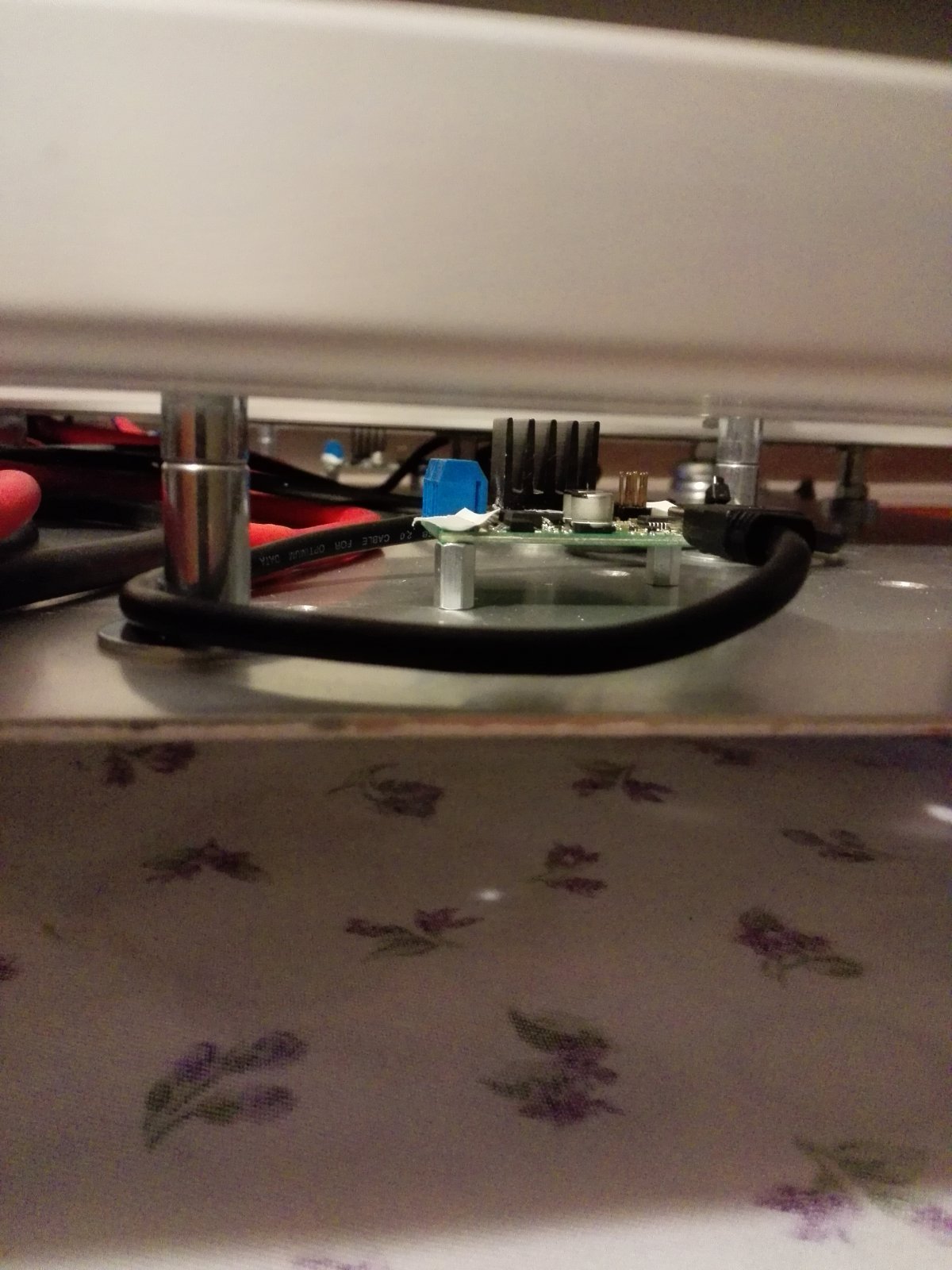

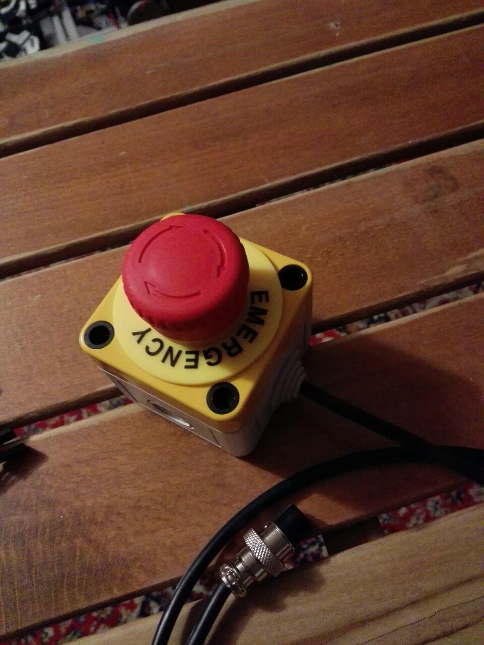

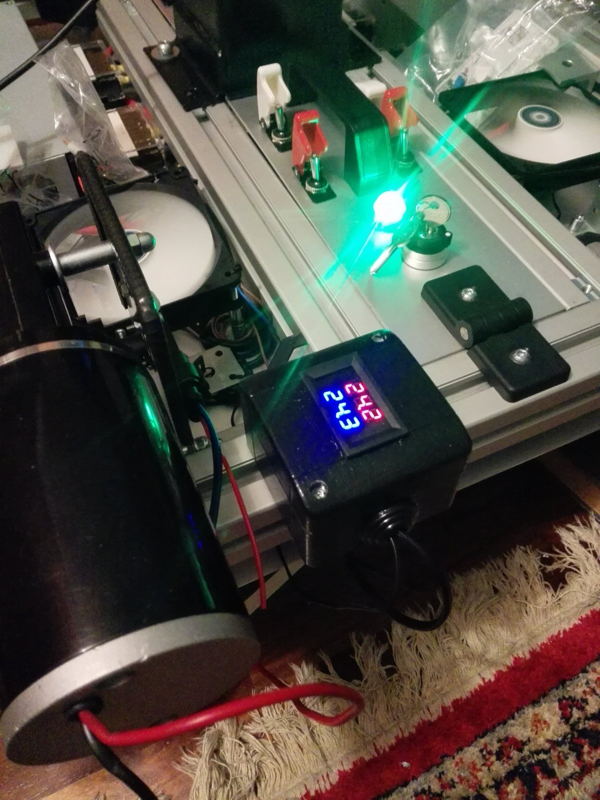

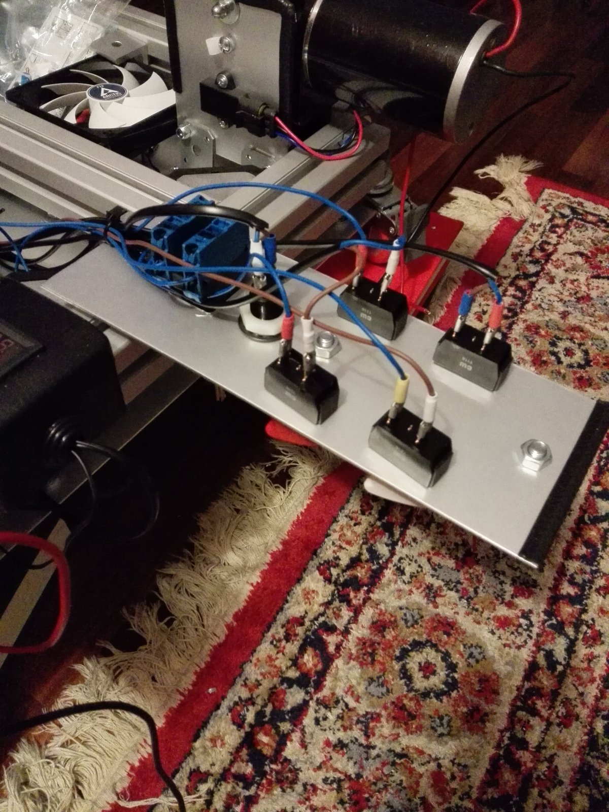

    A (very) big update:
    This is the overall situation of my sim:

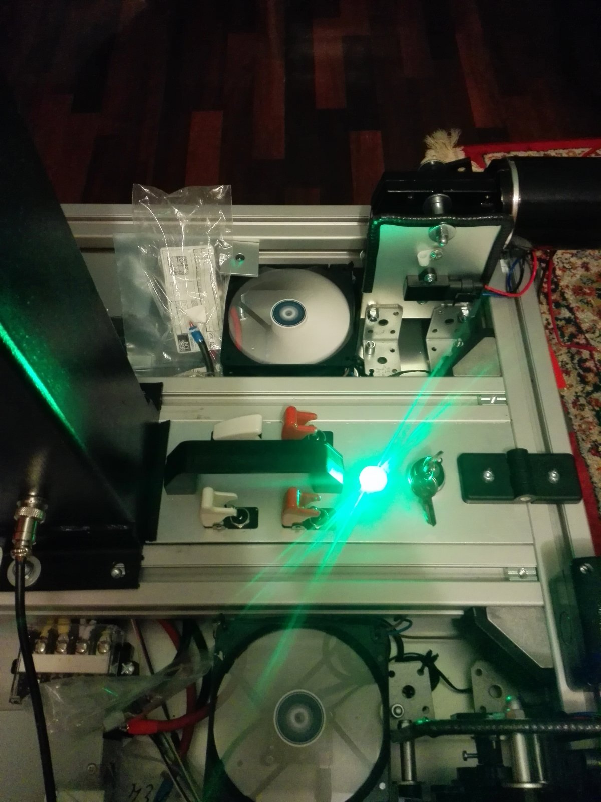

    In this central barrier i've maked connection to give the start to my 2 HP-DPS600. This connection goes to my emergency switch and after that to a key switch. As you can see from second photo, i've placed a connector into my U-joint base; this is the emergency switch connector, and the most important thing to notice is if you don't connect the E-switch the circuit is not close, so Power supply can't starts...this means if you want to use my sim, you must be safe :)
    IMG_20170918_203813.jpg IMG_20170923_090733.jpg IMG_20170915_201138.jpg IMG_20170923_170511.jpg

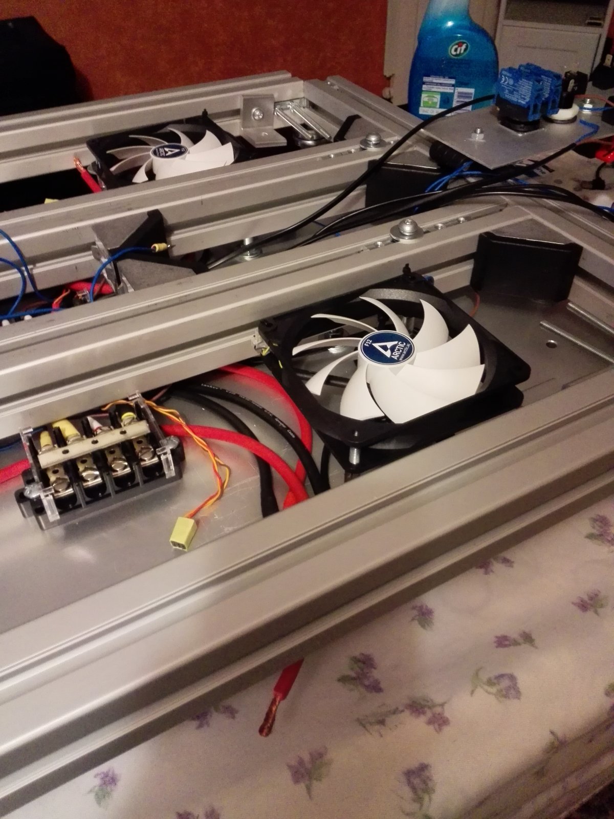

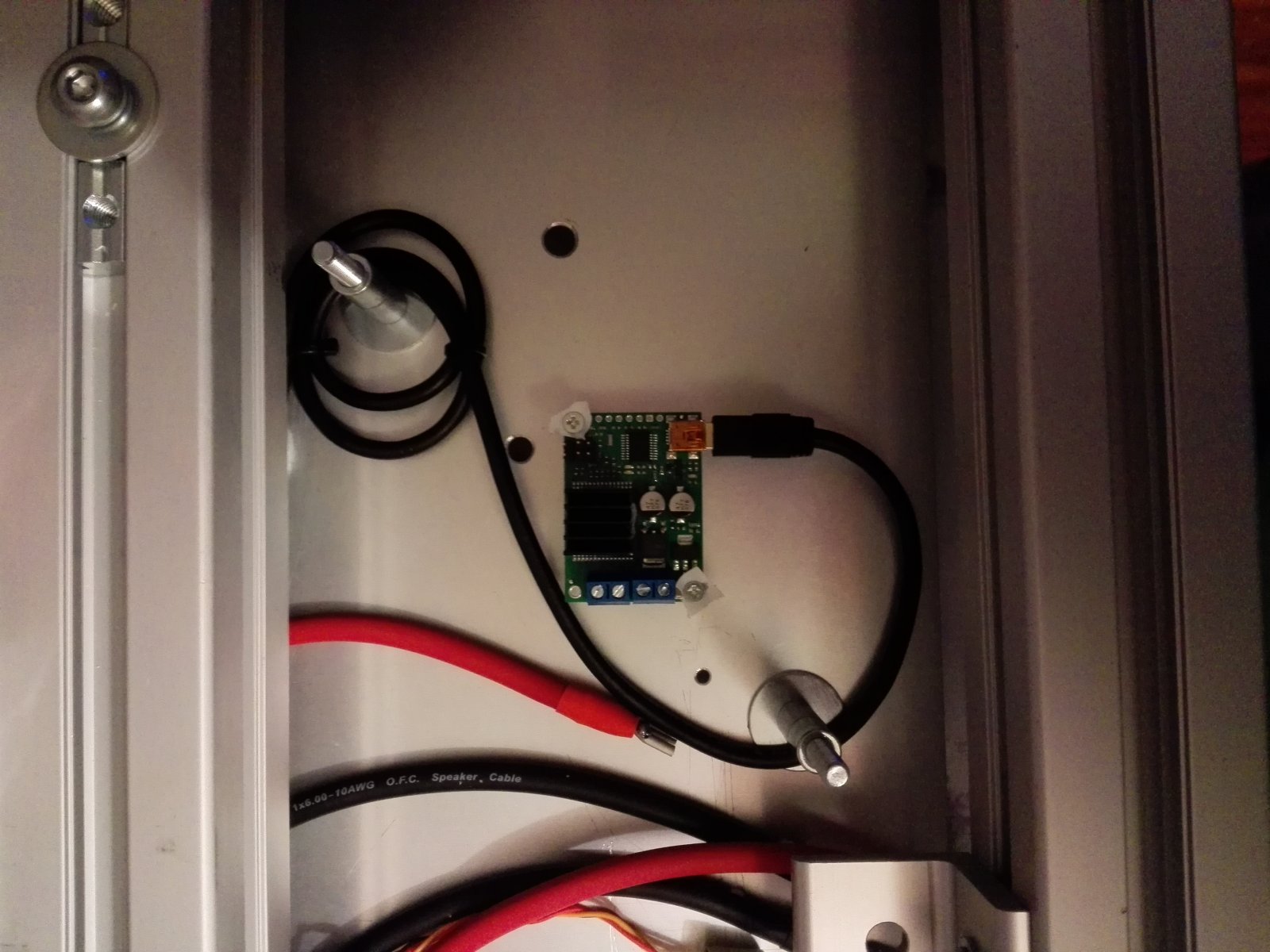

    These are the connection goes to fans, JRK and other thing like temperature sensor and wind simulator.
    Here you can see fuses box and usb hub.
    This is my JRK and fan:

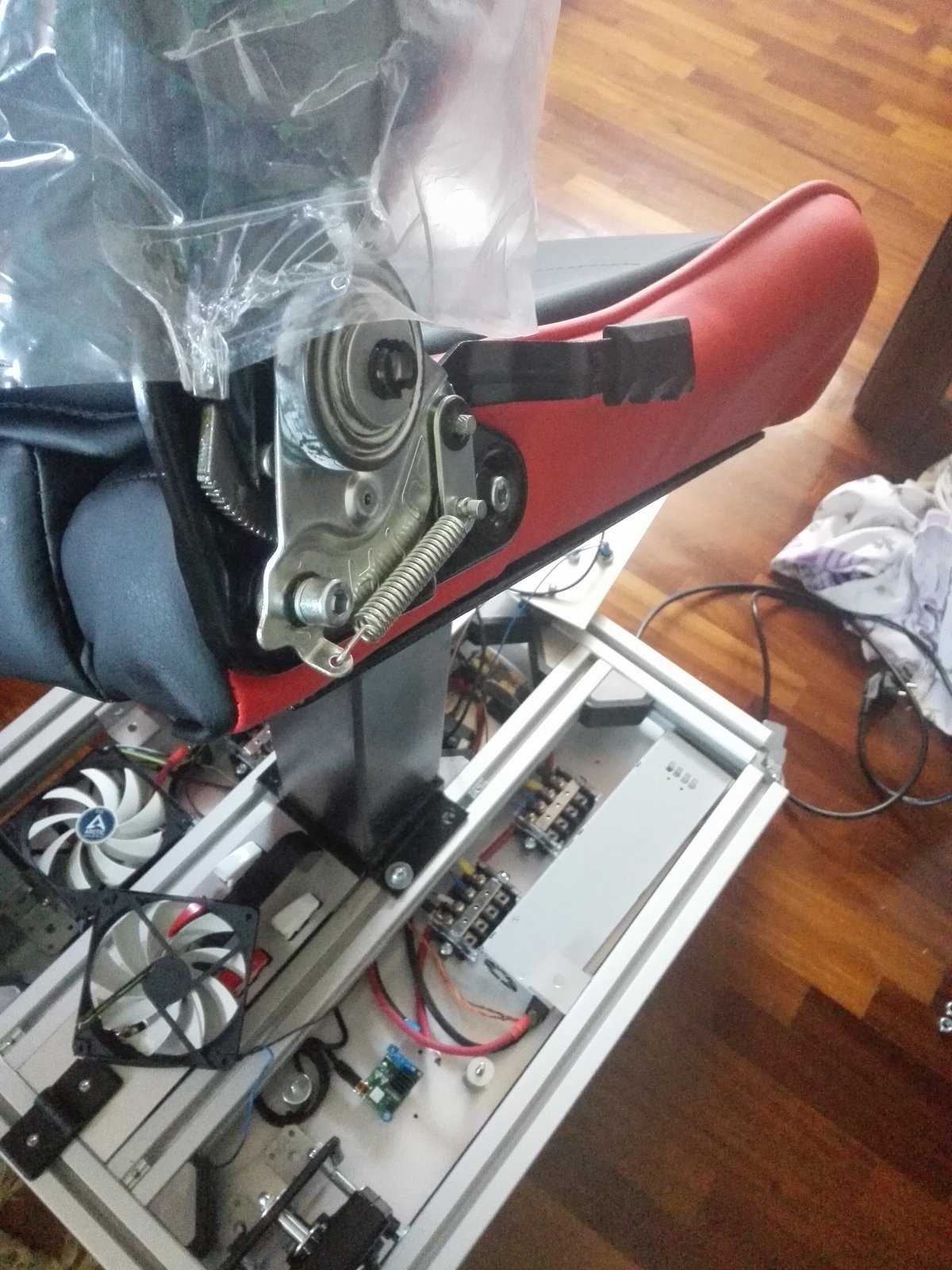

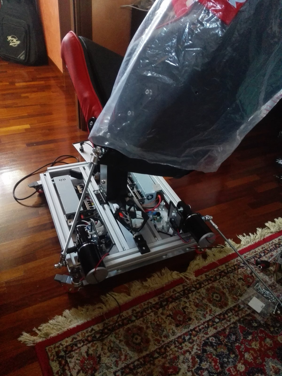

    This is the lever for motor:

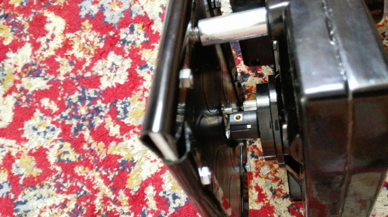

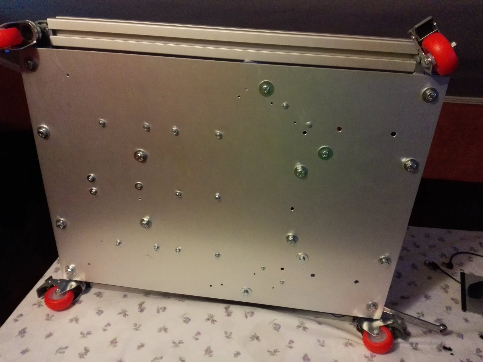

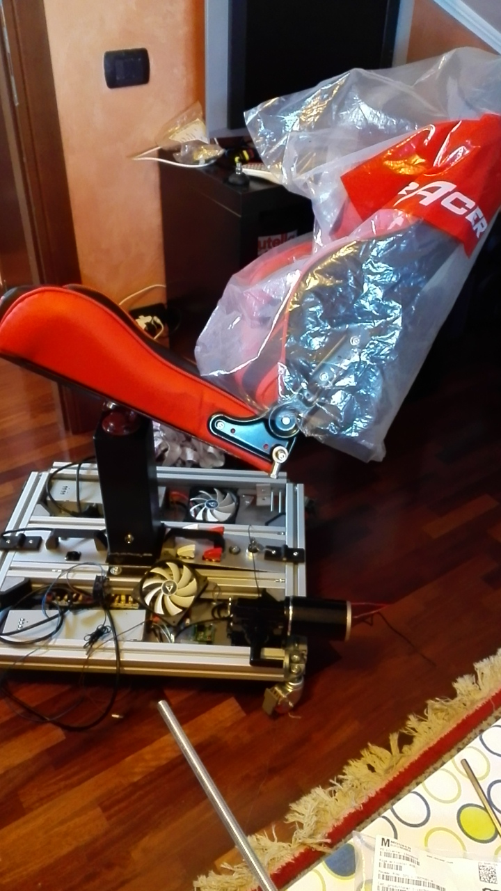

    Yesterday i've tried to mount my sim because it's time to make connection between motors and chair:
    Now I have a problem: this screw cannot be unmounted; so I need to find another way to connect all together.
    I'm hoping to start to have motion next week.

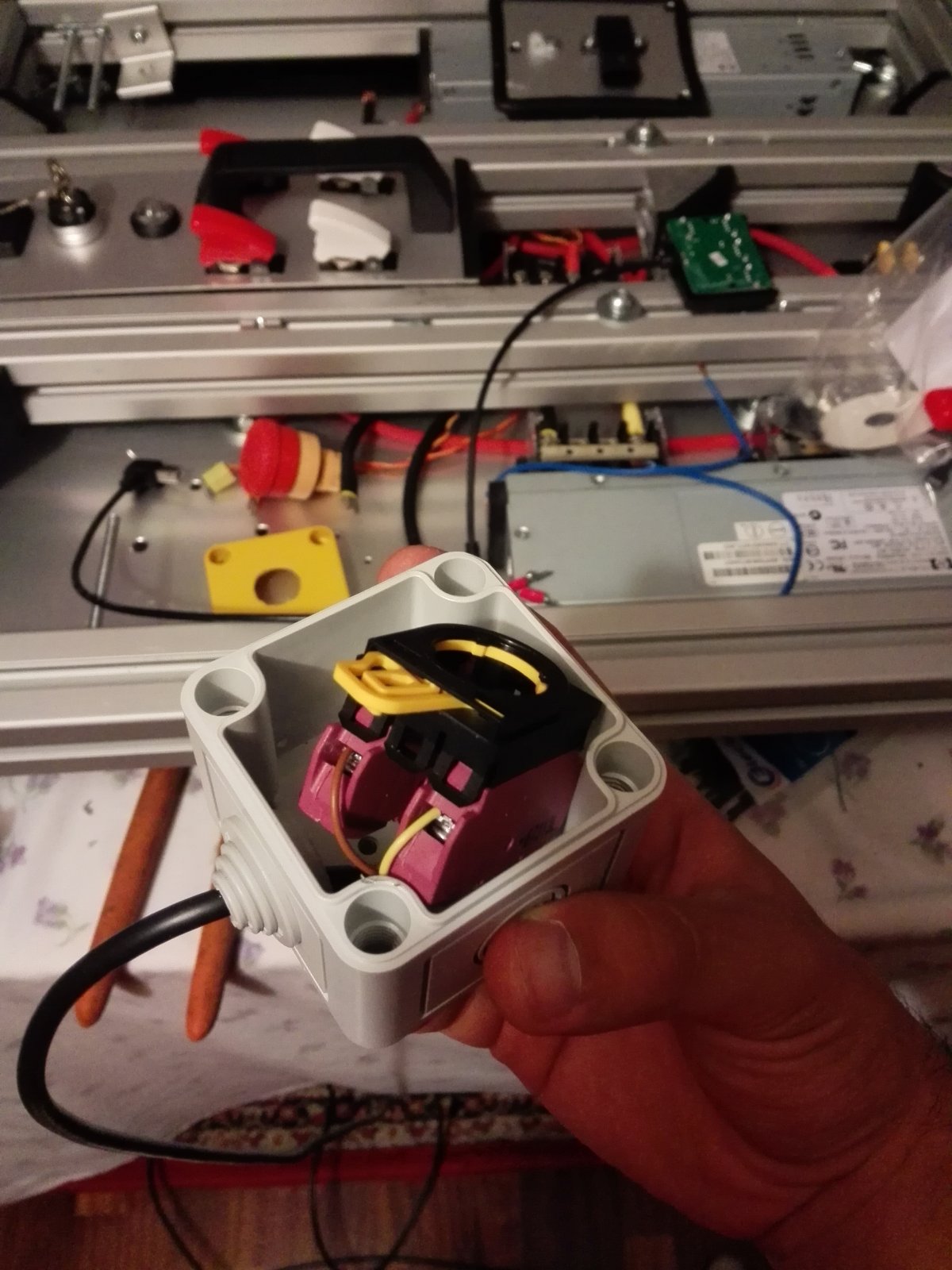

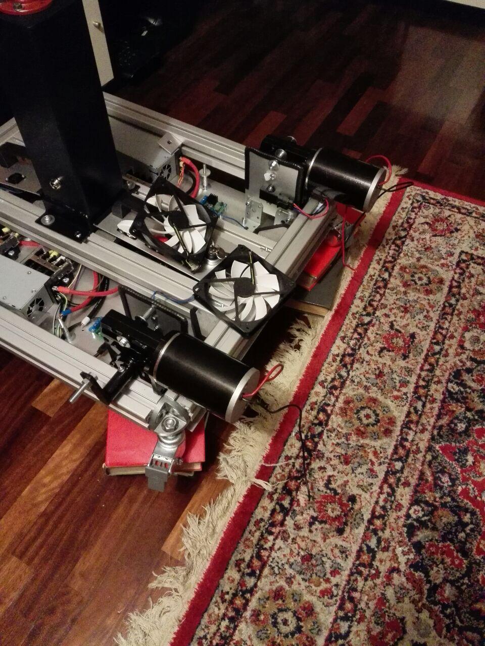

    Minor update:
    I've closed my E switch, and i've placed motors and hall sensor:
    photo_2017-09-25_21-32-54.jpg photo_2017-09-25_21-34-00.jpg photo_2017-09-25_21-34-00 (2).jpg photo_2017-09-25_21-33-59.jpg photo_2017-09-25_21-34-04.jpg photo_2017-09-25_21-34-02 (2).jpg

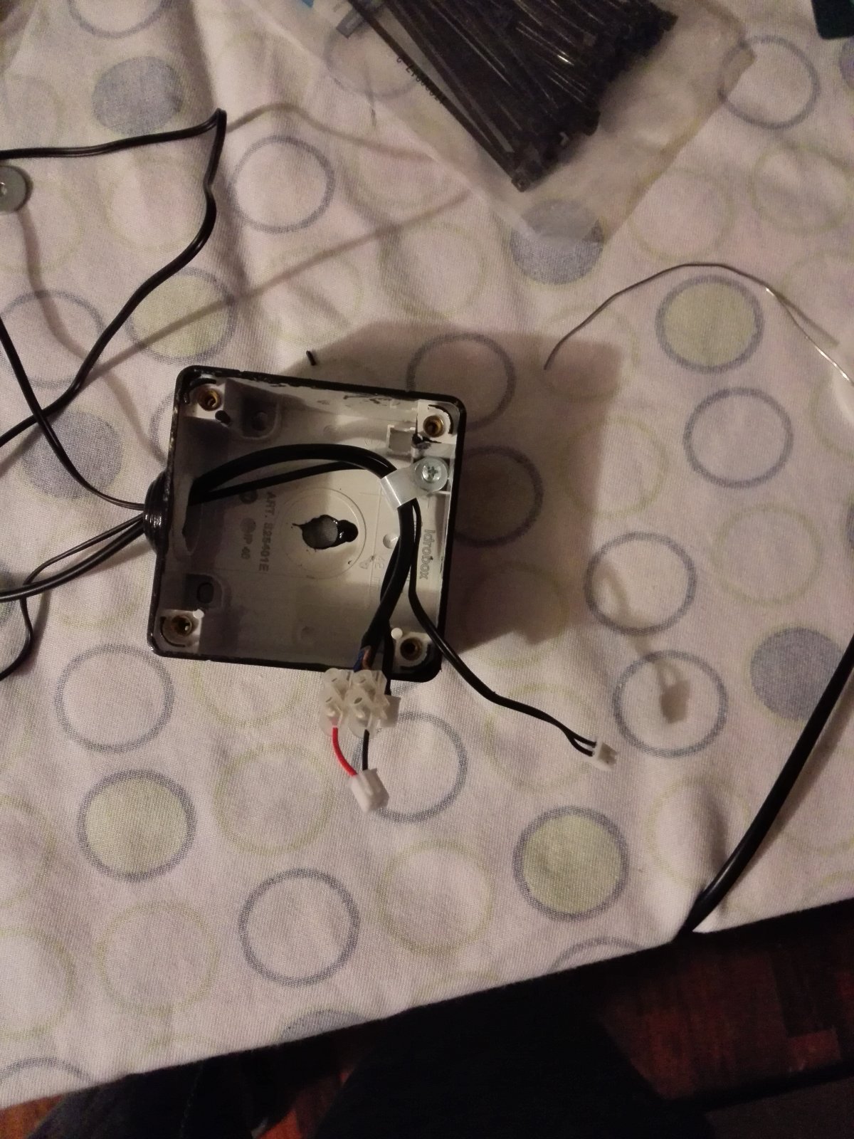

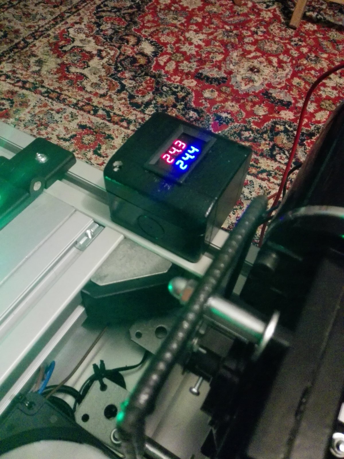

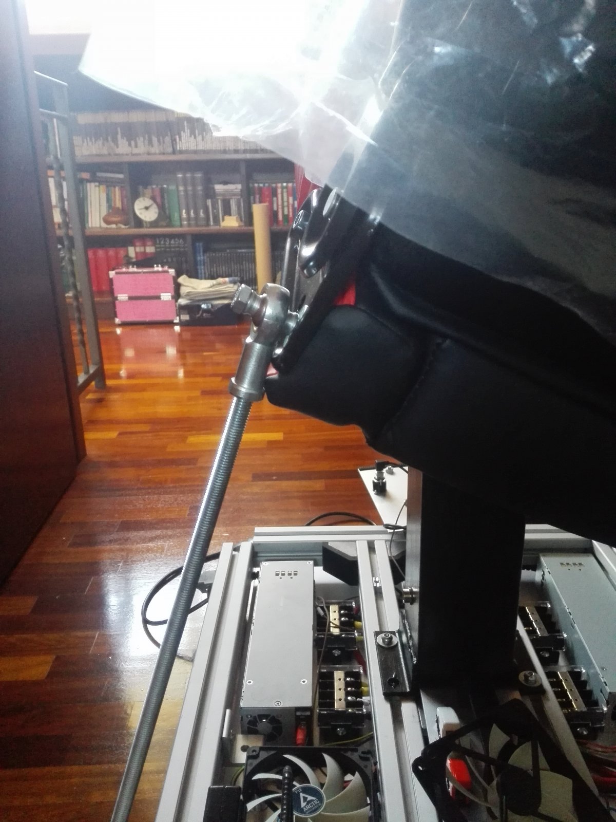

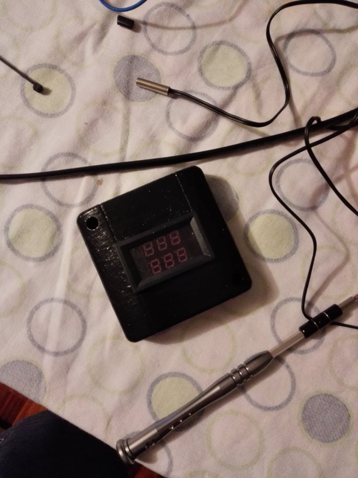

    I've prepared box for my dual-temperature sensor:
    And thread for my motors...it's M10 thread, 43cm long with a lot of nut to make it more resistant...what do you think about it? It's enough?
    I've fired up all yesterday, and all works fine.

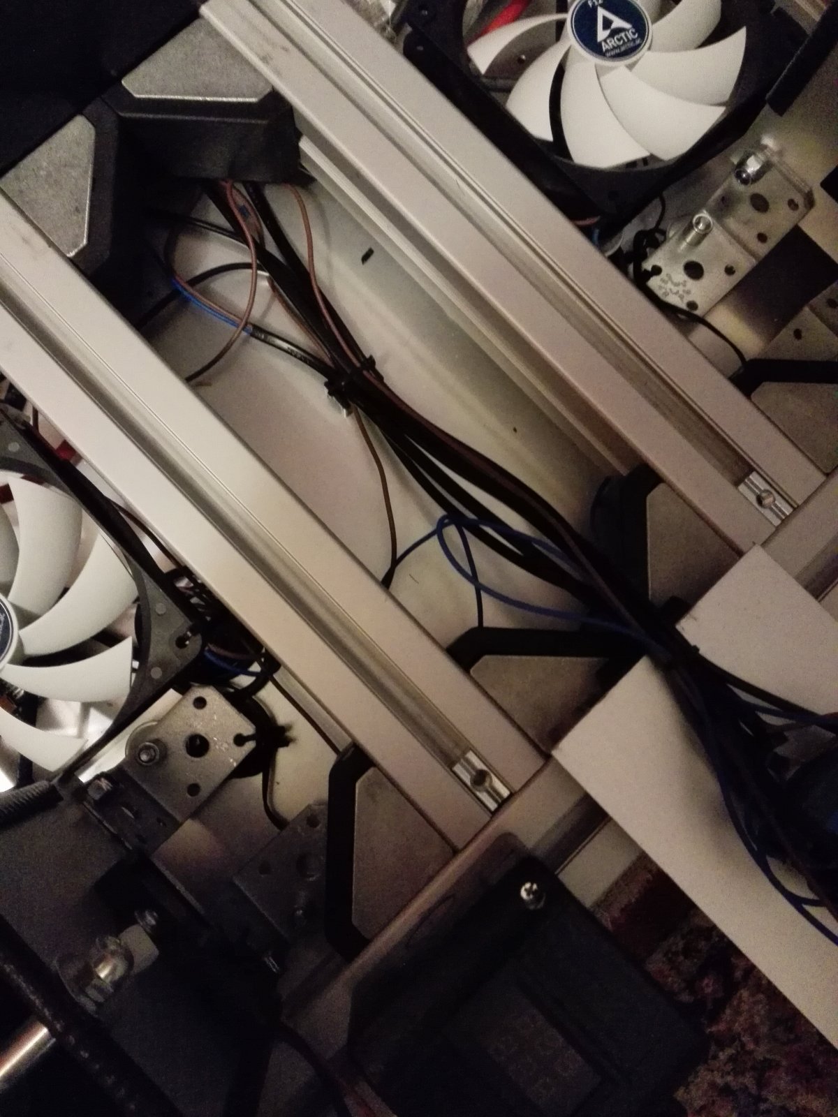

    Cable Management :) :

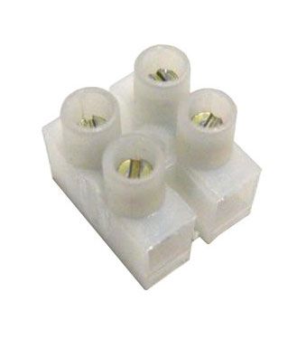

    What technique can I use to insert 10 AWG cables into JRK header? That connector are very very little...and my cable can't stay well inside it
  18. noorbeast
    21,644
    151,522Coins
    +11,041 / 56 / -2
    A 10 AWG will not fit well, in the short term you could add and connect slightly thinner wire or carefully trim the 10AWG. But ultimately the best option is to solder larger terminal blocks to the JRKs: https://www.xsimulator.net/communit...f-simulator-conversion.5580/page-5#post-92011

    If it's possible, I don't want to re-solder my JRK.
    It's a beautiful idea to add a connector just little before JRK connector (i'm so stupid, i' haven't thinked about this solution...)...but why you say "in the short term"? Can't be a good solution?
    My idea is to keep the 10 AWG cable and near JRK connector use this:
    and to insert thin cable that fit well to JRK headers...
    what do you think? Can be a good solution?
  20. noorbeast
    21,644
    151,522Coins
    +11,041 / 56 / -2
    Yes a connector will work allowing the use of thinner wire, but new connector blocks are the best way if you want to use the 10awg.
