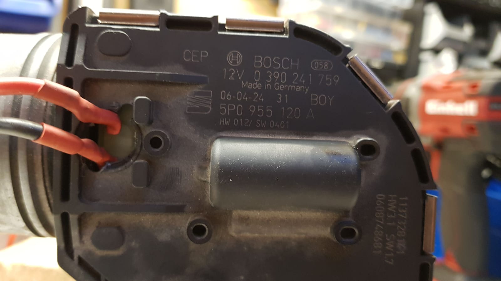

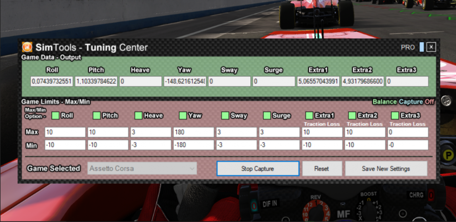

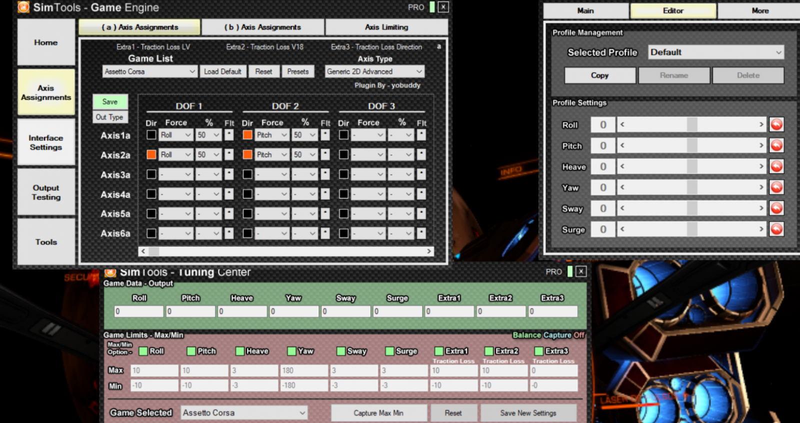

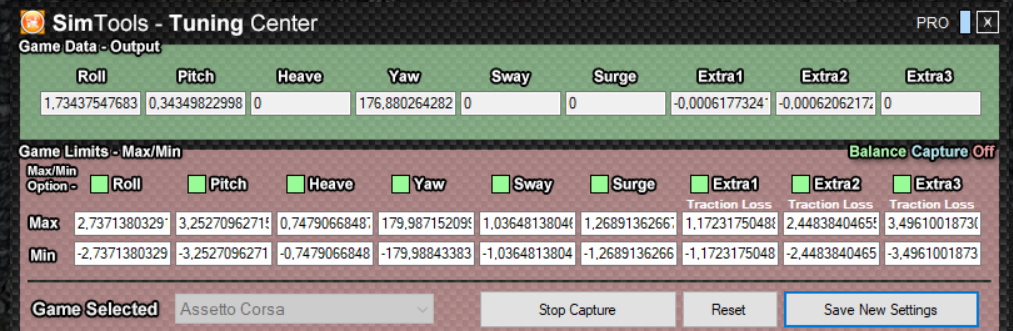

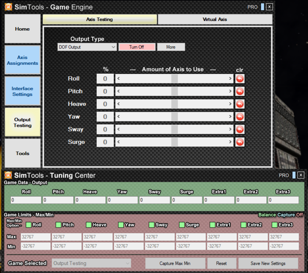

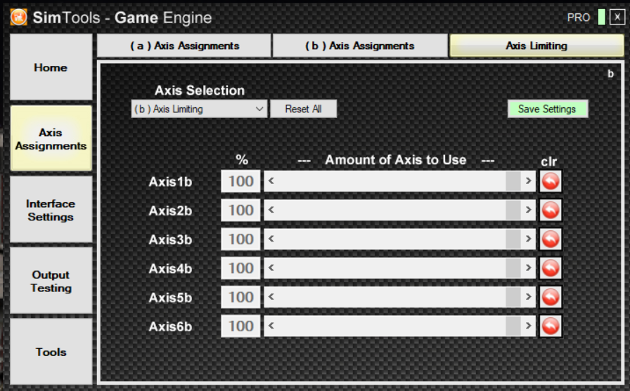

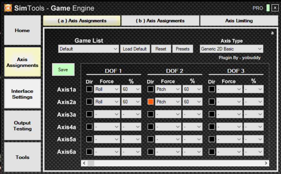

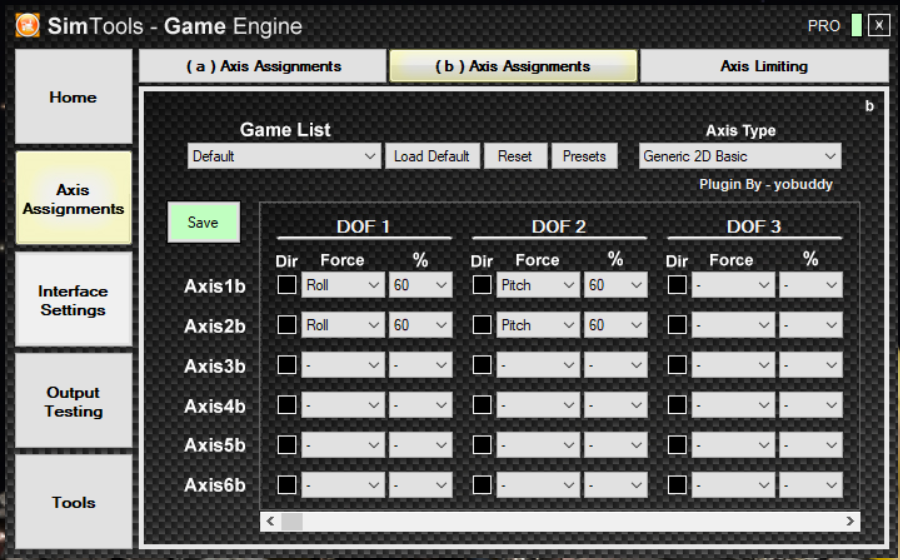

    Hello, I present my platform for movement, I have already purchased it but it is not a commercial version, I am having problems with the configuration, it moves but when I try the test the roll moves up and down, the pitch moves left and right, I have Tested dirt rally and obviously it's not going well.
    Take Arduino One, bridge ibt-2, wiper motors of seat León Mk2
    How can I make it move correctly?
    Thanks in advance
    The code is this:
    Hola, os presento mi plataforma de movimiento, la he comprado ya montada pero no es una versión comercial, estoy teniendo problemas con la configuración, se mueve pero cuando pruebo el test el roll mueve arriba y abajo, el pitch mueve izquierda y derecha, he probado dirt rally y evidentemente no va bien.
    Lleva arduino One, puente ibt-2, las pruebas en vacio parece que van bien, a pesar de estar las funciones invertidas pero cuando me subo es como si no pudiese conmigo, ( se ve lo que hace en el segundo video ), se que será problema de configuración pero no doy con la solución, a ver si me pueden echar una mano.
    Gracias de antemano

    Can you please post pictures of all of your Axis Assignments.
  6. polybasss
    polybasss Member Gold Contributor
    Sep 26, 2018
    100
    Burgos Spain
    165Coins
    +16 / 0 / -0
    21,580
    151,094Coins
    +11,028 / 56 / -2
    If the issue is pitch and roll axis being wrong, then as I previously advised the solution is the Dir settings:
    You actually supplied pictures of two different Axis Assignments, but I am going to presume this is the one that creates the roll and pitch issue:
    Your settings should be set to produce the movement SimTools expects: https://www.xsimulator.net/community/faq/which-way-to-set-simtool-axis-movements.230/
    So try unchecking the DIR on pitch and check one DIR orange on roll. Test in Output Testing. If either roll or pitch is reversed then check the opposite DIR for that axis.
    21,580
    151,094Coins
    +11,028 / 56 / -2
  15. polybasss
    Sep 26, 2018
    100
    Burgos Spain
    165Coins
    +16 / 0 / -0
    these are the values doing a round with a medium car on a medium track, I have only captured the min-max and saved, now the movement is very unreal and I am very lost, I do not know what to touch, any suggestions? @noorbeast
  16. noorbeast
    21,580
    151,094Coins
    +11,028 / 56 / -2
    Do one force at a time, start with surge and then sway. I am guessing a bit, but you will likely want to raise the Tuning Center values for sway a bit and possibly reduce the surge values a little, a smaller max than min value for surge helps simulate that gearshift kick.
