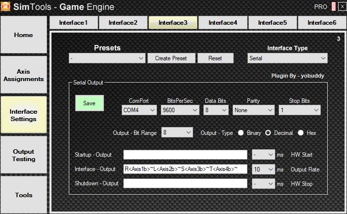

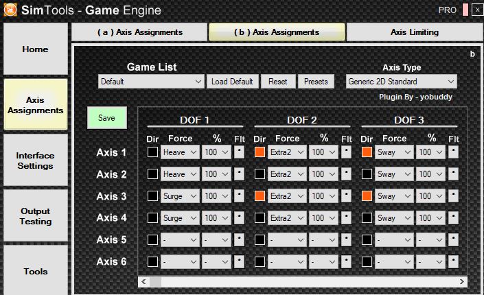

    For those using my arduino script, here's the SimTools axis setting using Axis Assignments(b) as (a) is used for my 3DOF
    Axis 1 & 2 are for the Heave flaps and 3 & 4 for the Surge. I'm also mapping roll/sec to these flaps and experimenting with sway too. I can't vouch for the tuning !
    And here's how SimTools talks to my Arduino script. Intreface1/2 are used for my 3DOF, so I'm using #3.
    Note that Axis1b, Axis2b etc might be Axis1a,Axis2a if you used Axis Assignments(a) above. The R,L,S,T are how Arduino knows which servo we're talking to.

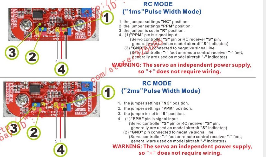

    Check the tiny pots on the servo board. Rotate them all to the right to get largest rotation for the input data.

    Yes its an Arduino thing. Once you do SimTools tuning which determines your realistic max/min thresholds for the telemetry data received from the game, SimTools outputs 0 to 255 for values -ve max and +ve max. My Arduino code excludes 0-127 as we can't do -ve (ish) and then maps 128-255 to values which on my seat corresponded to level-to-max lift, and you will need to work those out for your servo placement.
    See the extract below from the code I provided. For right heave 134 is neutral (actually a bit up from flat), 90 is max lift.
    const int kActuatorScale[kActuatorCount][4] = { { 134, 90 }, // Right Heave Actuator scaling NB: 6 up from neutral
    { 82, 126 }, // Left Heave Actuator scaling NB: ditto
    { 115, 70 }, // Right Surge scaling NB: Starting point is 30 forward of flat
    { 65, 110 } // Left Surge scaling NB: Ditto
    So forget Simtools for a while and work out what Servo value= neutral (or 20% up) and what = max and then adjust the values above using that testing script I provided. Note that these Wingxine servos are a bit odd in terms of how they respond to values. They say its 0-360 they accept as input, but I found they clipped, i.e. 340 may be the same position as 360, so experiment first and see the range it really responds to. Also there are two jumper switch modes which affect the way they respond to input range. I think I changed the jumpers to the non default ones - I forget which it is now. The schematic shows this:

    Does the smoothing do anything for you. Washout works, but I can feel no difference with smoothing off or 100%. The servos seem to jump from one point to the next, not a fluid movement, especially small movements. Are you seeing this too?

    Work on your tuning - manually widen the range between max & min via the Tuning Centre, watch the numbers as you fly (non VR needed) and you can see what is happening to the numbers which should correlate to what you experience.

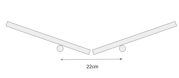

    I have finally finished my new rig (or let‘s say its first fully functional version) and did some first tests. The result is positive: I like the forces applied by the heave flaps. The distance of the hinges is about 22 cm, and for me the effect is convincing.

    Can I double check that hinge placement for heave flaps? Is it like below? On my heave flaps the hinges are on the inside edges but are only 5cm apart so it is much more of a lift effect than a squeeze effect.
