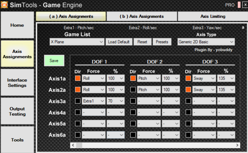

    Am I using the wrong settings? These seem to work for the FSX plugin but not on X plane, I tried replacing Pitch with Exta 1 and Roll with Extra 2 but still no response. The simulator is working fine when output testing. All the settings are set in X plane 11, as when I enabled them my simulator moved into the correct position. Any help would be appreciated :)
    21,915
    153,101Coins
    +11,117 / 56 / -2
    Have you activated the correct in-game settings: https://www.xsimulator.net/community/faq/x-plane-11-setup.288/

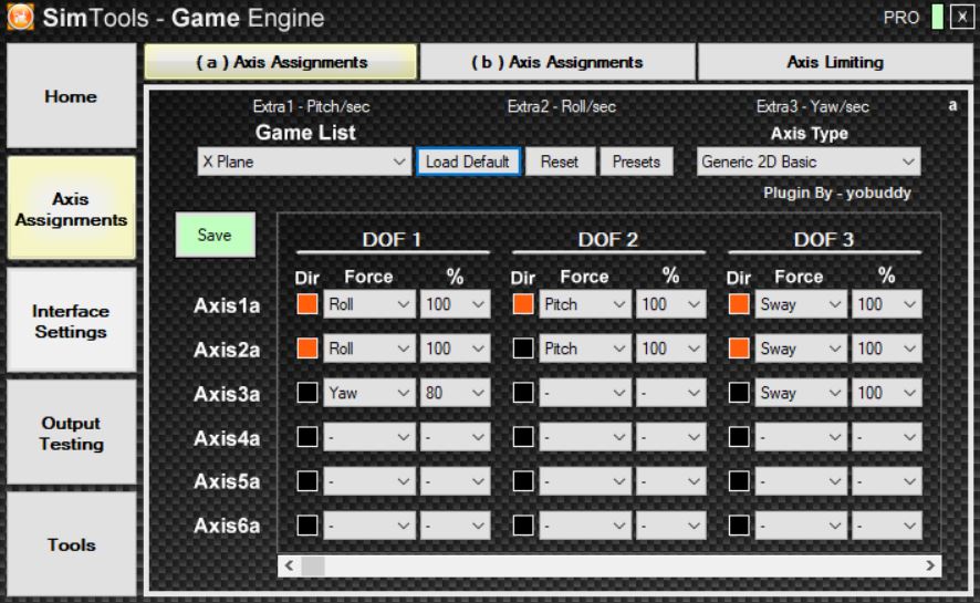

    21,915
    153,101Coins
    +11,117 / 56 / -2
    What rig do you have and is SimTools acting as expected in Output Testing: https://www.xsimulator.net/community/faq/which-way-to-set-simtool-axis-movements.230/
    I ask because normally sway would be set the opposite to roll, but that is not what you have in your settings.

    I think X Plane is now talking to Sim Tools as when I change the settings in X plane, the simulator does move when I save the settings. However now whenever I try to make a flight the game just crashes :/

    X Plane is not that easy to configure for me also, I also have a DOF Reality (P3) and for me the Pitch and Roll are reacting well, but weakly, I do have to put more than 120 to feel something that is half of what I feel in a real aircraft.
    Also the yaw is not working correctly, if I yaw with my rudder, sometimes nothing happens and sometimes I'm in straigh and level flight and my rig is yawing full left or right without any reason

    I managed to finally get it all working! I have the same issue as you though, response seems very week even when putting a high %. The motion works but it just doesn't seem to have the same power I get when using the rig with FSX. Hopefully there's a way to improve this, if anyone has any ideas let us know!

    It takes practice to create and refine motion profiles: https://www.xsimulator.net/community/faq/steps-to-create-a-motion-profile.228/
    And flight profiles are a little different than race profiles. For a start Filters are often used, in particular Smoothing and Washout - Gain and Return. It is also not unusual to have higher % Axis Allocations for pitch and roll, plus higher totals.

    To give you an idea, here is what I have
  20. noorbeast
    21,915
    153,101Coins
    +11,117 / 56 / -2
    I would suggest a total Axis Allocation of 475% is way too high.
    You also need to change the Axis Type to Generic 2D Standard, which will then make the Filter options available.
