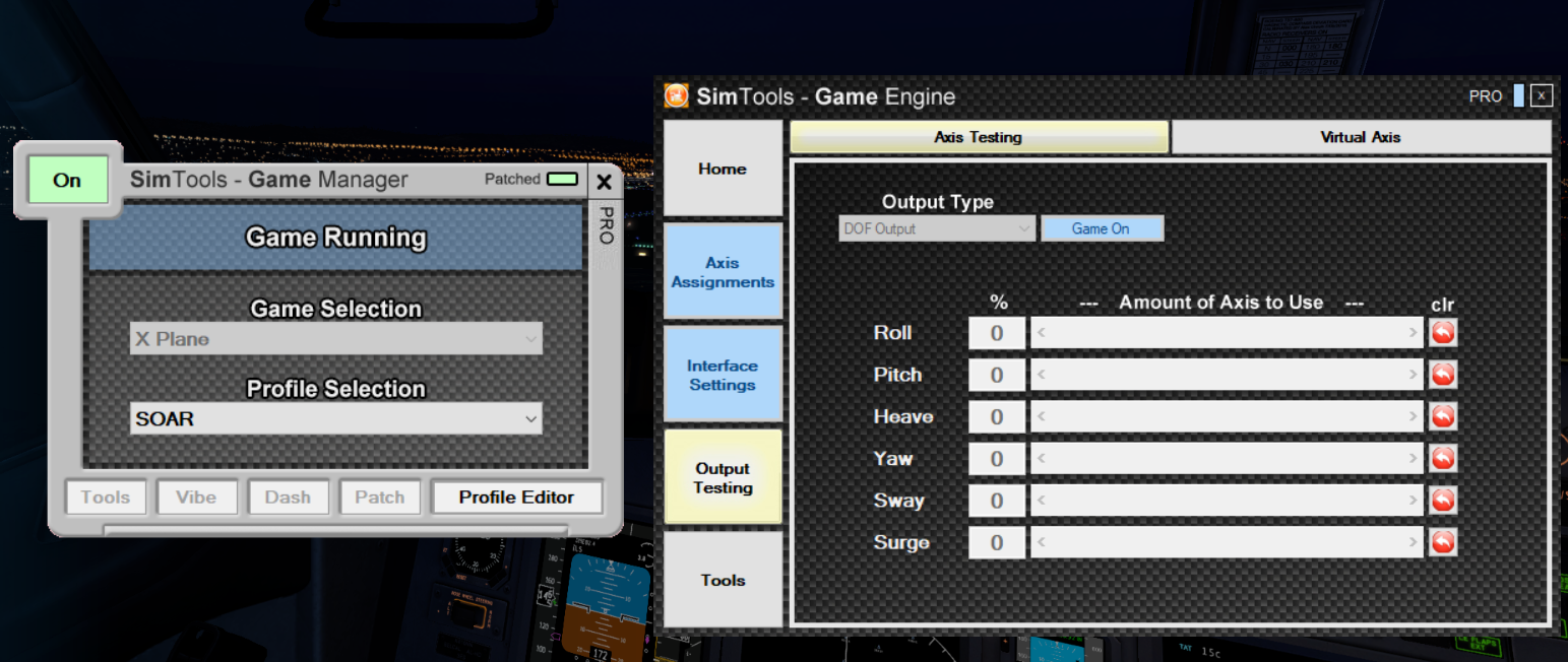

    Hello!
    I have successfully connected Simtools with my SMC3-SPS setup and have good motor response from both Simtools and the SMC3 software.
    I have also followed the X-Plane settings listed in the X-Plane 11 update.
    The boxes are checked correctly, IP address 127.0.0.1, port 4123, UDP packet rate all the way up.
    However, I am getting no motion from X-Plane. Does this mean I need to setup a UDP network using a 2nd computer? If so, how would I do that?
    Thanks for any input.

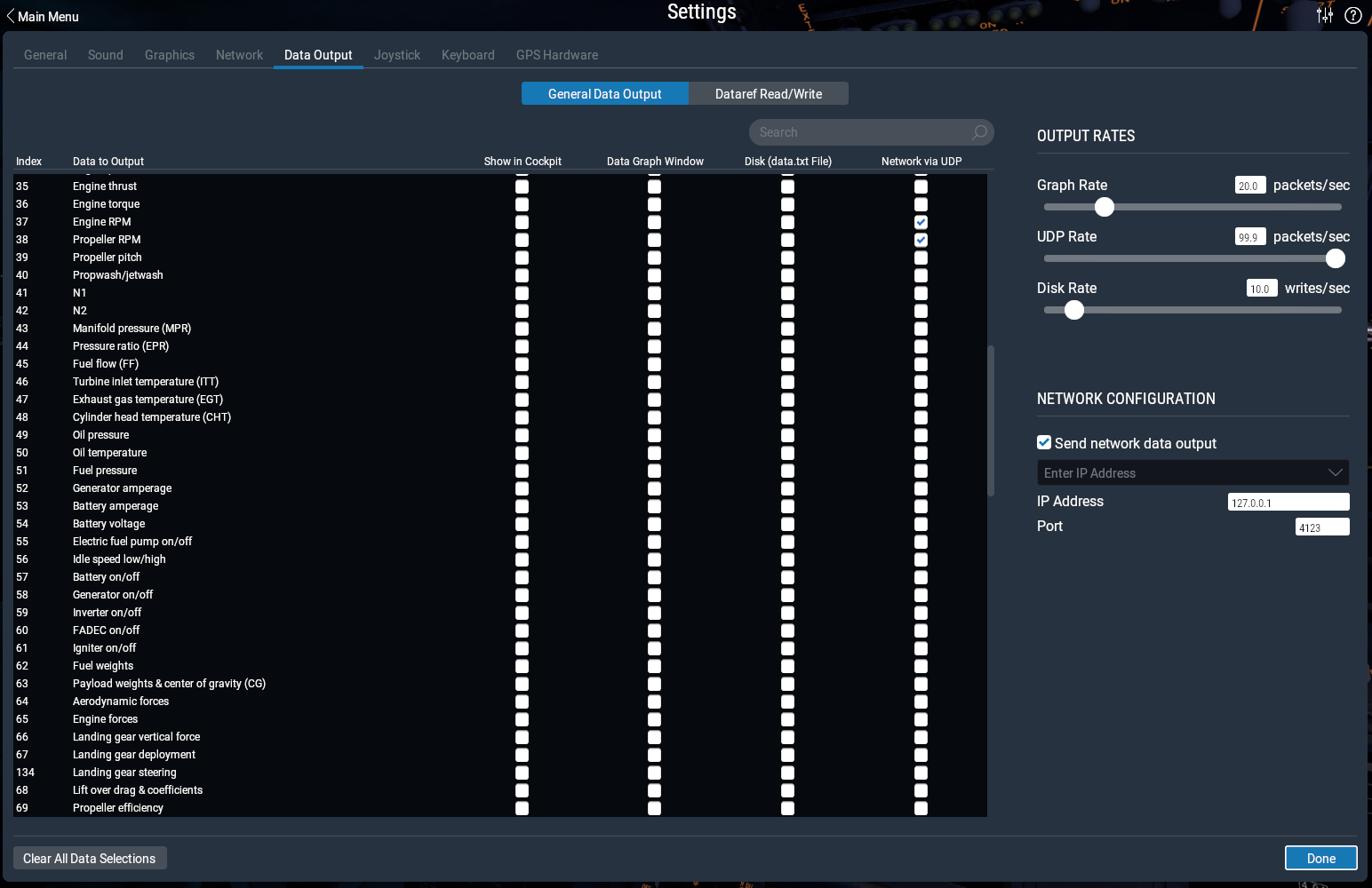

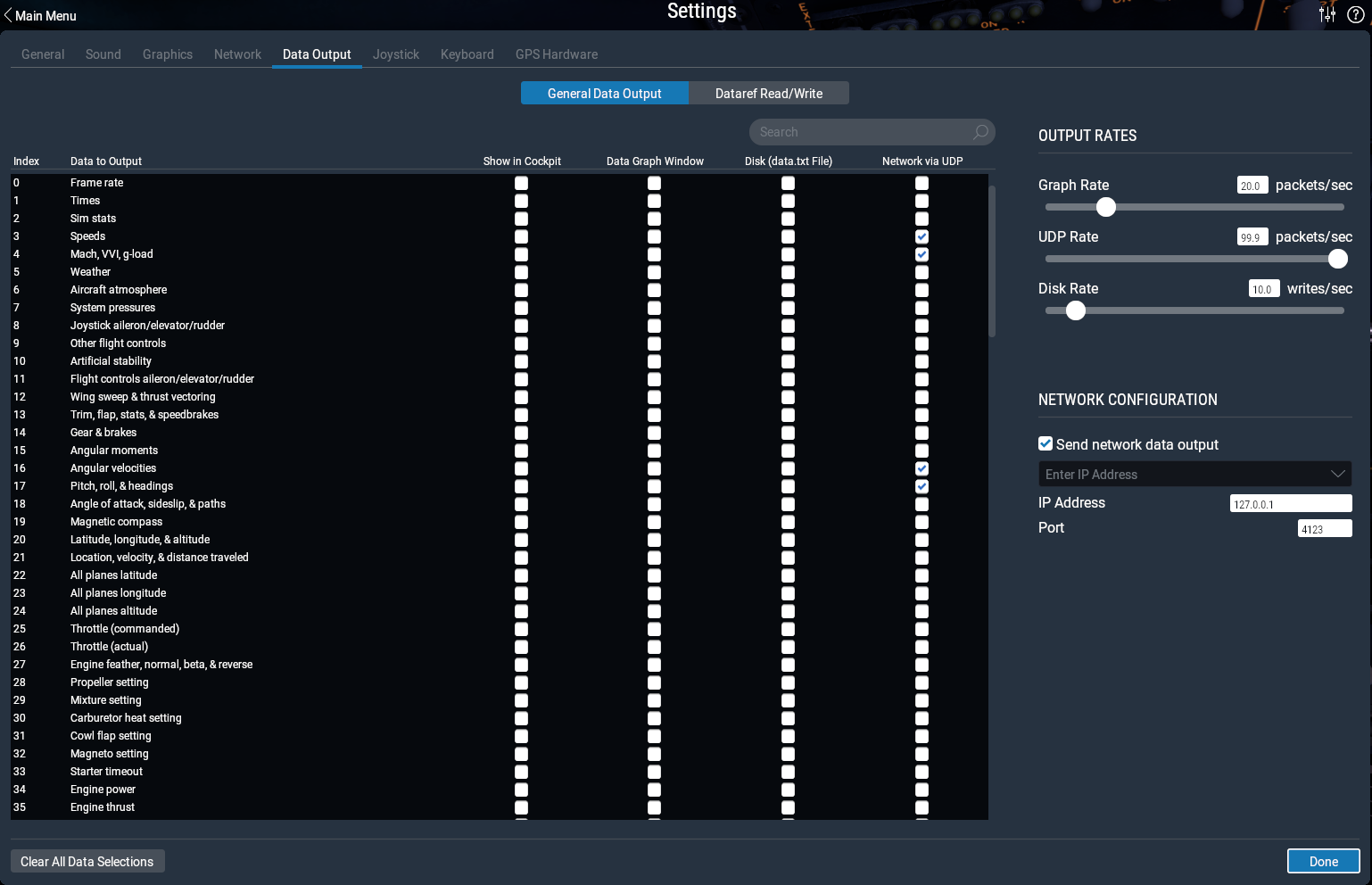

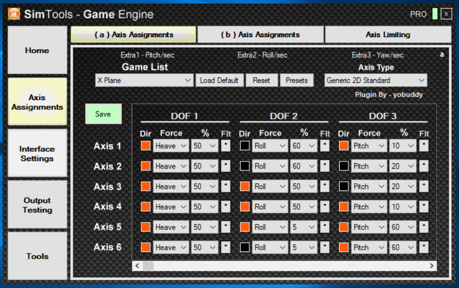

    @noorbeast, thanks for the response.
    I did follow the setup guide on that page.
    Here's pics of my settings and Simtools running. The only boxes checked are 3, 4, 16, 17, 37, 38.
    I'm also running it through Steam, wasn't sure if that changed anything.

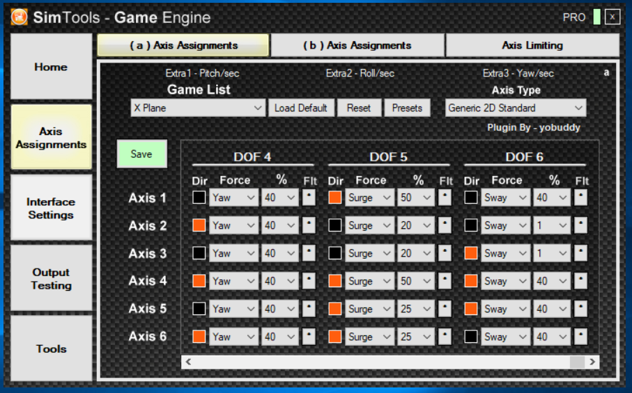

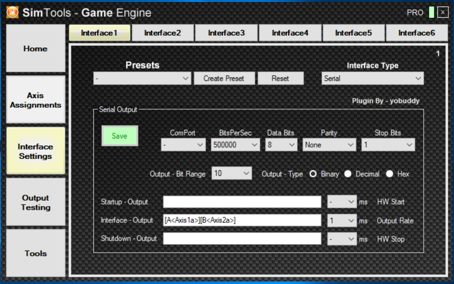

    Please post pictures of you Interface Settings and Axis Assignments.

    Is it because I've used over 100% for each DOF?
    Also, I've been using an Arduino Mega for testing, which is why the output rate is 1 ms. And, the COM port is usually 5, but I don't have anything plugged in right now.
