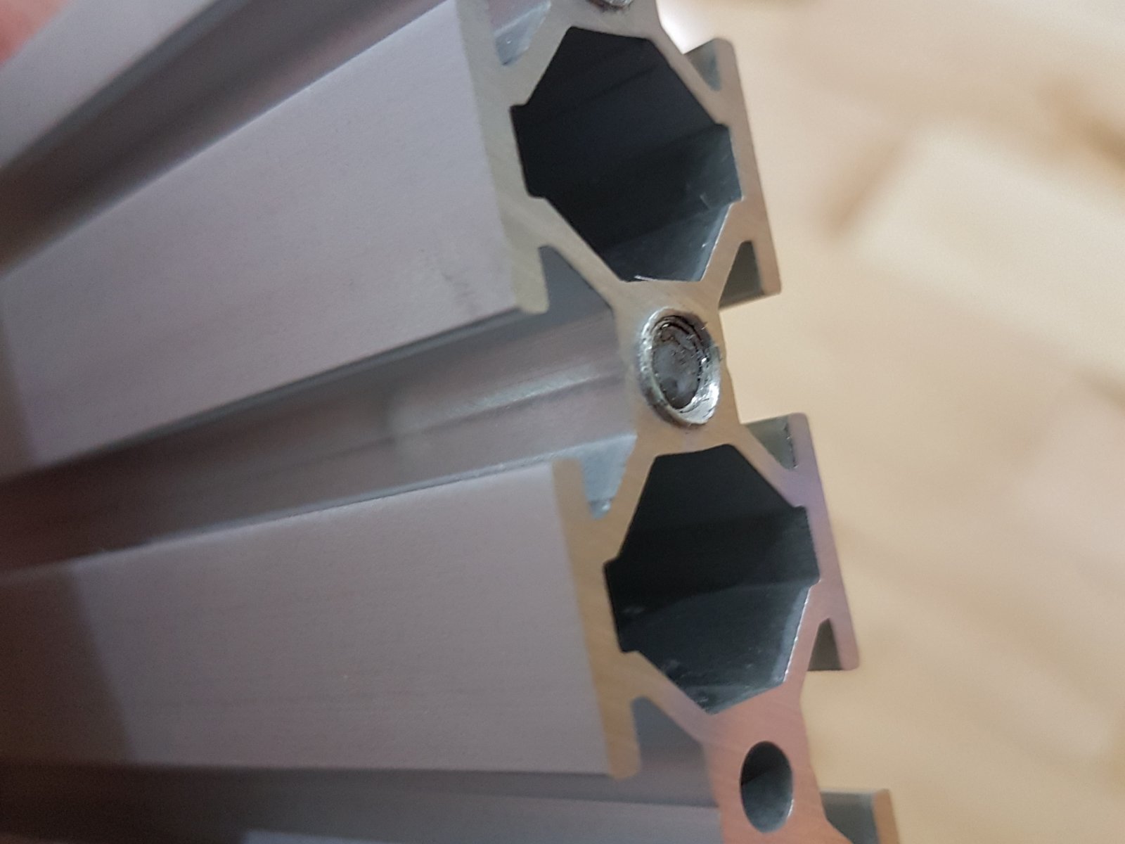

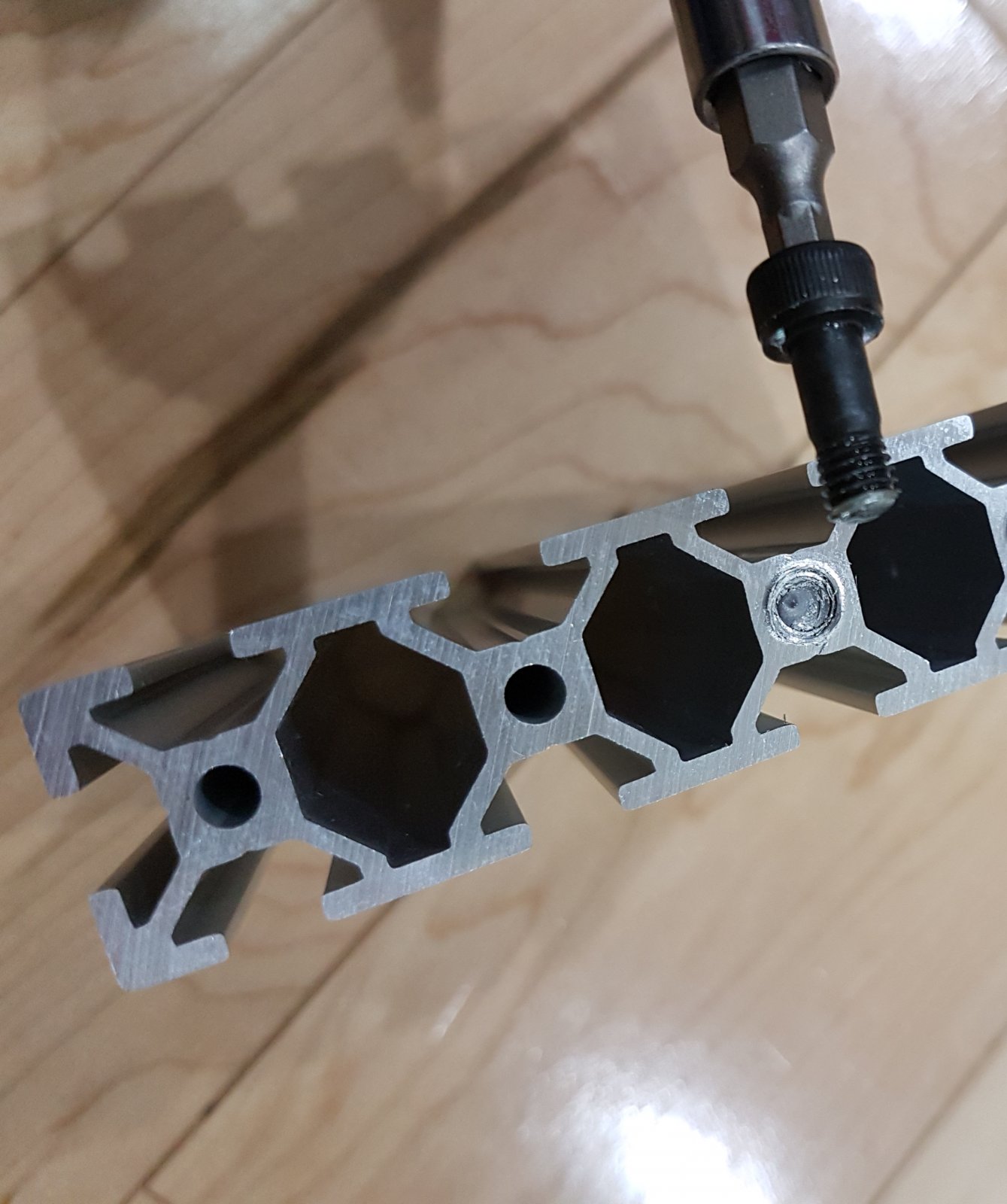

    Hi ,
    Is it very important to have the 75 mm plate to prevent the twist?
    thanks a lot for your idea and works !:)
