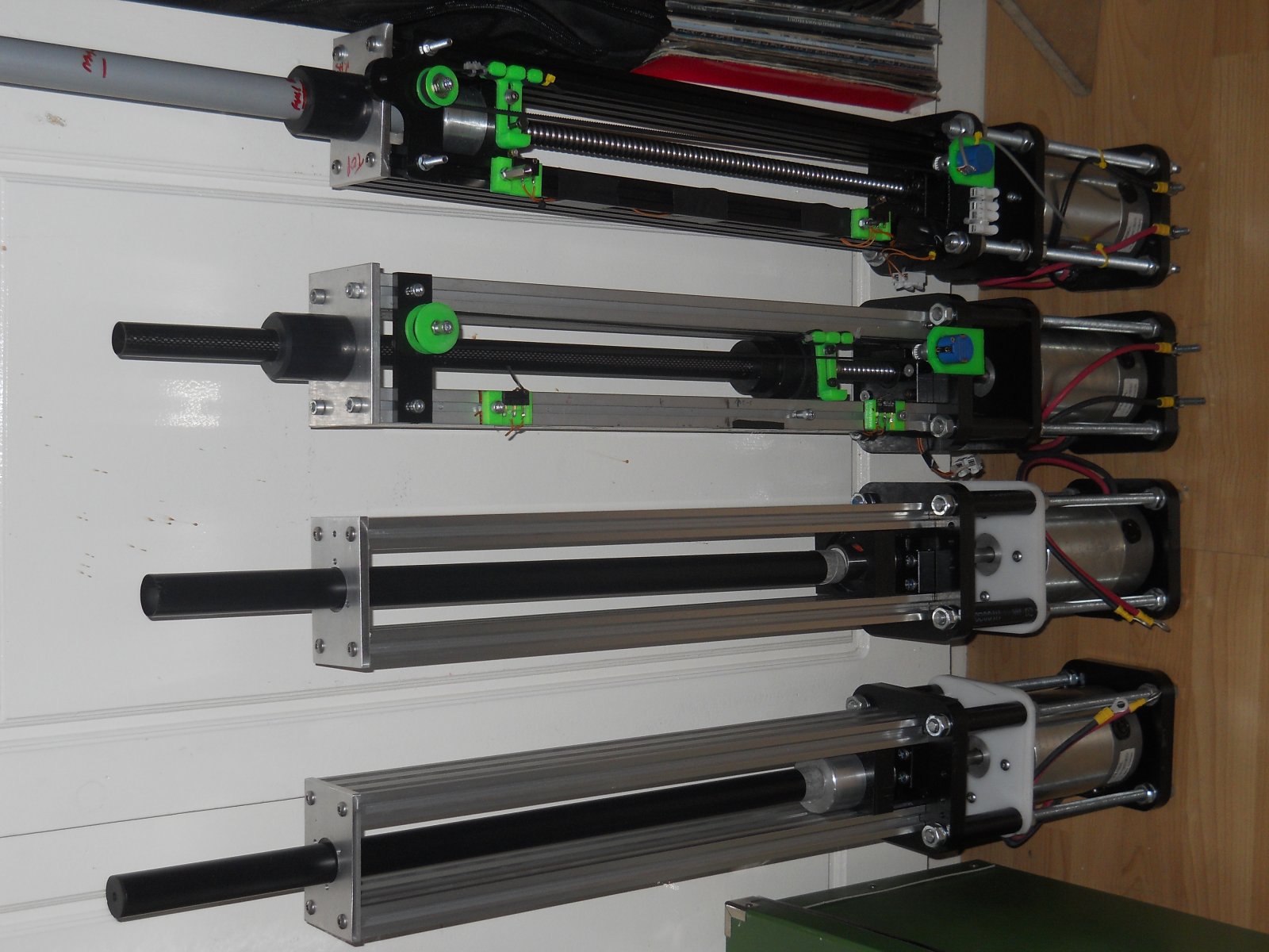

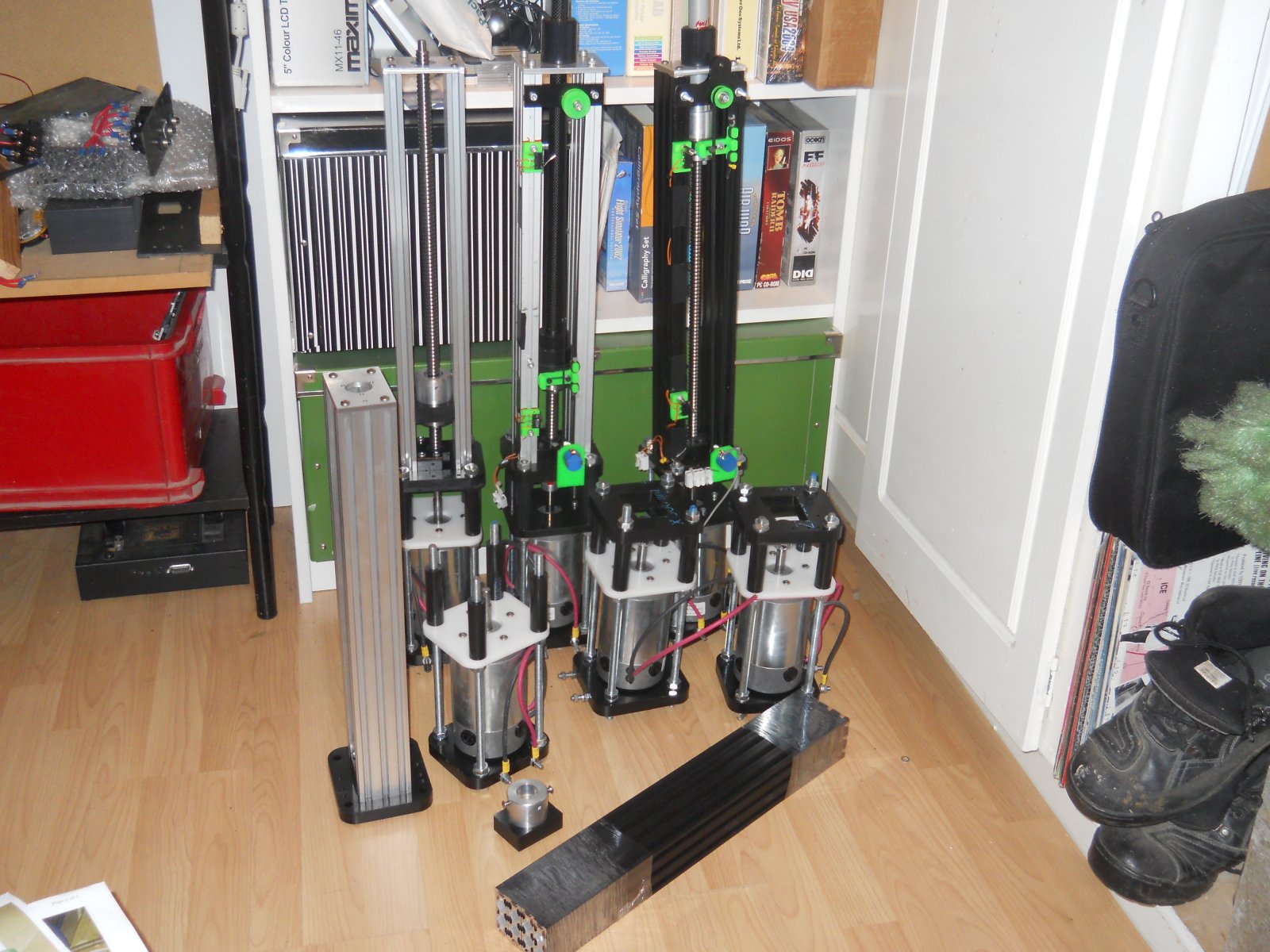

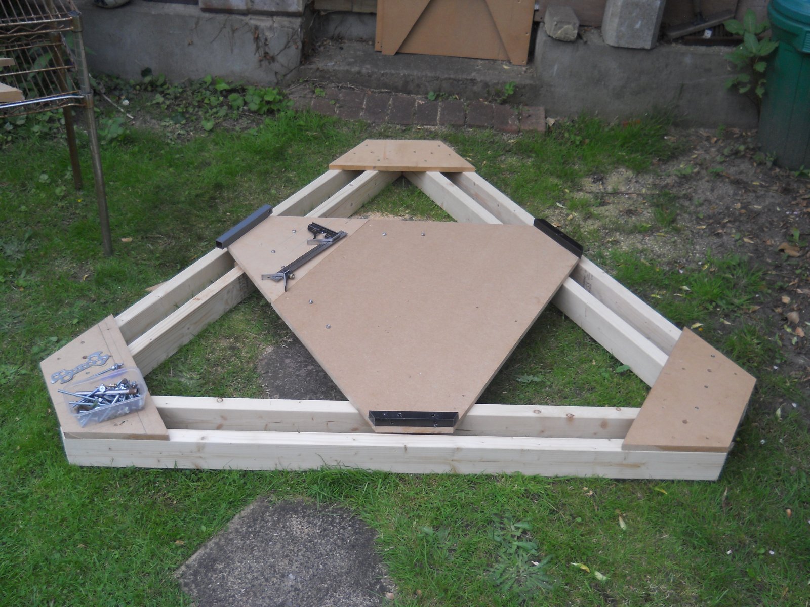

    Hi Guys a trickle of updates , still awaiting the last 2 1605 x 500 ballscrew units then that will be all 6 sorted , have attached a couple of pics ref the new Base and Temp upper Platform ( for testing Movement use only ) with any luck I should be able to start mounting the Built actuators this week sometime

    That's great man! Keep up the good work!
    That actuators looks freaking powerful!

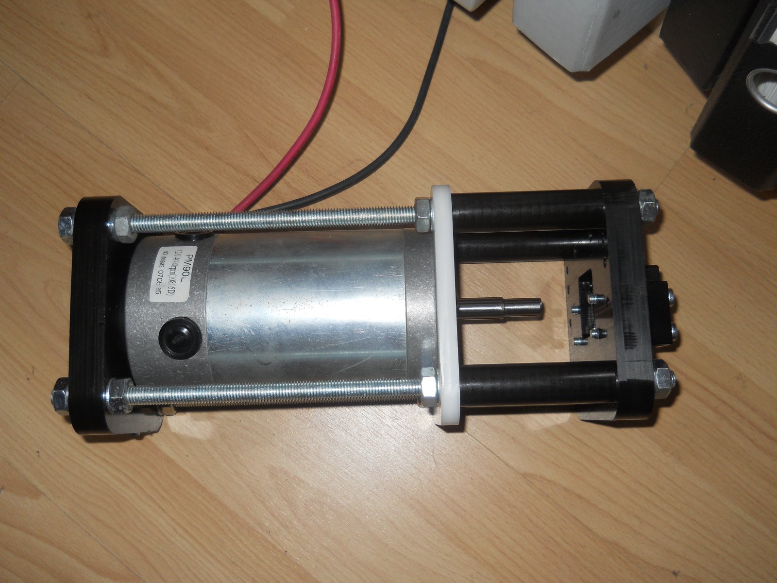

    Yes ebay is youre friend.The motors are still sold on ebay, great find they are 0,7nm cont.
    With a little luck you could do without gassprings

    BNIB Parvalux PM 90 Electric Motor -
    12V 4000 RPM
    Description:
    • BNIB
    • 12V DC Permanent Magnet Brushed Motor
    • Manufactured in the UK by Parvalux
    • Huge Torque (> 2NM) - Suitable for many applications (e.g. Small electric vehicles, conveyors, machinery etc.)
    • Rated at 270W and 4000 RPM (no load)
    • Stepped shaft; suitable for gearbox applications
  16. adgun
    adgun Active Member
    Jan 28, 2008
    538
    mechanic
    Netherlands
    5,801Coins
    +138 / 4 / -0
    motor sheet from parvalux

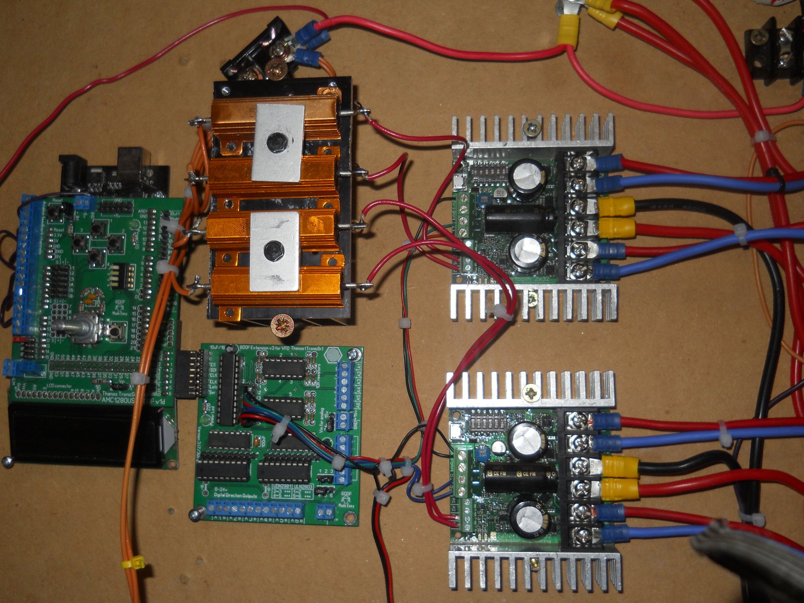

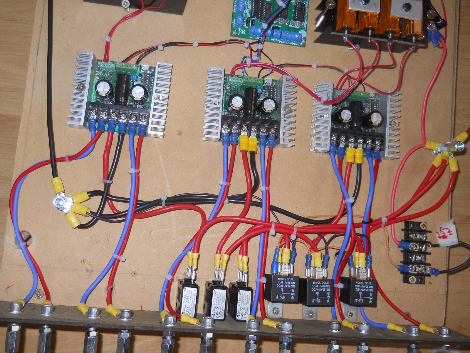

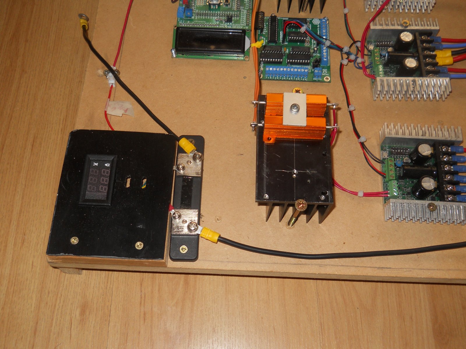

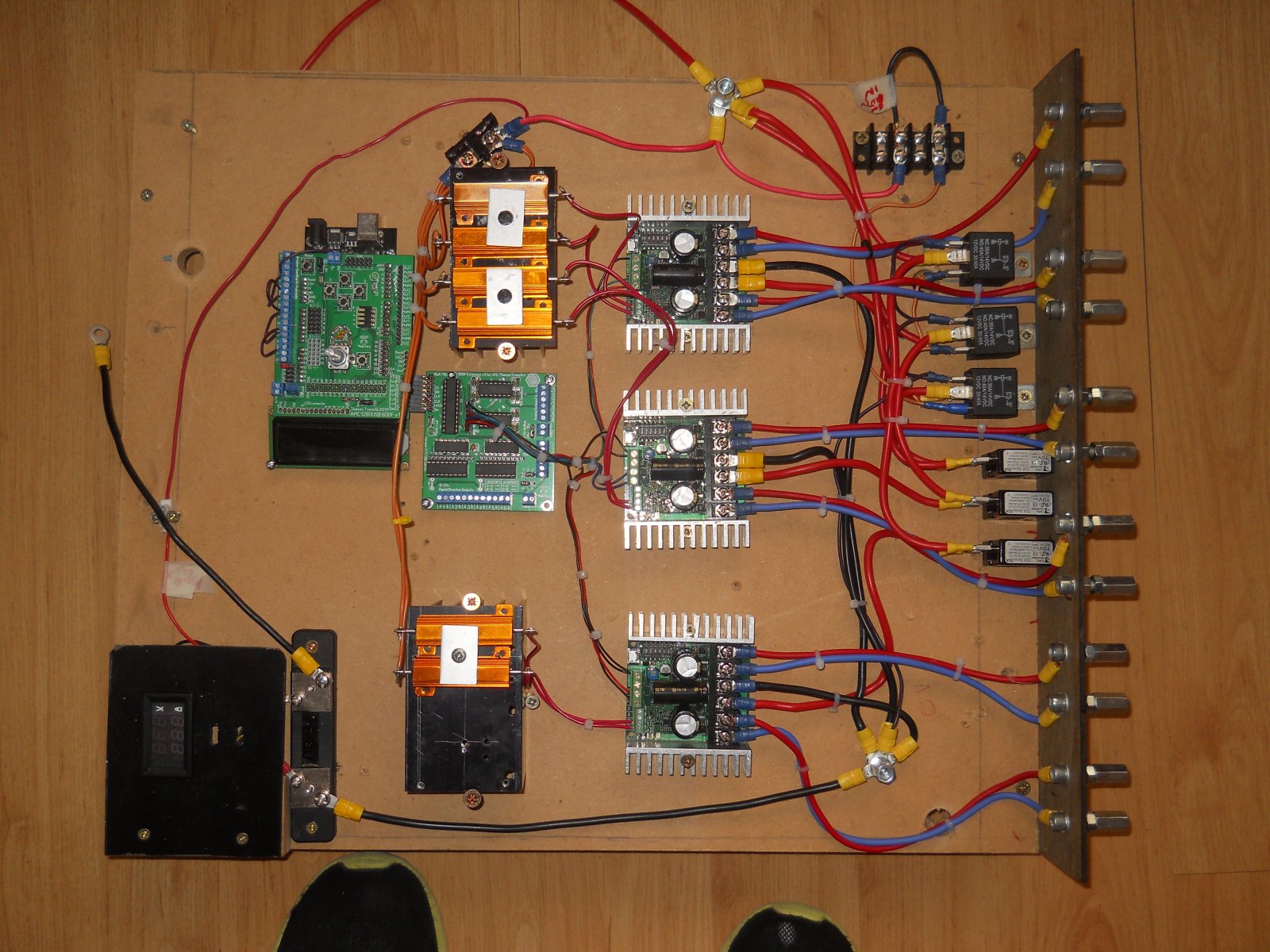

    Hi Guys Been putting together the control box as always Rough n ready but all elements are in place Final version will be better laid out , but getting to the point soon where the last 2 actuators will be mounted on the base,, Ding Ding Round er ......Lost count but still battling away :)

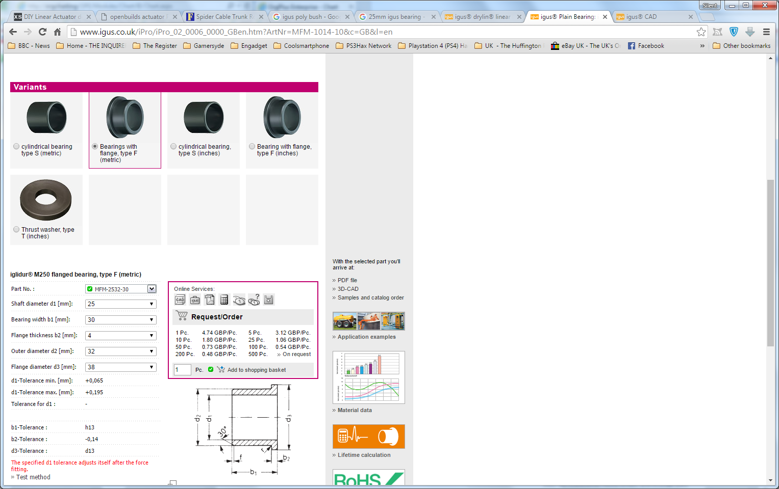

    Are these the poly bearings you got ?
    EDIT: Ignore as I see you put the spec on your design :)
  20. wannabeaflyer2
    Jun 12, 2015
    724
    london uk
    8,362Coins
    +958 / 7 / -0
    Hi @SilentChill I did a crafty and asked them to send Samples and to my amazement they sent the 6 I needed:) So that was a Result as they say
