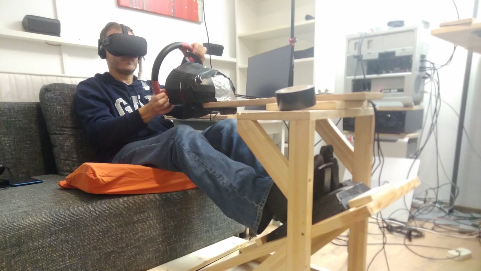

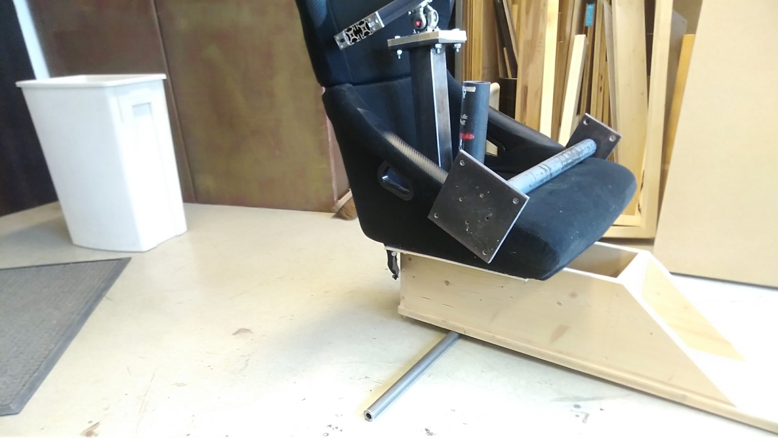

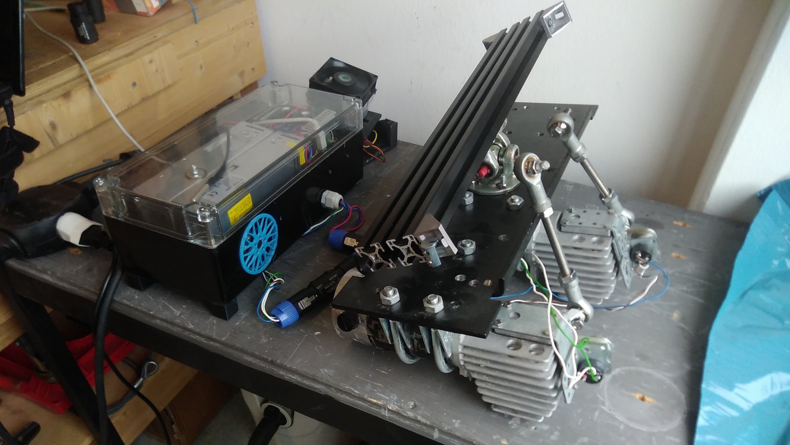

    My RaceRig

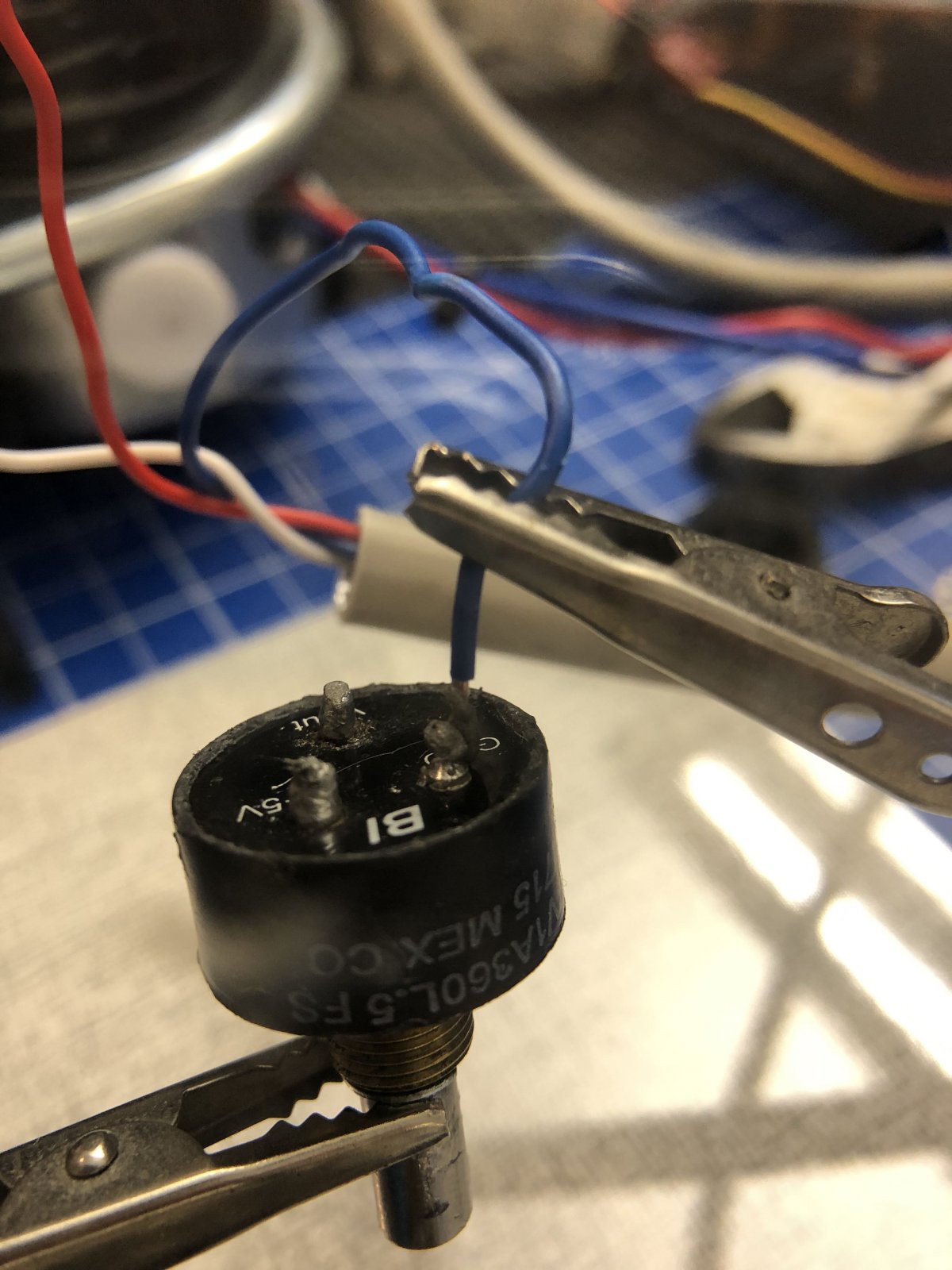

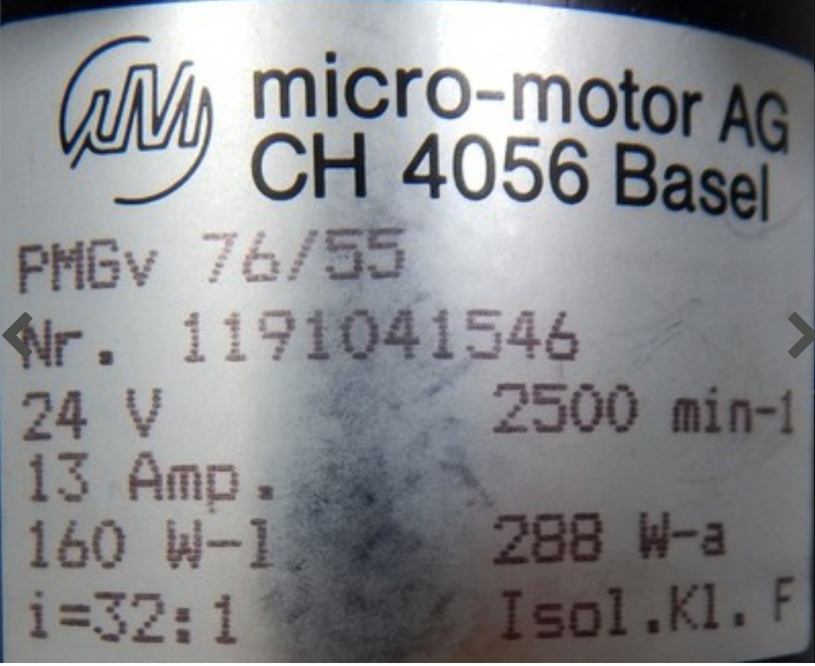

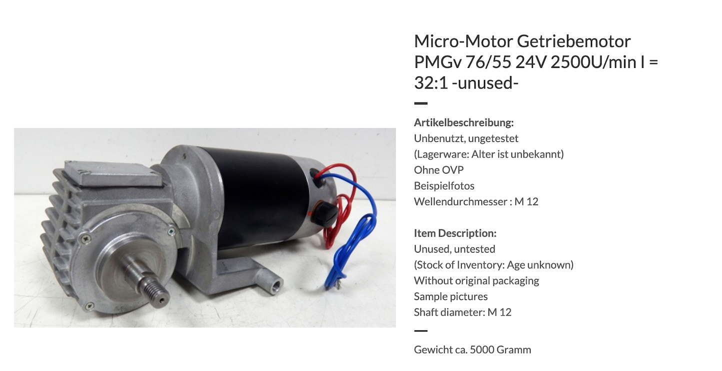

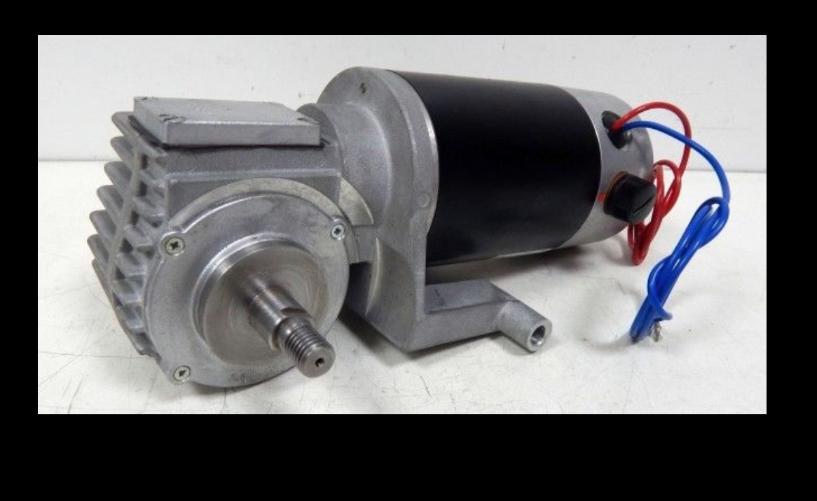

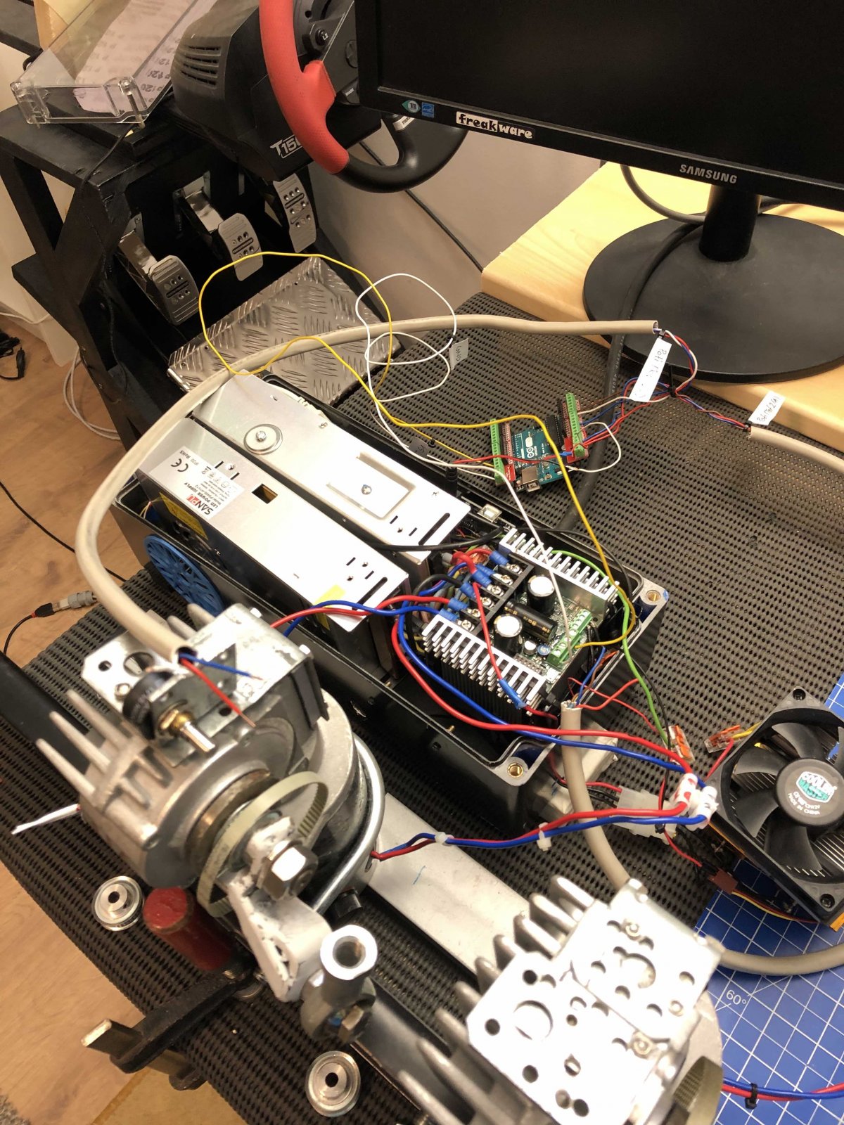

    What I bought on eBay
    WhatIgot01.jpg WhatIgot02.jpg WhatIgot03.jpg MeinMotor.png MotorSpecs01.png MotorSpecs02.png Poti.jpg

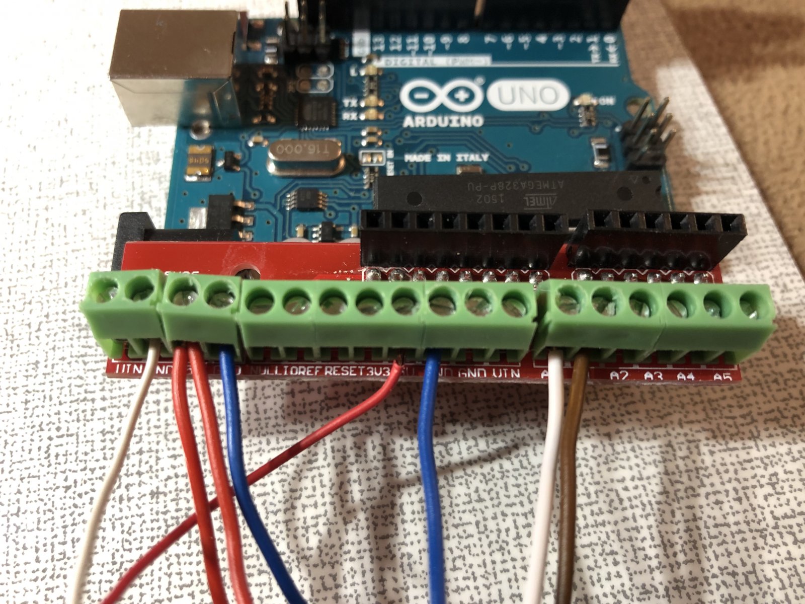

    My Arduino Wiring

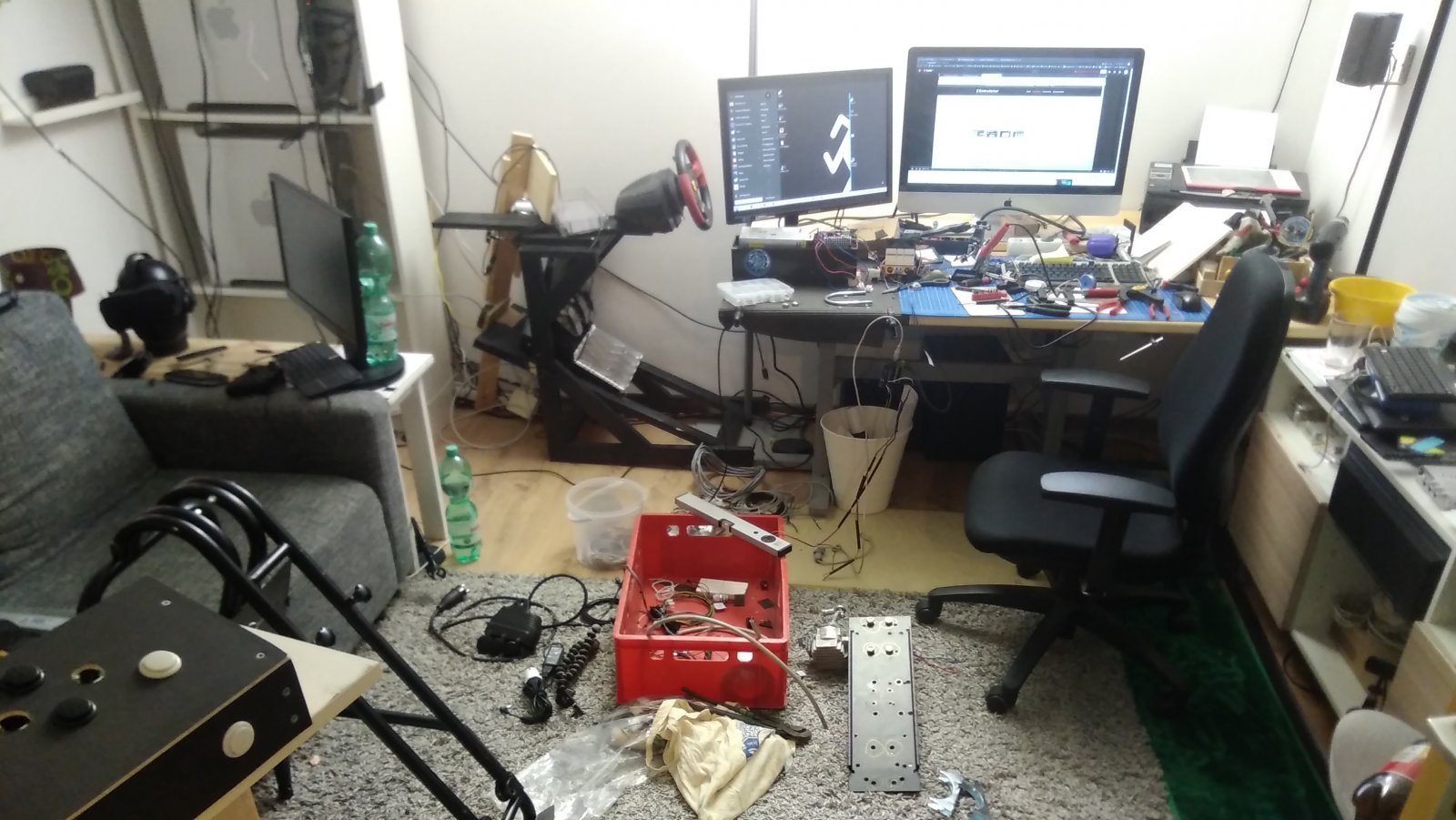

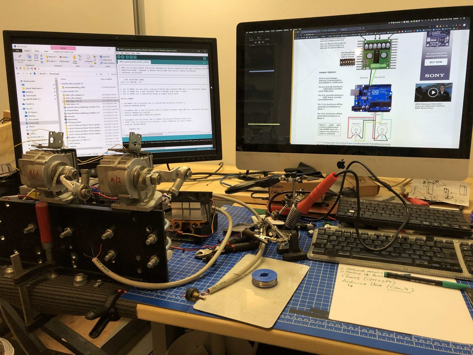

    Where I am now ... Chaos :cool:

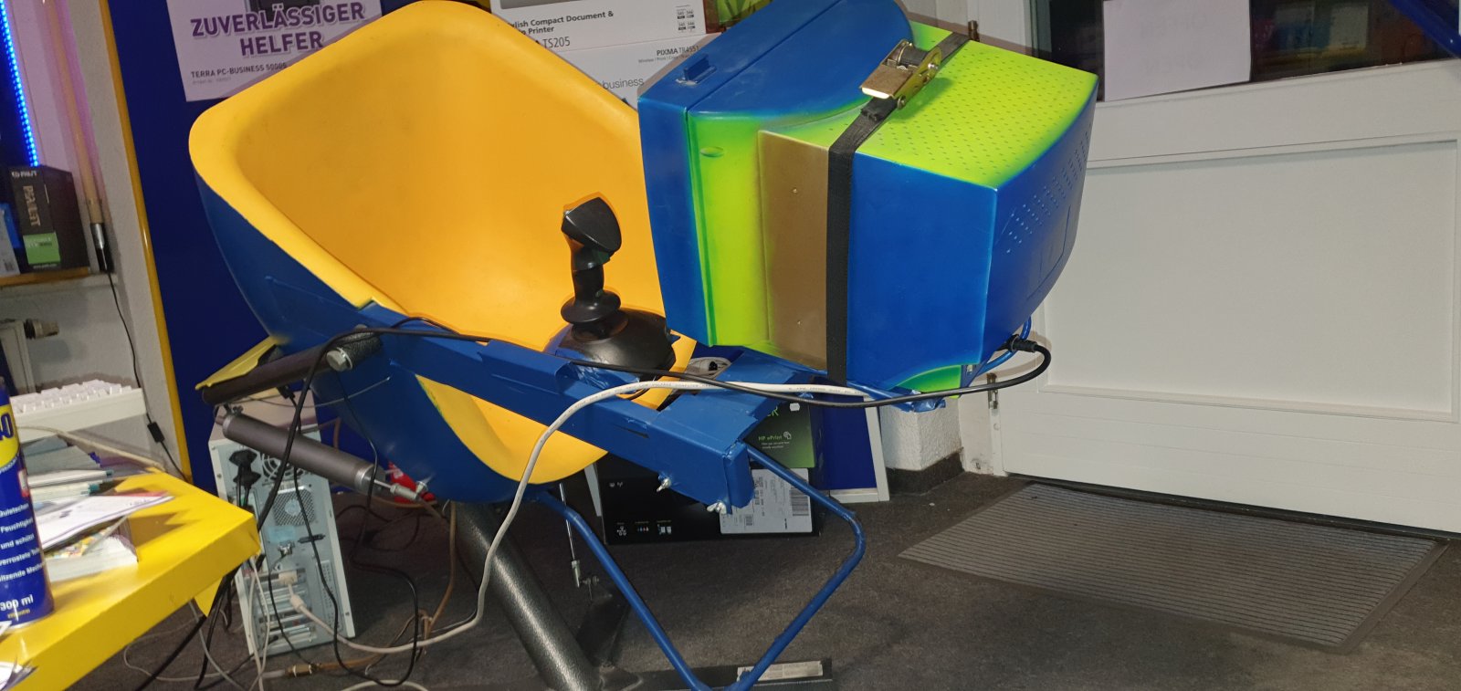

    I purchased that beauty for little money - maybe someone has a plan to mechanise that one? RNR meiner.jpg
    -> I already searched the forum but could not find anything like that:
    Maybe someone has some plans for me?

    Ups you are right the weight is too far away then right. I will change that and put the Seat right on a platform.

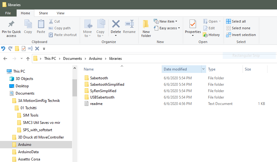

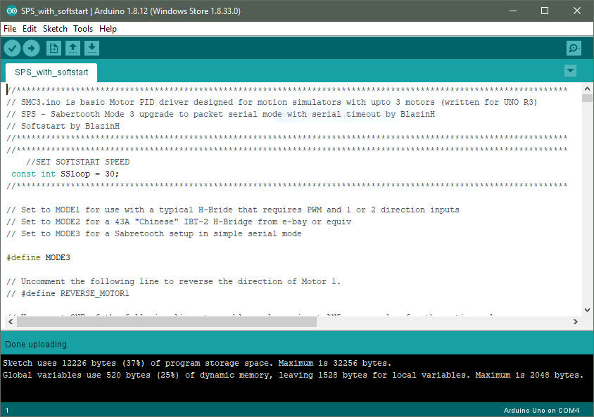

    Hi Noorbeast,
    I got that error over and over again ... Arduino could not find 'sabertooth.h'
    I started from new setting all up ...
    AND I found my MISTAKE !!!
    I never knew where to save the ARDUINO Libraries.
    And I always kept them in the wrong folder.
    Finally I put them in C: User ->Documents -> Arduino -> Library.
    Now I could upload the SPS Sketch and I get some reply from SMC3Utility.
    And I managed to get one motor running.
    :nerd Edit after a while and more experience:
    My problem/mistke was never WHERE to put the sabertooth libraries --> THIS WAS WHAT I DID WRONG:
    In order to avoide that "sabertooth.h file missing" error it is MANDATORY to start the Arduino IDE app FIRST and have it continously running while you THEN download and install the sabertooth libraries. After you did it in this follow up you are able to upload your SPS sketch without any problem/error :cool:
    Tell me if this was helpfull for U now ... as it made me crazy to find out :mad: back in my MoSiRig-Baby-Times .... now I might be around the knowledge of a 2year old :D
    Very tiered now. I will stop for toady (18:50 Berlin Time)
    To help others too I add the next pictures that shows where I put the ARDlibraries NOW that it works.
    Thank you for keeping fingers crossed for me - not sooo frustrated anymore - hope to get happy tomorrow.

    I like your power supply and motor drive box. Nicely done. I have all those parts just sitting on the floor and they fill with dust, plus I'm always worried about breaking a wire. I need to do something similar to what you did.
  14. cgodwin
    cgodwin Active Member
    Sep 18, 2015
    225
    Engineer
    Eugene, Oregon
    2,478Coins
    +278 / 2 / -0
    What are you trying to do with the Rock 'n Ride? Does it not work? Are you wanting to update it with a more modern control system?
  15. ART FLY
    ART FLY Gettin' High on DIY :) Gold Contributor
    Jan 18, 2020
    118
    Bavarian State Theater, Decoration Stock Manager
    BAVARiA
    421Coins
    +69 / 0 / -0
    Hi cgodwin nice to have you involved!
    Well the nice box does not count to my honor. I bought this box on the internet from an abundonned project. https://www.xsimulator.net/community/threads/ger-2dof-motionseat-with-rseat-rs1.13219/
    I had to redo all the cabeling.
    The postal delivery service kicked the parcel around a lot, so also one Hall360sensor was broken. The case for the resistors were broken ... Still I also like the Box for all the electronics from the beginning too for the same reason you mentioned not to get everything covered with dust lately :)

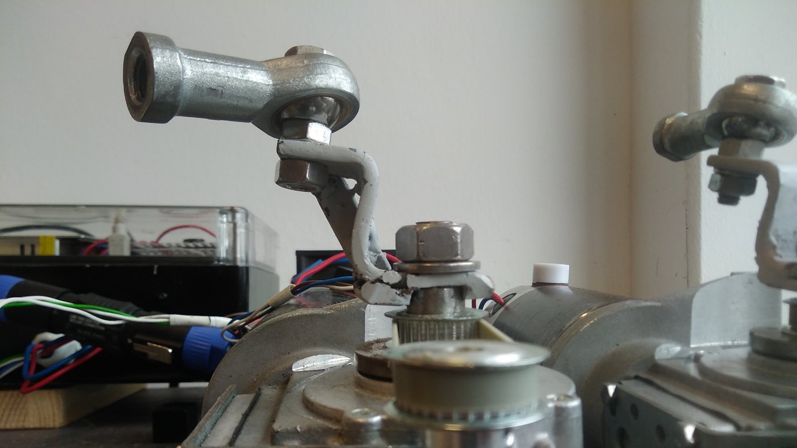

    I do not think the Rock'n'Ride Chair can be brought back to live with the actuator set up it came with. But mabe you know how to find a suitable new interface.
    I thougt it might be cool to move it with a belt or a chain just like in the YT video I posted. But I have no idea how to handle the Motor control for that either :( Maybe just gear it with levers o_O ?

    Maybe I should not build a full motion platform with my motors (I have 4 of these, but I think only 3 of them will work) but really mechanise the RNR chair and later position it on a lottle turn platform for tractionloss.

    have you had the motors working with smc3utils
    you can see and adjust the settings

    Hi gadget999 - I got one motor working pretty well with the Utility. I think my other motor is damaged. I will try with the spare ones I bought on ebay (I was lucky to get 2 more as the swiss manufacturer is out of buisness)
    What do you think about the engines? I posted some info Pictures about them above.
