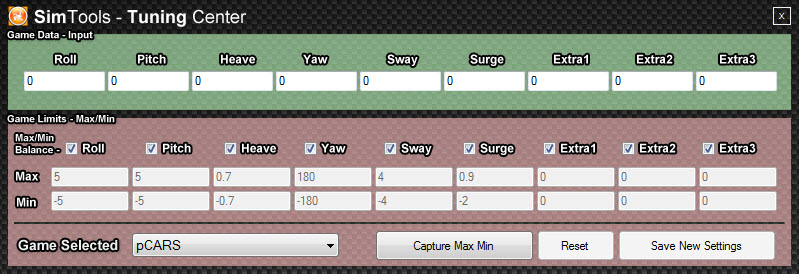

    Hey guys lets place our Tuning Centre Values and Axis Settings for new comers!!
    Shoulder Mount - Seat Mover - Jrks 12v200W 25:1 worms on 65mm lever.
    [​IMG][​IMG][​IMG]

    151,106Coins
    Perhaps it would be helpful to add a comment of what sim style they relate to, shoulder mount, foot mount, traction loss, 3DOF.

    Rob i just copied your settings, i was totally lost, i just wonder if you could publish your axis setings the fit settings of your axis... smooting, washout, Deadzone, Boundry
    :D thanks a lot (a parking lot) :D (remaind me not to jokes in other language) :D
  8. Nick Moxley
    17,056Coins
    +2,506 / 30 / -2
    Unless there's a particular problem with a certain force, I tend to stay away from Filters if at all possible.....Yes certain games require some Filtering....but again i would suggest running as little as possible.

    i would love some scn5 settings for 2 dof shoulder mount rig to try out.
    i finally sorted the vr graphics out and now i just got to sort motion but i ain't too good at that i don't mind saying ! lol
  13. noorbeast
    21,582
    151,106Coins
    While it takes time and practice when using VR it really pays to learn how to create and refine your own motion profiles, including making specific car and track variations in Game Manager Editor: https://www.xsimulator.net/community/faq/steps-to-create-a-motion-profile.228/
    In VR you tend to use less axis movement in motion profiles, but make them as fast and precise as it can be, while with screens you would use larger axis movements.

    I am going to go thru that link with a fine tooth comb.
    I have I think in the axis setting sway at 80 on each.
    And 110 on surge each.
    If I don't run that I don't tend to get much happen.
    Is this because of me running the running centre with this set too high at 50% on all when I do the test.

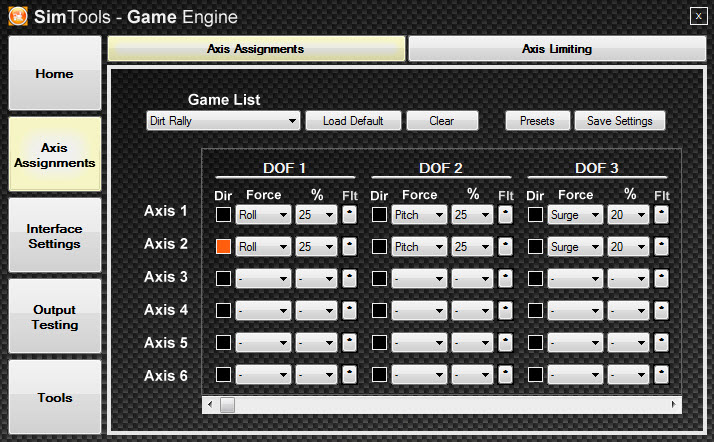

    While you can go a little over 100% total in Axis Allocations at some point clipping will be an issue: https://www.xsimulator.net/community/faq/axis-assignment-percentage-totals.120/
    Follow the steps in the link I posted earlier, TC values for racing should be much lower and in the case of heave and perhaps surge may even be less than 1: https://www.xsimulator.net/community/threads/tuning-centre-and-axis-settings.8363/#post-148555

    I have a question for anyone with advice............... while in Pcars 2 Daytona Track. with 2 dof left turns on track. when i come into the bank my right side motor draws back until the straight which my seat comes back up. every corner is the same... if i drive to the flat on the inside my seat flatens out. as soon as i hit that bank the seat goes back. i dont know if it is sway or roll? anyone with an idea?
  18. noorbeast
    21,582
    151,106Coins
    Tuning for an oval track is difficult.
    Try doing one axis at a time, so you know how each reacts to the banked turn: https://www.xsimulator.net/community/faq/steps-to-create-a-motion-profile.228/
  19. Nick Moxley
    17,056Coins
    +2,506 / 30 / -2
    Also watching the Live Axis is a Dead Giveaway as to what force is going FULL travel.

    I'm studying about motion profile and tuning center and I understand that:
    1) verify one dof at a time, so I can start to verify surge and then the sway and so on. If I set only the surge I can use 100%, while if I verify the surge and the sway I can use 60% and 60% (to obtain max 120%)
    2) Capture Max/min by tuning center and then modify the values to obtain the best motion profile about the surge, for example.
    But my question is this:
    I verify the DOF one by one and I set the Max/min in tuning center, but when I set all DOF I can't have the 100% or 60% to every DOF.
    For this reason the Tuning center values are still ok? May be if I change the % DOF in axis assignment I need to change the Tuning center values that I'd saved.
