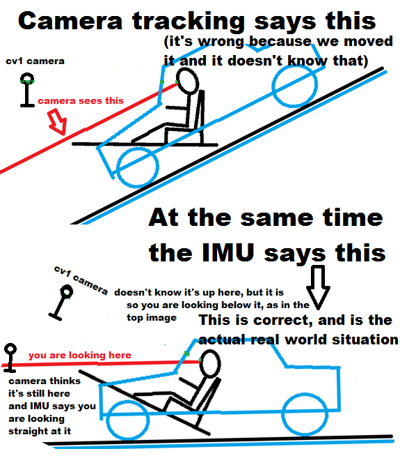

    First, what exactly IS the problem? The problem is a bit tricky to grasp. I'll attach my lovely art to try to help with that. What happens is that when the motion simulator moves us around, it thinks that we are walking or jumping around as in room scale. It makes this assumption that if we are moving relative to the real world we are supposed to be moving in the sim world. Walking around a VR room or peeking around a VR corner.
    When we use motion simulators the vehicle you see in VR is actually locked to the living room floor. The car moving doesn't make you move in real life at all. If you lean over you could stick your head out the window though, the car doesn't move over to follow you when you do that right? It's stuck to the real life floor.
    When you use a motion sim, and for example the car goes over a bump the VR tracking thinks maybe you just did a little bunny-hop while standing in your living room. Maybe you were hopping across a little VR obstacle. =) Every motion that the motion sim makes moves your VR headset around because it's moving and you are sitting on it. That's bad. You want it to totally ignore all that, but you DON'T want it to ignore when you lean over inside your motion cockpit to stick your head out the window or turn your head to the right to check that mirror. We have to separate those two, because the VR tracking thinks they are both the same.
    What we need is to attach the VR vehicle to the simulator instead of to the living room floor/Earth. This is what you see in my image above. Our head tracking needs to track only how we move relative to the car.

    I decided in a vague way that the problem was the computer noticing that the data from IMU and optical didn't at all match up and getting upset about it. The point was it wasn't good enough, and about that time the "motion compensation" plugin came along.
    For those of you who are scratching your heads and can't understand where the problem is because with the camera on the motion simulator the positional data will always be relative and therefore correct, here's the explanation of what was going wrong that I now know in a non-vague (but very confusing) way.
    Let's use the example of hard forward acceleration in a simulated race car. Your IMU is keeping you looking straight ahead relative to the real world and your brain is ok with that, but your optical tracking says straight ahead is up in the sky in front of you. The sim is tilted back remember? So the CV1 camera for example is now raised up and tilted down looking at you at an angle. It's seeing the top front of the HMD instead of the front straight on, but the IMU tells it that that do not have your head tilted downward.
    In the example of the CV1 the camera is not seeing what it expects to see in terms of the LED array on the HMD, the spacing is all wrong because of perspective. It's recognizing the LED pattern showing it that you head is tilted forward/down and actively trying to correct what it thinks is bad IMU data that says you are looking straight ahead.

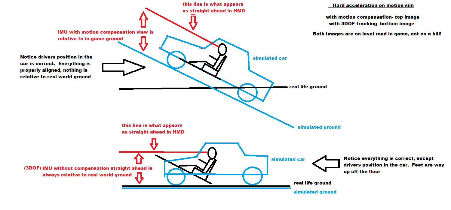

    SteamVR OVRIE Motion compensation:
    Finally we had a proper fix at least partially working. It didn't work properly at all with Oculus though, and we were mostly unable to use bass shakers (which are awesome in sims with software support!) as they caused big tracking problems.
    To use the motion compensation plugin what you do is you attach a tracked motion controller such as a Vive wand, Vive Tracker, or Knuckles controller to the motion platform. When the simulator moves, that tracked device moves with it.
    When you move your head, that tracked device does NOT move with it. This is the key.
    So if you subtract the motion of that device from the motion of the HMD, you just subtracted the motion of the motion simulator which was the whole objective.
    But it's not that easy. =/ For it to be perfect, the tracked device would have to be in the exact same location as your head. I do not recommend trying to have two objects occupy the same space at the same time under any circumstances, but when one of those objects is your head it goes double!
    So there's going to be some error, the farther the device is from your head the bigger the deviation is. With Lighthouse we generally place the tracker on the top of the seat, right behind our head. This is quite close to the head and that's good. Unfortunately WMR headsets and others with that type tracking such as Rift S and Quest can not track the hand controller if it's directly behind you. The only option becomes to have it in front of your or alongside you. This puts it much farther from your head so there is a lot more error, but it's much worse than that.
    On most motion simulators the center of rotation is almost always fairly close right in front of the driver/pilot. This means that if you put the tracked controller two feet in front of you, when the simulator makes a "pitch" movement, the tracked controller and the pilot's head go opposite directions in the heave axis! If the sim pitches up, everything forward of the CoR goes up and everything aft of the CoR goes down! If the sim yaws left, the controller moves left on the sway axis, and the driver moves right on the sway axis. If you put the tracked controller alongside the pilot say on his left side to fix the huge pitch problem then when the sim rolls right the controller goes up, but in a pure roll motion the pilot's head does not. In fact it actually goes down a little bit. And that's where things go horribly wrong with WMR motion compensation.

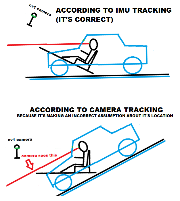

    It is very confusing! This is the same bit most folks stumble over. I've got a good understanding of it and I still have to be careful not to get tripped up thinking about it.
    Ok so we are talking about running the sim like a CV1, without the motion compensation plugin.
    When you accelerate forward, the sim pitches up to cue this motion right? But the Car and the world in the VR headset did NOT tip up. Alright, I found the diagram I made a year or two ago to help with this. =)
    So that explains why we need motion compensation, which isn't what we are discussing so basically ignore the top half.
    We are talking about the CV1 camera without motion compensation so that's the bottom diagram there. Let's say the CV1 camera is on the hood of the car, that's about right. So the IMU in the HMD is making you look "real world straight ahead" as in the bottom drawing because the reference is real gravity. The camera thinks that it's on the hood of the car in the bottom drawing.
    The problem is that the camera is actually on the hood of the car in the top drawing because it went up with the platform tilting. It's looking down at you from up there, while you are looking straight ahead relative to the real world because the IMU says that way is straight and level and that's where your windshield is and the road ahead.
    So the Camera thinks it hasn't moved and you should be looking straight at it. But what it see's is the HMD looking at an angle below it. As far as it is concerned you are looking at a downward angle. If that's was true than the IMU should be showing that your head is tilted down, but it says you are looking straight ahead, so they disagree completely on this. This should help.

    Neg, this is all about what happens with the camera on the rig. Mostly pay attention to the middle image.
    Here is another way to explain it. If you completely removed the IMU from the VR headset, the optical tracking would be able to track the HMD 100% on all 6DOF without it. The only reason for the IMU is apparently it's faster. TrackIR5 works exactly this way, 100% optical.
    So you put the camera on the rig and the camera knows exactly where the HMD is and it's pitch/roll/yaw angles from the shape of the constellation of LED's. It's 100% fooled by our trick of putting the camera on the rig and has no idea that anything unusual is going on.
    But we can't disable the IMU. The IMU doesn't know or care that the camera is on the rig, it knows THE TRUTH because it uses gravity, and perhaps magnetic north as it's references.
    If the camera is 100% fooled on all 6DOF, but the IMU isn't fooled at all then the software now has to deal with two totally contradictory data-sets being reported for the pitch, roll, and yaw position of the HMD.

    Now the two disagree on the pose by a far larger margin than is normal, and the software has to try to figure out how to handle that.
