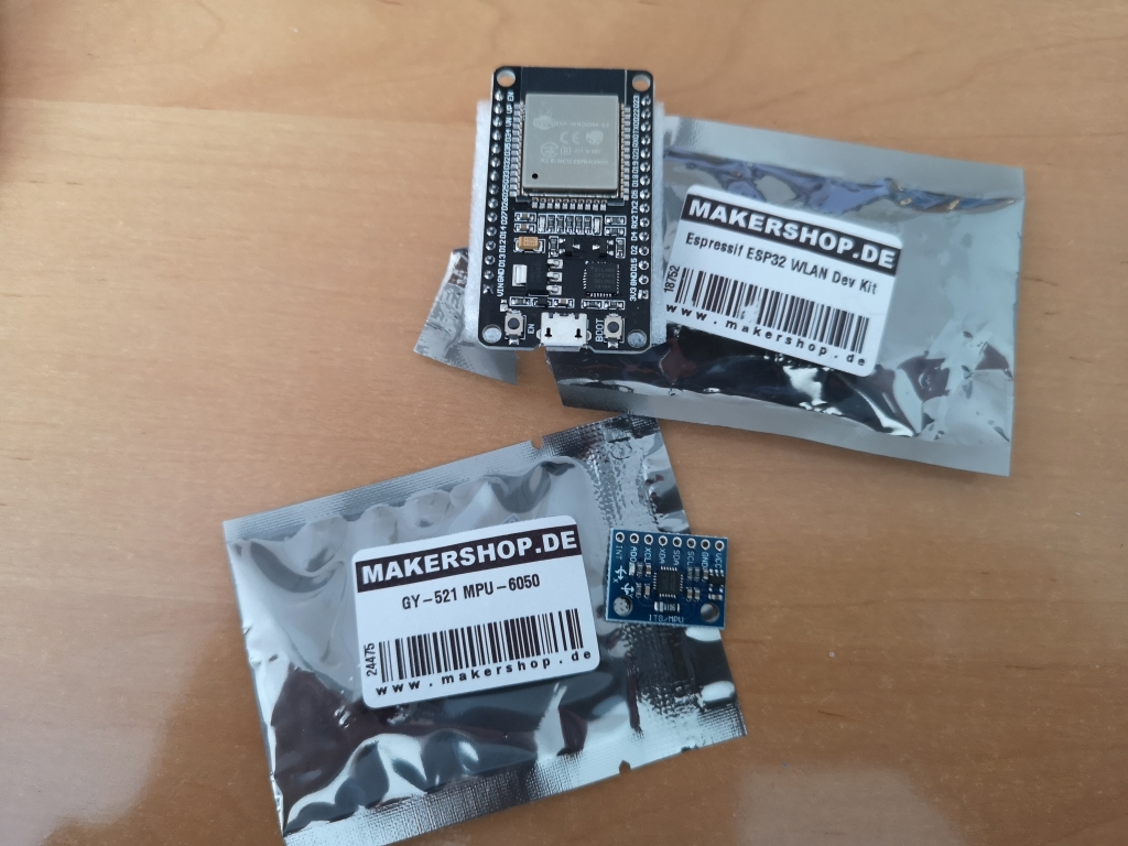

    Was speaking with @hexpod about motion cancelling, and I've had this idea in my mind for some time.
    Many talk about using inverse kinematics, and for example, use the software info to calculate platform position and from there make motion cancellation.
    In my opinion it doesn't work.
    There's lot's of lag in this solution. Requires maths, more software.......
    So I thought of using an hardware solution.
    Well, this might not work, but we can try.
    We need to calculate the "pose" and to calculate that, we need:
    - A gyroscope to know the 3 angles
    - An accelerometer to know the acceleration in each of the 3 directions
    With that we can calculate the "pose" of the platform.
    The advantage of this solution is that it works on any kind of rig (6dof or 2dof).
    But we might have problems. Precision can be one of them.
    This is the hardware I want to use:
    - ESP32 (fast, cheap and with WIFI/Bluetooth) --> 8.35€ each at ebay
    - MPU 6050 - 6 DOF gyroscope/accelerometer --> 3,10€ each at ebay
    Some ideas from the start:
    - Use more than one MPU 6050 to get a mix of info from them (I ordered 3)
    - Create a module on the FlyPT mover to show this data or an independent software.
    - If it works, worry with the connection to hmd and proper motion cancellation.
    Anyone want's to try?

  11. pmvcda
    pmvcda aka FlyPT
    Nov 3, 2010
    1,868
    Portugal
    14,203Coins
    +2,181 / 16 / -0
    Just received the hardware:
    now let's build it...
    just need some free time... o_O:(
    Seriously, it might not work, but I will try.
    • Creative Creative x 2
    • Optimistic Optimistic x 1
