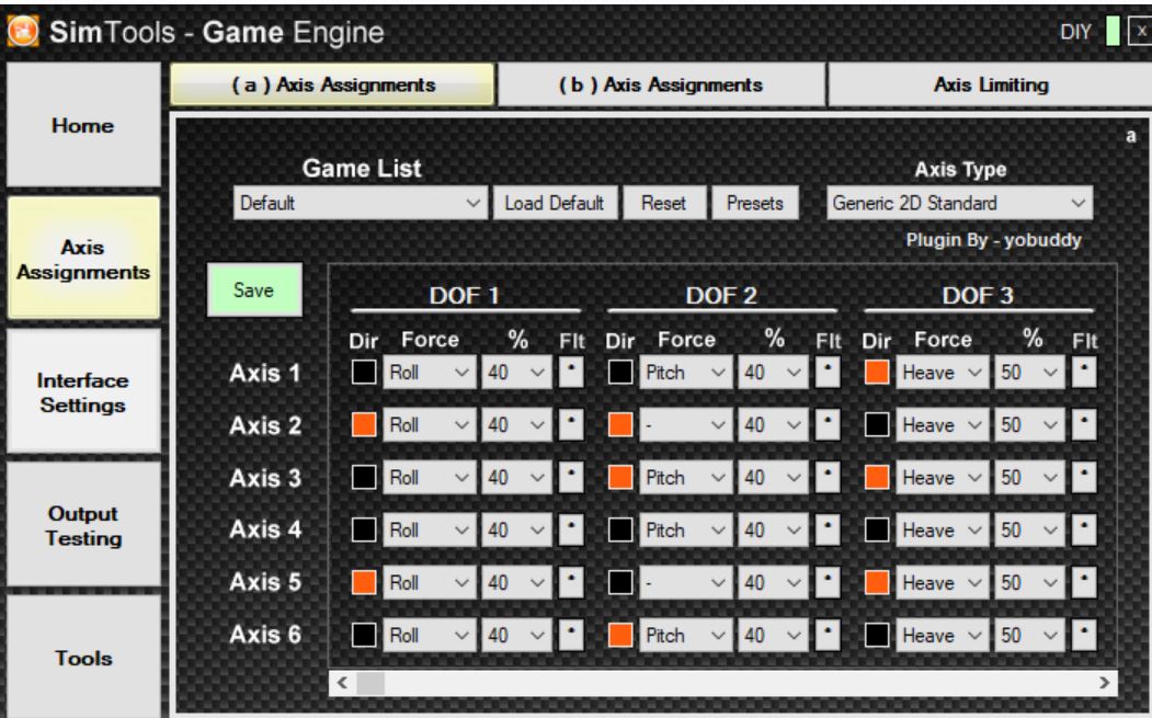

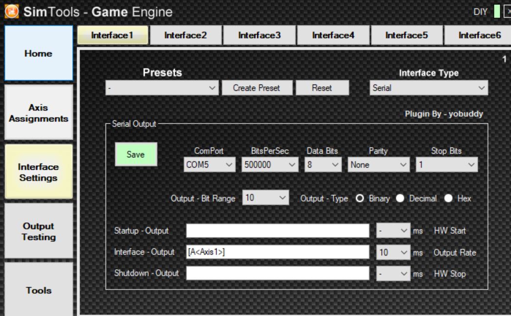

    I have just finished reinstalling simtool V2.1 on my new windows 10.
    I had sucessfully changed my 6 comport within SMC3 and they all work fine(they all move physically individually).
    I had previously took screens of my old settings and copied everything as it was except for the comport numbers, when i tried to test the axes...nothing bulge?? i tried to find documentation for V2.1 and couldnt find anything, it says ''under construction'', i am wondering if i need to put anything in the ''b'' asignment section, i used only the ''a'' section.
    Tks in advance !!
    here is a typical screen of my settings:

    Each axis nees to be assigned like this <Axis1a> <Axis2a> <Axis3a> <Axis4a> <Axis5a> <Axis6a>
  20. poman
    poman Active Member
    Jan 5, 2012
    128
    154Coins
    +95 / 0 / -0
    aaaaaaaaaaaaaaaahhhhhhhhhhhhhhhhhh!!!!!
    LOL should have figured that out by myself knew it would be a silly thing...
    Tks so much
