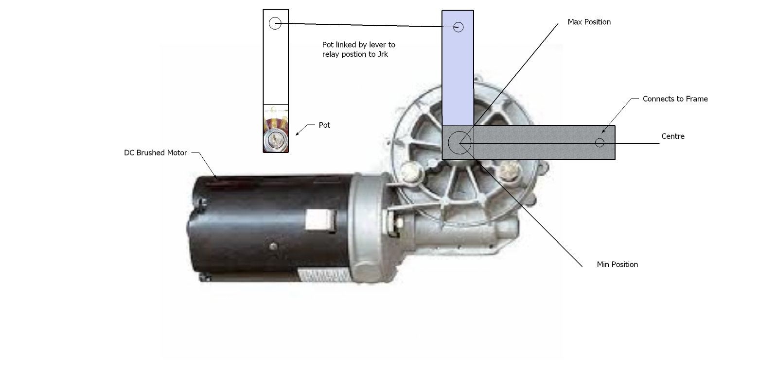

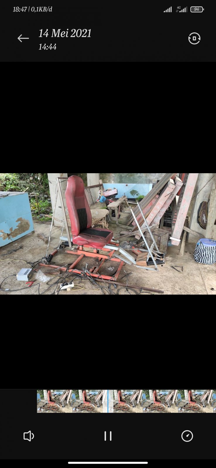

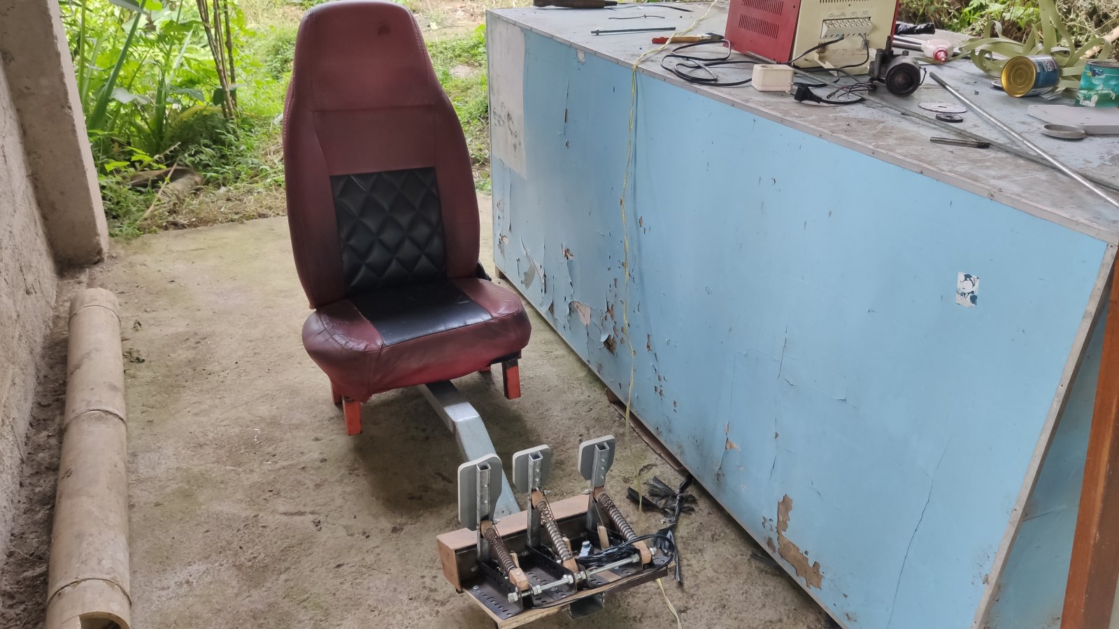

    this is an update of my 2dof progress, I have tried to drive it directly with 24v input to the wiper motor just to try, I want to ask how to put a potentiometer (I used 10k value) to the wiper motor. plans so tomorrow can try to get moving with simtools demo (while ready to apply for a DIY license, and I hope good luck getting it) Thank you.

    It is best to connect a pot to the motor with a flexible coupling: https://www.xsimulator.net/community/faq/how-to-connect-protect-a-potentiometer.13/

    A motor with a lever provides effective torque in a range of about 38 degrees up and down, so the motor does not run 360 degrees, instead a pot is attached to the motor give positional feed back to the control board so the lever can be effectively moved anywhere in the target range: https://www.xsimulator.net/community/faq/fundamentals-of-motion-control-electronics.23/category

    But i see, on your link to make holder pot to motor, i see someone modif the pot to move endstop of pot sir, i should be like that sir??
    And i will use methid like this for my pot sir, it work nice sir??
    Note foto from your link sir

    You will find the FAQs a valuable resource for common questions such as this: https://www.xsimulator.net/community/faq/
    In particular check out the Design: https://www.xsimulator.net/community/faq/design-considerations-resources.24/category
    And Build sections of the FAQs: https://www.xsimulator.net/community/faq/building-resources.12/category
    There are a variety of ways to connect and protect pots, both directly and indirectly: https://www.xsimulator.net/community/faq/how-to-connect-protect-a-potentiometer.13/
    Personally I use Hall sensors rather than pots, as they have really good resolution, long life span and won't break if over rotated: https://www.xsimulator.net/community/faq/how-to-choose-potentiometer.238/
