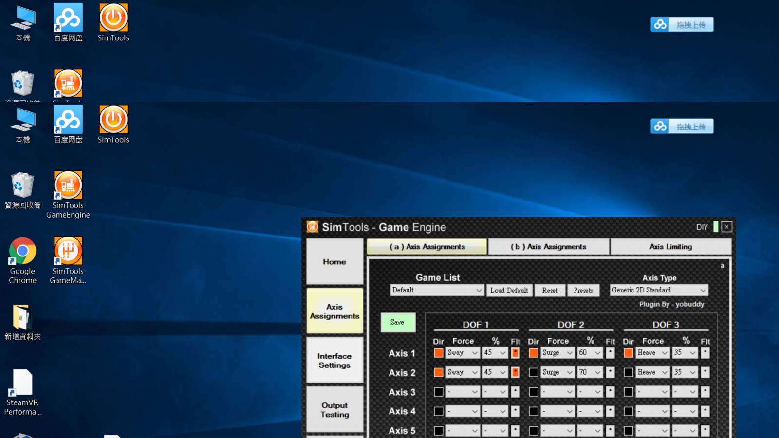

    Use 1.3 normal movement of the normal 2.1 test start will start skew, and will not return to the center, the cursor are not used

    There is insufficient information concerning the hardware you are using and all settings, for SimTools and computer language settings: https://www.xsimulator.net/community/faq/simtools-language-setting-bug-change-to-english-local.233/
    Your DIR settings in Axis allocations certainly look odd for a 2DOF, a motor may be reversed but this is what SimTools expects: https://www.xsimulator.net/community/faq/which-way-to-set-simtool-axis-movements.230/
    You need to have fully removed 1.3 before installing SimTools 2 and redo all motion profiles: https://www.xsimulator.net/community/faq/steps-to-create-a-motion-profile.228/

    Start test can not return to the center point
    The system is WIN10 environment SIM2.1
    There are uninstallation 1.3
    21,555
    150,950Coins
    +11,025 / 56 / -2
    That does not really help. You likely have not properly deleted 1.3 before installing SimTools 2, or have a settings or hardware issue, but there is not enough information to tell which.

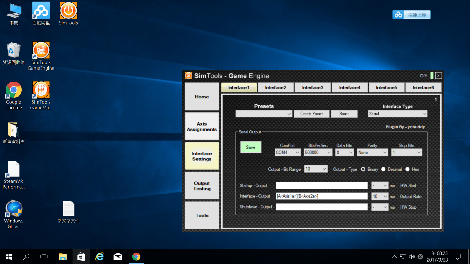

    Can you please post some pictures of your rig so we can tell what the mechanics being used are.
    Please tell us what hardware is being used and what code is used for controlling it.
    Please confirm if your system language is set to English local or not.
    Please post pictures of all settings for hardware and SimTools.
    When uninstalling 1.3 did you agree to uninstall all files or not?
    As noted your Dir settings are either wrong for a standard 2DOF or a motor is reversed, which is it?
