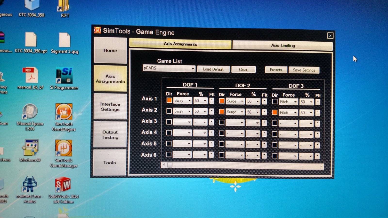

    This is my second test using simtools+step motors now without encoder
    @Ebtron help me, now we will improve the mechanical and test with the plataform

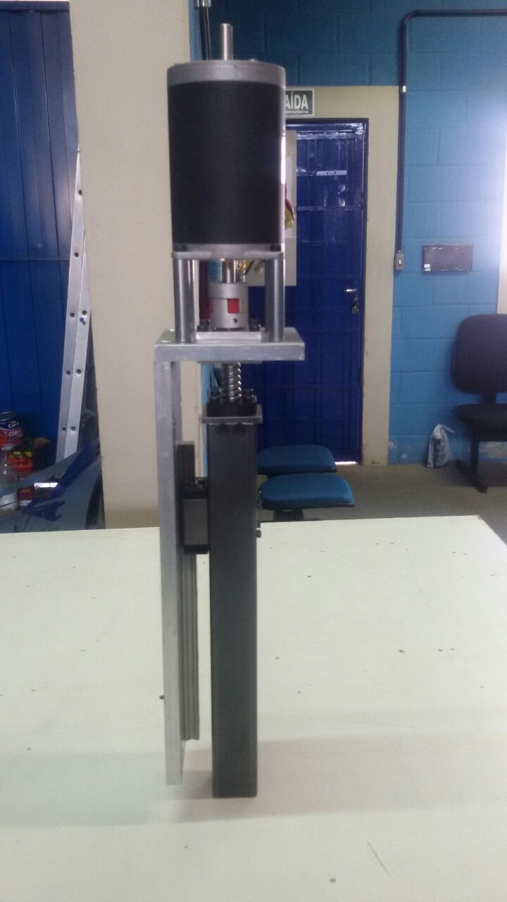

    woow, that finished metal actuator looks amazing ... how much are you spending with each of this beauties... ?
    fer

    what is it for, the rail you placed at the side of the column of your actuator?
    fer

    @ferslash we spent about the U$ 350,00 without the motors and drive, we build our own actuators because to import the SCN5 ou 6 we need pay alot of taxes, and the rail is to guide the actuator.

    Outstanding idea with the rail. Where is the pivot point of your rig? In the video it seems as the two actuators carry your whole weight. Amazing!

    @RacingMat sorry i forgot the pictures, i don't whats happened buyt i can't post the other file, but i'm using (pitch, roll, heave in 50%)

    @Bordiin , great work! Did you changed the spindle step or is it the same? What is the pitch of the screw? I think you need 5mm or 6mm to get enough speed.
