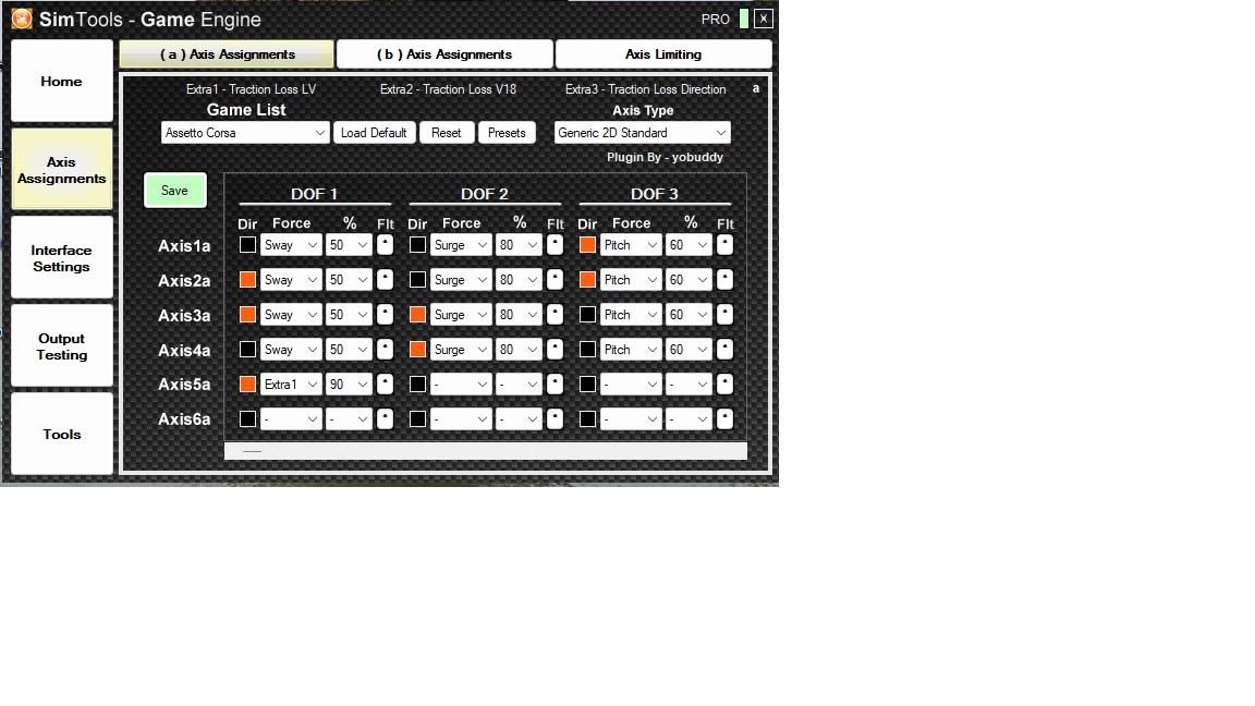

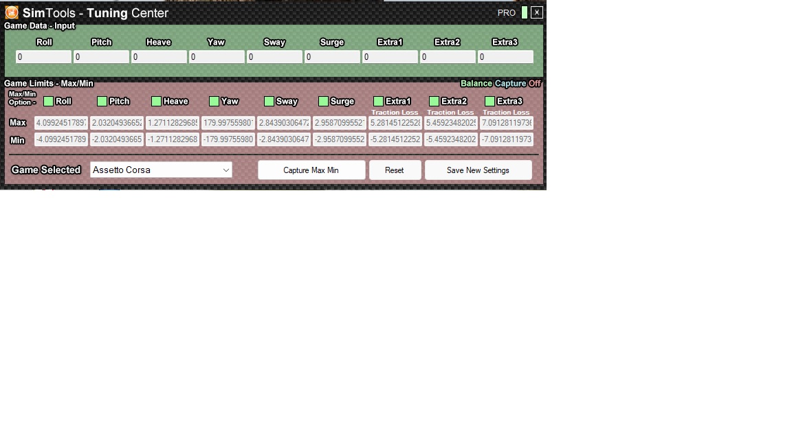

  4. Suglock
    Suglock New Member
    Dec 13, 2021
    23
    46Coins
    Hello
    My set-up as ask
    Thx for your help

  6. Suglock
    Suglock New Member
    Dec 13, 2021
    23
    46Coins
    Photos of my configuration because I don't know if I'm doing well in my settings I only have two jacks.

    Thanks for the clarification.
    So for 2 actuators you only need Axis1a and Axis2a configured, not all of theses:
    Because you have a 2DOF rig it has to share its full movement range (100% of its physical movement) between different axis. That is the purpose of the Axis Assignments, how much each of the movement rage each axis is allocated. Your current allocations are way too high, as the total is way more than the total movement range your axis can provide.
    If you read through the earlier posts FAQ profile tuning tips it suggests you start at around 20% and then adjust from there: https://www.xsimulator.net/community/faq/steps-to-create-a-motion-profile.228/
    Likely Roll, pitch and sway will end up with an Axis Allocation over 20%, surge likely around 20% and heave much less that 20%, likely 10% or under. In reality the total allocation can be a little over the 100% of the actual actuator range, as it is rare all axis are at their maximum values at the same time, except in a crash.
    Initially tuning should be done one axis at a time, temporarily disabling all other axis.
