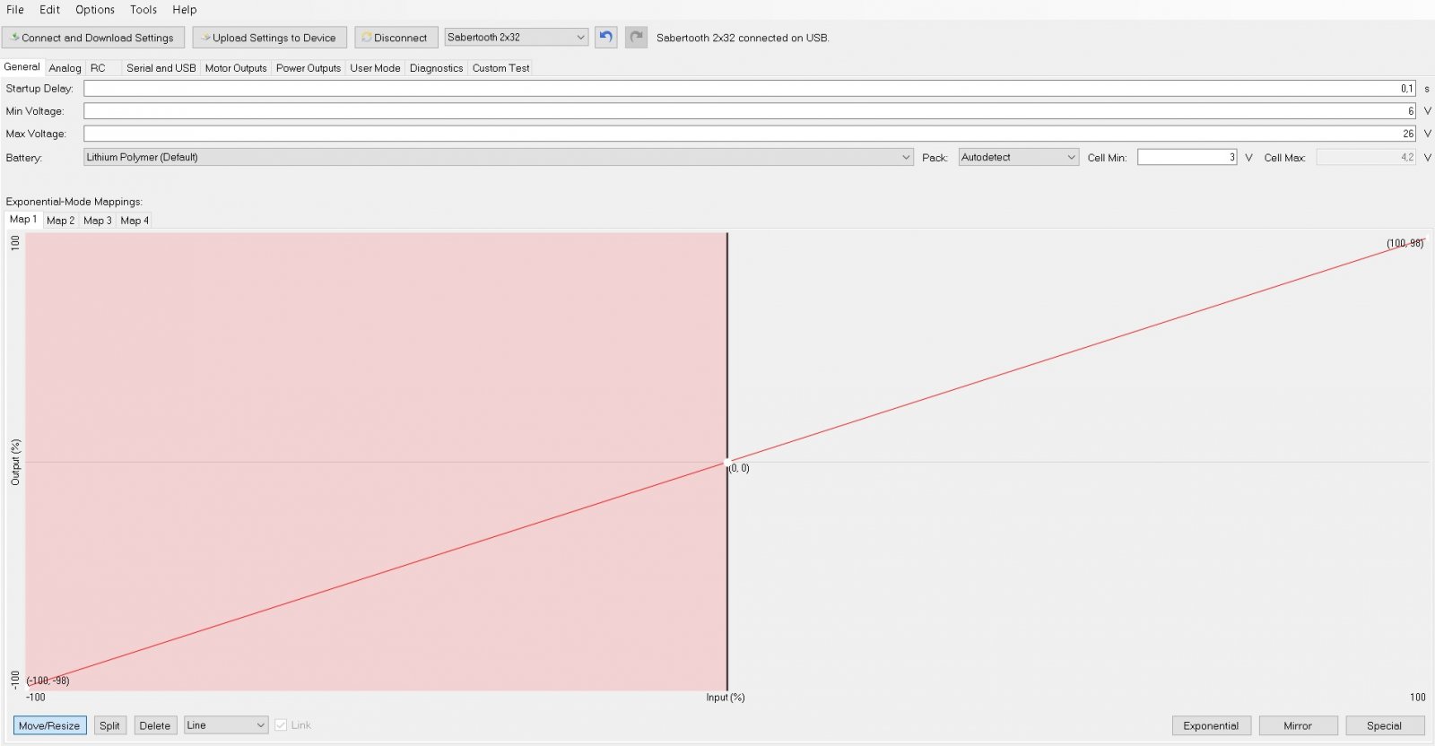

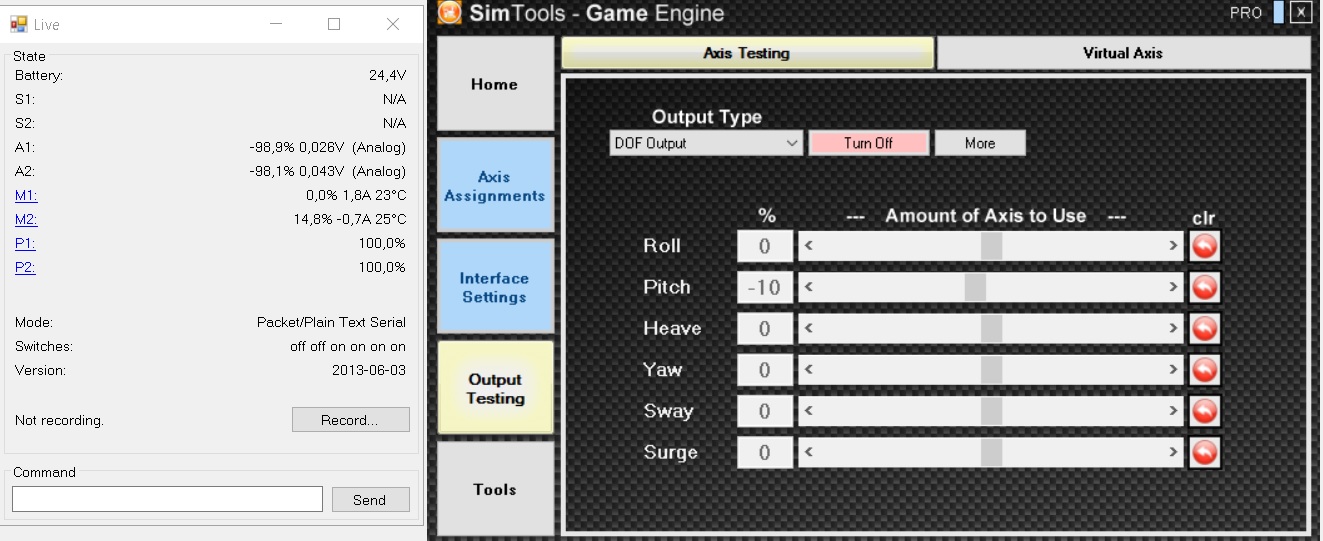

    after trying a little, my 2dof test structure is now moving.
    Only I have the following phenomenon, in Simtools when I test the axles, the following happens:
    I control an axis via Simtools and you move the axes of the motors up and down normally, depending on the position of the slider.
    However, the slow linear movement of the slider in Simtools results in somewhat larger movements / jumps in the motor axis.
    Had already assumed that the pots rustle, this is not the case.
    I measured the voltage at the inputs A0 and A1 with an oscilloscope.
    The voltage curve is linear to the movement of the potentiometer without jumps etc.
    There is a very slight humming on the direct voltage from approx. 0.00V to 0.08V with a changing frequency.
    In addition, if the slider is not adjusted in Simtools, the axis of the motor remains in that position. The motor makes a minimal noise as if the motor is controlled minimally without moving.
    I had already set a dead zone in Simtools but without success.

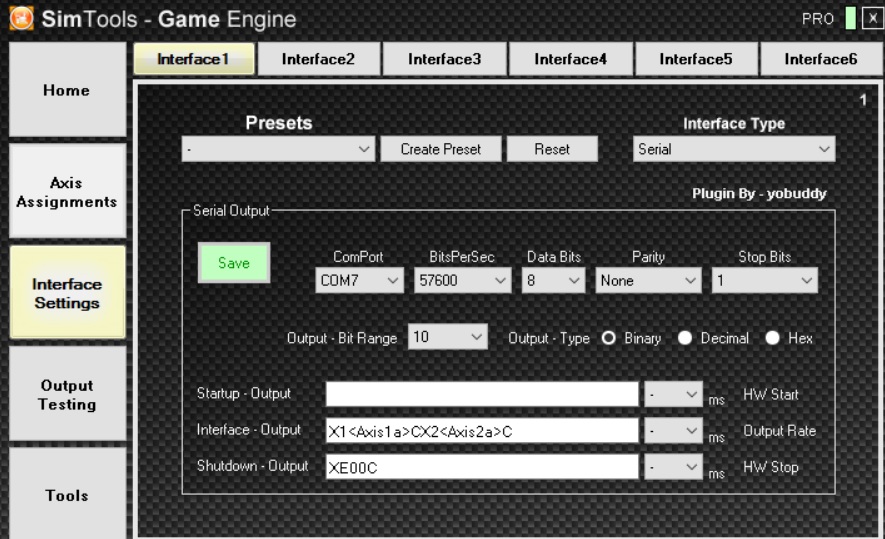

    My Simtools interface settings:
    BitsPerSec: 57600
    Data bits: 8
    Parity: None
    Stop bits: 1
    Output Bit Range: 10
    Output Type: Binary
    Interface output: X1 <Axis1a> CX2 <Axis2a> C 2ms
    Shutdown Output: XE00C 2ms

    Now, after a long time, I've built the basic structure and wired everything so far.
    Unfortunately you can now really see how the servo arms jump.
    I've already experimented a little.
    So Windows version I used Windows 10 Home Version 1909.
    Again to my problem:
    As an example, if I move the Pitch slider in Simtools (Dof Output), the motor works correctly.
    An example: from 0 to 30 the arm moves to every position and then nothing happens from 30 to 50 and then the arm jumps to the position of 50.
    By that I mean that the arm cannot move to the position between 30 and 50.
    I also have the problem in ((a) Axis Output) when I test the axis directly.
    Now I have run the diagnostics in describle and disconnected the potentiometer.
    Now I move the slider in Simtools and the motor is driven sometimes more or less strongly depending on the position (easy to recognize by M1%). Now the controller comes to 31 and the M1% remains constant until the controller has reached 50 and then M1% jumps by, for example 30 higher.
    Then I adjusted the potentiometer by hand and the motor turns from slow to fast. In diagnostics you can also see that the M1% can be adjusted at will.
    Hope someone has an idea.

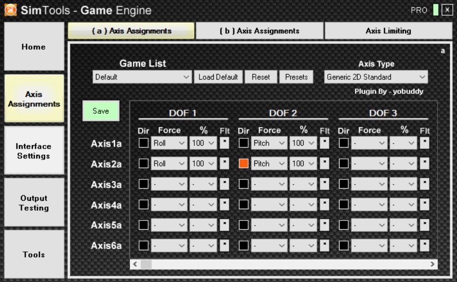

    Here are the pictures of my settings in Simtools

    66Coins

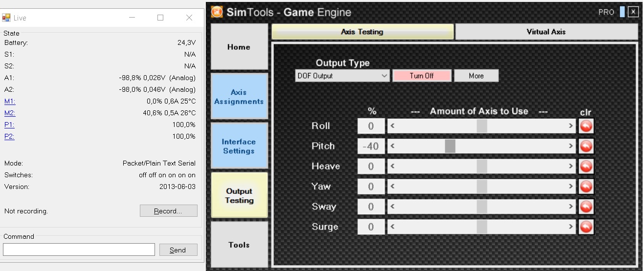

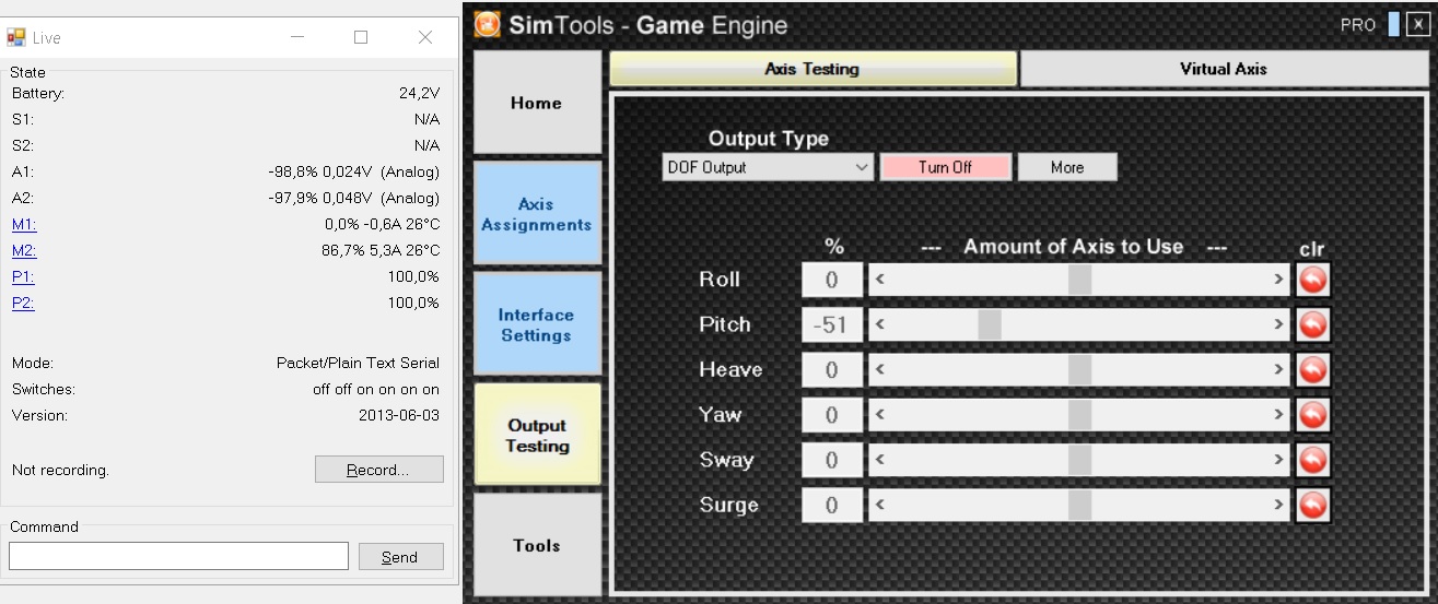

    Just took a few pictures here.
    The potentiometer is connected to motor 2 but not connected to the axis.
    Now the motor moves faster depending on the greater deflection of the pitch
    At picture 1 pitch -10 -14.8% / - 0.7A
      File size:
      197.9 KB
      Views:
      281
  10. Mister_Ray
    Mister_Ray New Member Gold Contributor
    Sep 21, 2020
    17
    Deutschland
    66Coins
    So on picture 2 I have set the pitch to -25 and the motor is driven at 40.6%.
    The motor now also runs faster than with pitch -10.

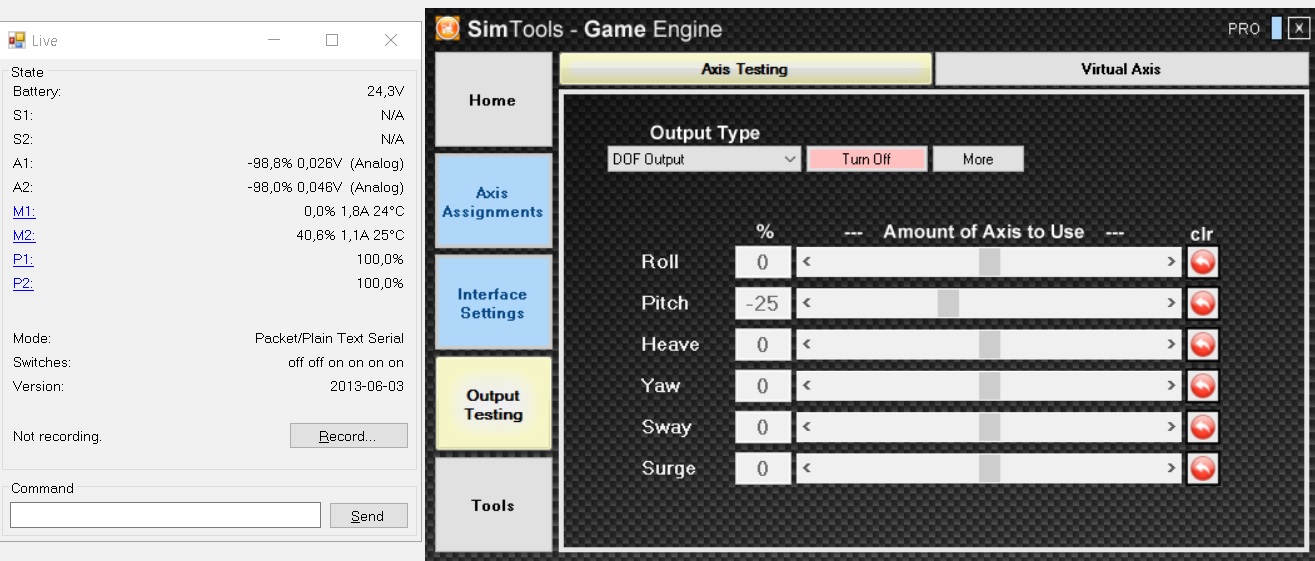

    On picture 3
    I have now set the pitch to -26. and the motor continues to be controlled at 40.6%.
    No change to pitch -25%
    the engine is still running at the same speed.

    In picture 4
    I have now set the pitch to -40 and the motor is still controlled at 40.6%.
    In picture 5
    If I have set the pitch to -47, no change in the motor speed is equal to pitch -25
      File size:
      205.1 KB
      Views:
      257
      File size:
      201.2 KB
      Views:
      263

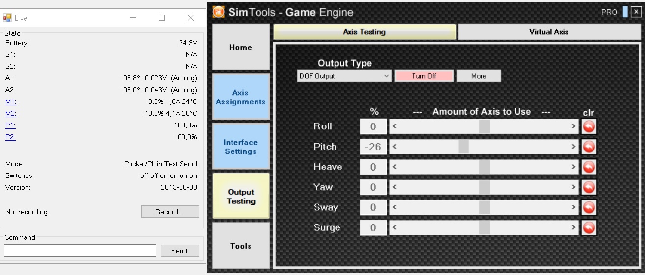

  12. Mister_Ray
    Sep 21, 2020
    17
    Deutschland
    66Coins
    In picture 6
    If the pitch is now -51, the motor has jumped to 86.7%!
    Now the engine turns a lot faster.
    When I connect the potentiometer again and do a test run.
    between pitch 0-25 the motor arm moves normally.
    at over -25 it stops and jumps with a large jump at pitch -51.
    above -51 the motor moves again normally without jumps. he only does this again with higher pitch values
    This is what the poor also do with other values, I only took it as an example.
    I had these problems with Simtools V2.4.1 and V2.5
    Will try again with an older version.
      File size:
      206.2 KB
      Views:
      270

    I have now tried Simtools 2.1 and everything works with the version.
    No more jumps in the motor arms and you can approach the position precisely.
    I used the same settings as in version 2.4.1 and 2.5.
    Then i uninstalled the 2.1 and installed and started the 2.5 again.
    Doesn't work again. Will now test a version in between.
    I will also test the one with Windows 10 v.2004 with Simtools v.2.5 .
  15. Mister_Ray
    Sep 21, 2020
    17
    Deutschland
    66Coins
    I have now tested the Simtools v2.4 and with this version everything works for me.
    I will try other Windows versions with higher Simtools versions when I have the time.
  16. Mister_Ray
    Sep 21, 2020
    17
    Deutschland
    66Coins
    I just installed and tested the new simtools version 2.5.1.
    Can only say that in this version everything works for me as it should.
    Great job, thank you.
