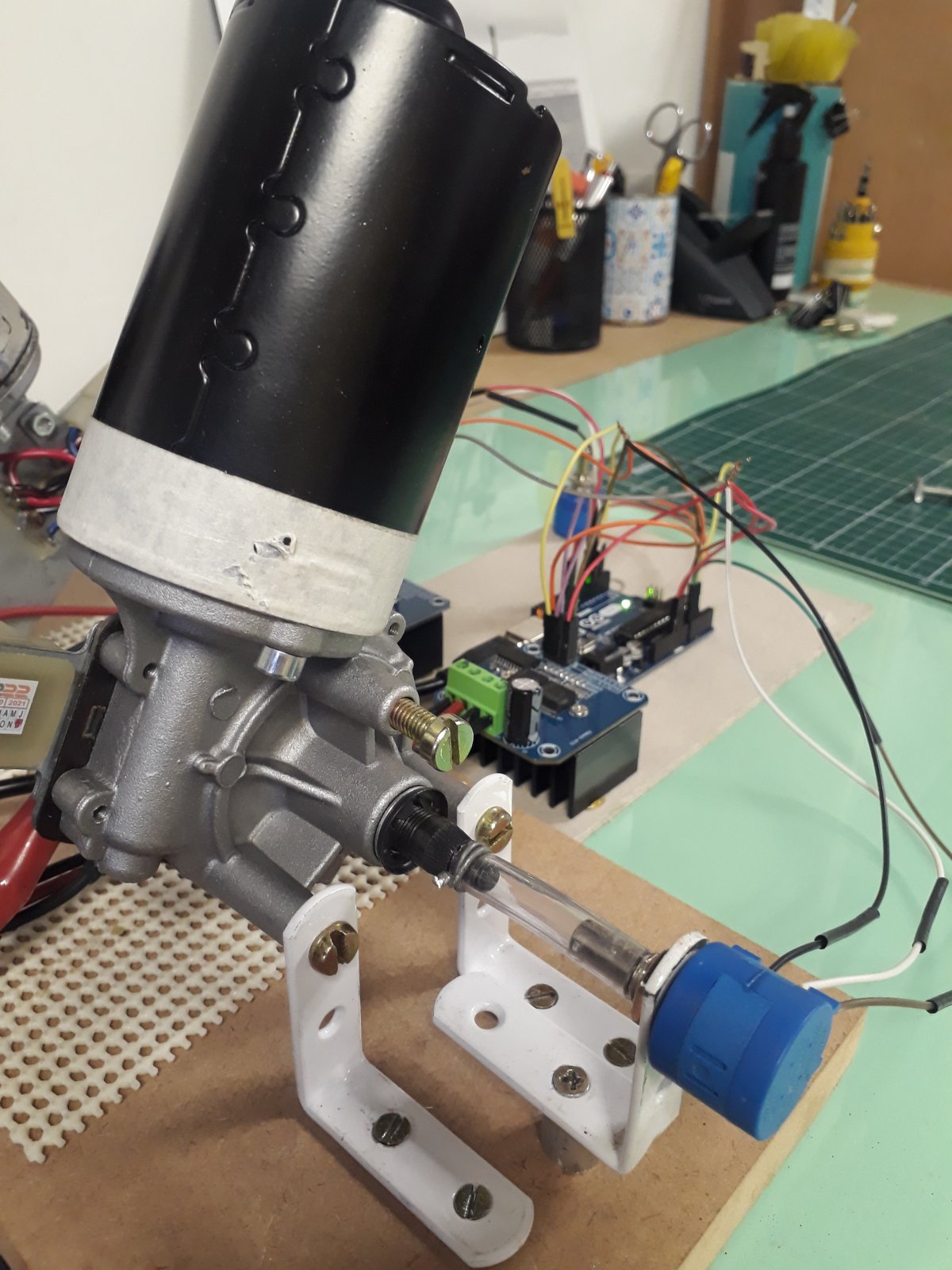

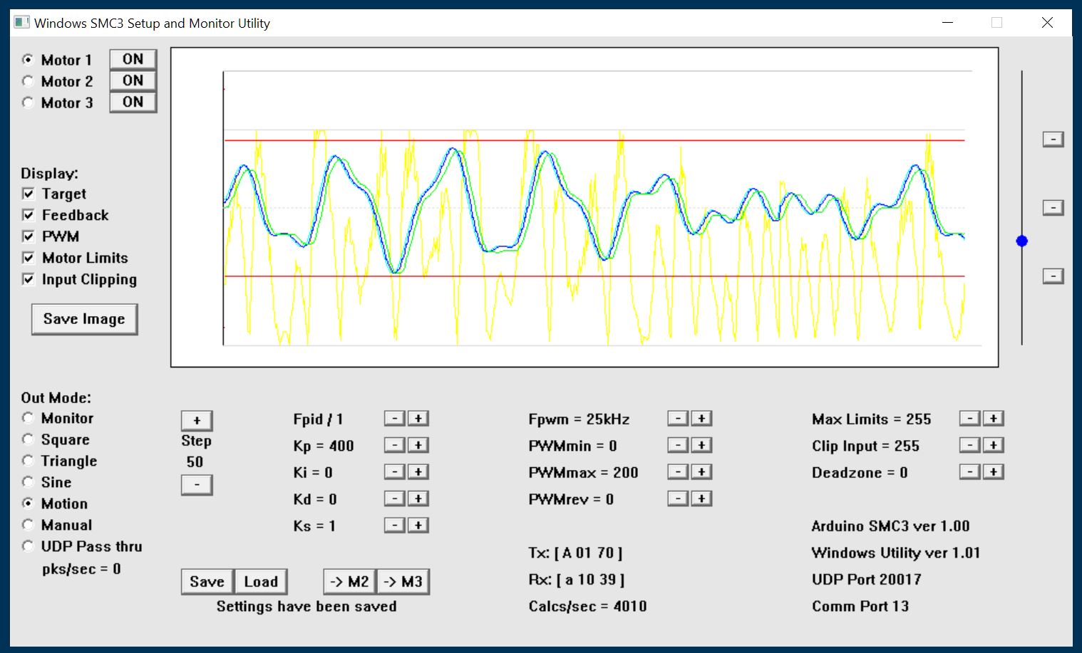

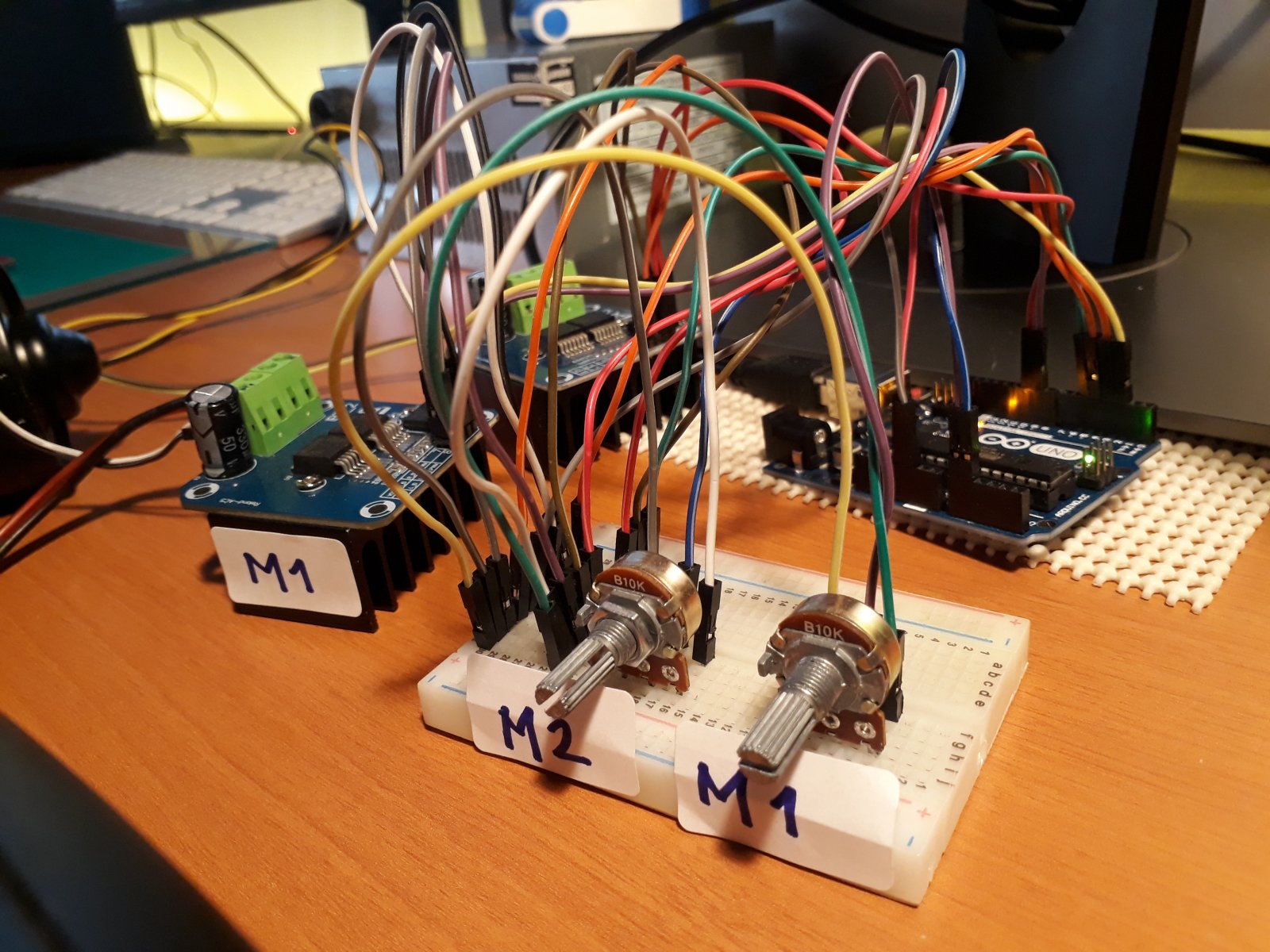

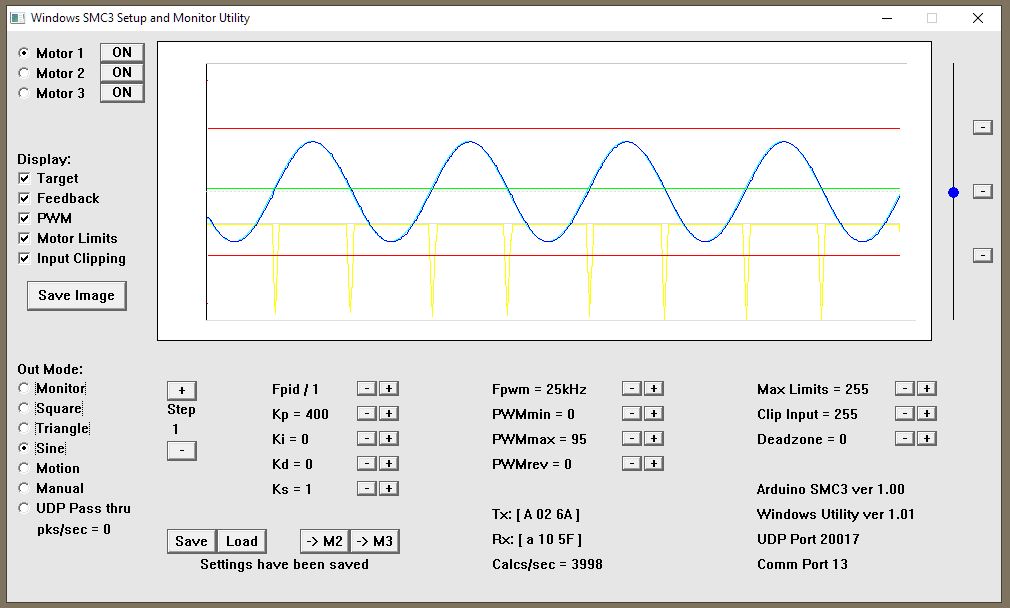

    I have the potentiometers in the engines and even so the green line does not follow the blue line

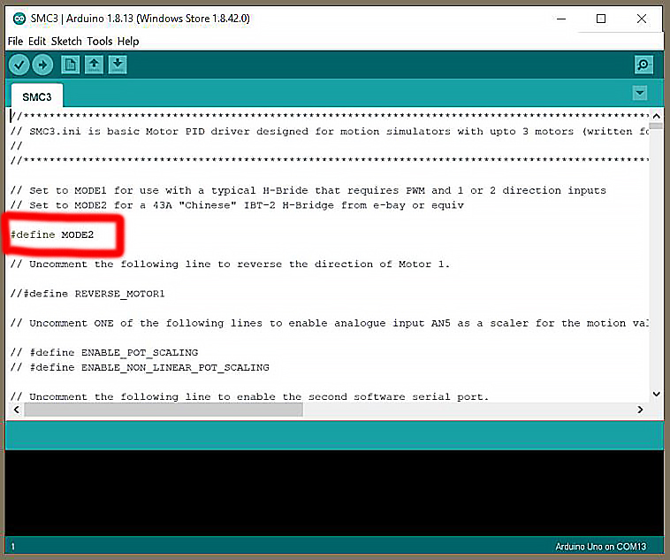

    - Yes. I configured the code for Mode 2 as needed

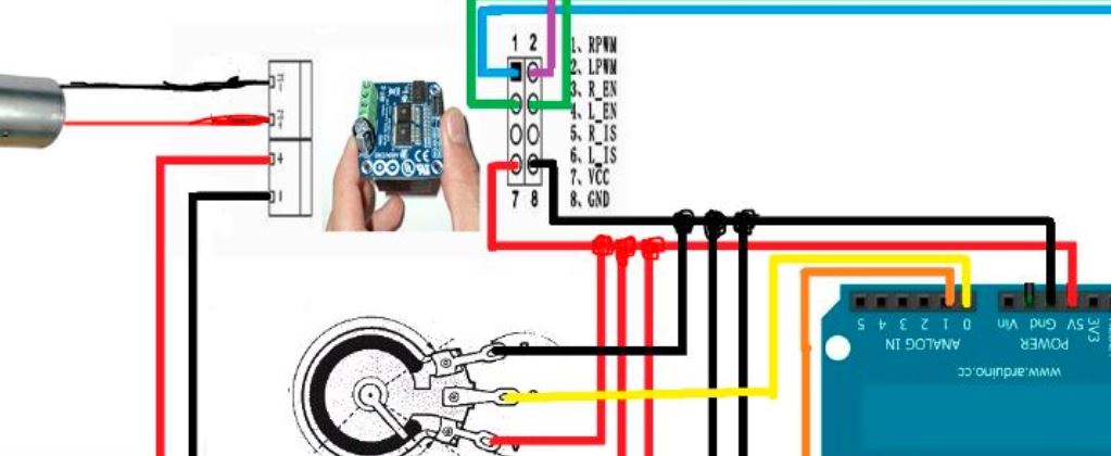

    - I checked the connections and this is according to the diagram
    21,906
    153,047Coins
    +11,116 / 56 / -2
    Have you connected the pots to the motors?
  7. marcosrobert
    marcosrobert New Member
    Jul 10, 2018
    14
    Design Grafico
    Sao Paulo - Brasil
    253Coins
    I connected the pot following the diagram.
    Is correct?
    When I turn the pot, the green line goes up or down,
    indicating that the potentiometer is working

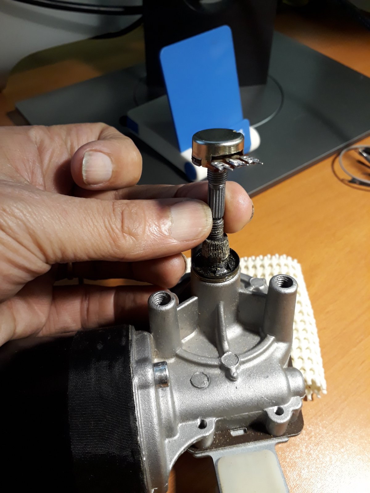

  10. Christian Doehl
    Christian Doehl Member Gold Contributor
    Oct 6, 2020
    63
    Germany - Bavaria
    695Coins
    +35 / 1 / -0
    Just for understanding: When the motor turns it has to turn the pot as well as this is the feedback for the motor position. When th motor moves the lever it also turns the pot and the resistance value ist the feedback for the Arduino. So as Noorbeast already mentioned you have to connect the pot to the motor, in this case connect does not mean wiring but mounting. And keep in mind that the pot housing has to be mounted to the frame or something else as otherwise the motor turns everything and the resistance will not be changed.

    I will connect the potentiometer to the motor. Thank you very much for the clarifications

    I followed the guidance and mounted the potentiometer on the engine.
    On the SMC3 the green line does not yet follow the blue line
    What can it be?

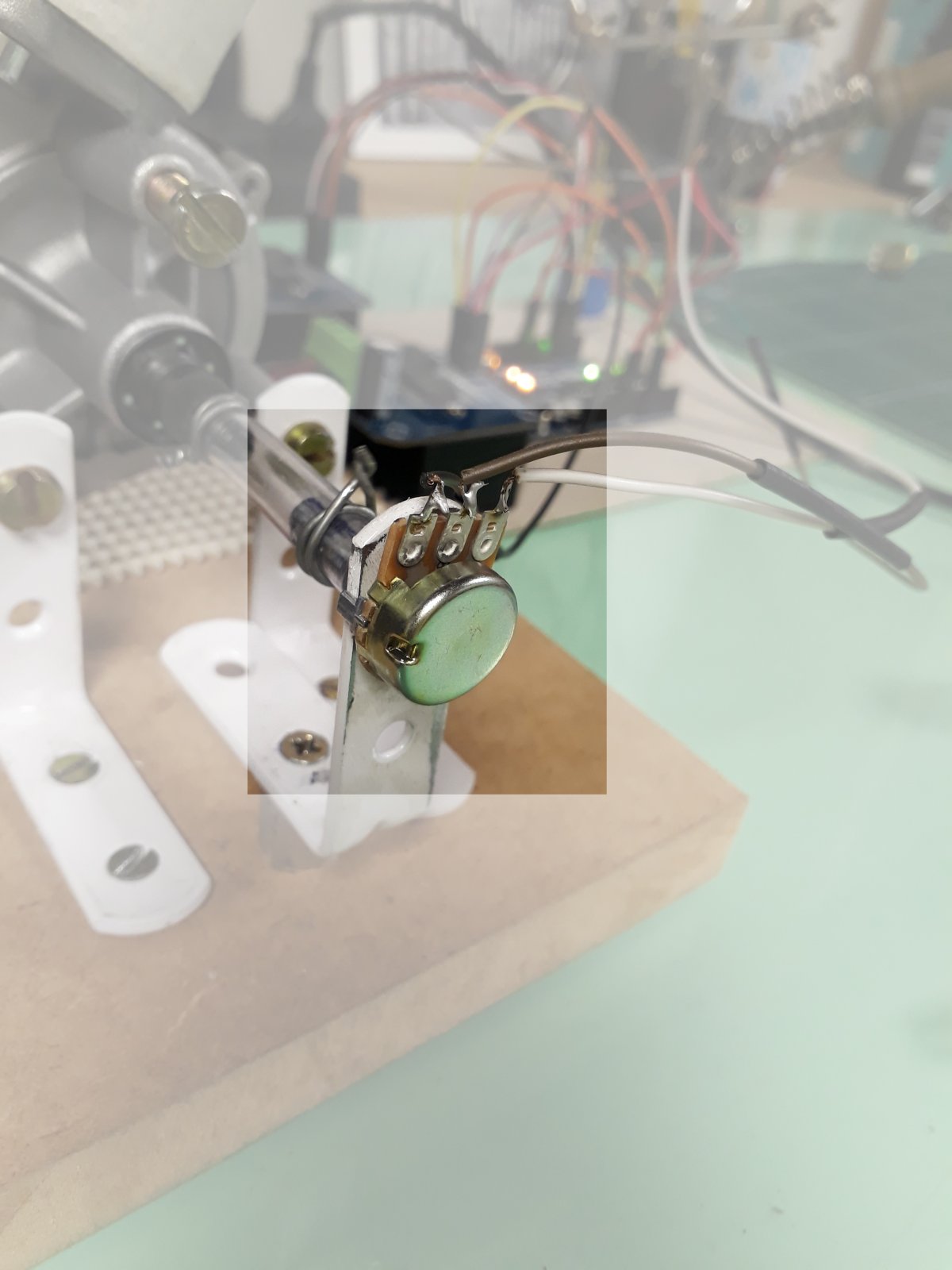

    I changed the potentiometer and got this result in SMC3

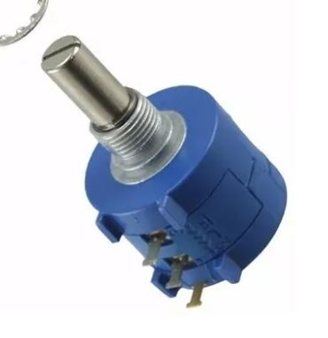

    Just guessing but your pot looks like a multiturn pot, means it needs multiple turns to reach limits, in this case you may need something like a gearbox. A big gear on motor shaft and a small one on pot. Not sure thats the rootcause but a possibility. In my opinion your mount is for max 360 degree pot.
    BR
    Chris
