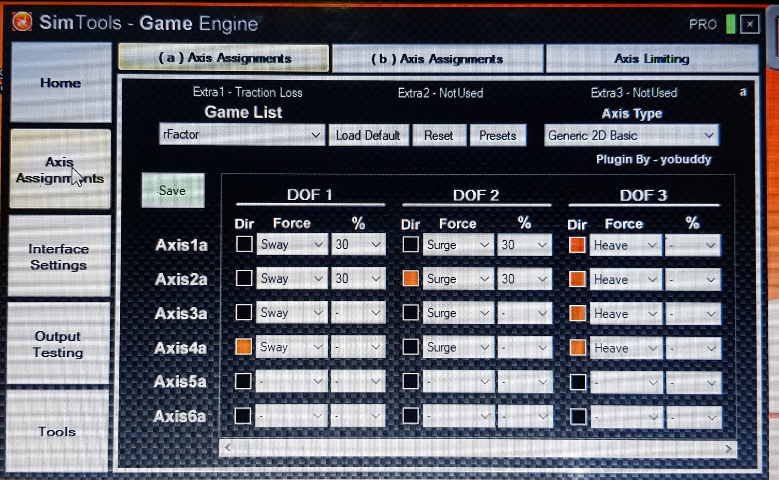

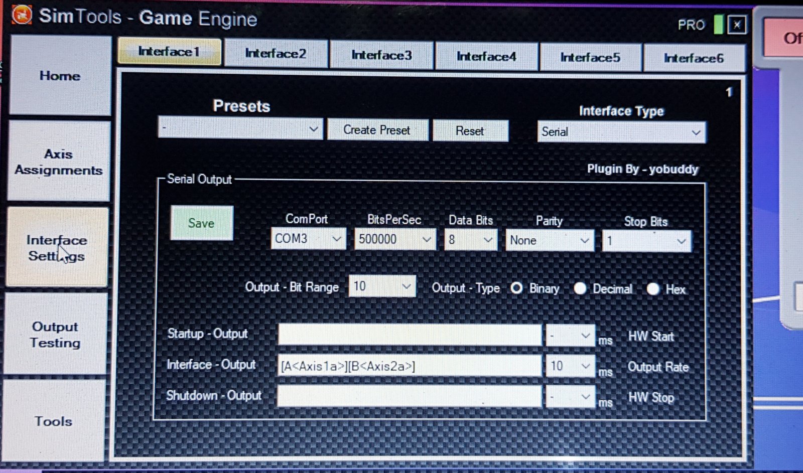

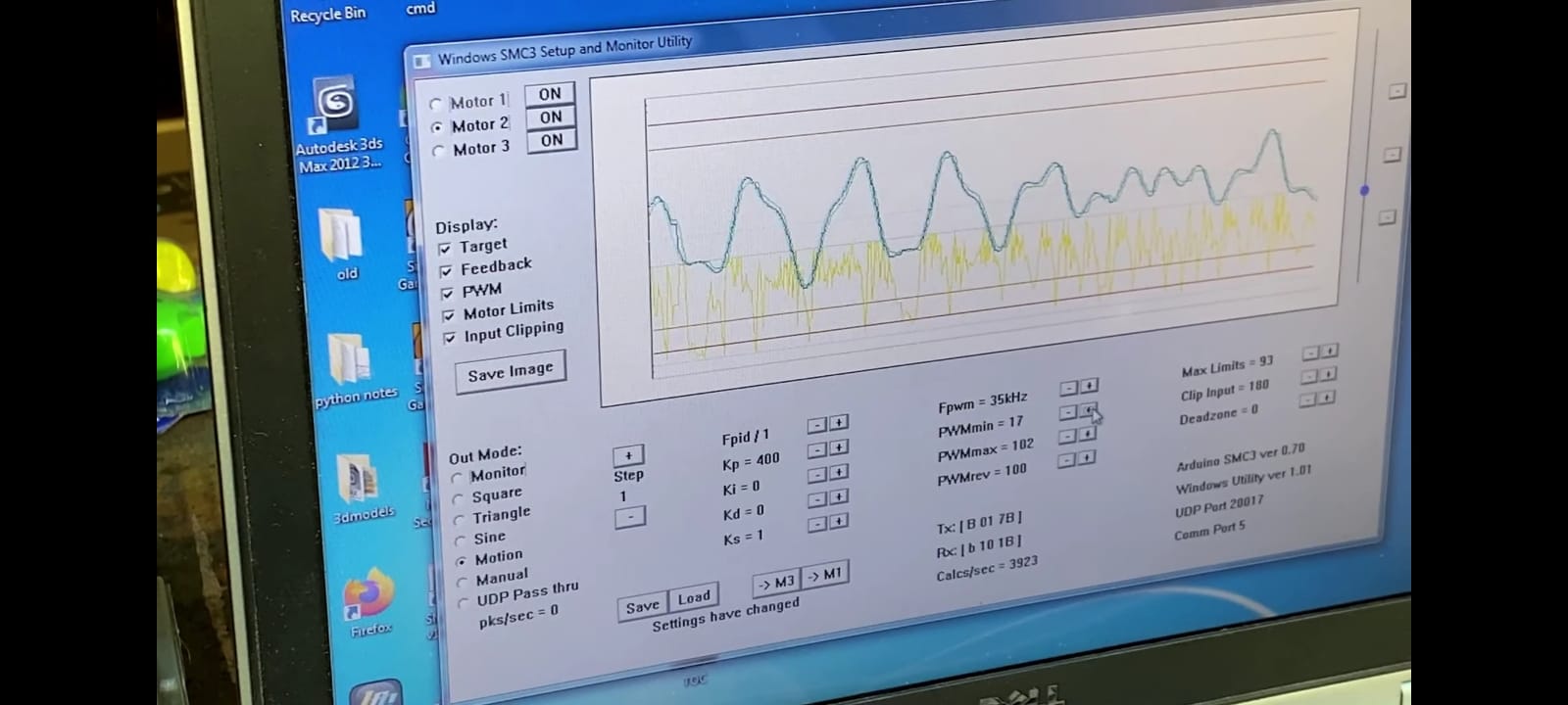

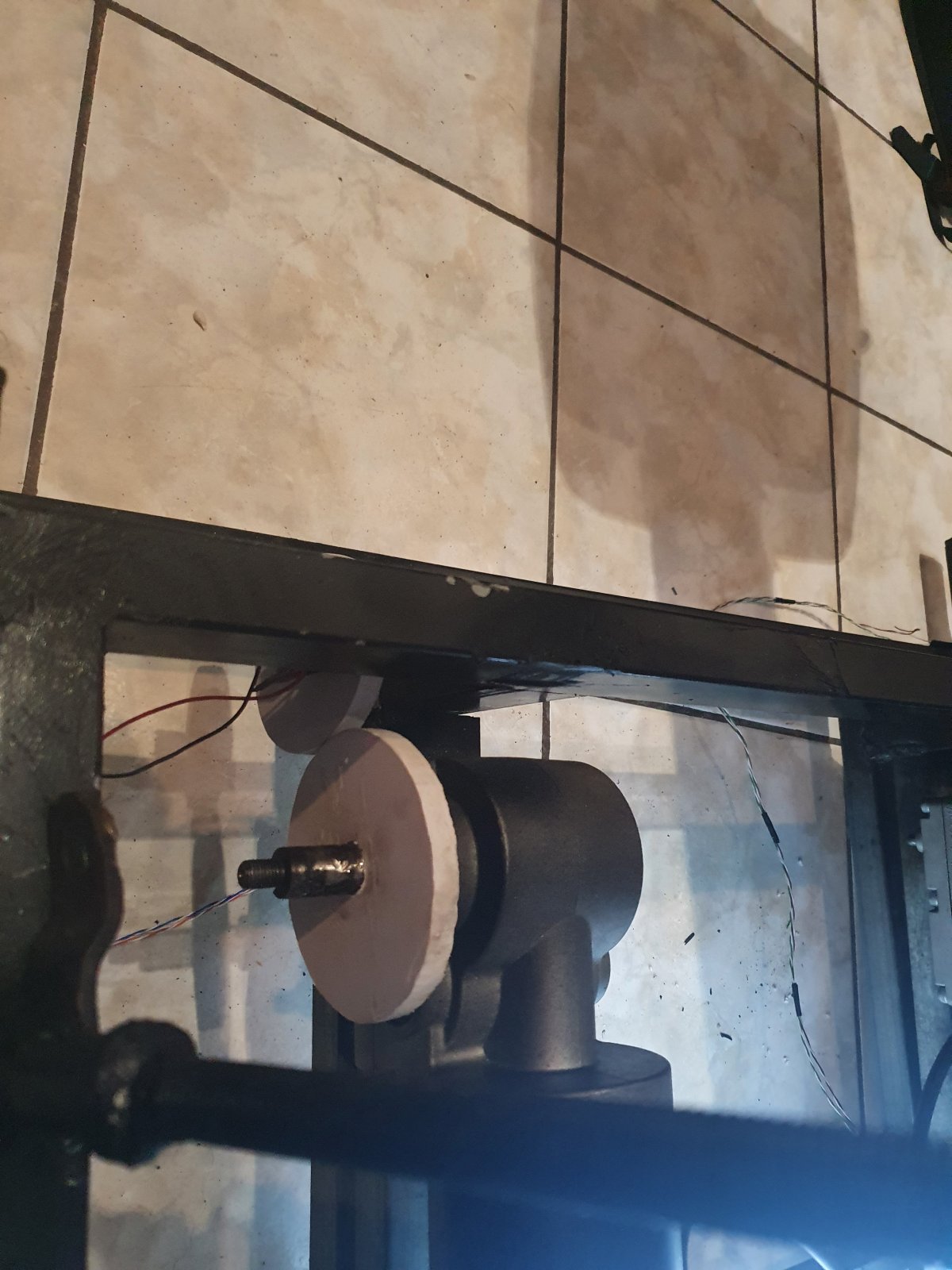

    the SMC3 code is a code that is loaded into the arduino and once loaded into the arduino you would have to download the SMC3 utility to couple the motors with the potentiometer the code is the standard 3dof code that we all use once I do all this you would have to look at how to couple the motors .. and once coupled you would have to configure the game engine well put in port that you are using the same parameters of the photo then continue configuring everything in the axis part in the axis assingnament flap when you open a game there is if the engines would have to go up and down simulating braking or accelerating or when you turn to both sides.

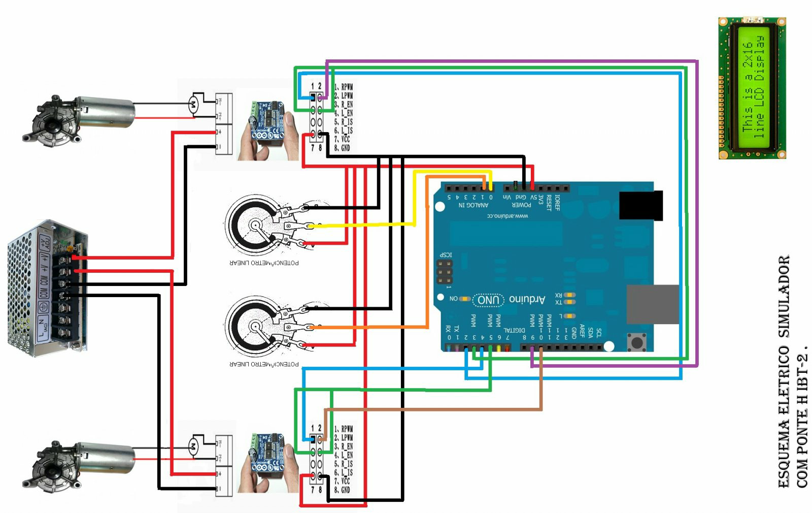

    This is my conection
    21,592
    151,215Coins

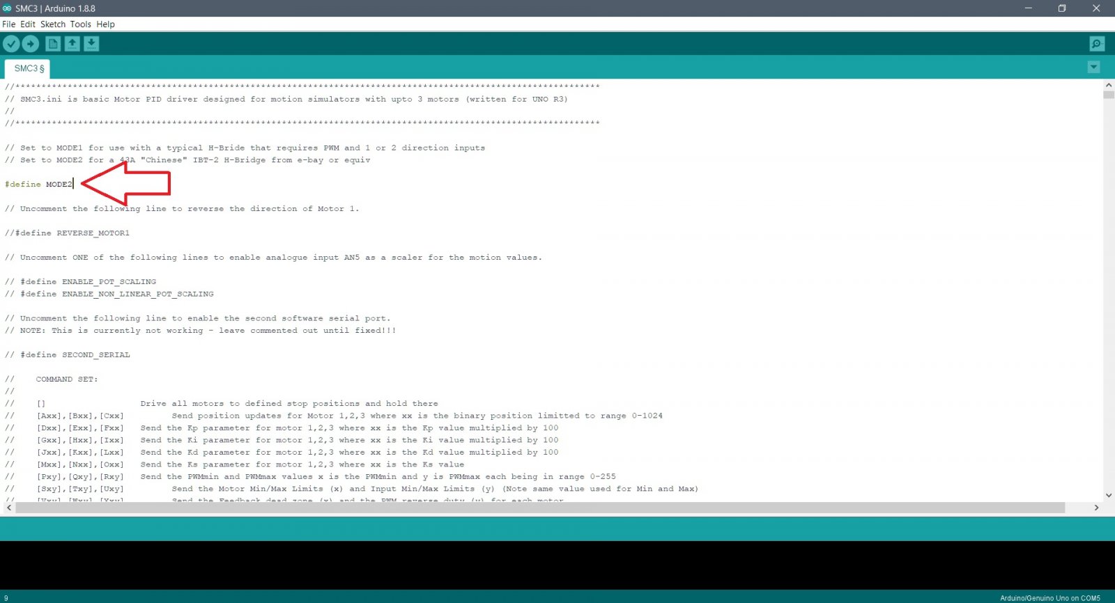

    By any chance are you using wiper motors and are the pots connected to the motors?
    Mode 1 and Mode 2 depends on what motor drivers are being used with the SMC3 code, Mode 1 for the likes of Motor Monsters and Mode 2 for the likes of IBT-2 boards: https://www.xsimulator.net/communit...3dof-motor-driver-and-windows-utilities.4957/
    That wiring looks to be correct.

    I am using wheelchair motors.
    my connection is made with arduino and ibt2

    If you are using IBT-2 then the SMC3 code must be changed to Mode 2 in the code like this:

    Of course, as you say in that part of the code, it says that you have to clarify the way you use, you are right. I think that in the video you put as a reference, it never clarifies that the code must be reformed.

    When you want to understand something, it seems to me that you need to re-read the instructions several times; I also didn’t understand exactly where to change the code the first time.

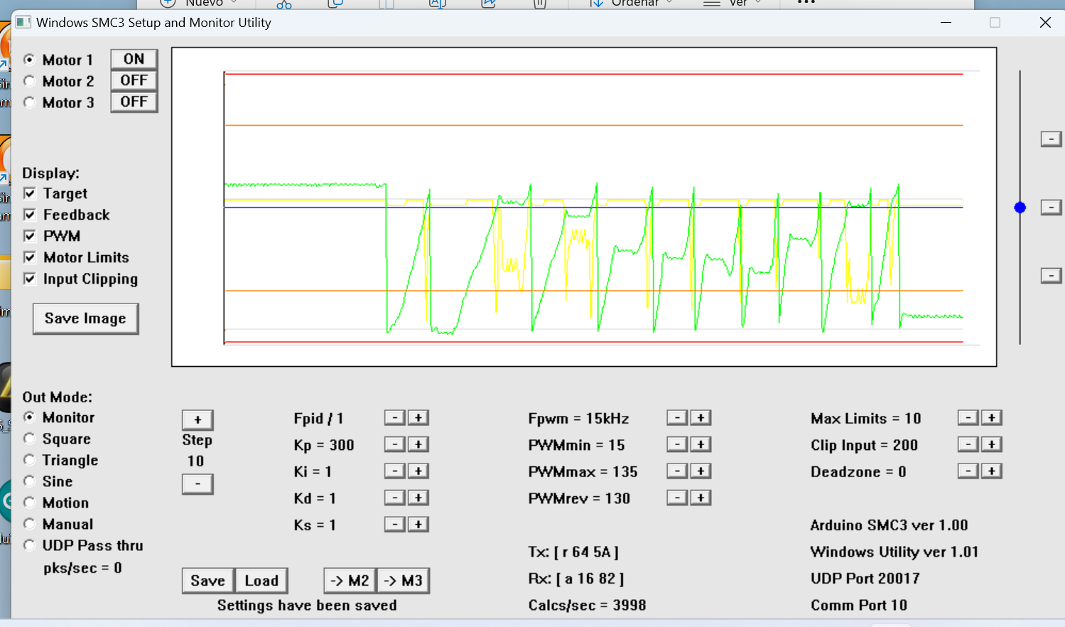

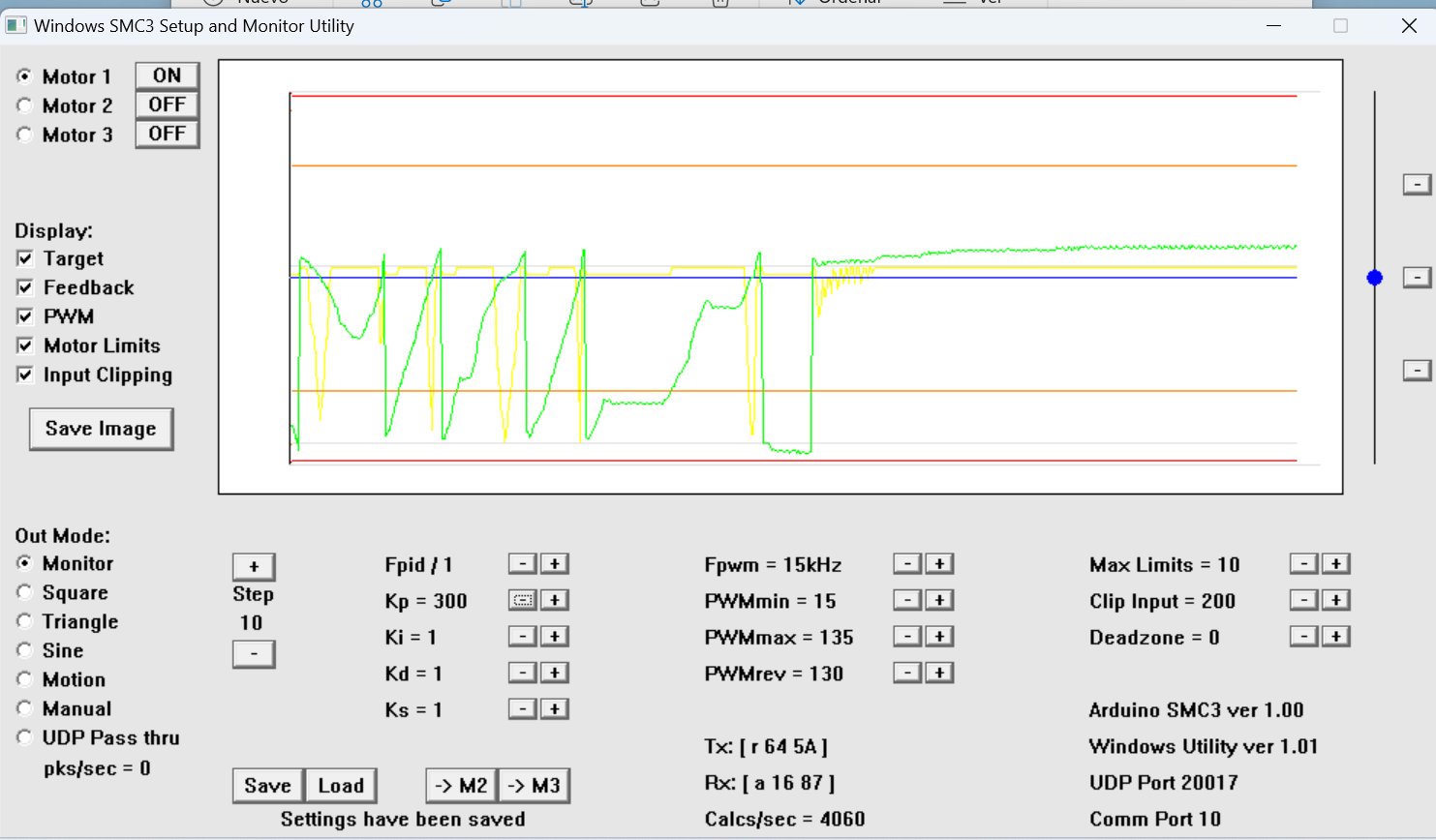

  20. elfren
    elfren New Member
    Sep 27, 2023
    18Coins

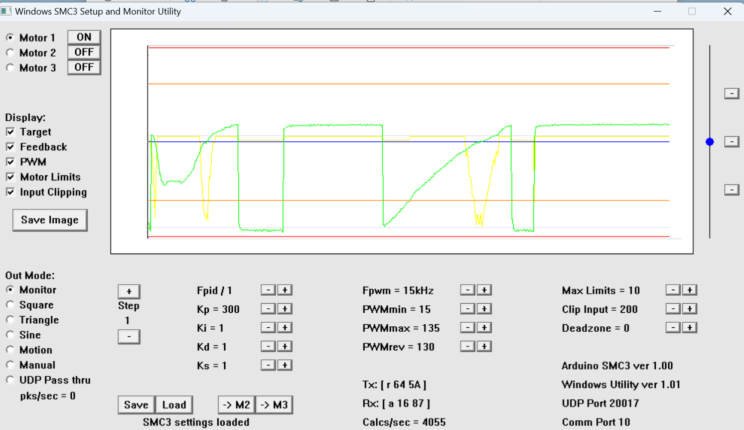

    Tengo un conflicto con el sensor. Lo que pasa es que en vez de marcar todo el parámetro en la configuración de smc3, solo marca una parte y cuando estoy usando el 2dof se desconfigura porque supera el límite. Tengo mi licencia. Simtools pensé que sería por esto pero sigo con el mismo conflicto
    La última imagen, que es diferente a las tres primeras, es una imagen tomada de un video en el que se puede ver donde la línea verde que hace referencia al sensor recorre toda la trayectoria del motor ya que este es un caso diferente al mío donde el motor apenas llega a la parte superior y cuando pasa el punto donde llega mi línea verde, Se apaga y deja de funcionar hasta que lo configuro.
